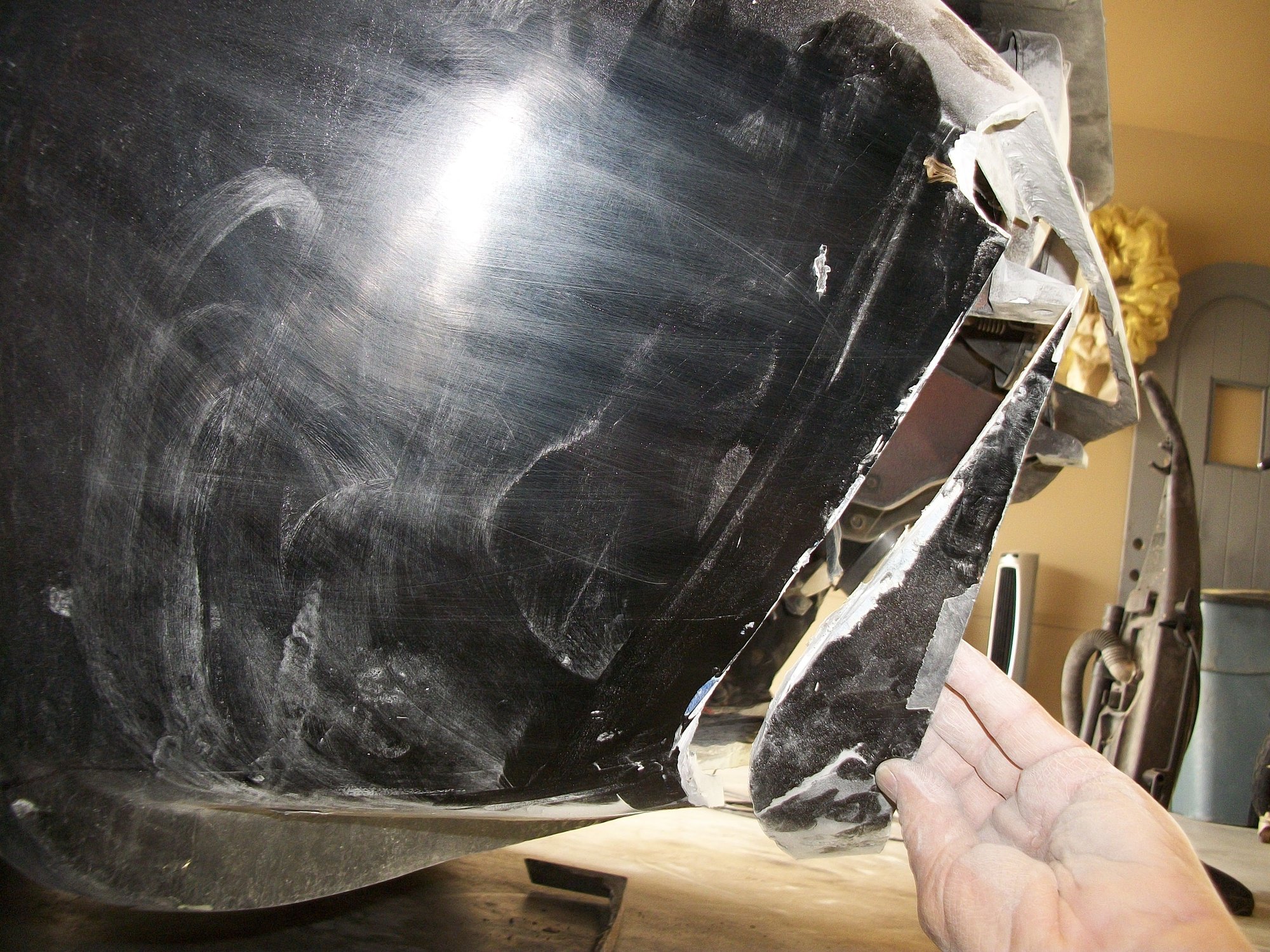

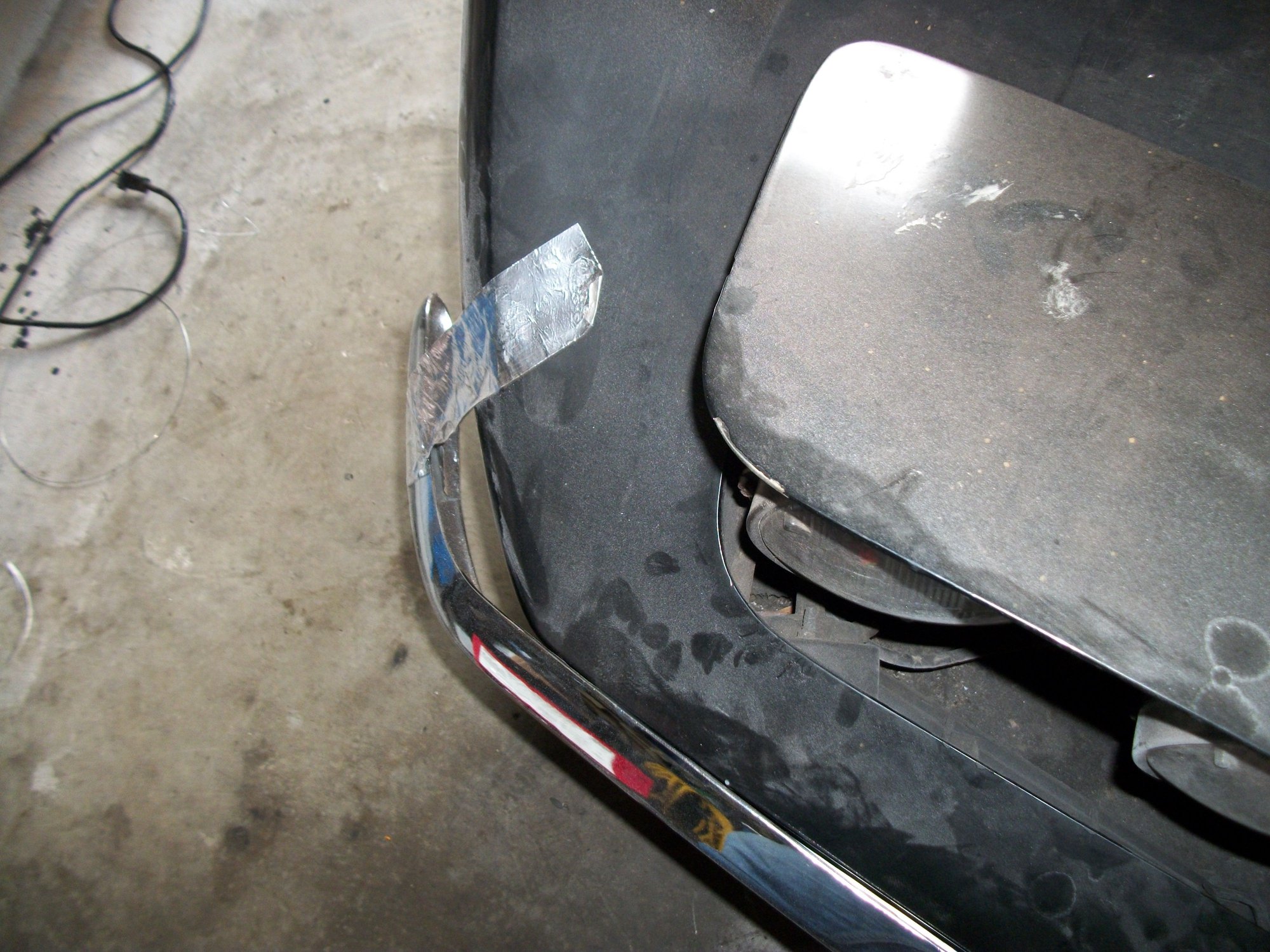

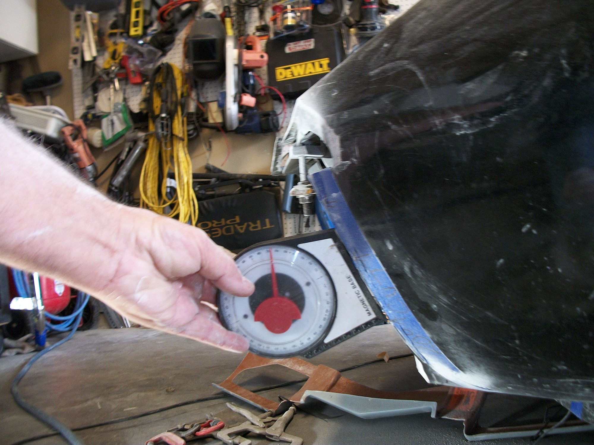

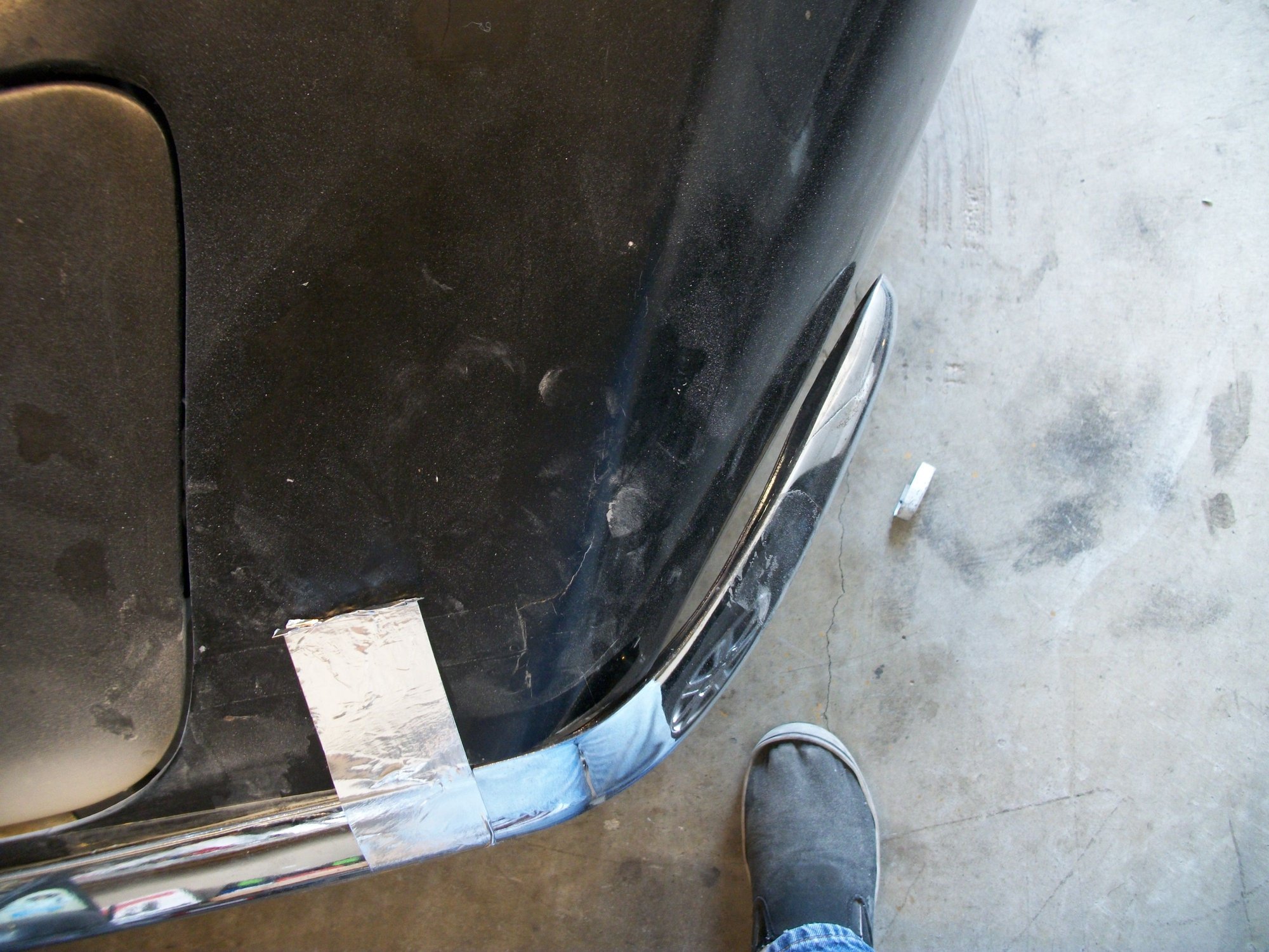

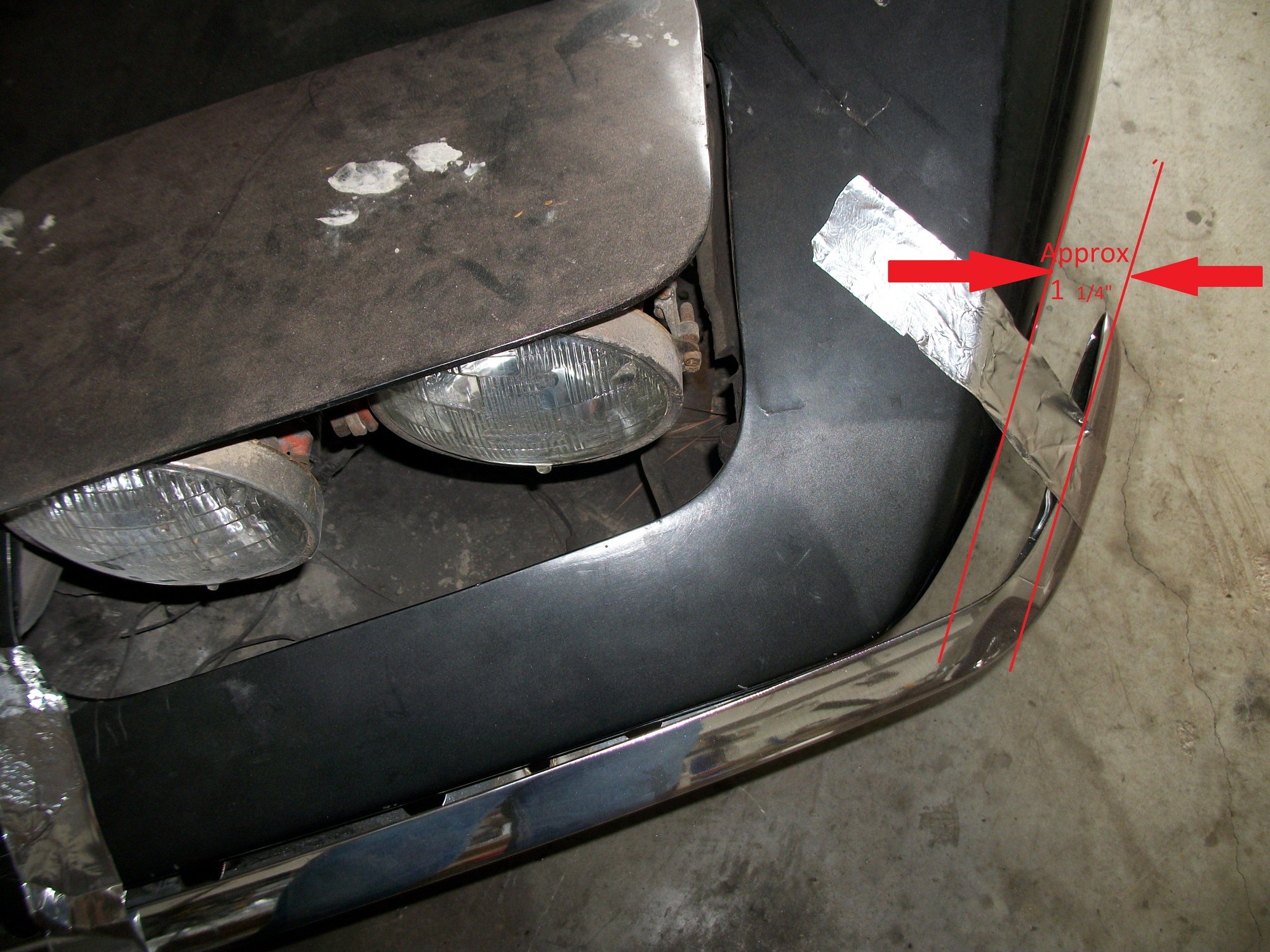

Priya...since I am attempting both mods it seems to me there is an "easier way" to mod the nose for a chrome bumper, and have it well-braced also. (The hard way which I am doing now involves three times the work).
I originally was going to "shorten the nose" several inches until the corners of the chrome bumper fit fairly closely to the fenders/nose. The mod was going along well (no experience with fiberglass). I had the nose trimmed back in 1" increments to avoid cutting off too much. All I needed to do was "piece together" fiberglass to get the nose shaped to match the bumper/build up the "low areas" with fiberglass so a minimum amount of body filler would be needed. Working aa few hours a day or on weekends it should have taken me/rookie about a month.
BUT...I decided I wanted a more original factory look which doubled the time to do the mod. Forum members gave me great advice...I NEEDED it. The plans changed on a weekly basis as to how I would get an original look.
The worst part of the problem I created was finding Bondo/screws/rivets/cracks/voids that needed correcting. I never would have needed to deal with all that if I had continued with the "Easy Mod". THEN...one day...the entire clip needed removing to "do it right".
So...back to the Easy Mod...I took pics (see my table of Contents to find them faster) of the Easy Mod (up to the point I changed my mind) and also of the Original-look Mod.
I probably would have been driving the modded/painted car a year or more ago had I stuck with the Easy Mod. Still. I am glad I learned so much from Forum Members by doing the nose the hard way.
Below are a few pics of the Easy Mod...…"roughing in the bumper and changing the grill angles to match a '68 nose...…......
I hope the above made sense.
