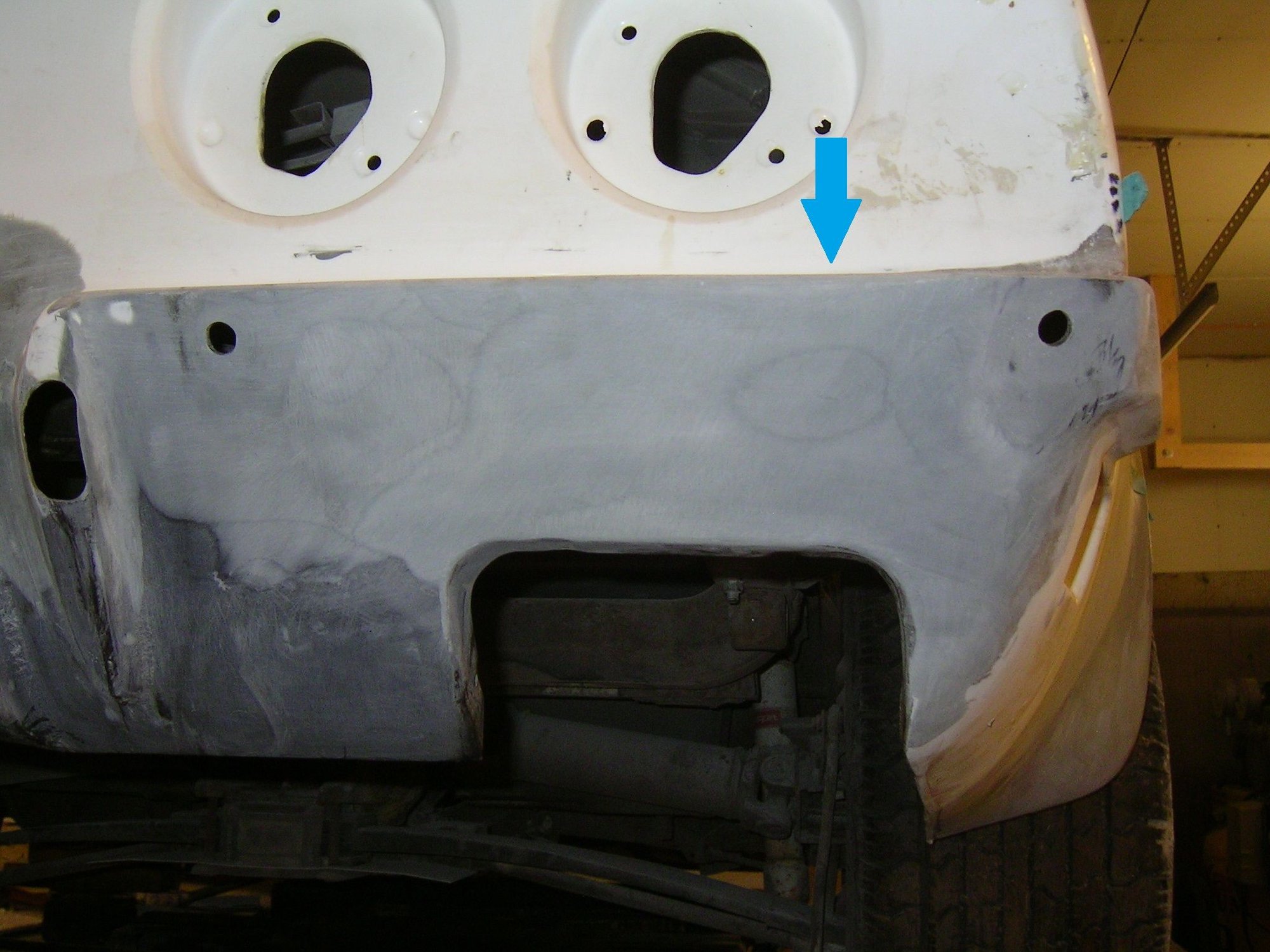

On July 4th we finally got my 79 back into the garage. My husband was off work for a couple of months but we got nothing at all done, not that we didn't plan to. Ward likes to get started working in the morning starting as early as 6:00 AM. Me, I don't like to get started until 2 or 3 PM. By that time Ward is sleeping on the couch in front of the TV and its hard to get him out the door. I find it hard to get started working on anything so knowing Ward is sitting inside on the couch relaxing makes it even harder to get out the door so we both end up doing nothing on his time off. Mind you I could (and I suppose probably should) get up with him at 5:00 AM and be ready to start work in an hour but...that's pretty tough for me, lol.
I finished filling and shaping the exhaust filler panel around the corner bumper mount. The filler was getting pretty thick around where the blue arrow is so I didn't add enough there to make a smooth transition - it'll be covered by the bumper anyway.

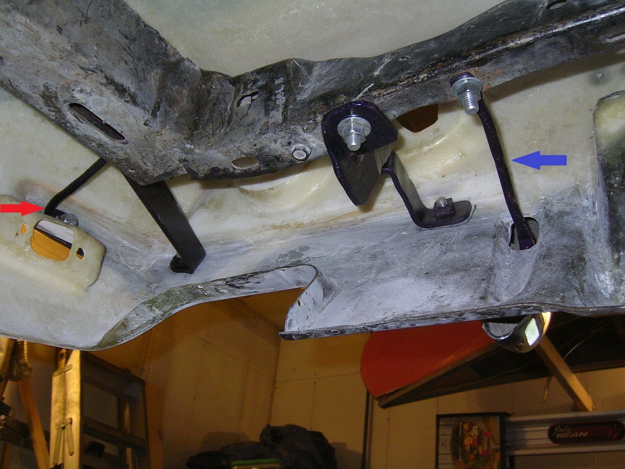

I got the last bumper bracket done on the passenger side. I have the same two shown in the picture below left to do on the driver's side. I'm pretty sure I can finish them both off in less than two weeks, maybe less than one week
I painted all the passenger side bumper brackets purple, or at least that was the plan. I had two little cans of purple paint and when I went to the second one it wouldn't spray so I ended up finishing them with a blue. They all look black except in direct sunlight. I'll paint the driver's side a light colour, probably the Cat yellow my husband has laying around. This way when the bumper brackets come off in the future it won't be such a jigsaw puzzle figuring out which bracket goes on which side.
Just to make sure, I tried fitting the passenger side bumper once again with all the finished bumper brackets in place, everything still lines up:
The inner bracket that goes to the lower part of the bumper (blue arrow) was a pretty big pain in the *** to get aligned as you have to bolt it to the bumper first and feed it through the hole in the exhaust filler panel, hold the bumper in place and see if it lines up to the hole in the frame cross member. Quite a bit of trial and error to get that one lined up.
On the bracket with the red arrow I know there's a rubber washer that I think goes on the outside of the quarter panel between the quarter panel and the bumper. Should I have some kind of rubber washer or sheet of rubber on the other bumper mounting points as well?
