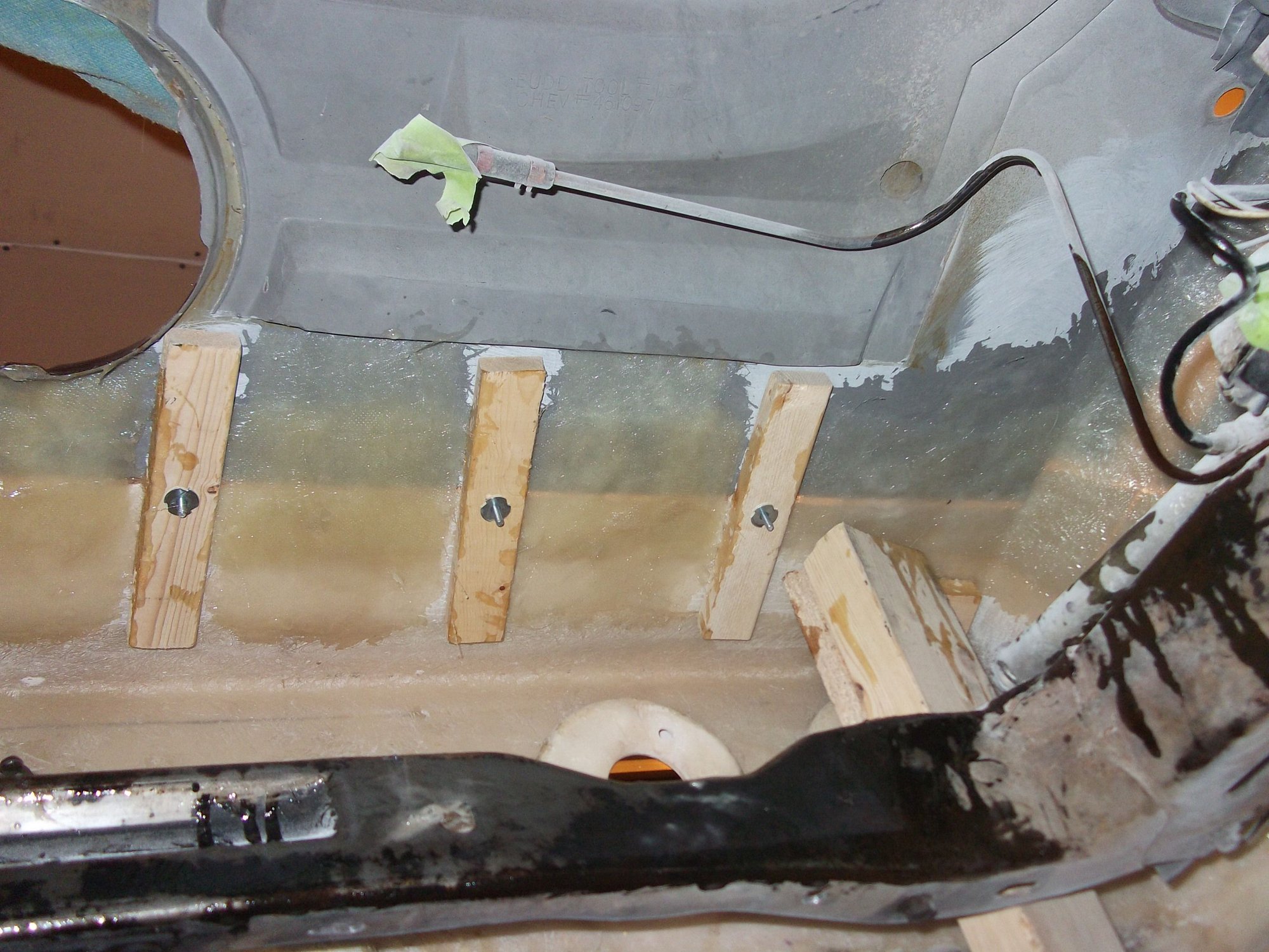

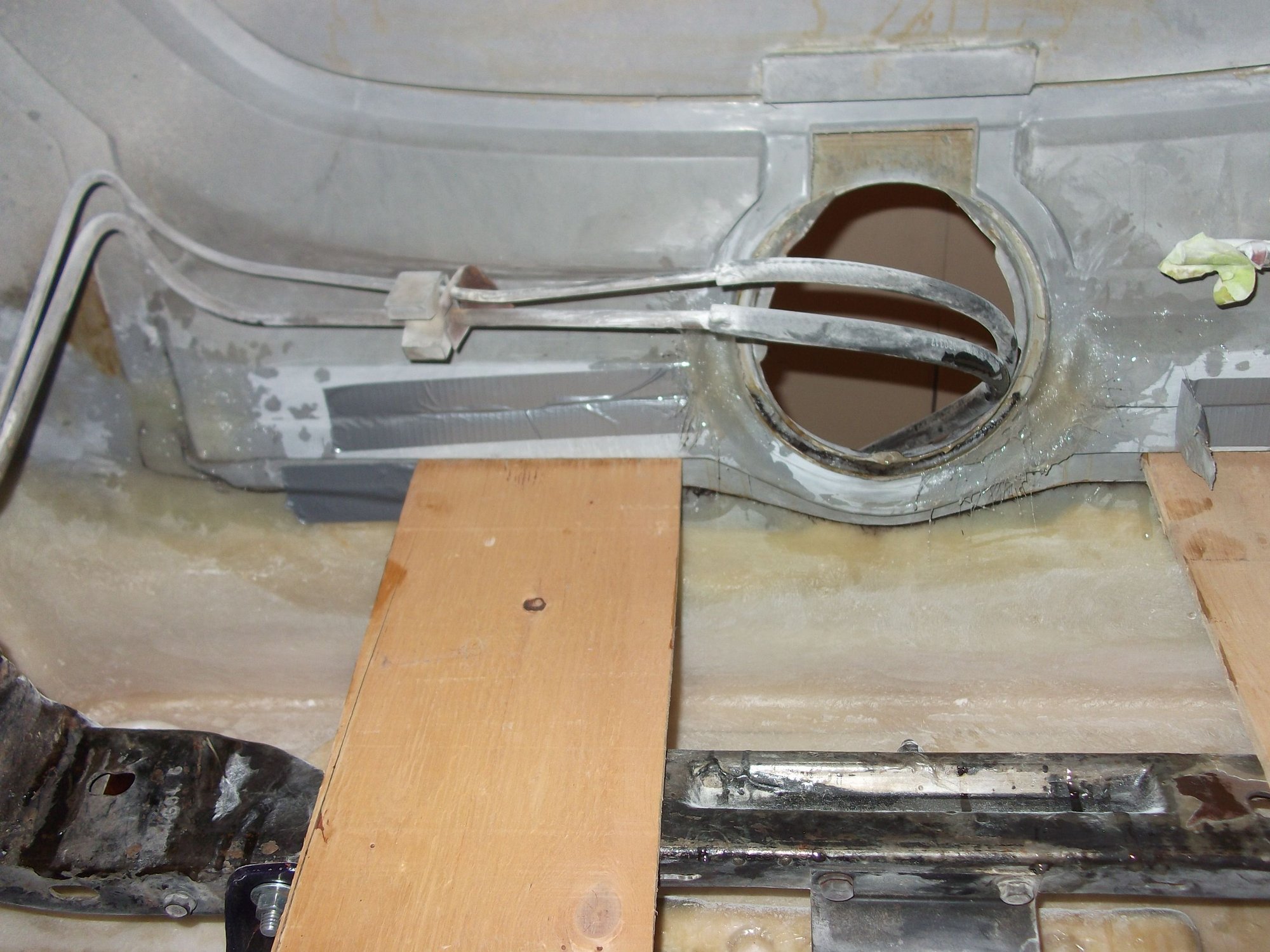

Yes, I got the last of the rear bumper brackets done on Friday. I'm now working on replacing a piece of reinforcing fiberglass I cut out to mate the ACI 70-73 rear clip to the back of the 79:
This reinforcing panel was cut and removed just above the yellow line. It feels good to be finally putting some stuff back in place on the rear instead of taking it apart.

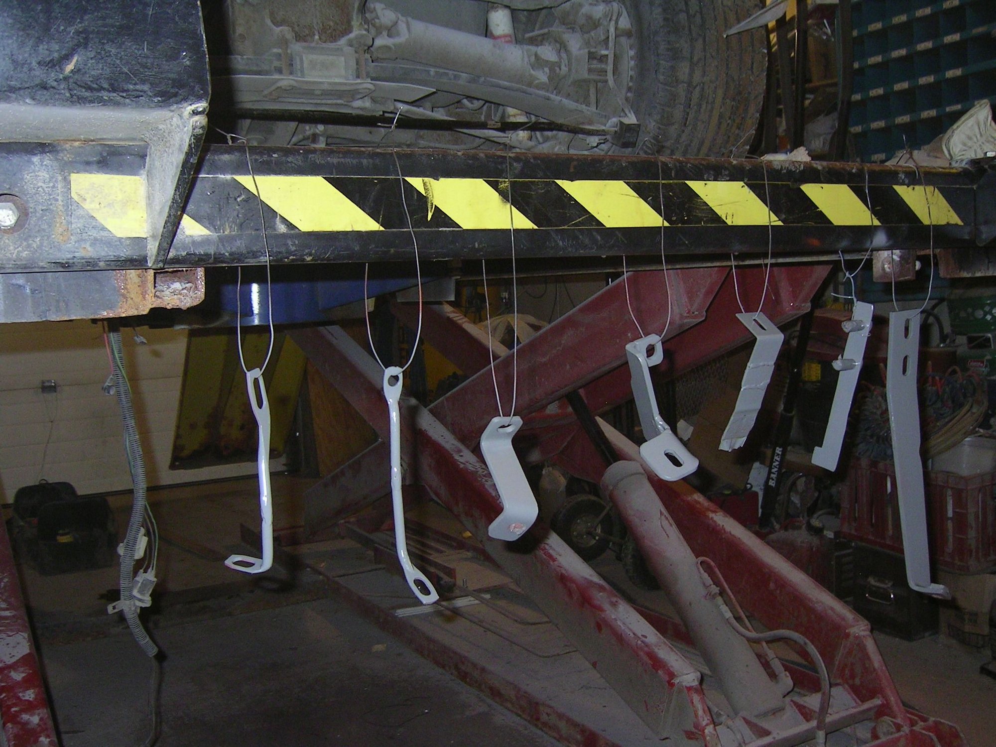

Here's the last rear bumper bracket that needed to be modified, ready for welding:
And the final weld:
And here's all the driver's side rear bumper brackets painted grey:

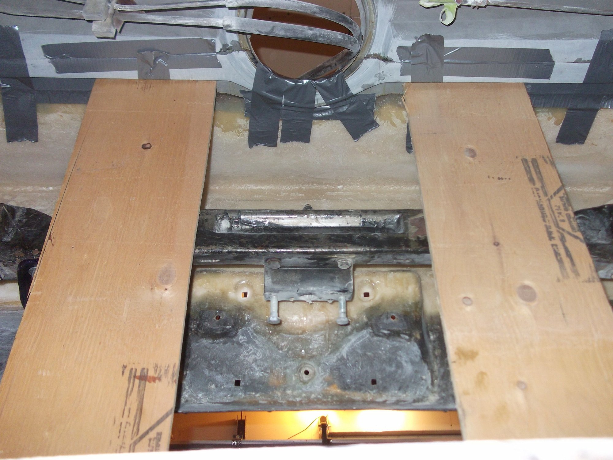

Then it was on to a piece of reinforcing fiberglass that goes on the inside of the upper deck I had previously removed to make the rear clip join:
I trial fitted it with some tape to see if it would stay in place and it looks good:
I took the tape off and added fresh resin and matt to rejoin the pieces. At that time I found the tape wouldn't hold the piece in place when the resin was on - go figure. I quickly raced around the garage to find something to prop up the piece with and found these two pieces of 1/4" plywood at a suitable length:
At this point I went into the house and took off my coveralls. I was sitting there feeling pretty pleased with myself when it hit me I used polyester resin on this SMC instead of epoxy resin - d'oh! So, I rushed out to the garage and tore it all apart and wiped everything back down with acetone - ain't that a peach? At least I remembered before it hardened up, better luck tomorrow

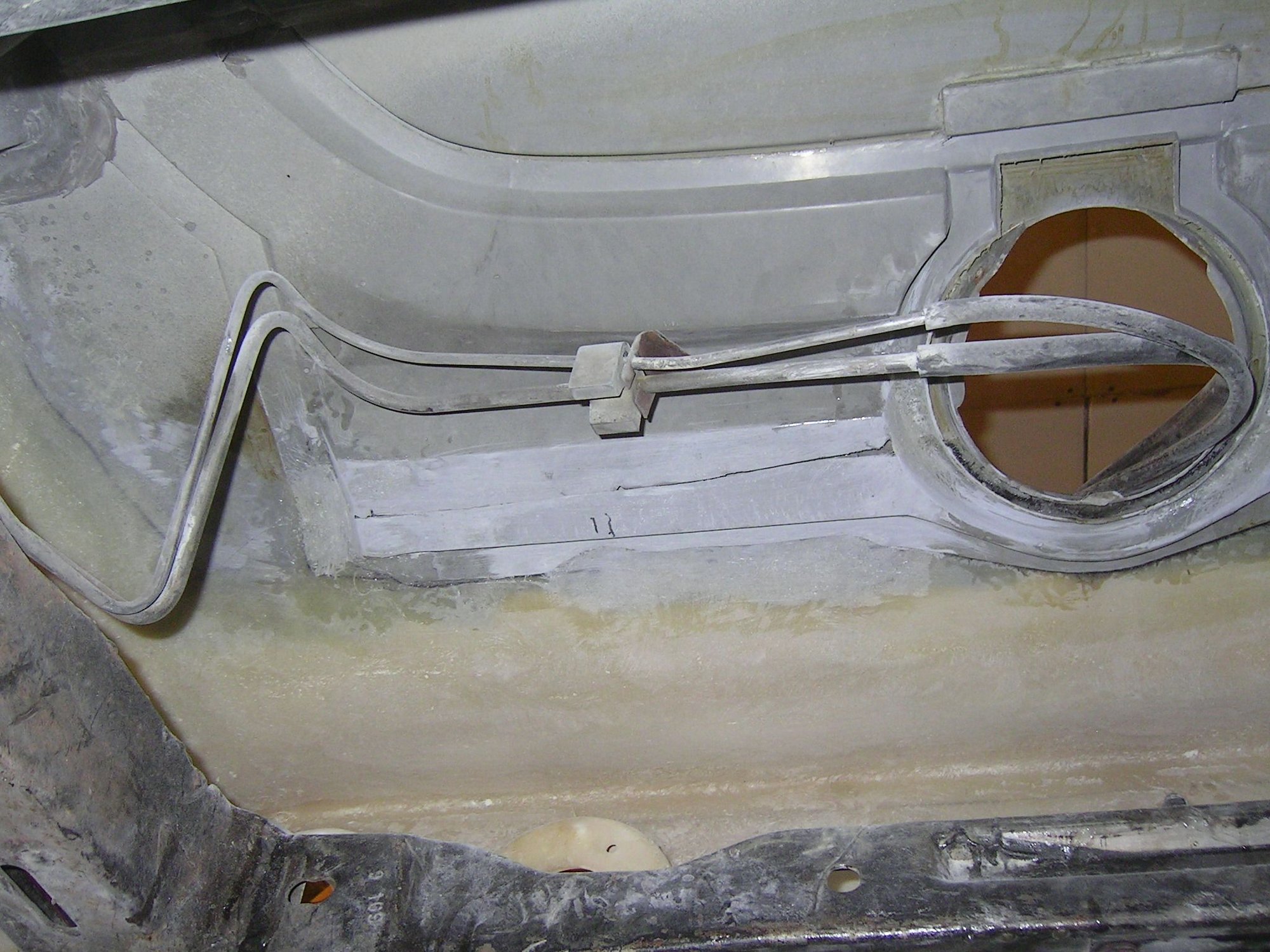

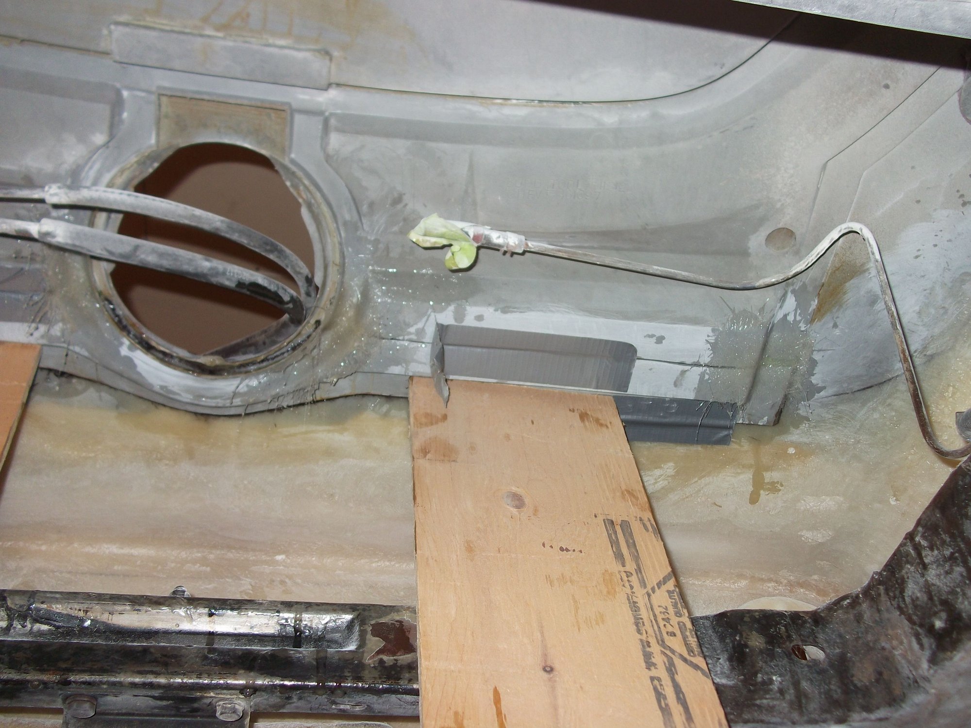

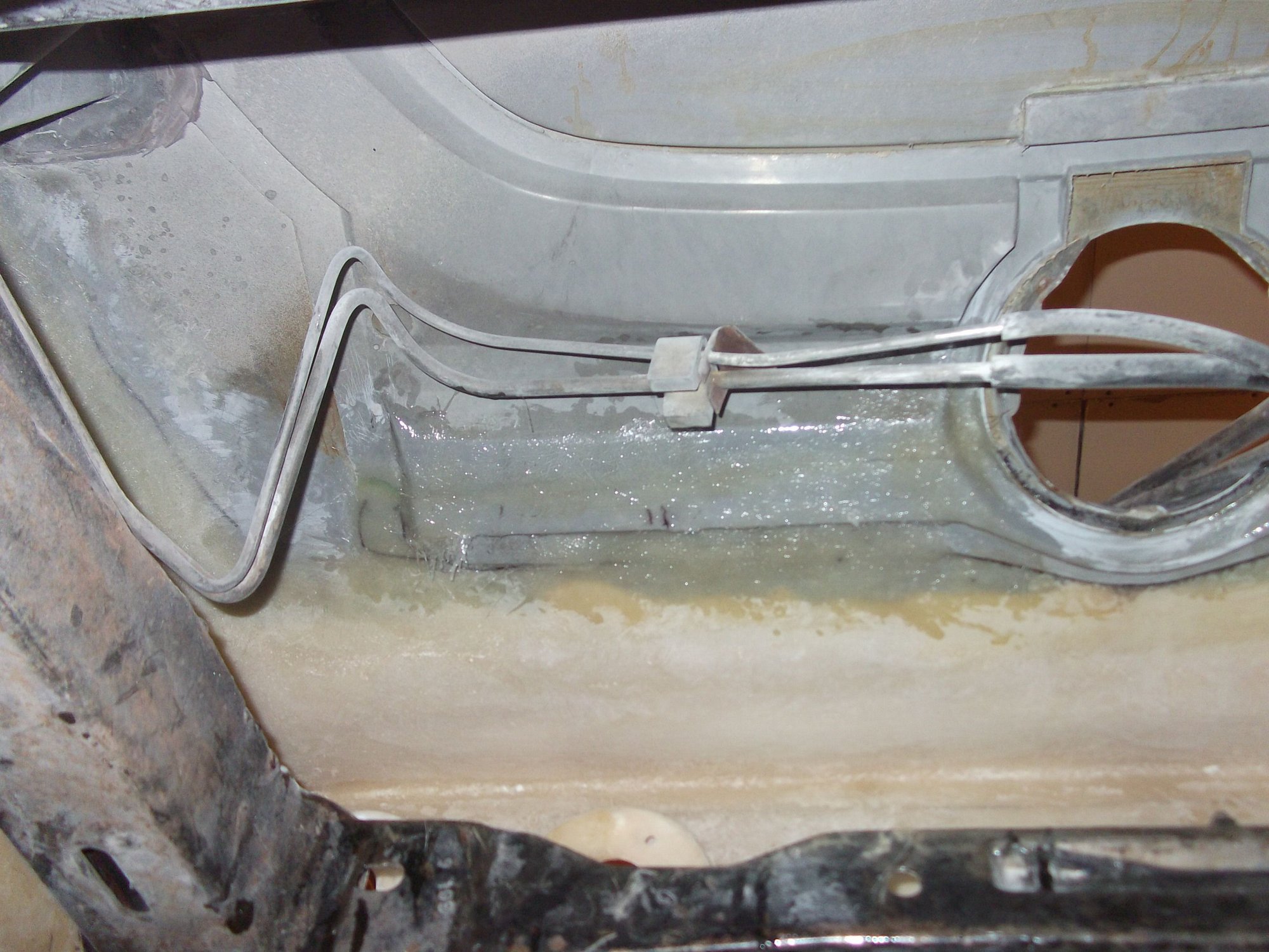

Today I cleaned up the laminating I did yesterday so I could finish the job off:
It turns out I didn't have my plywood pressed as tightly as I should have on this side of the reinforcement panel and it wasn't stuck to the upper deck in the area shown by the red rectangle:
So, I feathered out that edge so I could laminate on top of it:
And here's the lamination complete, just a little clean up needed:
This sanding in the gas tank area overhead while looking up is really nasty work! So hard on the eyes!

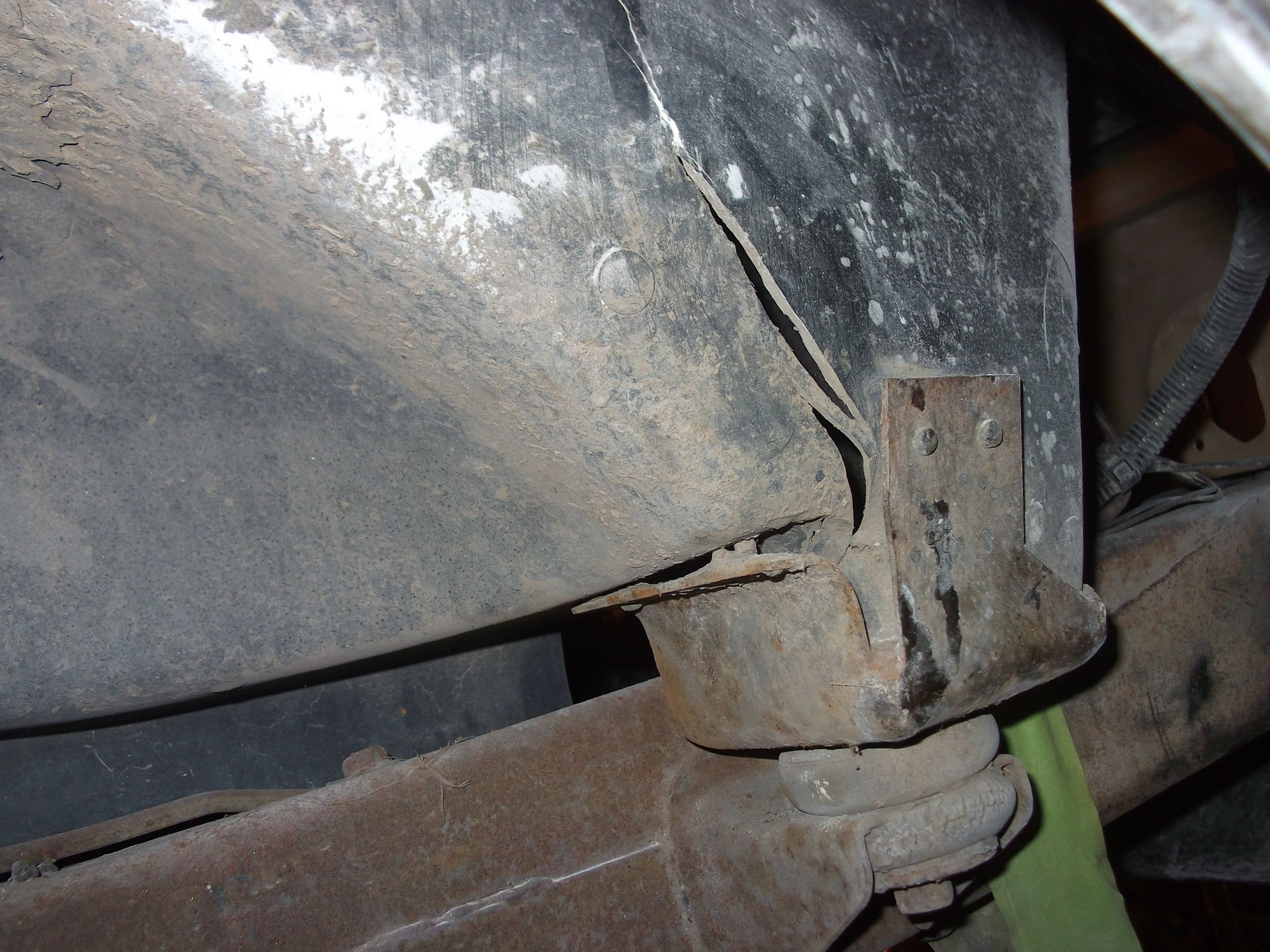

So, at some point I found this problem just behind the driver's side rear wheel well:
At this point, I don't have it in me to take the body off the frame so I'm going to repair this in place as best I can. Before starting I decided to remove the driver's side rear wheel only to find this:
No key was found in the car so I'm waiting for hubby to bring something home to deal with it. I've had the car since 2009 and I just find this out now. Good thing I never got a flat.
I pulled back the carpet in the rear of the driver's side and I see I have one bracket I need to remove to fix this. I used a cut-off wheel to remove the inner part of the two rivets and remove it. I also smoothed out the inside of the rivets from the metal cup that holds this body mounting point so I can fiberglass over the inside of the factory SMC.
I spent a few hours preparing the surface for glass, feathering the edges of the crack and so on:
While I was using the cut-off wheel to remove the rivets from the interior bracket I accidentally cut through the SMC at the blue arrow. No matter how good you think you are with power tools in close confines something like this always seems to bite you.
I obviously can't apply fiberglass on the outside of the body where the steel cup is for the body mount. Fortunately, on the inside of the car I can get entirely around the crack/hole and there is 2 inches of solid factory SMC to add the repair to. So, most of the feathering and sanding is happening inside the car and in theory I can get a satisfactory SMC repair if I can feather edge the edges of the SMC from inside. Its quite a challenge trying to feather the edges on the front of the hole that the body mounting bold sits in. I've been using a mirror and a die grinder and its gone reasonably well so far although its pretty awkward to do this kneeling where the driver's seat goes and leaning on the edge of the rear storage compartments area. I spent perhaps 2 hours sanding inside the car and afterwards my lower ribs on my left side were really sore from leaning on that edge. I decided to take today off as I'm still really sore and hopefully I'm healed enough tomorrow to take some more of this.
