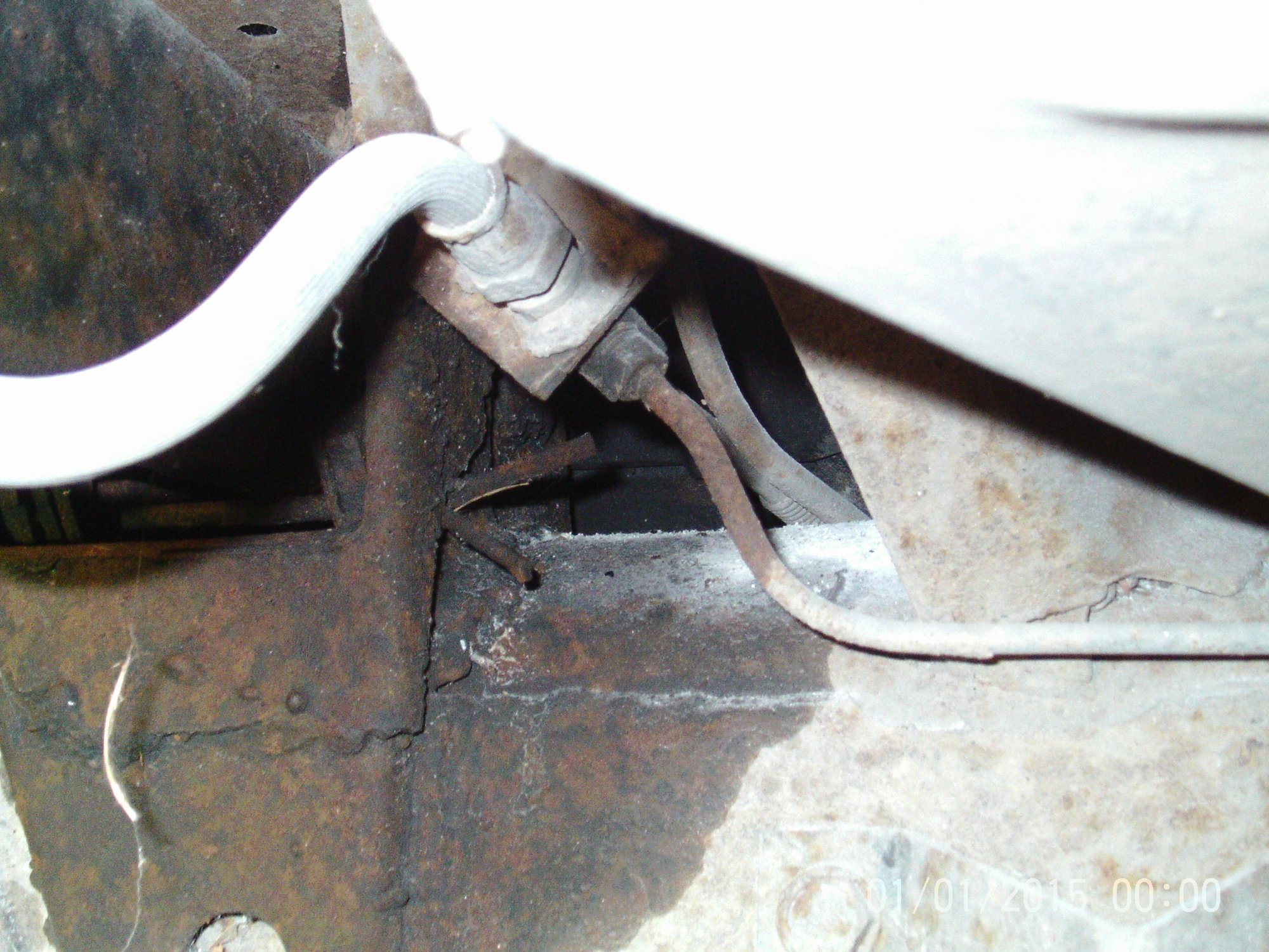

Ward asked me to remove the nut from the trailing arm bolt through the frame and to give a try and see if the bolt was seized in the bushing. I loosened the nut, but it looks impossible to get at the bolt end which is behind the brake lines in the picture below. Is it possible to get a wrench or socket on this bolt end without removing the brake lines and the brake line mounting bracket (which appears welded on)?

I see now it makes good sense for us to leave the trailing arm bushings until Ward is retired, then we can re-do all the brake lines that need to be removed to get at the trailing arm bolts. It doesn't cost much for brake line materials, its mostly labour to do it. It looks like a really torturous job to get at those trailing arm bolts.
