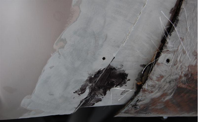

In rereading Josh's project thread (its been some time since I last did), he says he measured the width of the 82 rear at the rubber bumper flange and found where the width matched on the 69 rear and made his join there. That's what I was originally planning on doing and I'm leaning that direction now. What I don't understand is how he appears to have about 6 inches of the 69 rear clip whereas my 70-73 rear clip matches widths with the 79 at the 8 & 1/4 inch mark. Perhaps its the same and in Josh's picture it just looks shorter?

Priya, I am a little slow so is that a picture of your car or Josh's? The first picture lines up pretty good with the top edge. The bottom looks like it will lengthen the rear quarter just a little. Help me out here!

That's Josh's car. I should hope to have mine line up as well. Certainly my cut along the rear deck is much more ragged/uneven, so its not going to be as good as that. I hope to do better on the mating of the quarter panels though.

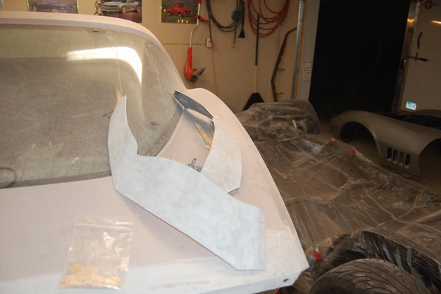

I did cut another inch or so off the 70-73 ACI rear clip yesterday, leaving the ACI rear clip at 8 & 1/4 " inches from the cut on the upper deck to the back of the ductail. While holding it up against the 79 it appears to be about ideal width to match. As I'm standing at the gas filler opening I couldn't get much of a look at the fit on the quarter panels but I shifted to the side as much as I could and still hold the ACI rear clip in place and it looked like the upper part of the quarter panels above the mid panel character line matched pretty well also. I couldn't see below that character line how the lower quarter panels matched up.
This weekend I'll have hubby hold up the ACI rear clip for me and see how things fit and where I'm going to go from there.
