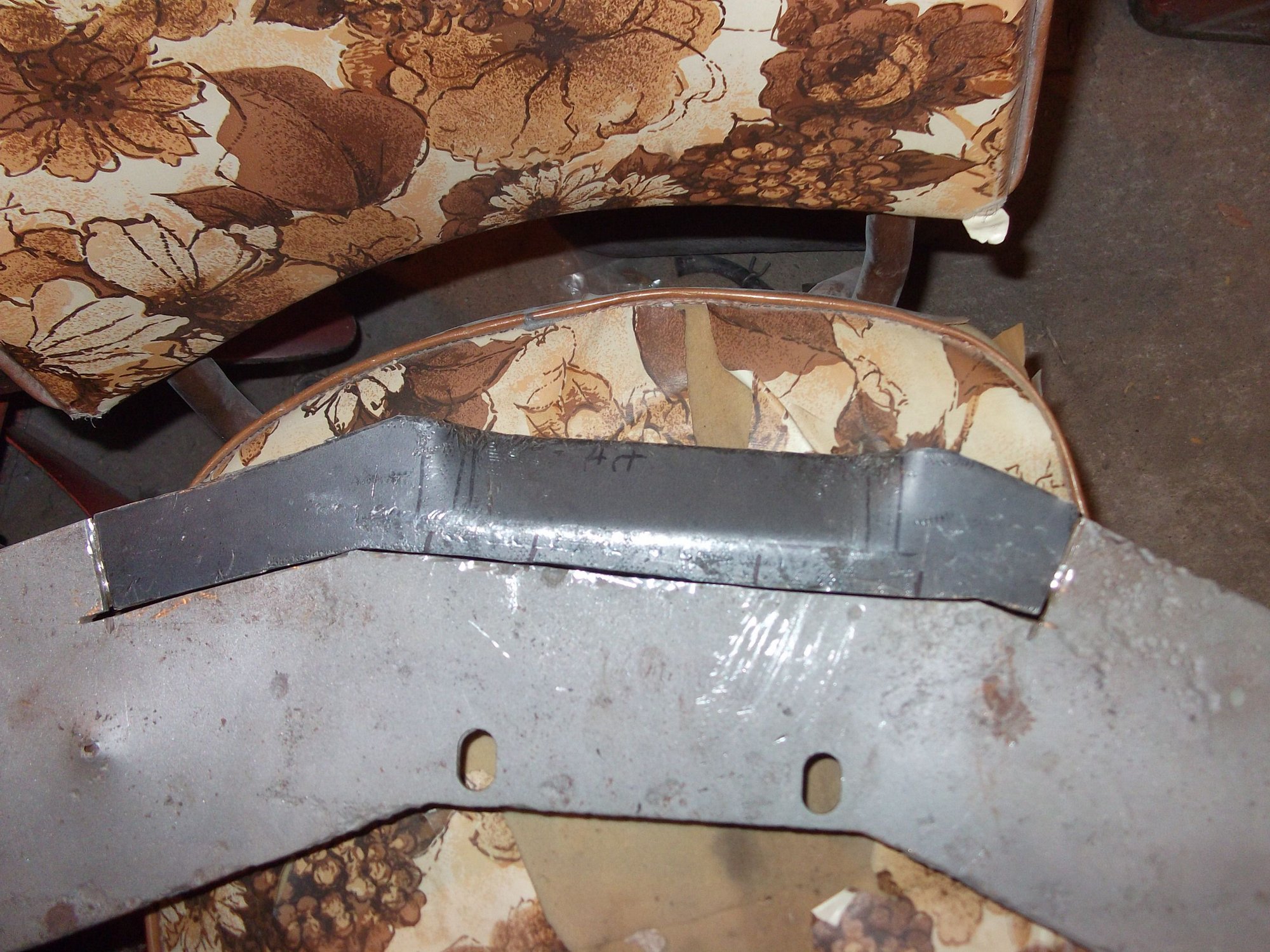

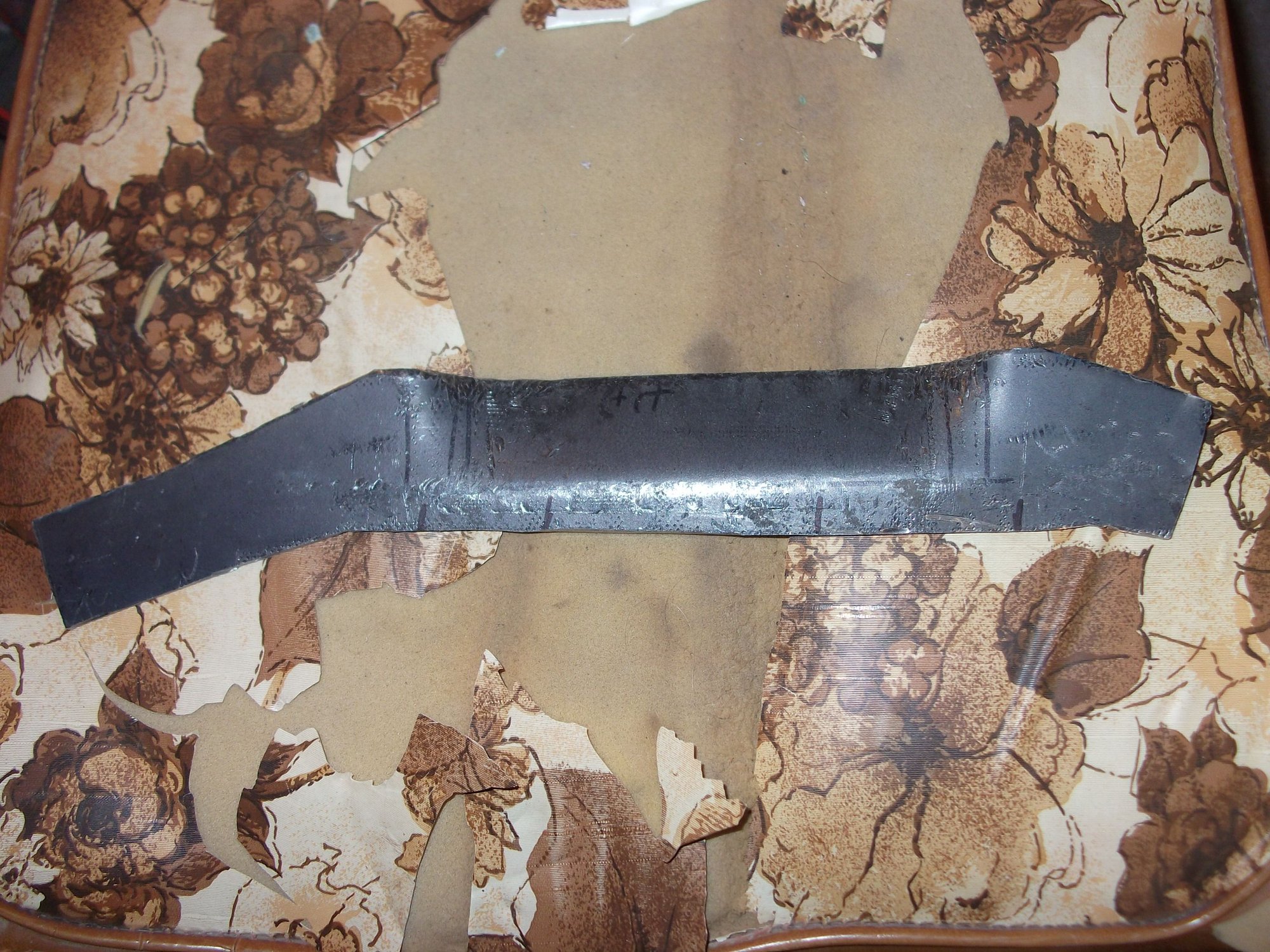

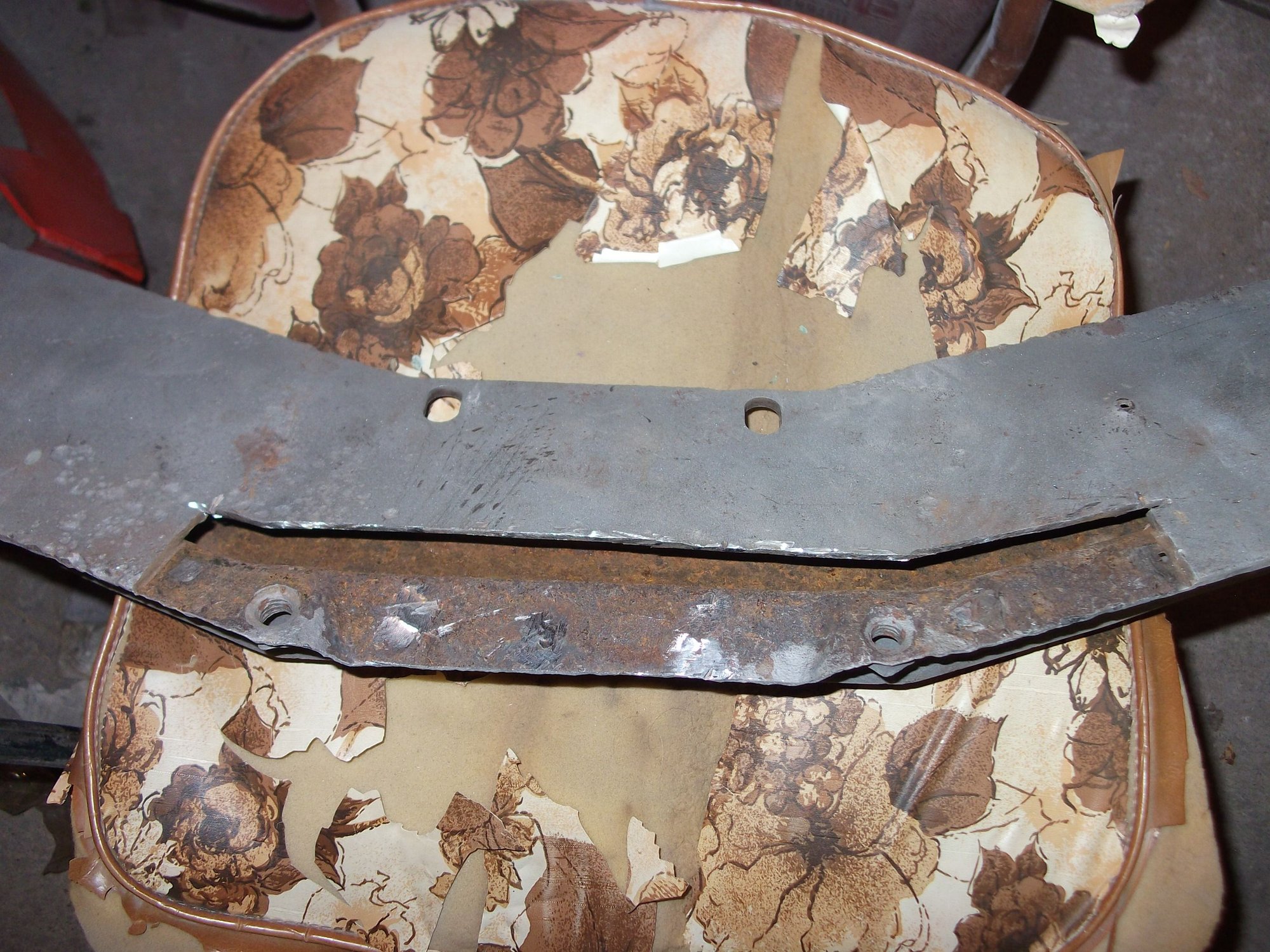

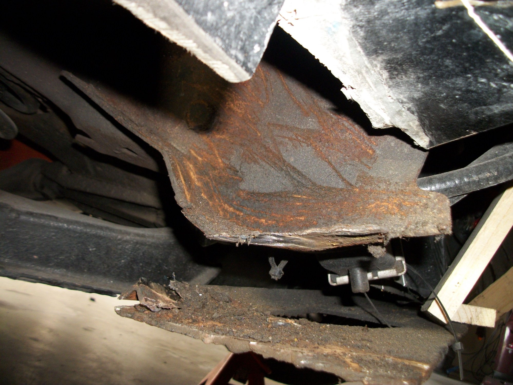

I completed some rust repairs on my 68 front bumper crossmember today.
This is after I cut out one of the rusted areas
Here's the repair piece I made. Hubby said he was impressed I didn't use any heat to get it into shape:
Not a perfect fit, but good enough for something like this.
And here it is all finished. I also replaced part of the edge in the upper right side of the picture:

Nice work Priya.
Did you weld those pieces together? Hard to tell.

Originally Posted by bmans vette
Nice work Priya.
Txs
Dennis
Yes, I welded them together. The horizontal line just in from the edge is welded in, it just looks like it isn't welded there because when I ground the weld that part of the repair was below the level of the surrounding metal as I didn't bend the patch perfectly.
Perhaps this picture shows better:

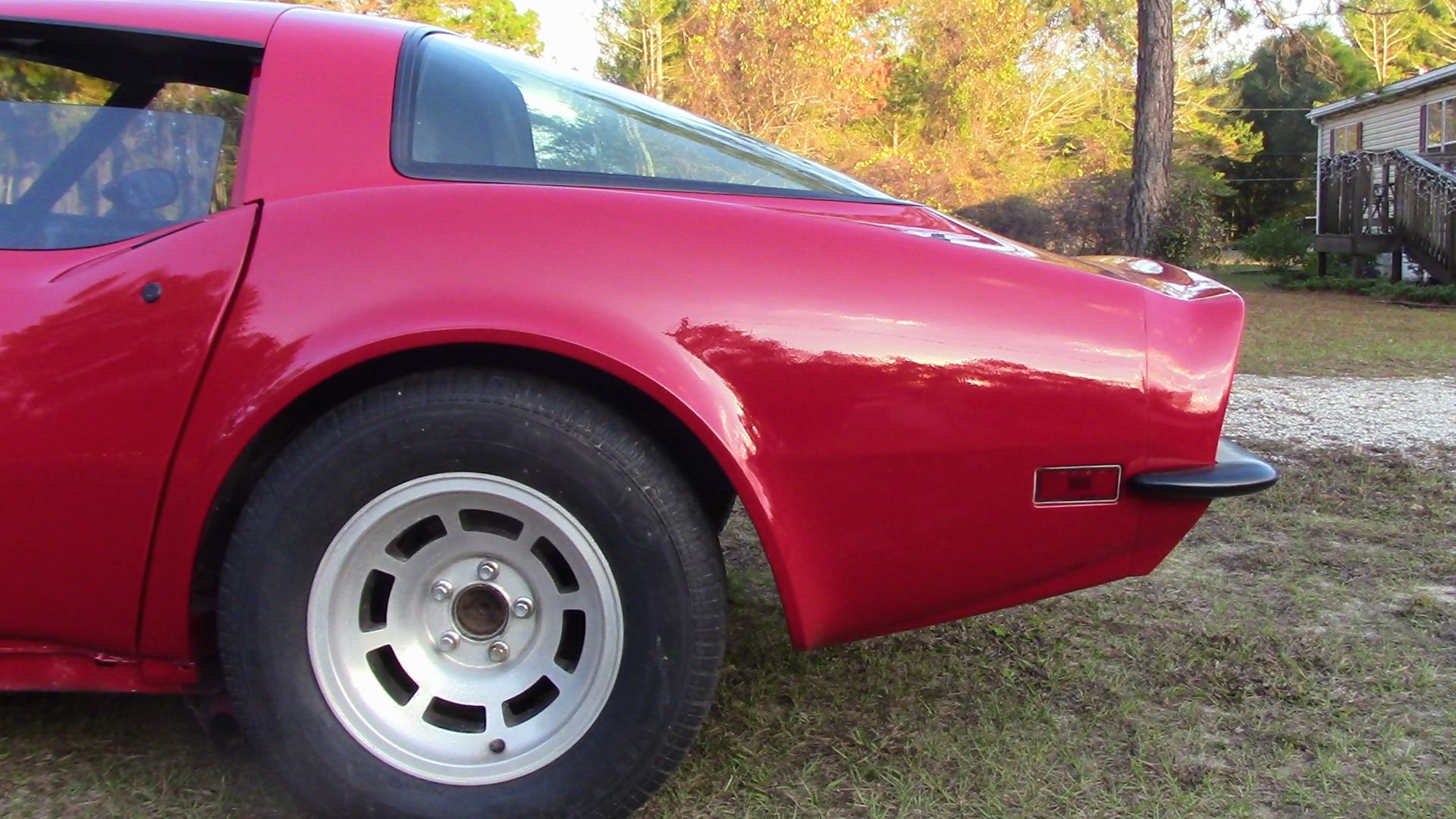

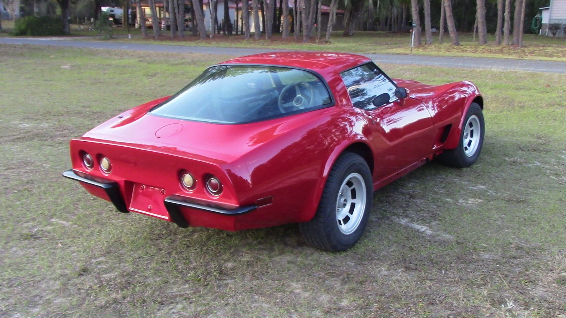

maybe these will help a little in the mock up

That sure looks sweet dtamustang!
Now I just have to try to imagine how it would look 2 inches longer.

Thanks Priya , it took a lot of work getting it looking like that , so i feel your pain and can appreciate what you are going through. someone on here must be good with photoshop and can stretch the right part of the picture to see what it would look like . I have to say though , when i was doing this one it didn't take much deviation for it to start looking exaggerated and almost cartoonish

Hi dtam,
Since the bumpers on your car are lower, relative to the body contours, I'm curious what you did with the taillight location and the license bezel location?
Regards,
Alan

Alan , here is a shot of the rear. the bumpers are at the same location as a chrome car. the shape and lay out of the rear was a 71 donor rear end. the only significant change from a chrome car is the lower corners where the rubber cars narrow up quite a bit. the bumpers on my car are significantly shorter than the original steel bumpers on the side due to the marker light being higher on the rubber cars. i hope that helps

Hi dtam,
Thanks!
Car looks good from that angle!!!!

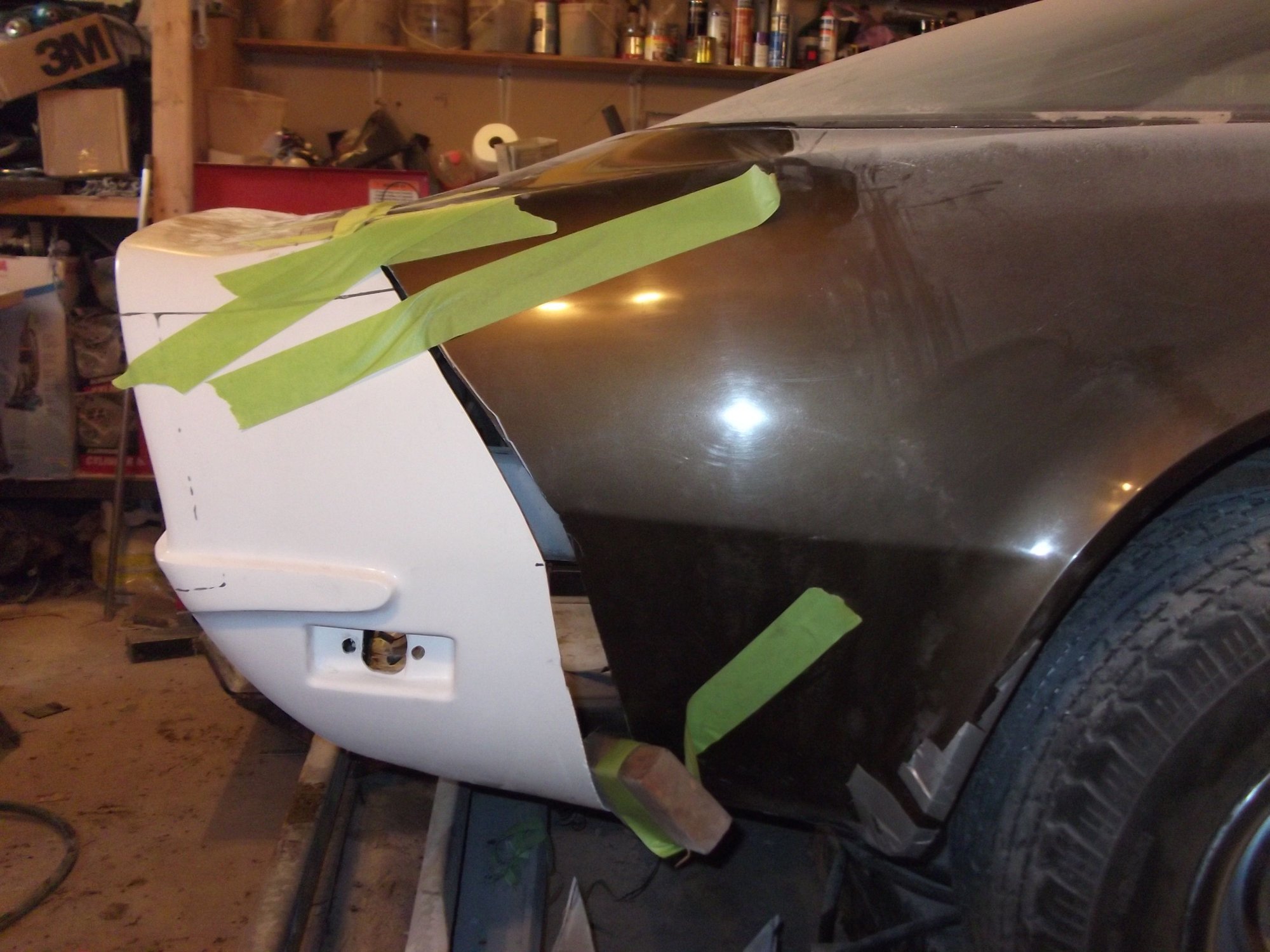

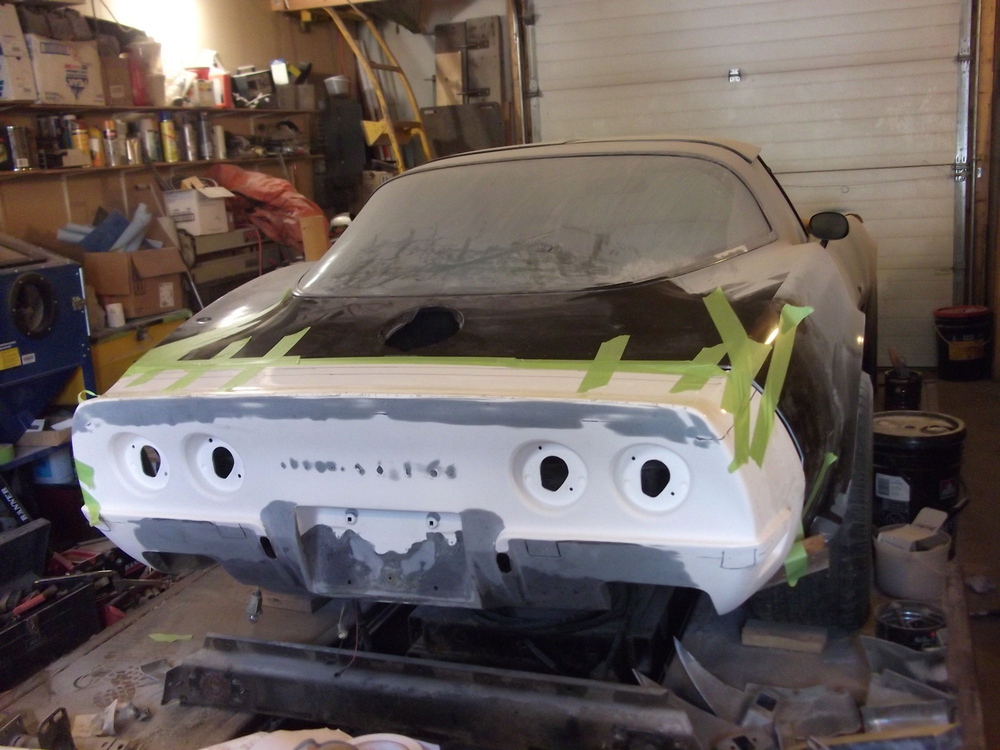

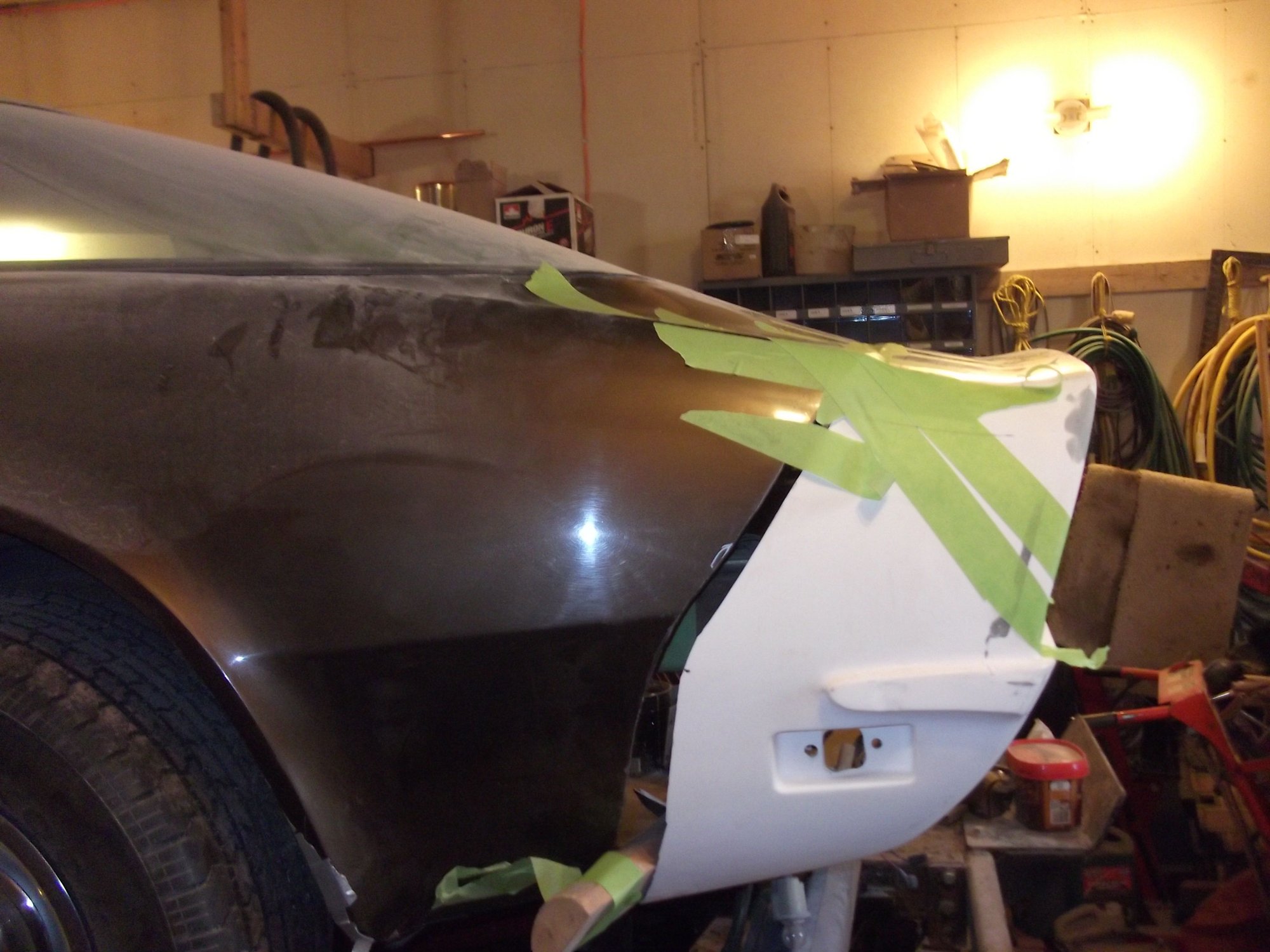

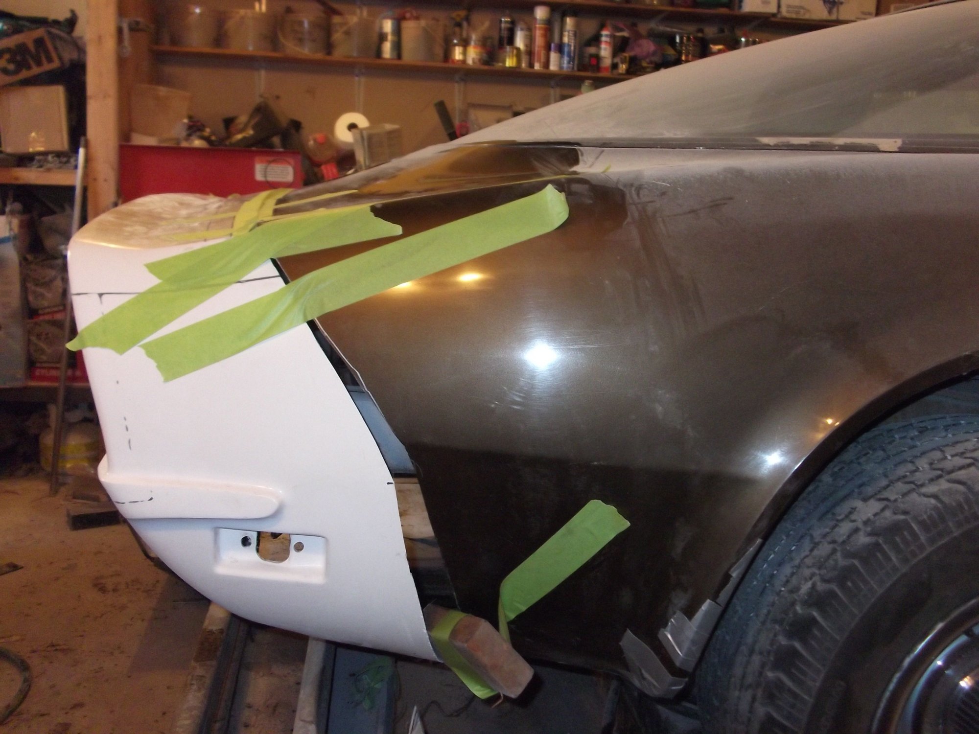

Yeah...so this is a disaster...
Apparently Josh is magic because this fit he got of a 69 rear on his 80 makes it look pretty straightforward. Unfortunately mine doesn't fit remotely that well
Here's the "fit" on mine:
I think being a couple of inches longer than a factory 68-72 is the least of my worries. For starters I cut too much off the lower quarters on the 79 although that perhaps doesn't matter as the lower quarter on the 79 is so much narrower than the 70-73 rear clip lower quarter I'll have to fabricate the entire lower quarter panel from the flare on the 79 back and perhaps redo the lower quarter on the ACI 70-73 rear clip as well. And the deck area matches poorly as well. It isn't readily apparent in the pictures, but when the corners where the quarter panels meet the deck on the 70-73 rear clip are matched up with the corners on the 79 the rear deck on the 70-73 rear clip is about 1/2 inch higher at the fuel filler opening. Although these aren't very good pictures to judge with, based on them I don't think the couple of extra inches of length matters to the appearance.
Its going to take a lot of thinking to come up with an approach to this. This is going to take waaaaayyyyy more work than I thought to get this done.
