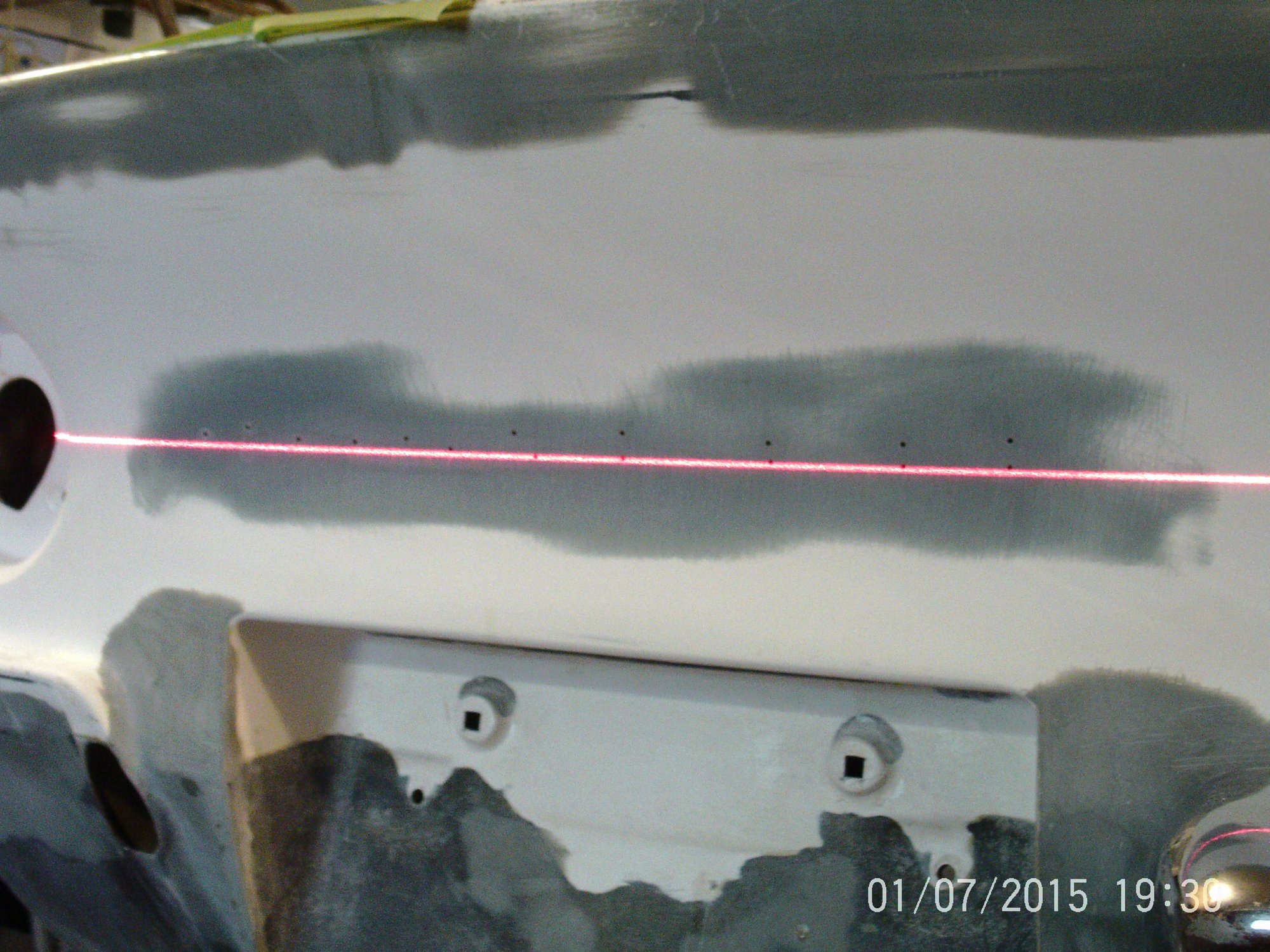

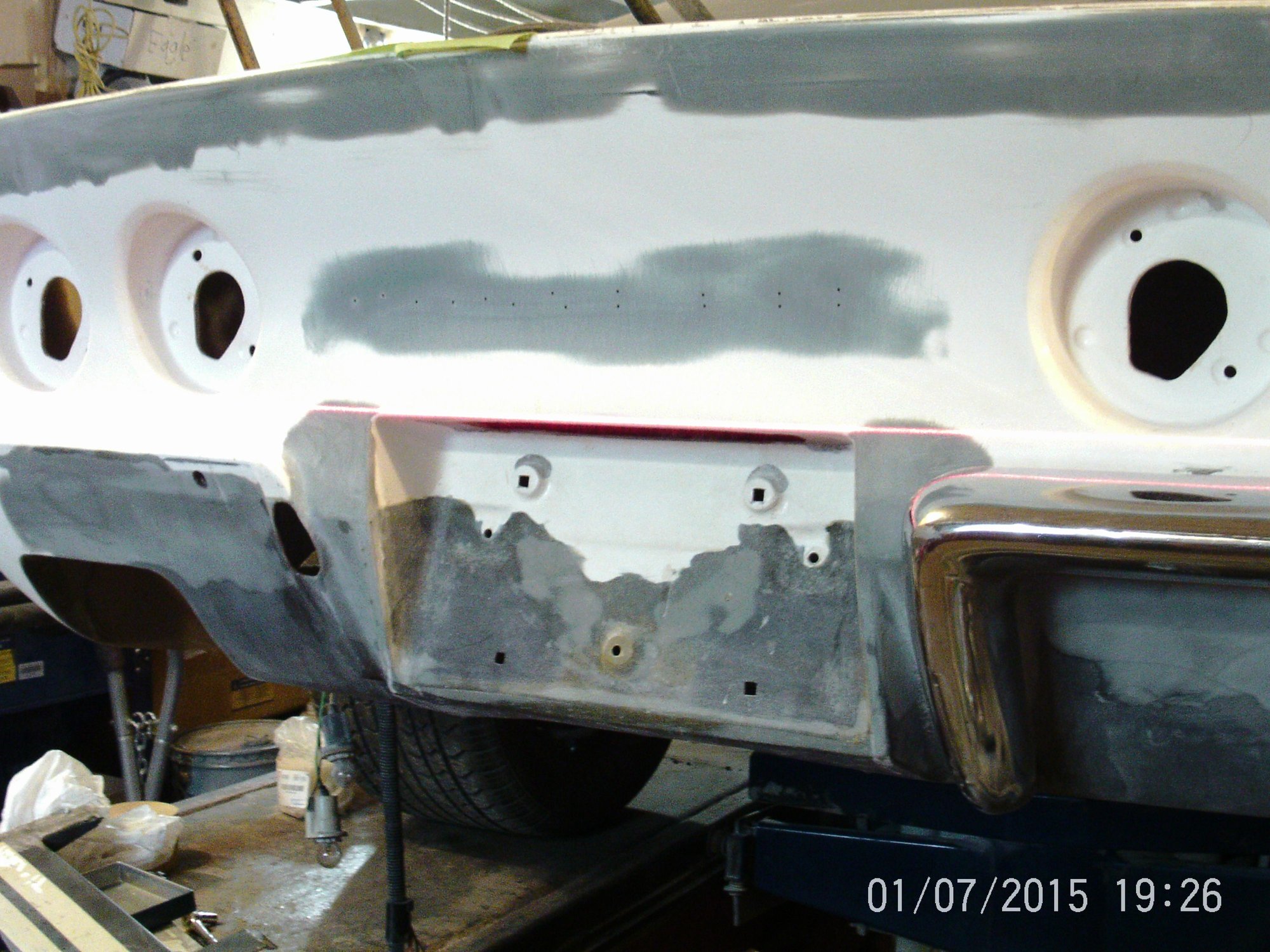

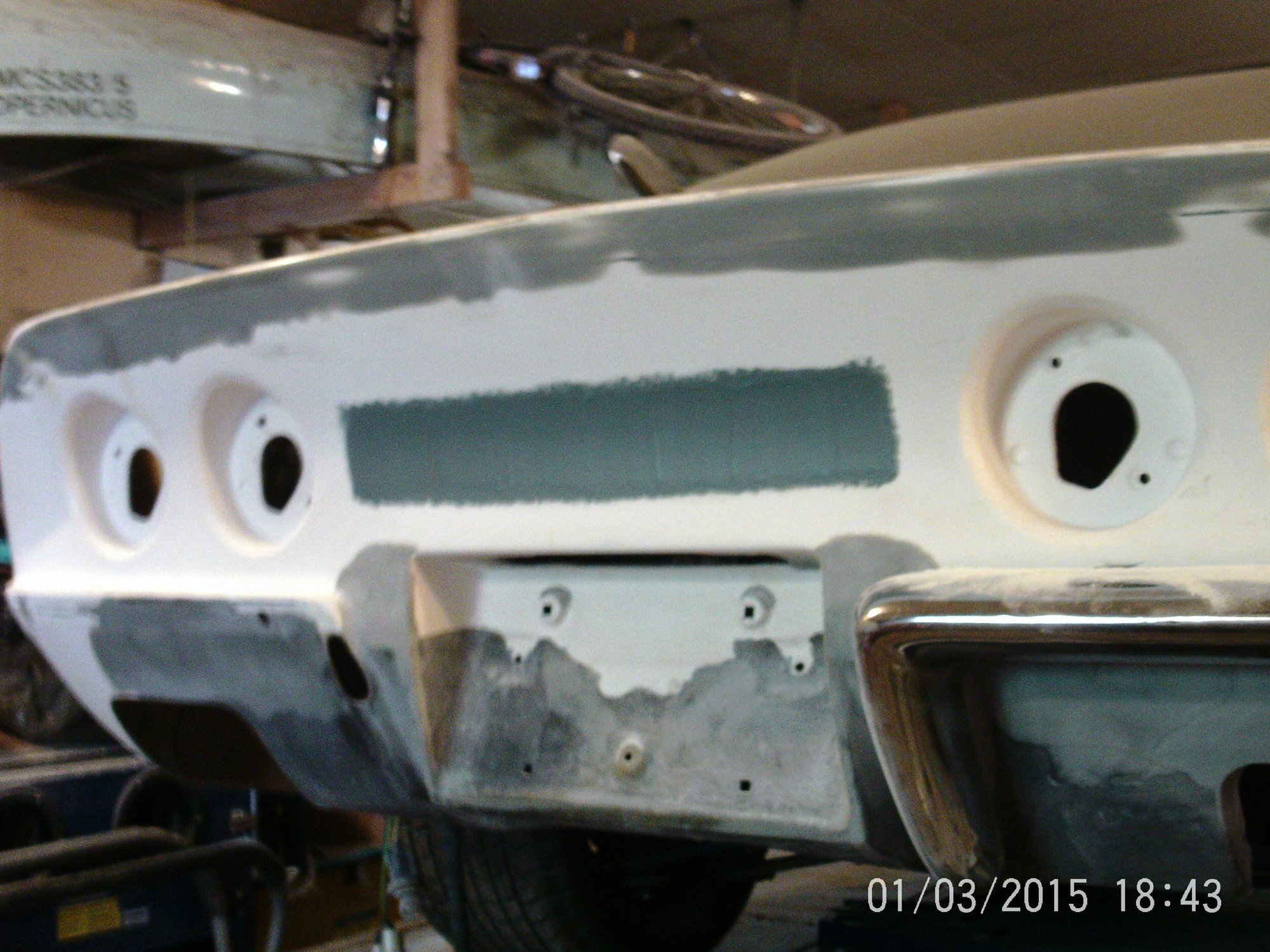

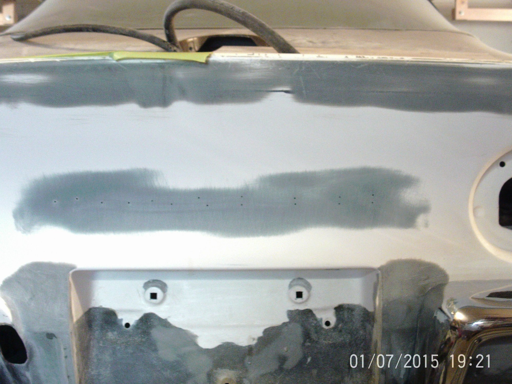

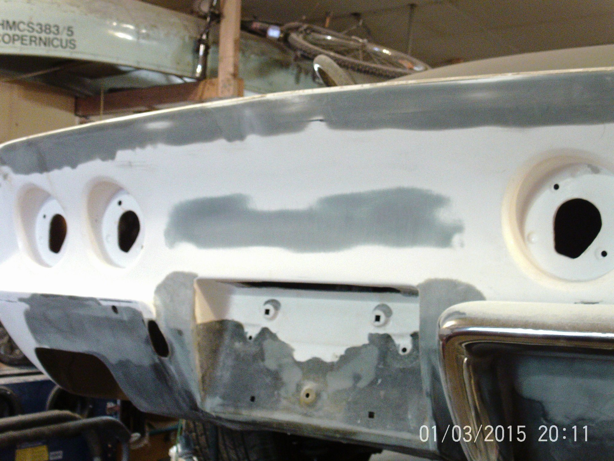

I filled in the letter holes on the tail light panel and thought I'd give it another go. I still have a scrap piece of tail light panel Dub sent me fortunately (the holes in it are a bit sloppy) I made a paper template and taped it to the tail light panel and took a drill directly to that. The last two times I re-did the letter holes I made a paper template from the scrap tail light panel, cut holes in the paper where the dots were and then used that to draw points on the tail light panel and drilled those. I figured by drilling directly through the paper into the tail light panel I'd save one transcription and one more chance for position error to creep in.
As soon as I started to drill the first hole I realized my eyesight isn't really good enough any more to do the best job on this. I had my glasses on but I got them about 14 years ago and its time for a new pair. I was eager to get this done so I continued and drilled all the holes and then immediately thought this wasn't a good idea. I know the two holes on the "T"s and "E"s are one right above the other and I could see it was a bit off and the heights looked different too. So I was feeling stupid for not asking Ward for new glasses before trying again. I used my smallest drill bit so I can adjust the hole positions a bit when I make them big enough for the letter pins to go through. I went in the house and told Ward I didn't want to continue with the letters without new glasses and he agreed to buy them for me . I'm really looking forward to getting them, I haven't been able to read an actual book for a few years although the computer isn't a problem.
Ward brought home his laser level and I decided to level the car and give it a try. I set the level up and to my surprise the car was perfectly level as it sat:
I moved the level up to the holes for the letter and was pretty surprised to see the holes for the last four letters almost perfectly level, close enough anyway that when I enlarge them I can get them at exactly the same height. The first four letters the laser level won't be a big help with because each letter is different. I'm encouraged at this point that I'm going to finally be done with these letters, I had been thinking I was going to fill in the holes and re-drill for a fifth time.
So I learned you just can't trust your eyes on this sort of thing, the heights of the last four letters all looked way off to my naked eye. The laser level is going to be a big help in getting this right. Earlier this evening I went to the optometrist, had the eye test and picked out some frames. They say I'll have my new glasses in 8 to 10 business days, I can't wait! I was hoping to get them in a couple of days so I could get back to the lettering, but I guess I'll have to work on getting the right shape on the quarter panels for now, they're pretty crude right now.

Thanks everyone! I think the laser level is going to be a big important help on this. Without it I was sure the height of those last four letters was all over the place and if I'd have proceeded without the laser level I'd have adjusted the "T"s and "E"s way too far up and down when they don't need to move up or down barely at all.
I'll get the "C O R V" letters straight as I can first by enlarging the holes and then I can move the "E T T E" up and down quite a bit to match without them showing the holes behind the letters. [Edit 2020-10-31] the "E T T E" letters can only be moved significantly upwards without showing by elongating the holes, they can be moved down very little before the top hole shows]
I don't know if I mentioned it earlier, but the last set of holes I had for the letters the right side of the name was 1/8" or more lower than the left side. It was pretty noticeable to me. I'm clearly a lot closer than that now.

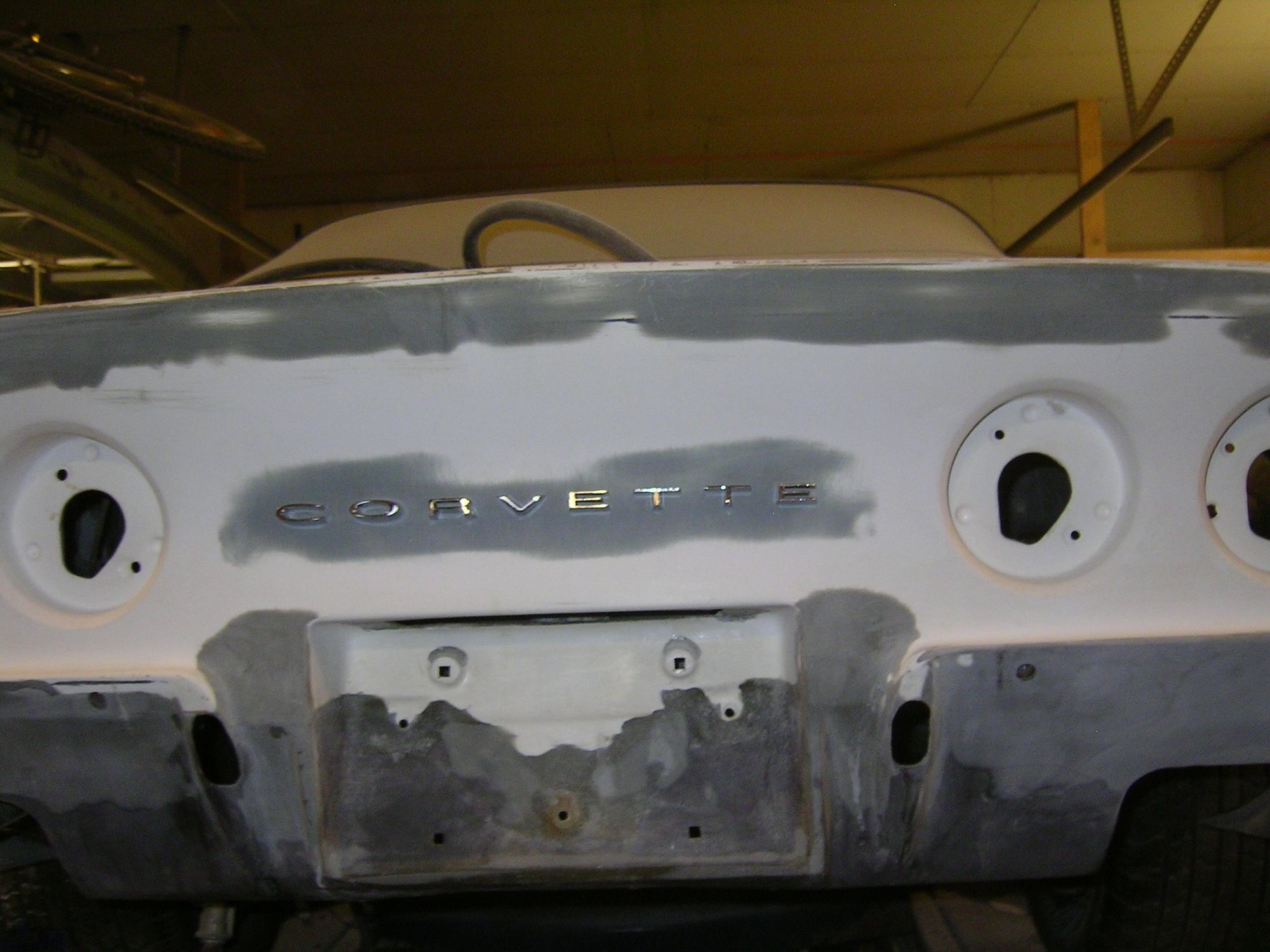

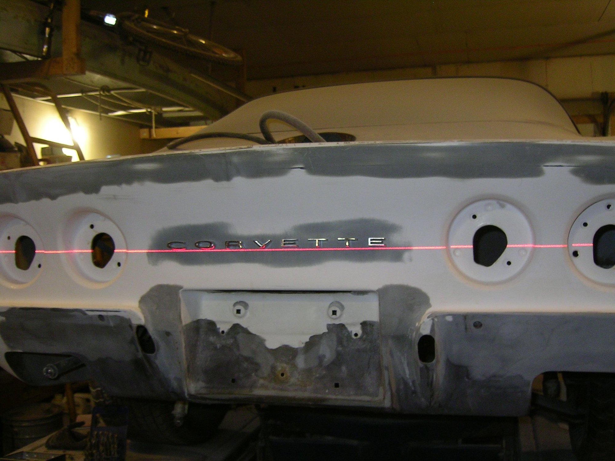

I got my new glasses on Friday so I had at the C O R V E T T E letters on the tail light panel again. You can only move the holes so much before the letters won't cover them any more. I might lower that first "E" a bit yet but all in all I'm happy with them this time. The laser level was a huge help!

It looks great from here...
dont worry about the EEEEEEEEE...it's fine !
The lazer light is a little bit crooked under the E.

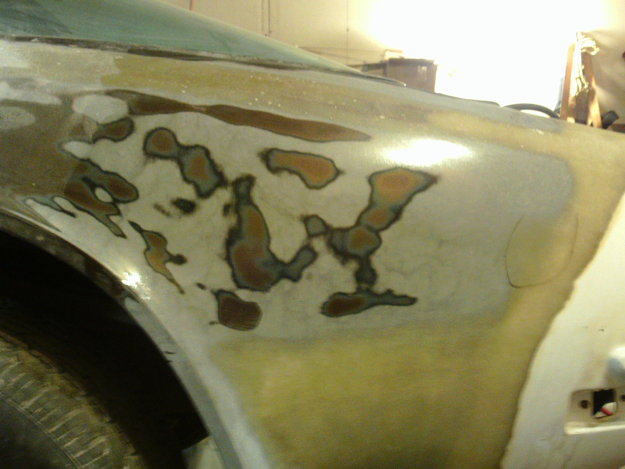

I spent a bit of time trying to get the quarter panels in better shape. I block sanded the driver's side with 80 grit and was disappointed to find how wavy the previous owners made the body when they painted it. It sure looks like they sanded it down with bare hands given all the low spots (I sprayed the panel with water just before taking this picture):
As I want to minimize how much of the original SMC I sand off I'm now not quite sure how to proceed. I could continue to bock sand with 80 grit until the spots of old paint are gone, but that will thin out the panel all over. Alternatively I figured I could at this point take some 80 grit to the remaining paint spots and sand them out by hand, then rough up the whole panel a bit with 80 grit, apply vette panel adhesive/filler over the entire quarter panel and then block sand until the SMC starts to show through again.
