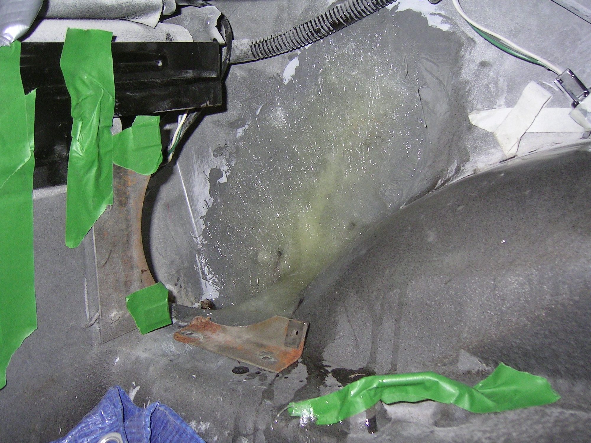

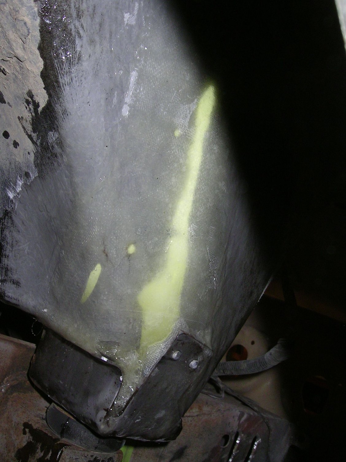

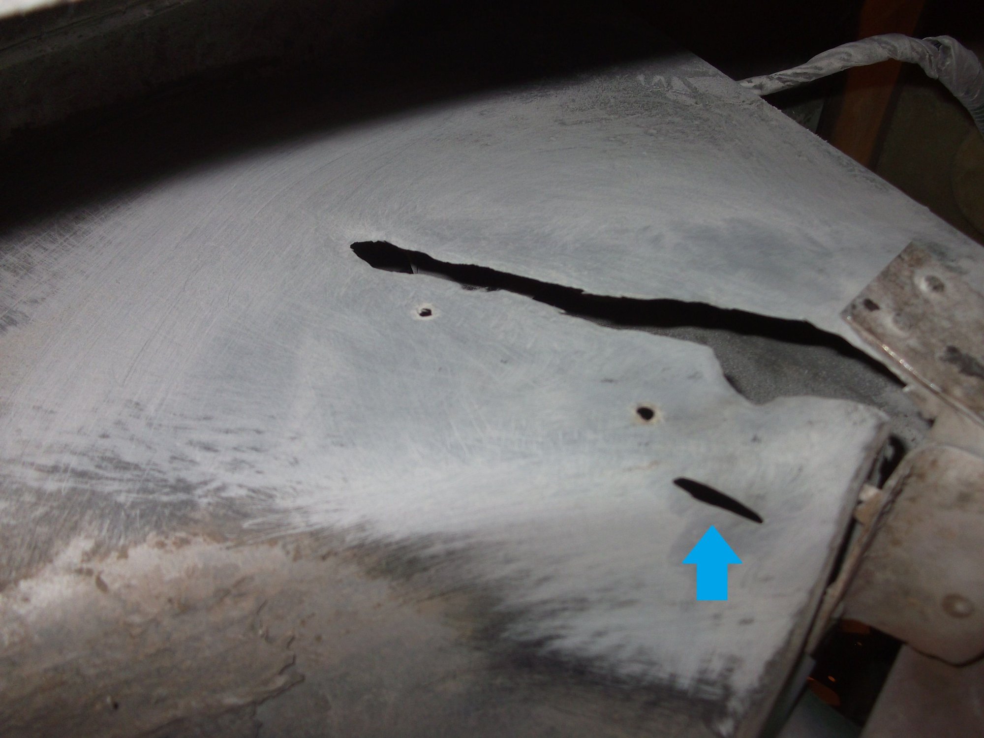

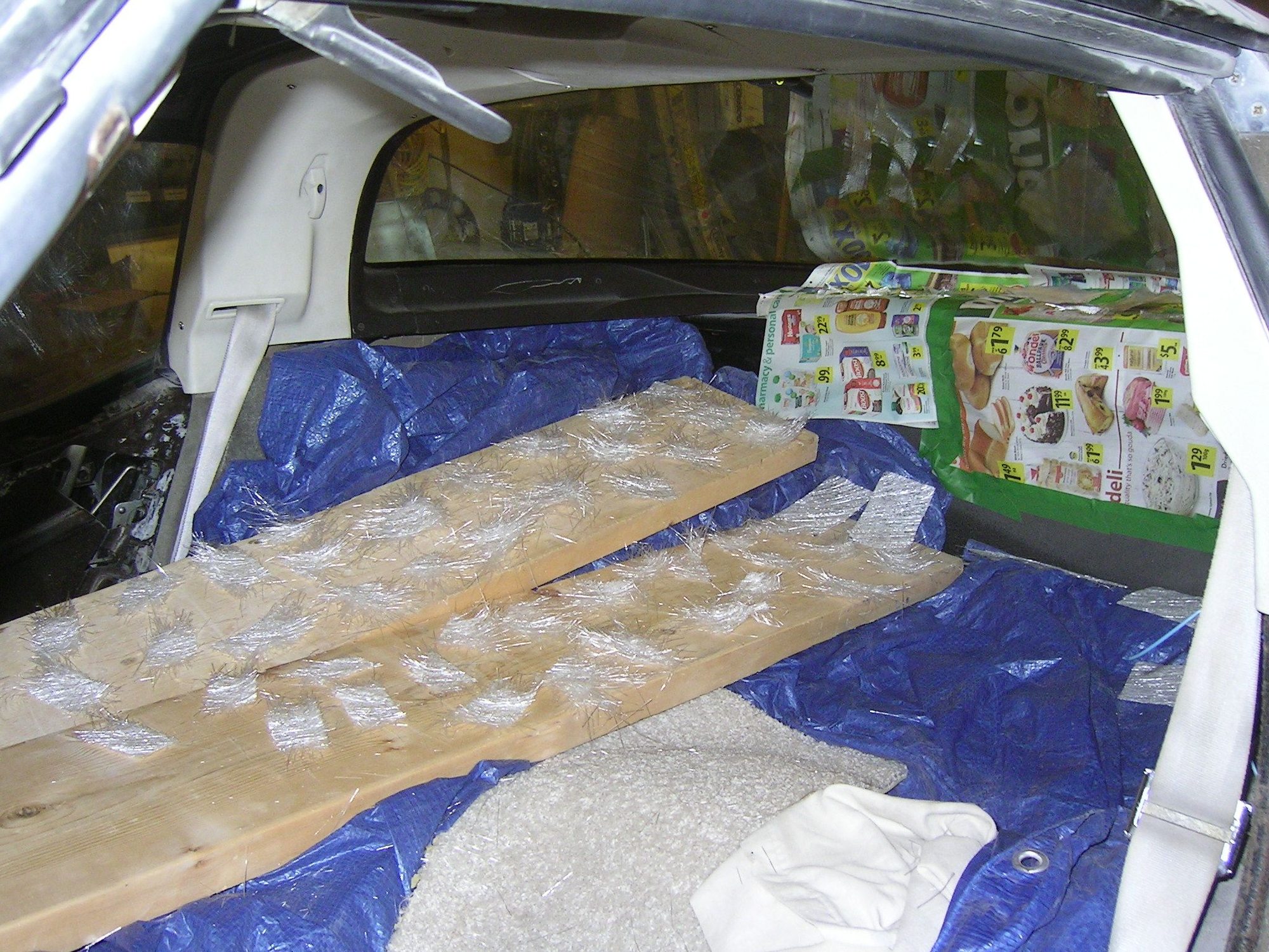

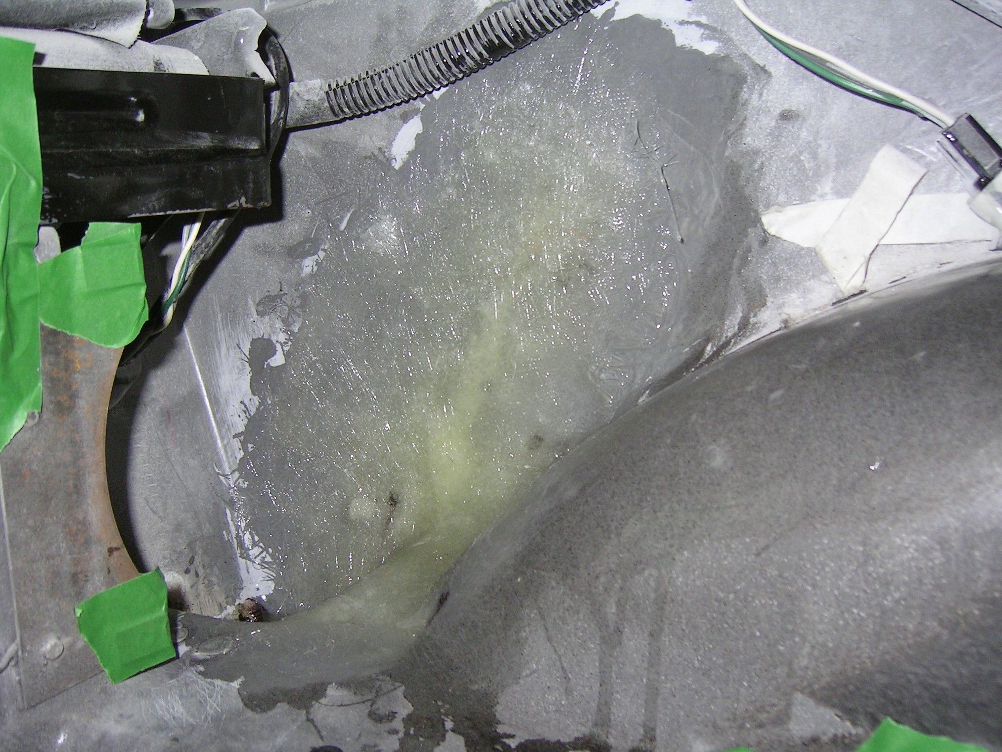

I got my body mount repair done. I know its not a proper repair but I'm confident its going to last for my lifetime and probably beyond. It took me a couple of hours to lay thing out in advance to be ready to do the laminating. I wanted to get it all done in one shot so I didn't have to come back and re-sand to get adhesion plus this way with wet fiberglass on both sides of the hole the two sides have a chemical bond rather than just a mechanical bond. I didn't take the whole interior carpet out so I laid down a tarp. To the best of my knowledge I didn't get any resin anywhere it shouldn't be:
So, the damage went from this:
To this:
And from this:
To this:

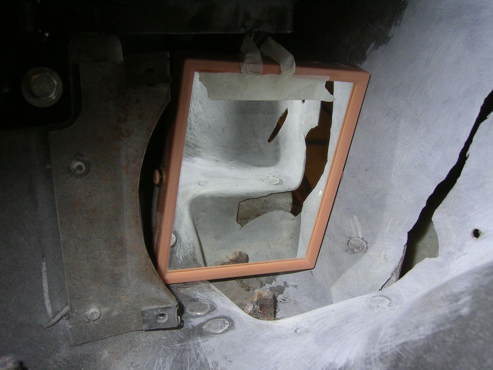

All I have left to do is reattach this interior trim bracket:
If I can get pop-rivets big enough I'll pop-rivet it back in place. I can tell where the original holes are by shining a light through from the interior:
Old Aug 27, 2020 | 08:15 PM
  #1444
7t9l82's Avatar
7t9l82
Joined: Oct 2010
Posts: 6,938
Likes: 848
From: melbourne florida
I think it looks perfectly fine. Job well done.

Thanks Roger! It was a bit of a struggle to do because laying on that rear ledge inside the car overworked various back and torso muscles and bruised my ribs. At times it was really painful to get up or cough but I seem to be mostly over it now.

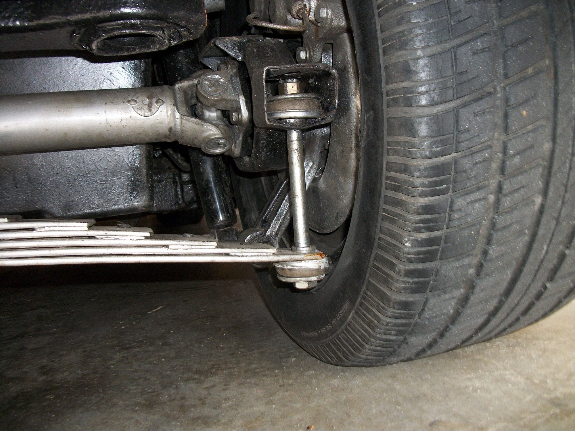

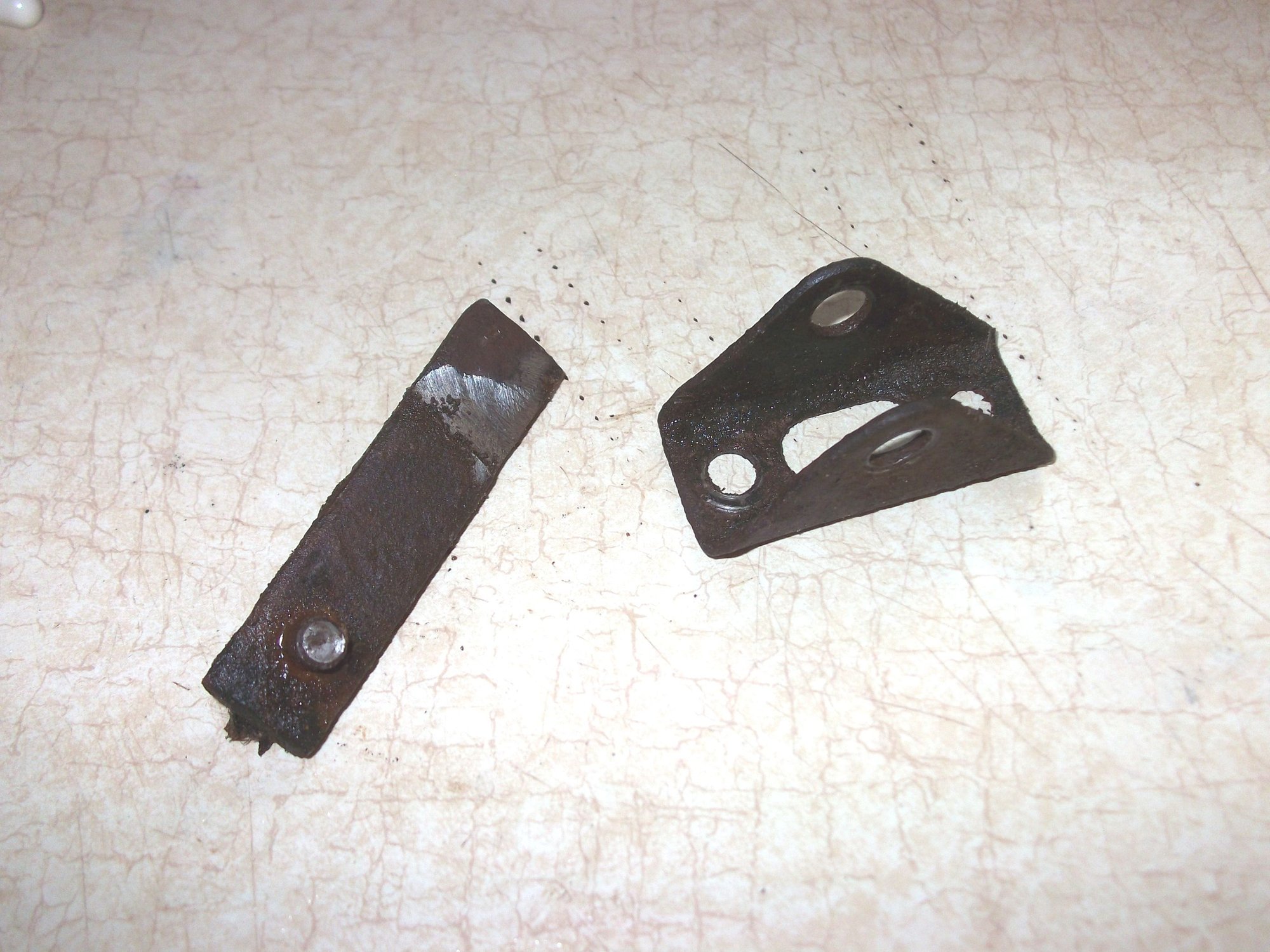

I decided while the gas tank is out the next job I'm going to do is to install the Hyperco 200 lb Easy Ride fiberglass spring I bought years ago and replace the U-joints on the half shafts. I was unclear on the spring removal/installation so I got some advice here:
https://www.corvetteforum.com/forums...tallation.html
I had at the rear sway bar and it must have been on there since '79 as it put up quite a fight. I got one bolt to come out the way it should, one I had to cut off and four that broke when I tried to remove them. The little plate in the picture below didn't want to come out of the housing for the spring bolt after the two bolts broke off so I had to use a cut-off wheel on the front stub of the broken bolt and then managed to wiggle it out. Along the way I smashed one of my fingers pretty good and its swelling up now - it hurts to type!
I don't think I'm going to re-install the rear sway bar and I will probably remove the front one too as I'm looking for the softest ride I can get.
