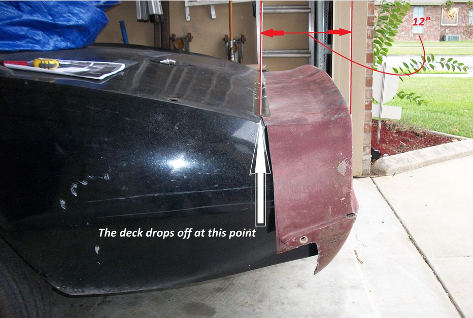

In going through Doorgunner's thread again,if I've got it right, it appears that after he took the picture above he cut another 4" off the black rear of his 69 from where the rubber bumper would have mated to the rear clip. If I were to add another four inches to the aprox 8 & 5/8 of where I thought the ideal cut would be on my 70-73 ACI rear clip we'd be in about the same place though I still can't reconcile that with the picture of the 69 rear clip on the bubble back corvette I posted in the picture above which appears to be more around the 5 or 6 inch length.

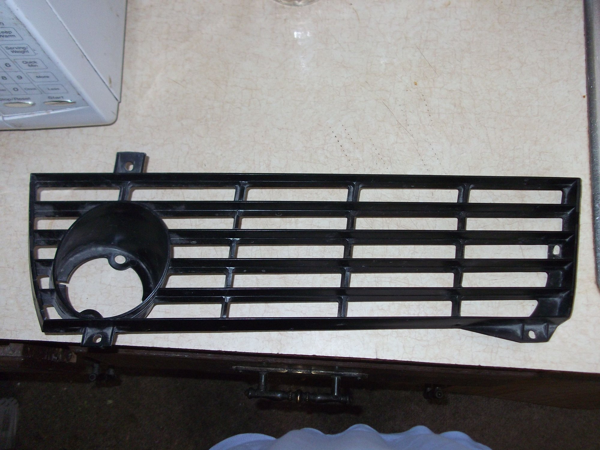

I received a nice part in the mail today.
OEM grill in close to like new condition. I got it for about $15 or $20 Cdn less than a new reproduction piece and found it in Canada so shipping was less than if it would have been coming out of the States. My estimated costs to complete the project are a little more than the amount of money I have left so I'm taking my time and trying to find bargains wherever possible.

Well, I just came back from the garage and checked my width measurements very carefully. The width of the 79 rear and the width of the ACI rear match at 8 & 1/2 inches from the ducktail. The cut I currently have in the ACI clip is at the 9 & 1/2 inch mark and when I hold it up to the 79 rear it is a bit too wide. I just don't know what to make of this given the length on a chrome bumper car from door to ducktail says I should need around 6" of the ACI rear clip and the picture of the 69 rear on Josh's 82 seems to show about 6" as well.
Tomorrow I'll cut another inch off my ACI rear clip and hold it up to the 79 and see how it fits.

as always , this is just an opinion. i think you are going to have to do quite a bit of filling and fairing in the upper corner areas to get them looking right , the reason i say that is , if you get the tail section to fit with minimal filler in the top corners ( line up the measurements of the tail with the measurements on the body ) the rear of the car is going to look stretched out or way too long in the back. after a lot of fooling around i just went with the rear of the door opening measurement to get the duck tail in the right location. once that is located and looking right , everything else will be where it winds up being. again , in my opinion , get it looking like you want it to look from the side , the duck tail at the proper angle, the tail of the car proportional and let the seams fall where they may. fill and fair as needed

I discussed with my husband and he felt that a couple of inches longer wouldn't be noticeable plus at six inches there'll be no room at all for any of the 79 crash bar but with a couple more inches I might fit part of it in. I think what I'm going to do is take another inch out of it so the width is the same trim the quarter panels to match as close as possible, temporarily mount it in place and see how it looks then and how it looks like the bumper brackets will go and then decide if I want to take more out of the ACI rear clip.
I guess what I don't understand is how on Josh's car the width of the 69 clip he used seems to match perfectly with the width of the rear of his 82 and he only seems to have used around six inches of the 69 rear clip.
