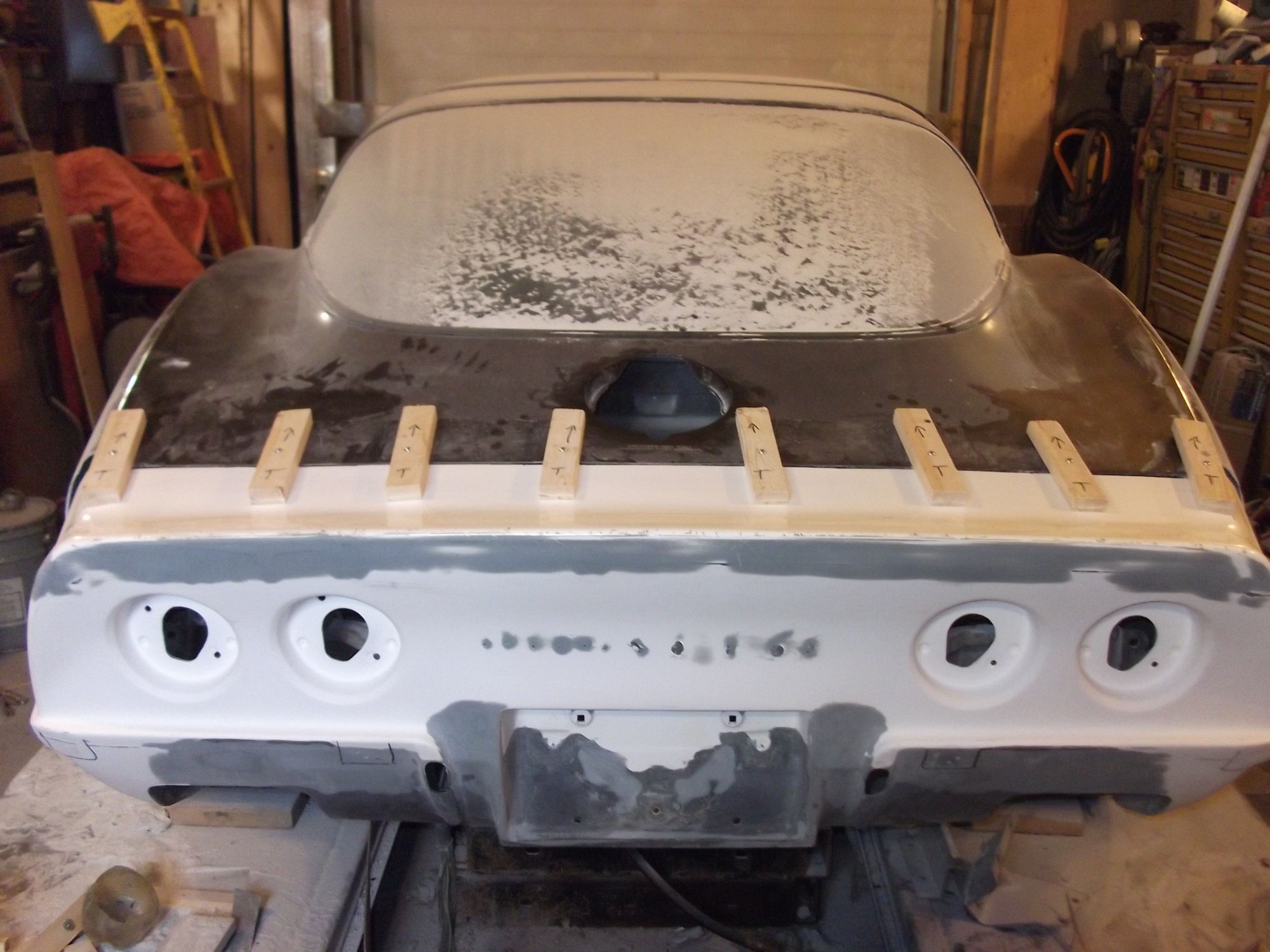

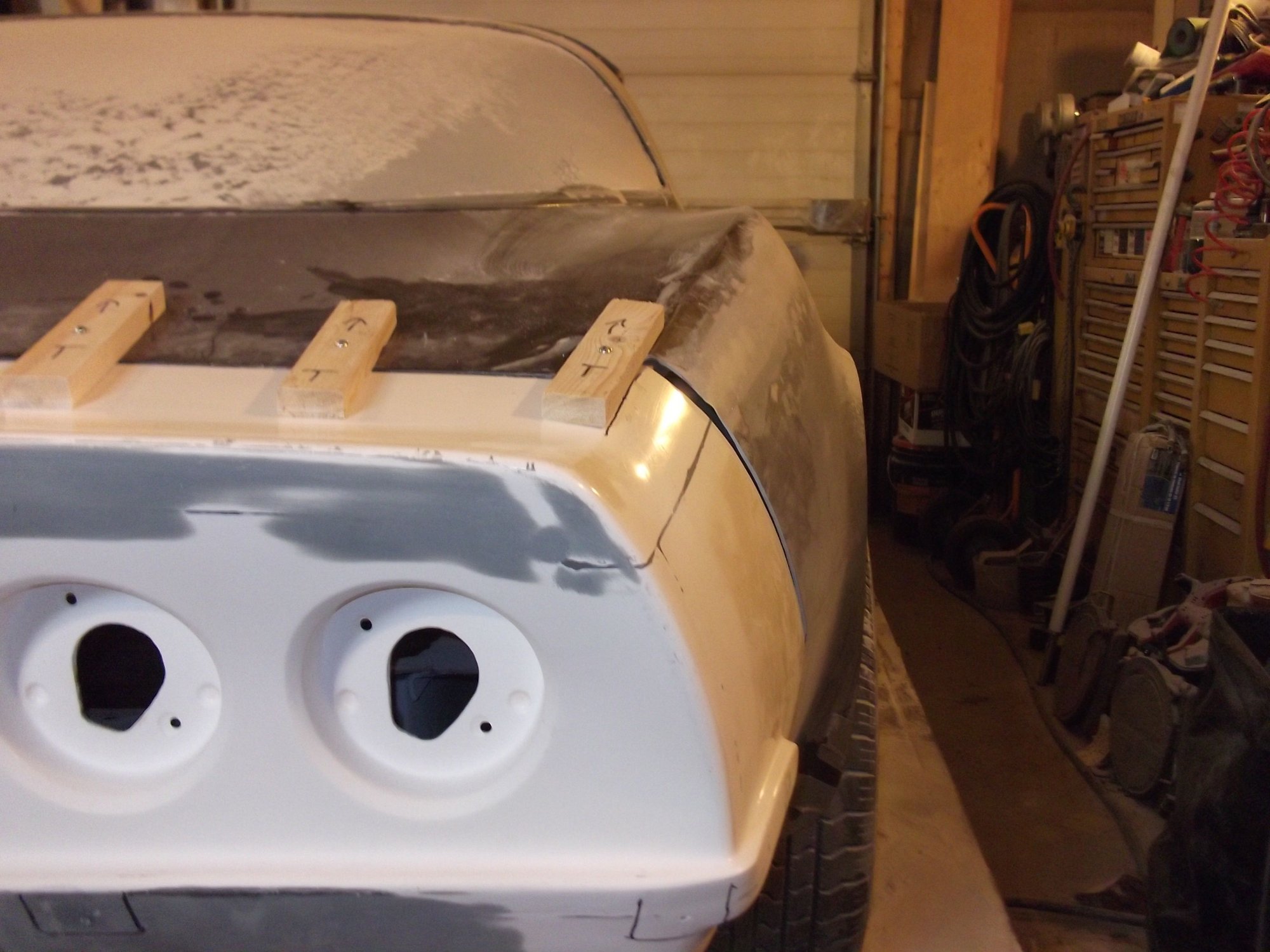

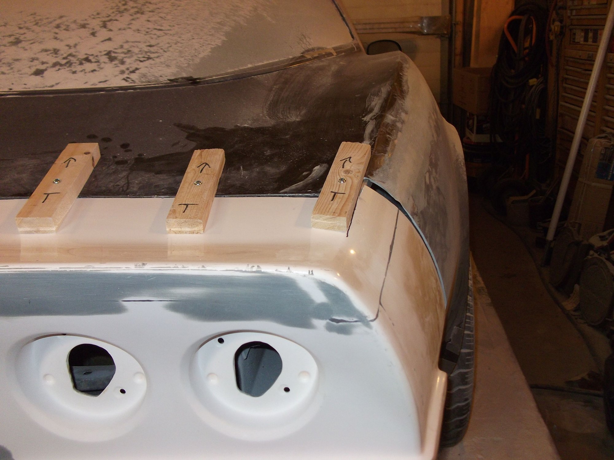

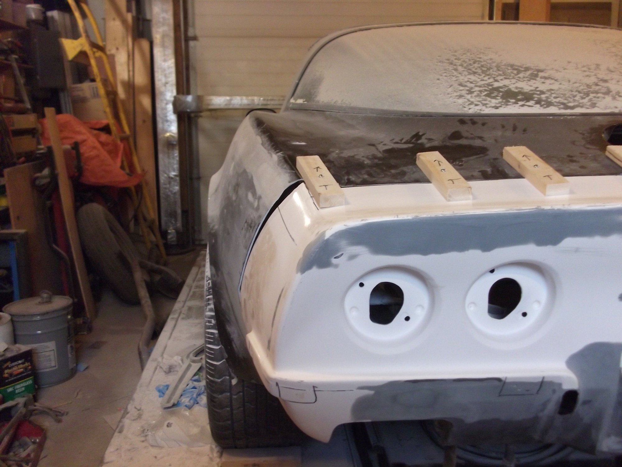

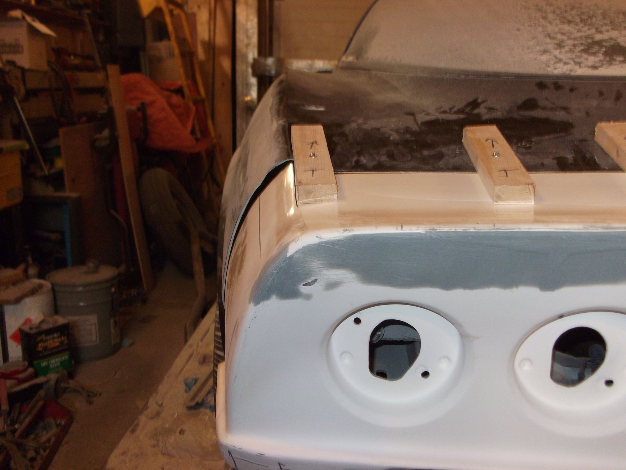

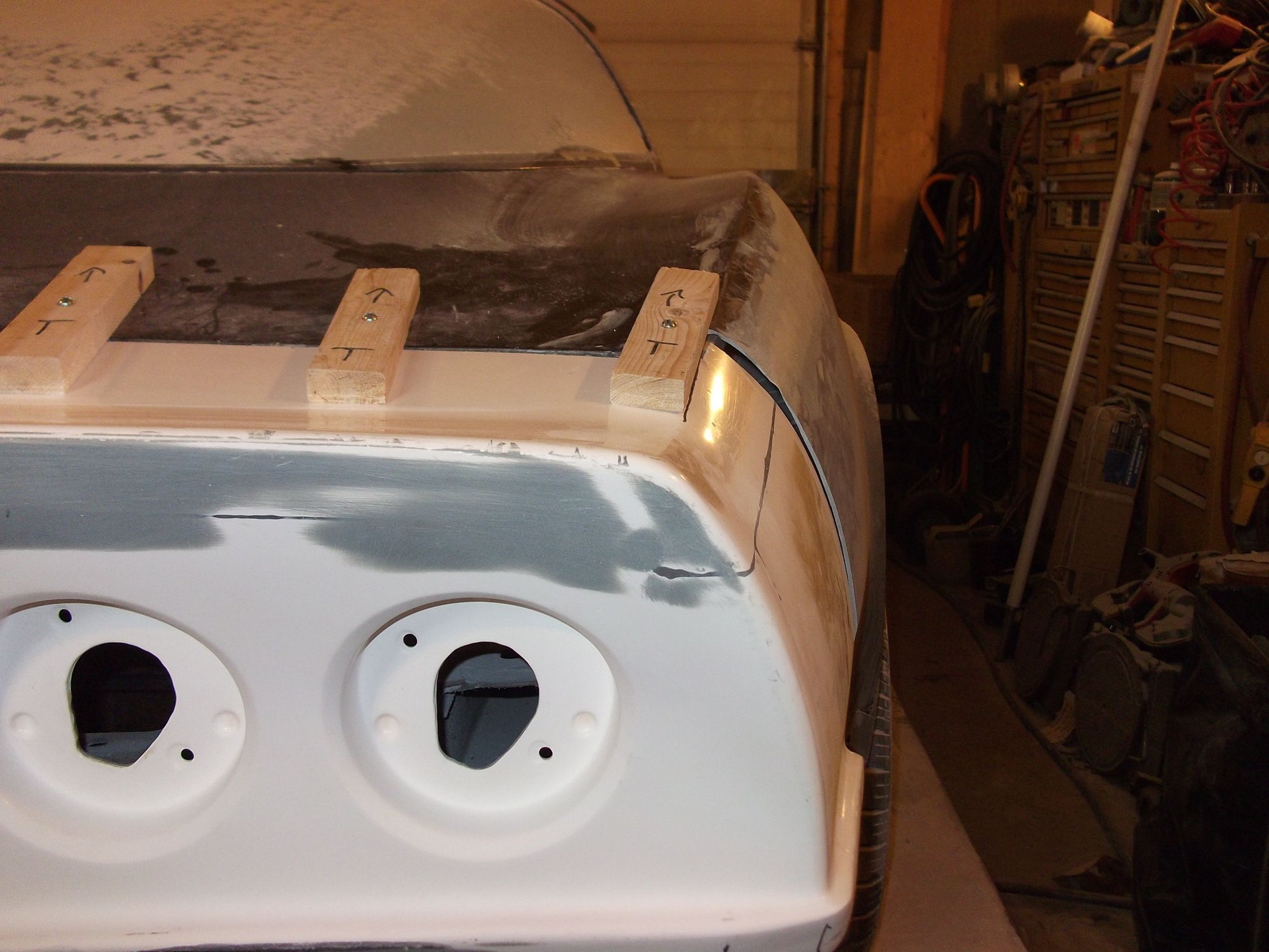

Well, here are some more pictures that hopefully give Dub the angles he was after. I drew lines on the character line where the quarter panels meet the upper deck but they didn't show up in the pictures. The outer edges of the outermost wood clamps line up with character lines where the quarter panel meets the upper deck on both the 79 and the 70-73 ACI rear clip.
On this one you can see the black line I drew on the 70-73 ACI rear clip and the grey line I drew on the 79. Both lines are on the character line where the quarter panel meets the upper deck.

THANKS for the photos. That is what I needed to see.
Obviously there are two ways of doing this...so...it depends if you want to cut a slit in the quarter panel and draw it in...or laminate it up and add VPA to the ACI clip to bring it out to meet with the factory quarter panel curve and blend that contour in.
And as you more than likely have looked at and noticed....there will be a transition from the curve or the quarter to the ACI clip due to these body contours are different. And not that it is 100% required to be done...but being able to get to the underside and add mat and resin (regardless of which way you choose) would benefit the job.
That will take care of the top line...as for the side line where the lines are off at an angle....we can get to that when and if you start you laminating and get the clip to be held in place...because you can deal with the side quarter area when you desire...because it is not required that you apply all the mat and resin at one time.
DUB
I'm thinking of doing both and sort of meeting each panel halfway.

A CRAZY THOUGHT.. what if you made the space on the side panel (between the original and the new ) larger and then "cast" in the section to correct the misalignment. I did it in mockups using wax paper with very thin 1/32 birch plywood as the backing. The wax paper (acts like mold release) would go in from behind -backed up with the birch plywood. Then you could fill in the gap with glass mat , over lay the two panels. When dry remove the plywood and wax paper. Grind / sand the inside and overlay the seams and "new cast in filler...
You could possibly contour cut a piece of wood to hold the 1/32 plywood against the inside of the panels to get the contour. This curved piece would be vertical, one on the ACI and one on the original panel.
Again just a thought...
Blue, where it is now i really dig that idea, it seems it might be something to consider incorporating, it makes sense.
I'll give that some thought Blue, thanks for the suggestion.
