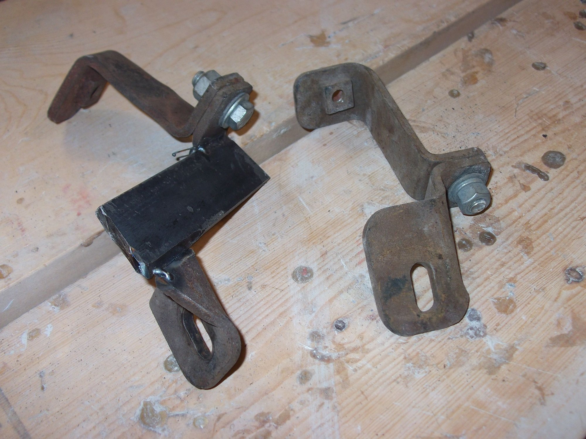

I got the next bracket sorted out. It went a lot quicker than the previous pair I did. Here's the before and after:
I didn't get to finish off the welds as I ran out of welding wire. As the metal I'm adding was slightly thicker than the factory bracket it was a little tricky to hold everything in place for tack welding because a vice grip won't hold both the factory bracket and the new metal. This bracket could be completed with the rear clip fiberglassed in place as there was no need to remove it to modify the bracket:

Looking good/progress!
Post a stickynote........."Weld bumper bracket"
(don't ask......... )
I keep a sheet of paper taped to the windshield and add / subtract what I need to do. Saved many opps moments.

VERY WELL DONE Priya.
Funny thing is on how somethings begin to go quicker once your car knows you know what to do and it chooses not to fight you any longer. I KNOW a car really can not do that...but forces in the universe certainly can...and I am GLAD that this came out as you planned.
DUB

Thanks Dub. I'm not afraid of the modifications to the bumper brackets anymore, I'm confident I can get them all sorted out.

For me the fabrication of a bracket, or whatever vs just replacing parts, is what I find the most rewarding.
Thanks for sharing your progress with us.

Interesting. I find it somewhat stressful. I feel pretty anxious until I come up with a plan.
