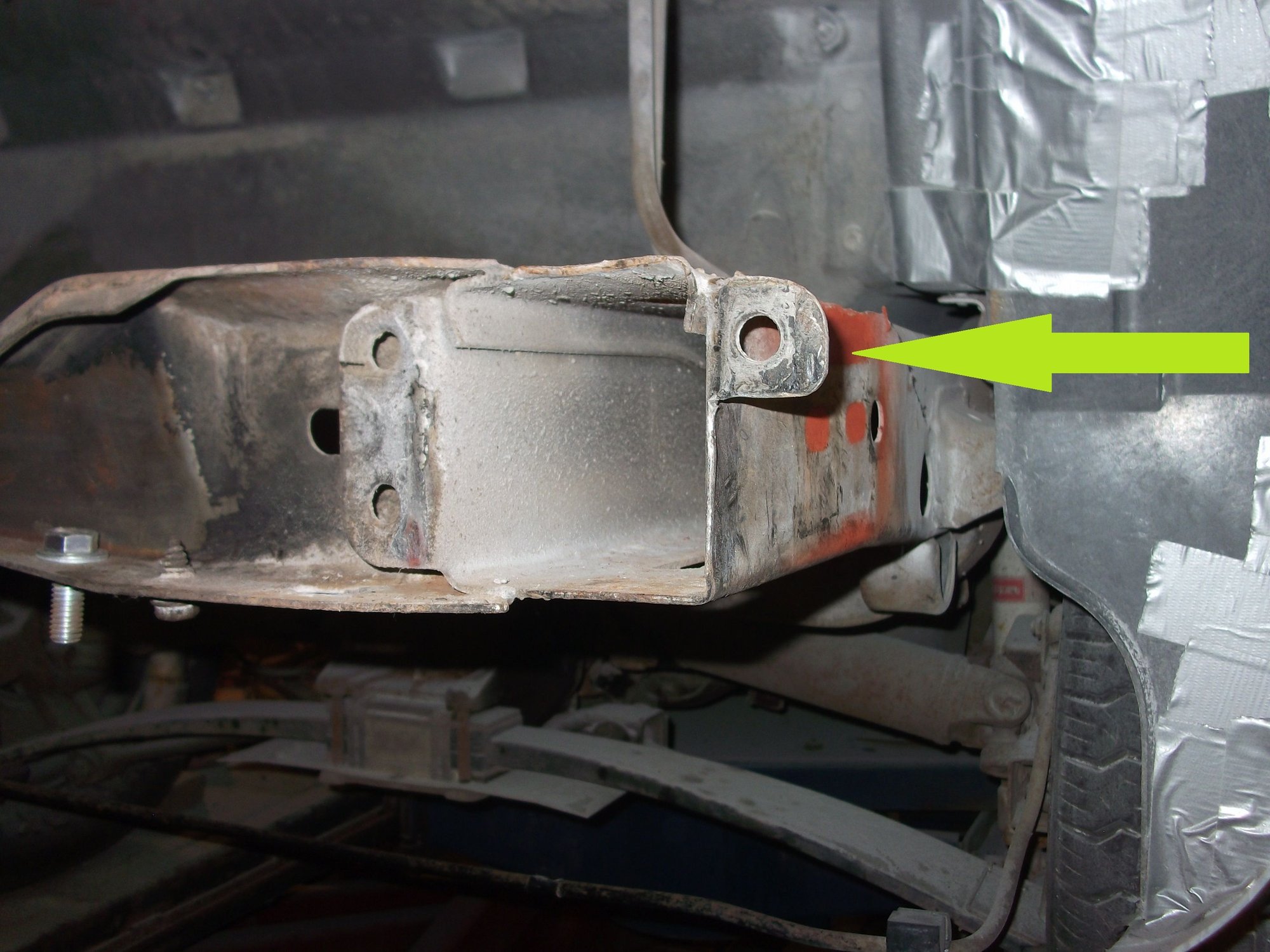

I finished a couple more brackets today although I expect when I get the 70-73 ACI rear clip glassed on I'll likely have to make some adjustments. The brackets had to have the angle decreased at point "A" and increased at point "B"
I used an oxy acetylene torch to heat the brackets and bend them but found once you get them close its too easy to bend them too far when you only need a little tweak. So I found I needed to get them close with the torch and then use a small sledgehammer and an anvil to complete the slight bit of bending necessary to get them just right. It took a lot less hammering than one would expect.
Once the brackets were lined up I vice gripped them in place and used a can of spray paint to mark where the holes in the 79 frame would need to go:

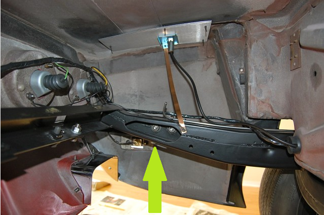

You need to remove the donor rear clip removed to make these holes. As it turns out these are the only brackets that you need to have the donor chrome bumper rear clip both on and off to modify. All the other brackets can be modified with the donor chrome bumper rear clip glassed into place.
These brackets bolt to the frame rails. On a chrome bumper car there is a hole in the inside of the frame to allow access to the bolts for these brackets as seen in the picture below:

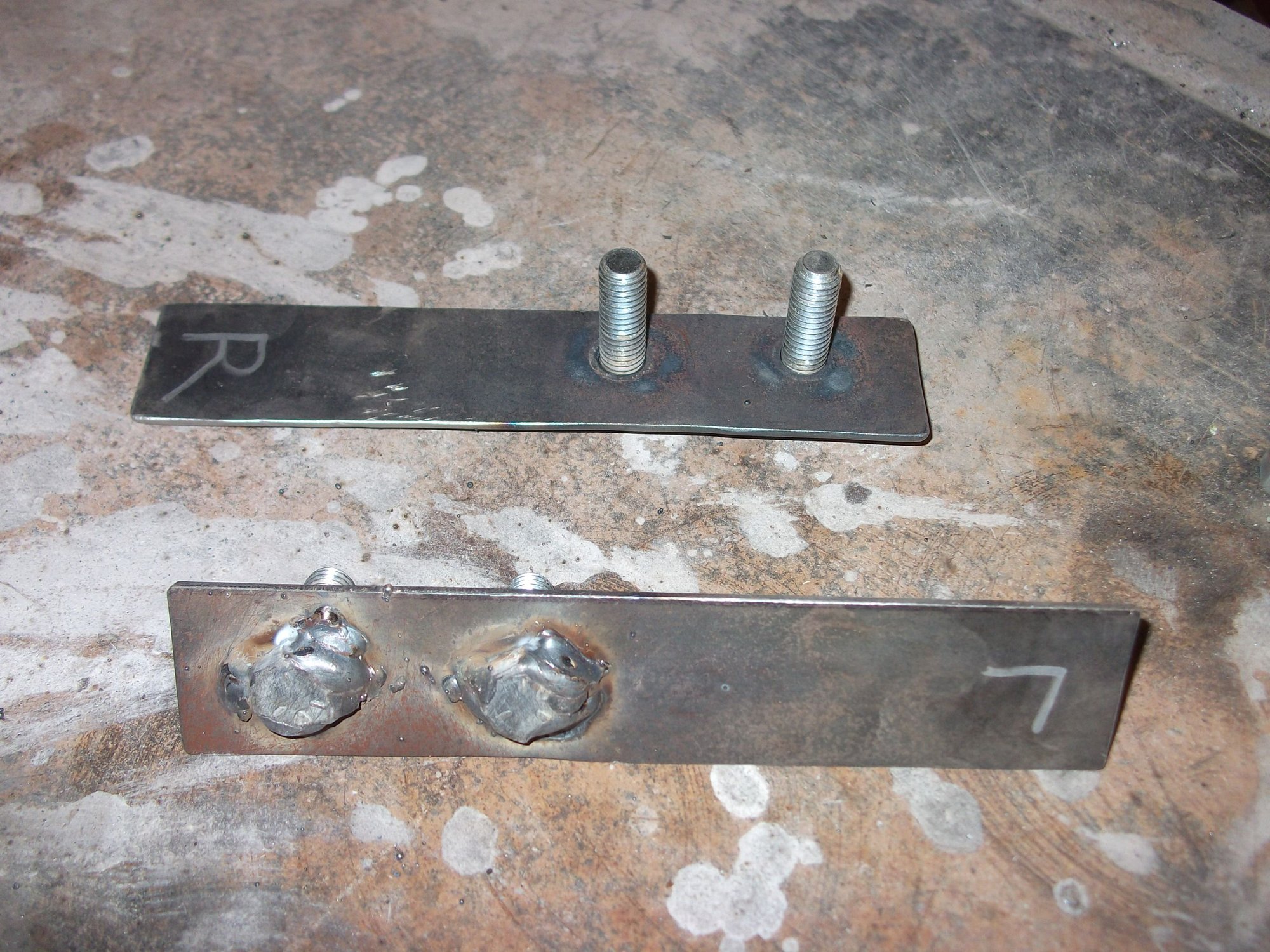

The 79 frame does not have these oval holes in it and the gas tank would cover them if they were there. To get around this I made these bolt holders so I don't need to make a hole in the inside edge of the frame rails (thanks to my husband for suggesting this to me):
Note the end of these bolt holders stick out an inch and one quarter from the frame rails so one can manipulate the bracket bolts with the donor chrome bumper rear clip glassed into place:
I removed a portion of the flange at the end of the frame rail shown in the picture below in order to provide clearance for these brackets. The remaining hole will be used for the bracket used on 72 and 73 cars that goes to the bumper through the quarter panel:
It would have been better to modify all the bumper brackets except these two after the 70-73 ACI rear clip is glassed into place so the brackets won't have to be changed if the clip moves slightly once its glassed in place compared to when it was clamped in place. So instead of modifying the remaining four bumper brackets now I'm going to glass in the 70-73 ACI rear clip now and modify those four brackets afterwards.

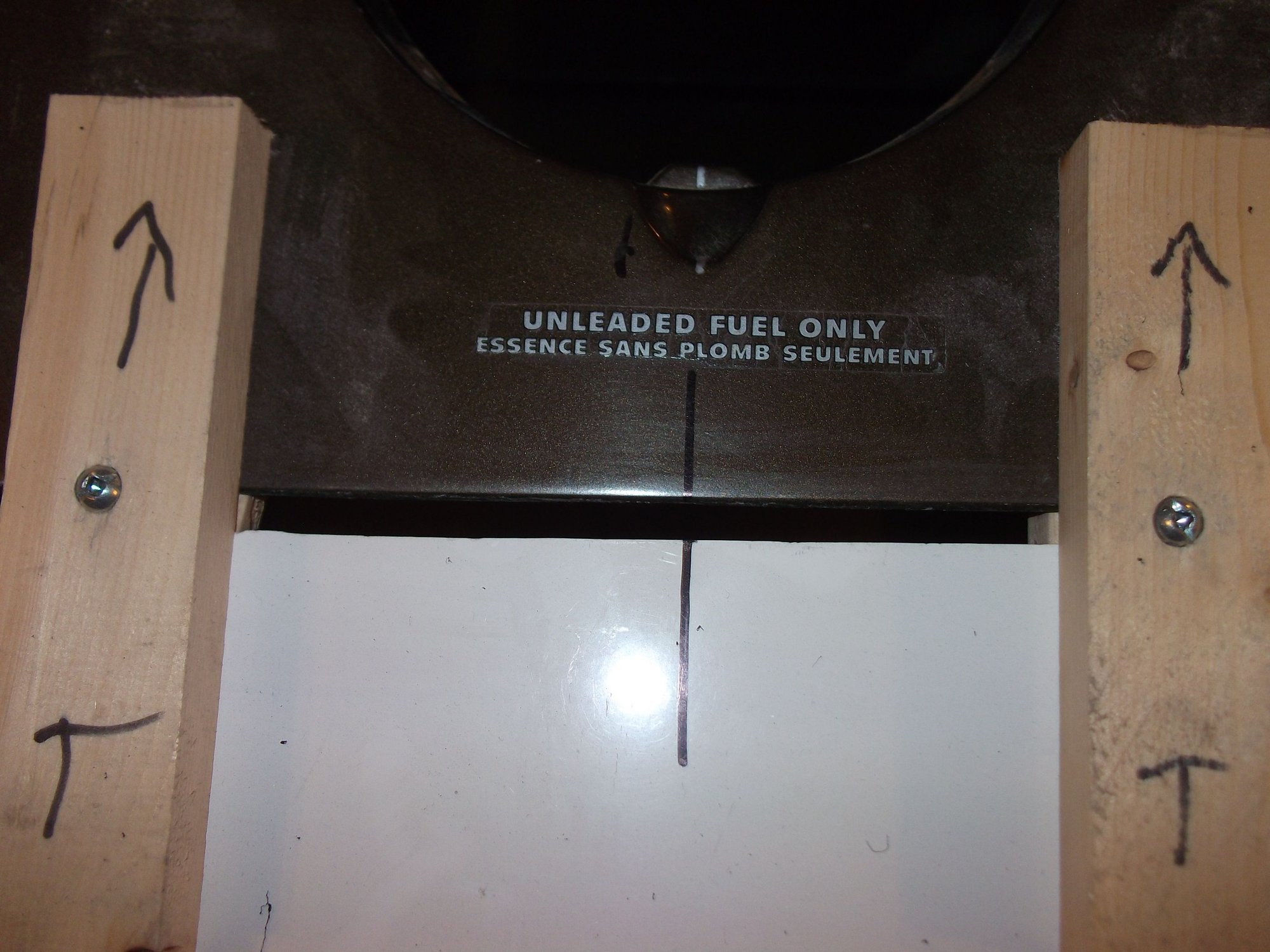

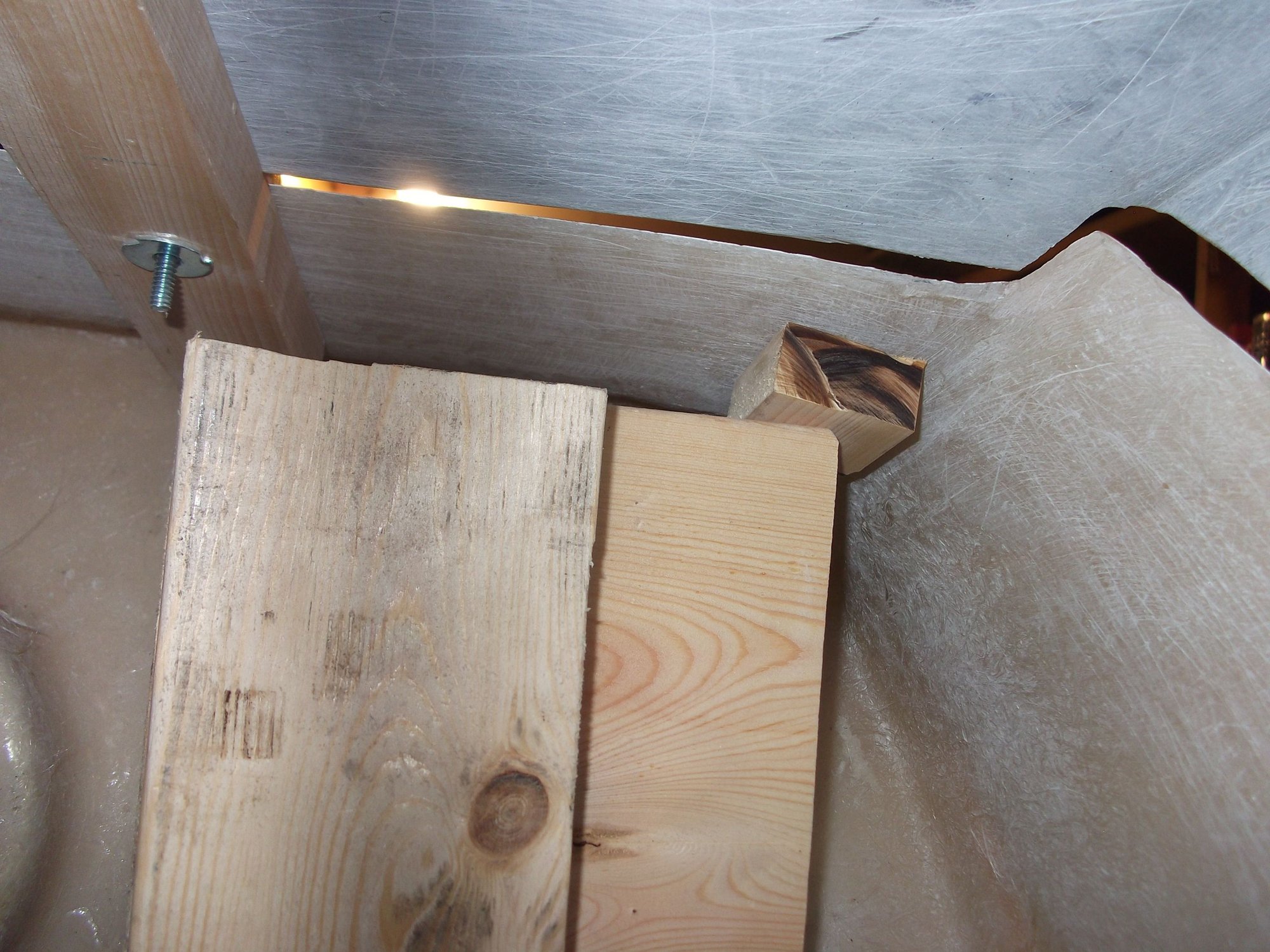

I spent some more time trying to get a better fit on the 70-73 ACI rear clip and come up with a way to allow me to glass in the edges where the rear deck and quarter panels meet.
I removed the wooden clamps from the outer edges of the mocked in place clip and found that I could push up the outer edges of the rear deck on the 70-73 ACI rear clip from underneath which will allow me to glass in this high tension area first:
This lines up this part of the two rear decks and upper quarter panels better than I expected:
And I finally got smart and made a couple of marks on the upper decks of the 79 and the 70-73 ACI rear clip so in all the removing and replacing I can better duplicate the positioning each time:
Too bad I didn't think of that at the beginning of this
