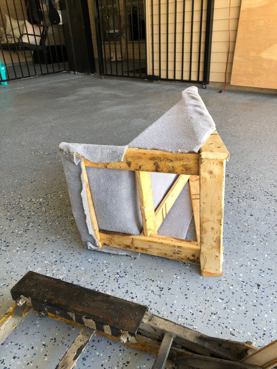

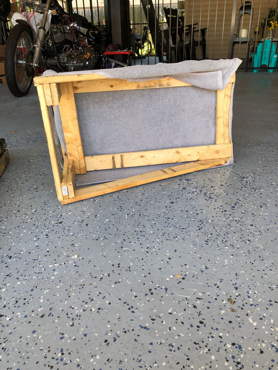

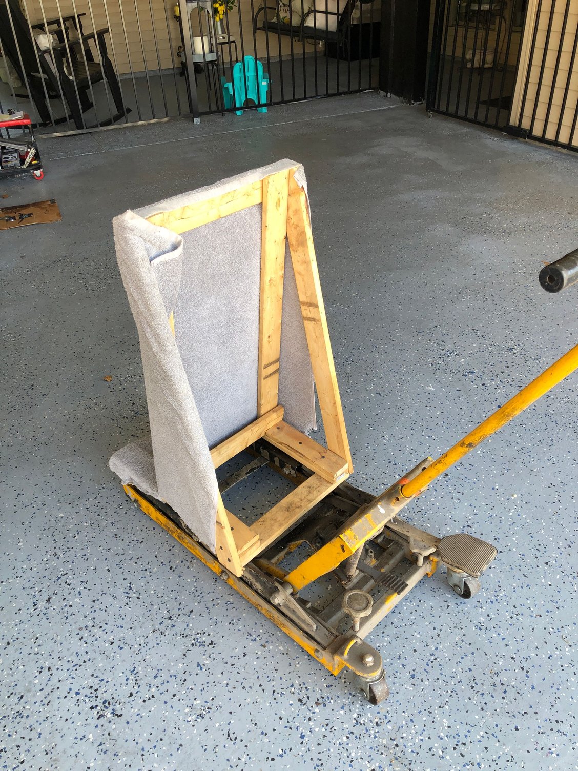

Here ya go.....it's a DIY ONE PERSON door installation tool/
It's wide enough to fit the width of the motorcycle lifting platform.
It's about 2 feet tall.
The base of it is long enough to fit the lifting platform.
I stapled an old thick towel to protect the paint on the door...the staples are on the backside of the wooden frame.
I used simple straps to hold the door tight against the frame and used a wooden tapered shimunder the door bottom edge to make the hinge holes line up with the birdcage holes.
Bottom of wooden base....
Laying on it's side/back view of upright...........
Sitting correctly on motorcycle lift/jack......(clamp it securely to m.c. jack lifting platform)
Front view...the door skin faces against the soft cloth and is strapped snugly to the wooden frame....
The door can stay secured to the lift and parked out of the way.

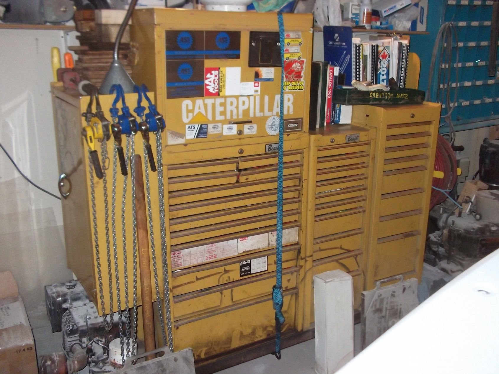

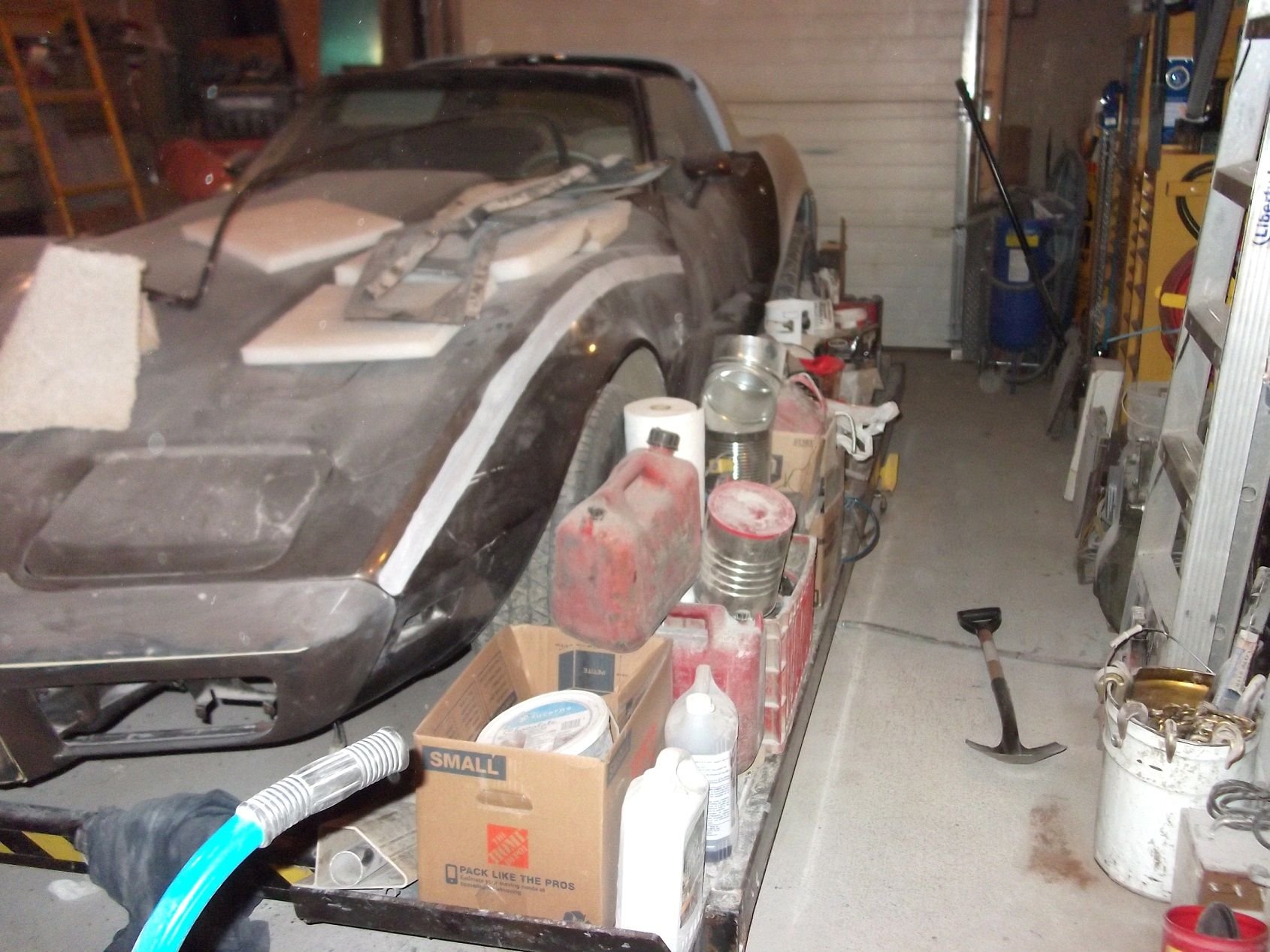

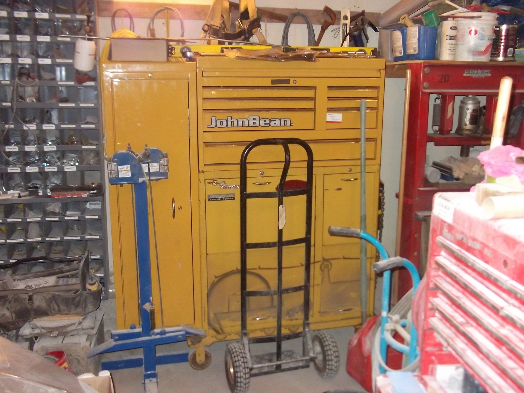

When I finished priming the back of the car I figured I'd take a short break and then get back at it. That was over two months ago. For some reason it's a lot easier to stop working on a project than it is to get started back up on it again
While I was trying to build up my motivation again hubby decided he's done being a mechanic and he brought his tools home:
There's another similarly sized cabinet in the basement. Sweety says last time he seriously tallied it up he figured he had about $80k in tools. His educated guess is that he now has about $100k invested in them. The sad thing is that they can only be sold for pennies on the dollar. The even sadder thing is that Revenue Canada doesn't let mechanics deduct their tool purchase costs from their net income - that's so unfair.
I've often complained about the cramped garage, it's a lot worse now with some of hubby's tools in it. Here's what he left after he made room for the tool boxes:
It's the same on the passenger side of the hoist. I've been really enjoying my time off, it's easy to let it slide with the car being partially buried. I figure I've given the spouse long enough, I'm going to suggest to him that he let me move all that stuff off the hoist and find a place for it. I don't want to let the whole winter slip away and I've got nothing done. It would really be nice to have the rest of the car ready for primer once all the snow melts in the spring. Wish me luck
