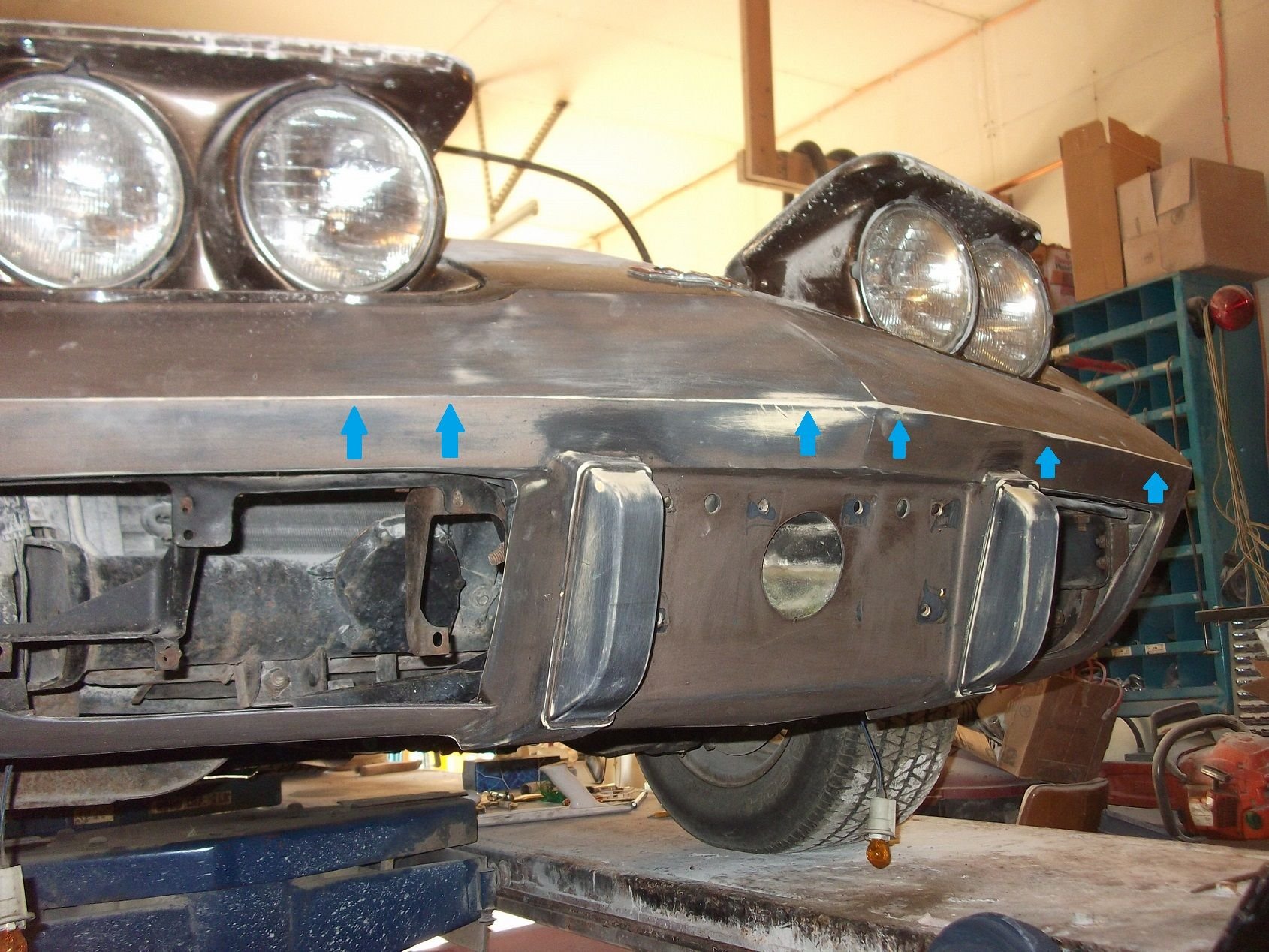

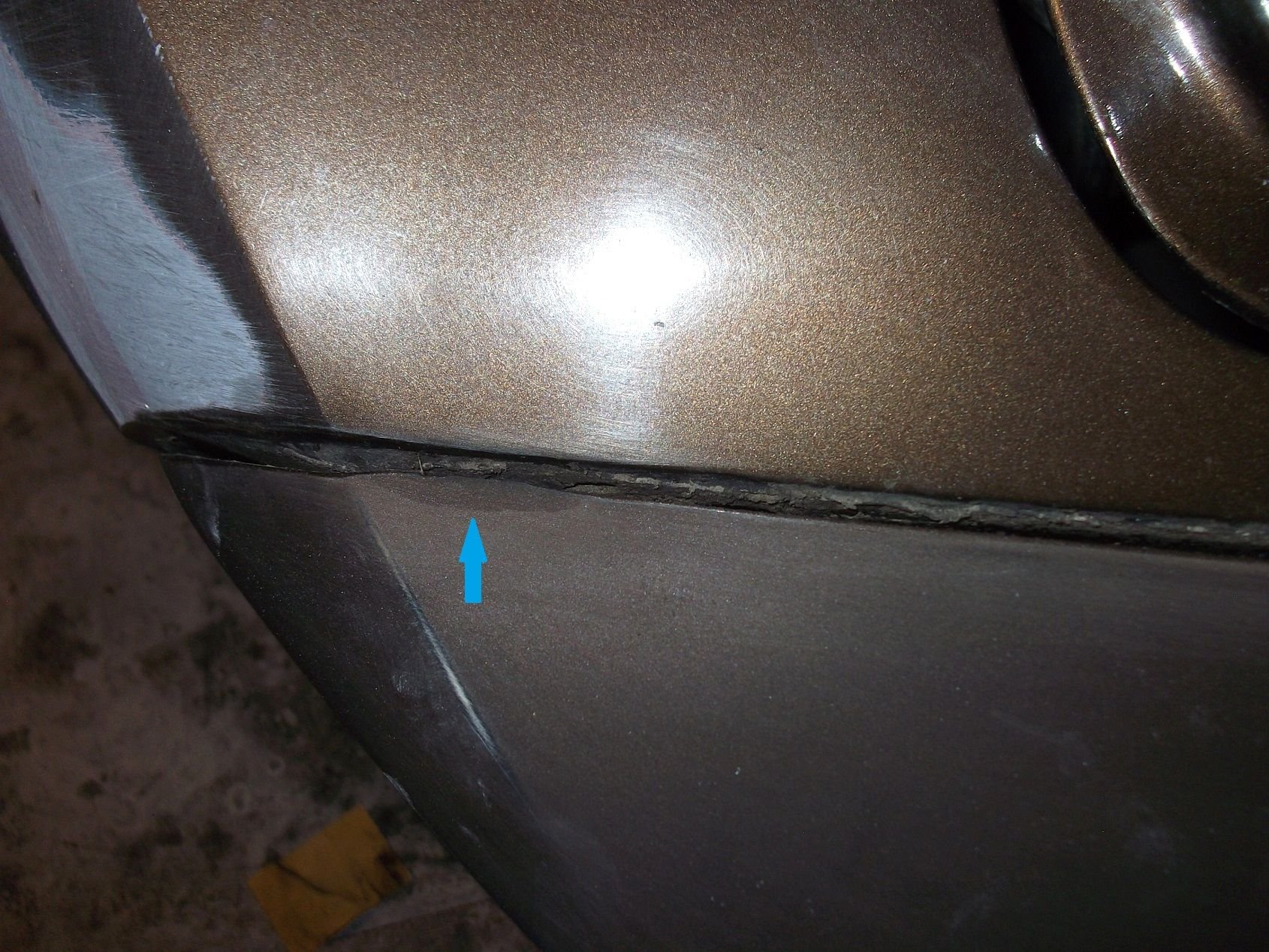

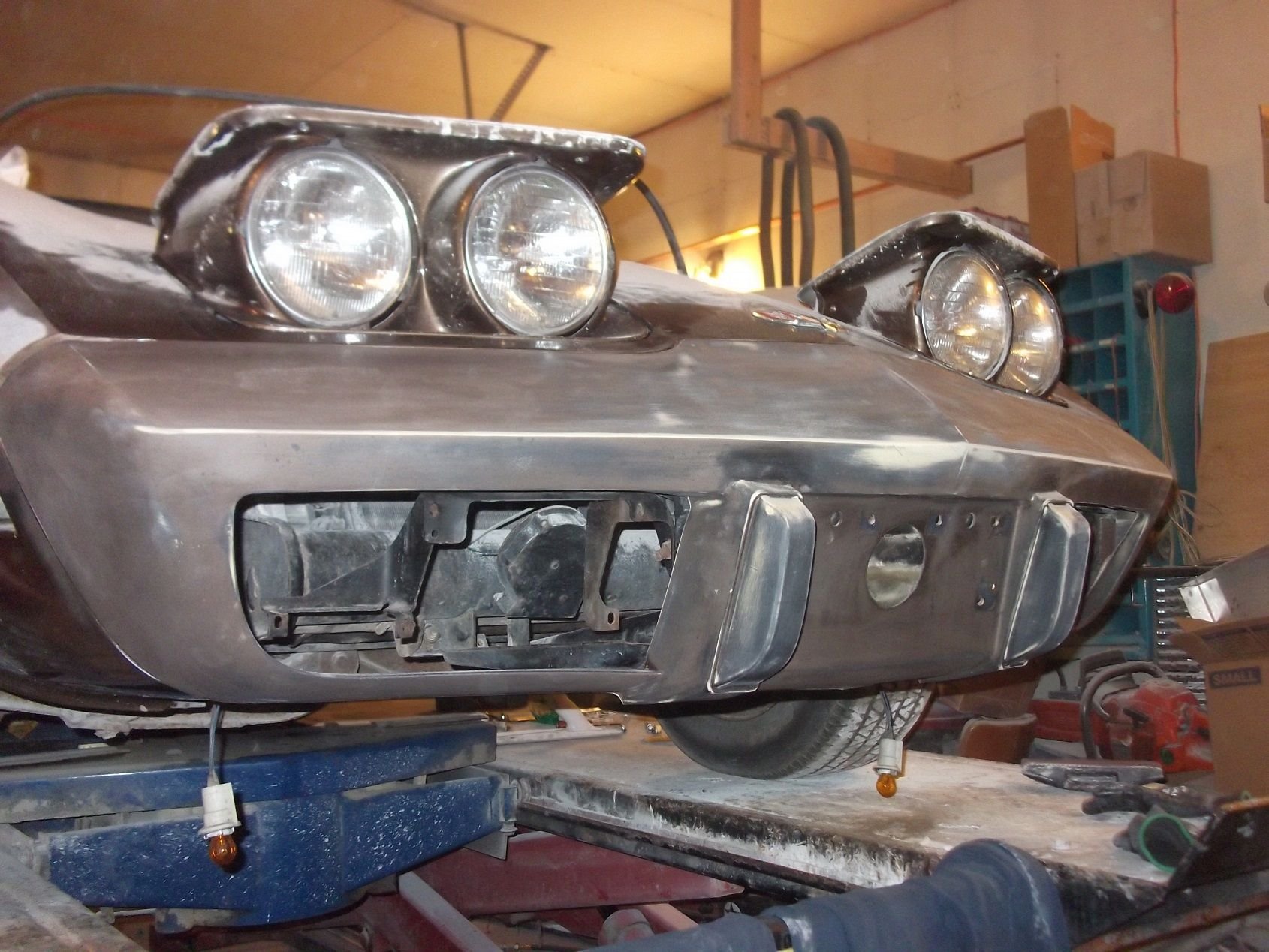

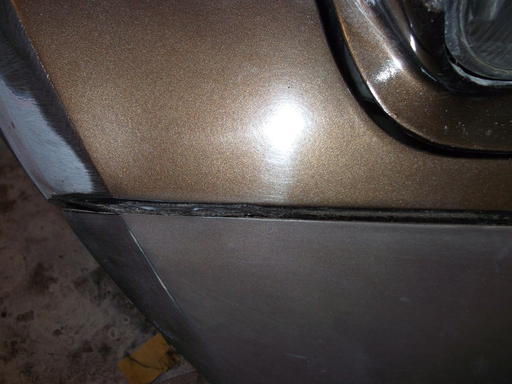

A few days after doing my best to wash off the penetrating oil I used to loosen the front bumper cover bolts I discovered that the oil between the bumper cover and body was creeping back onto the body work as you can see in the picture below (blue arrow):
In the same picture you can see a bit of casting flash on the bumper cover in the same place as the penetrating oil:
I cleaned the bumper cover again, focusing on the space between the bumper cover and the body and sanded away the casting flash that was making the gap between the cover and the body tighter than I would have liked in that area for painting the car with the cover on:
The bumper cover had a few tiny nicks and stone chips on the forward edge which I sanded off. Later I noticed that edge was sharp in places and more blunted where I had sanded (blue arrows in picture below):
I could have bought some rubber bumper patch and added fill to the blunt parts of that edge to make them sharper but adding fill to an edge is a lot tougher than adding fill to a relatively flat area so instead of doing that I decided to sand down the rest of the sharp edge so it was evenly blunt all the way along. When the car is painted no one is going to notice that that edge is not as sharp as the factory made it:
I'm hoping to avoid removing the headlight buckets for paint as it looks like a big struggle to get to the bolts holding them in place and they are nicely lined up already and I don't want to have to get them back into proper alignment if I remove them. The problem with that is the part of the headlight bucket shown in the picture below (blue arrow) which would be difficult to paint on the car and wouldn't give as good of coverage as it would if the buckets were removed:
So at this point I'm not sure whether or not I'm going to remove the headlight buckets for paint.

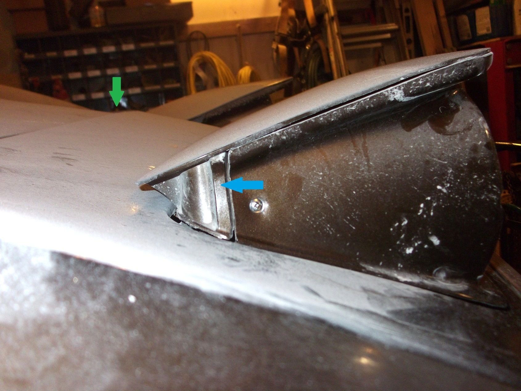

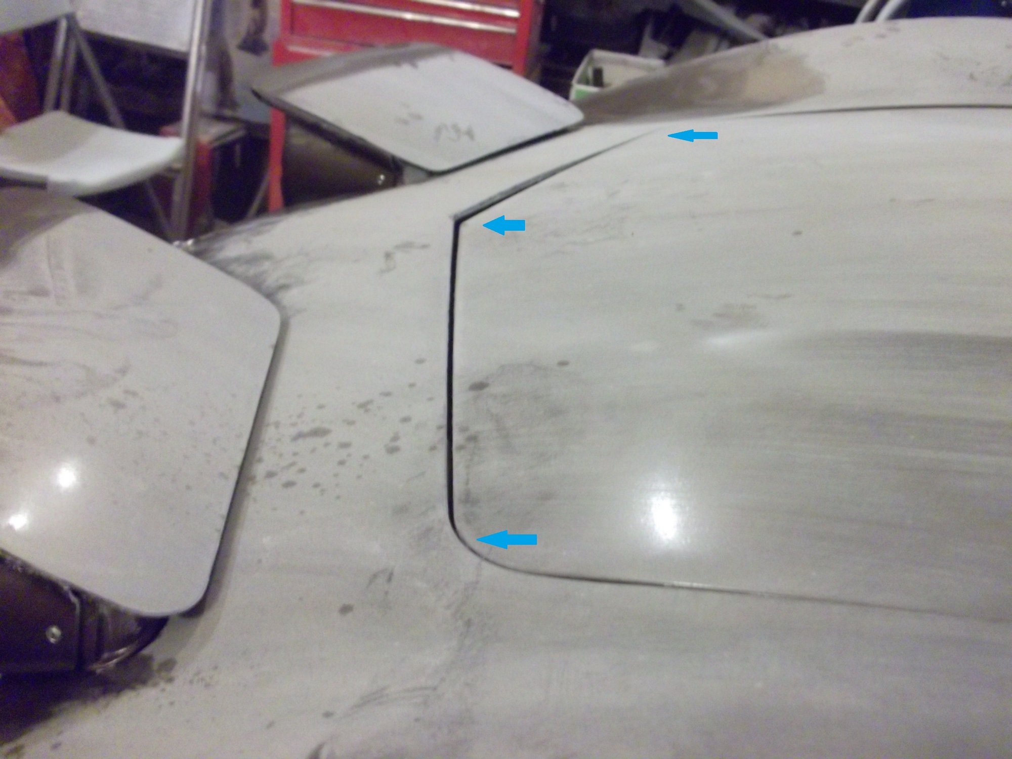

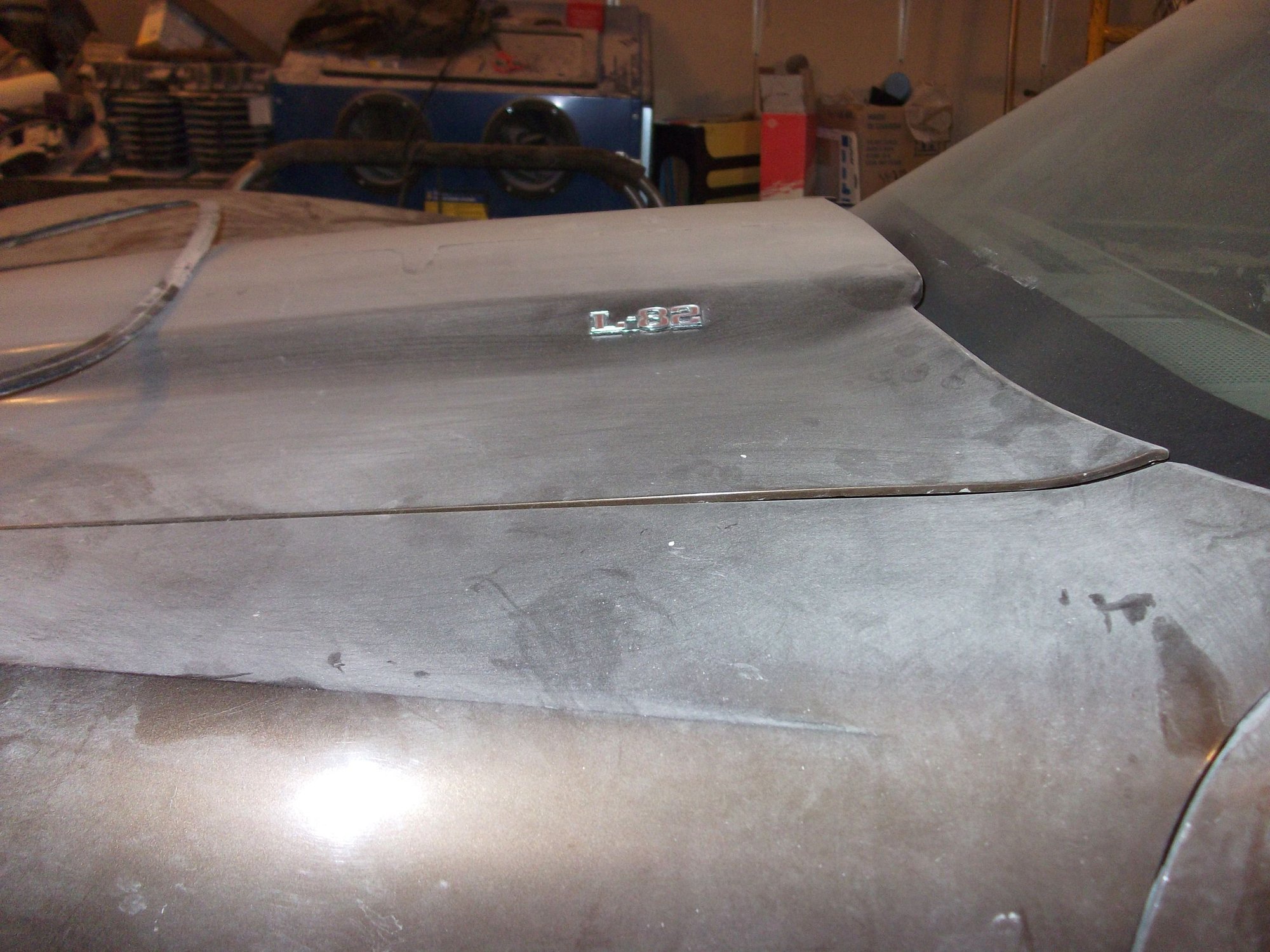

When I bought the car I noticed the hood was misaligned note the gap at the front centre of the hood (green arrow picture above),
You can also see the gap between the back edge of the hood and fender and between the headlight surround and the centre front edge of hood in the two pictures below:
Since I bought the car I had been thinking all that was necessary to fix those gaps was to lower the rear edge of the hood which would bring the front edge of the hood back up into alignment. Now I'm not so sure that's going to fix it. The front centre of the hood is 1/4" or more lower than the centre of the head light surround while the front corners of the hood are level to the head light surround (blue arrows in picture above).
I think lowering the rear of the hood will help with the alignment on the front edge of the hood but I don't think its going to make up all of the quarter inch or more of gap there. I can't just raise the hood at the front until the front centre is in alignment with the headlight surround because doing so will raise the front corners of the hood above the fenders. I don't know if the hood is bent or the headlight surround is in the wrong place or both. I thought about adding fiberglass to the top of the hood to make up the gap at the front but that would take a great deal of mat and resin which would have to cover almost the whole length of the hood which would be a great deal of work and would make the hood pretty thick at the front. I think I'm going to have to lower the rear of the hood and hope for the most possible rise on the front and live with the gap at the centre front of the hood that remains.

I think you made a good call on rounding the edges of the front rubber bumper.
The prior owner of my 73 added some of that rubber bumper filler when he had it painted twenty years ago.
The front bumper on mine looked horrible and that filler was cracking all over the bumper edges.
I like the front bumper on my 73, because to me it has better cleaner lines than any chrome front bumper model.
The one thing that does bother me is that the chrome rear bumpers don’t flow good when looking at the car’s lines.
I decided to replace the 73 style front bumper with a new fiberglass piece and remove the chrome bumpers, fill the holes and mold in the valance on the rear.
The guy who will be painting my car said this is something he has done many times over the years.
He showed me on a car in his shop where he welds in a crossmember directly behind the rear valance which supplies the same protection as the bumpers and brackets would in a rear end collision.
I can’t wait to see what you do next!

hood is low. raise the hood by shimming the hinges. if the center of the hood is then high, i did a bubba thing and put a threaded rod between bumper brackets and put a turnbuckle on the threaded rod. attached the turnbuckle to a bracket i attached between the headlight relays and cranked the turnbuckle up until alignment was perfect.
I'd be a lot happier about not doing the chrome front bumpers if my front rubber bumper cap looked like the 73 one. The bumperettes never used to bother me but as I heard people complain about them and talk about the better looking 73 & 74 front bumper cover I started to really prefer the 73 & 74 front bumper covers. After I decided not to do the chrome front bumper on my car I spent some time thinking about if there was an easy and cheap way to put a 73/74 front bumper cover on the front of it - I don't think so. I've seen at least one C3 with the chrome rear bumpers removed, the holes filled and the valance molded in, it looked pretty good, it was a red car but I don't recall who owns it. If we can afford it I'd like to put the pace car front spoiler on my car, I think that would better balance with the chrome rear.
I don't know where the headlight relays are so I'm not 100% clear on where you attached the turnbuckle, not on the front of the hood, but on the headlight surround panel in front of the hood?
I've been also thinking I could take the hood off, add mat and resin to the undersides of the front corners and then shave them down from the top. The only thing with that is I don't know where I'd put the hood, there's no room in the garage to put it without having it on it's side. That was a hurdle on doing the chrome front end too, I know the 68/69 front clip would have to come off and on the car several times and I didn't know how I could do that with no were to put the front clip when I needed it off the car.

never mind my previous. your hood lines up good at the sides. hood is what it is. it is possible the bar the back of the headlights bolt to has been bent up in the middle. sit between the headlights. if that doesn't help, maybe bounce up and down a bit. it is not a very strong piece. there are stories of the hood surround being bent down by a conjugal visit between the headlights... climb under the nose and look straight up through the center hole in the valance. you will see the support member and the horns and headlight relays. in fact if you are messing with the bumper cover, life is a lot easier with that valance removed. also a lot easier to paint lower valance and the spoiler when off the car. and is hanging the hood from the overhead to get it out of the way a possibility?
