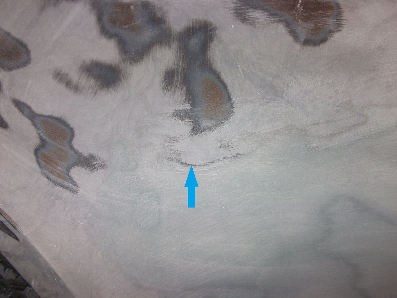

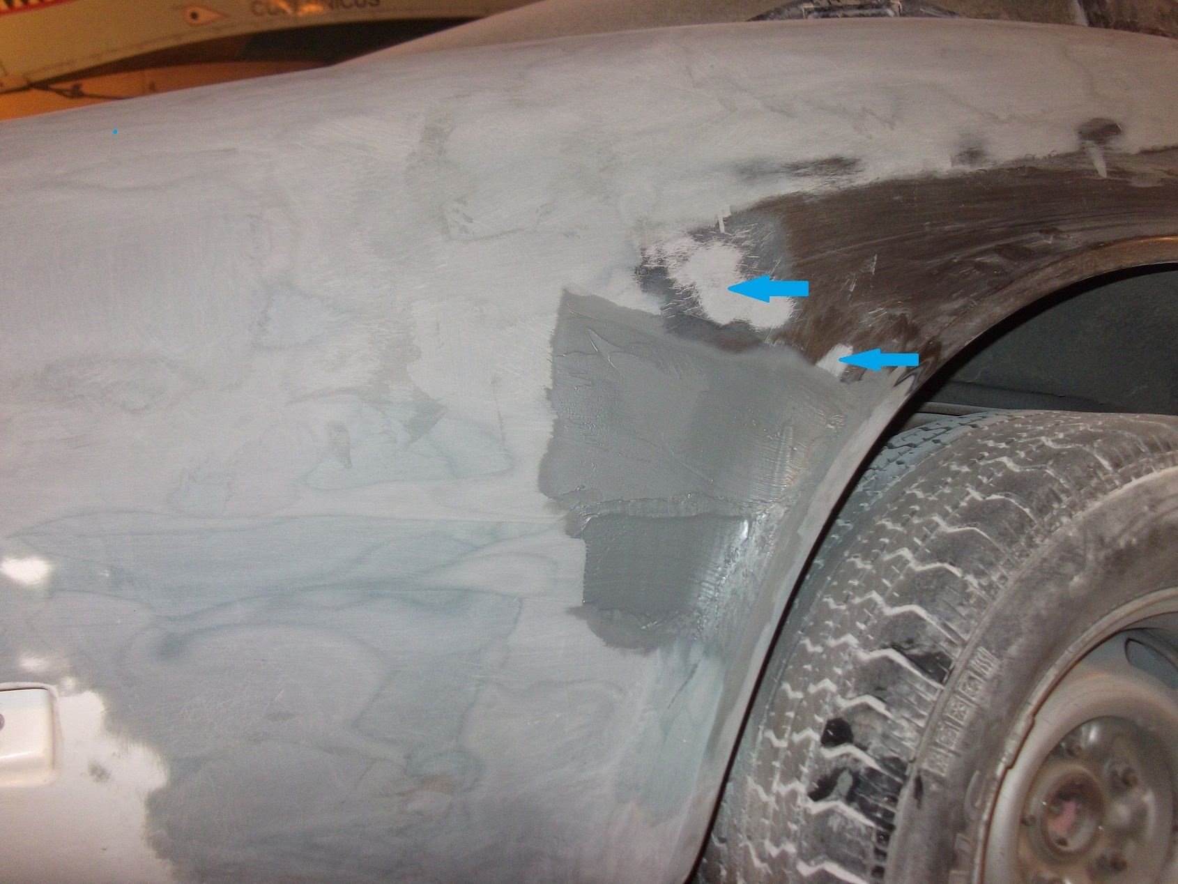

I've since covered the passenger side completely in filler and sanded it down another 3 times or so. Part of that was I didn't remove enough paint and had filler over the paint at the area shown by the blue arrow below:

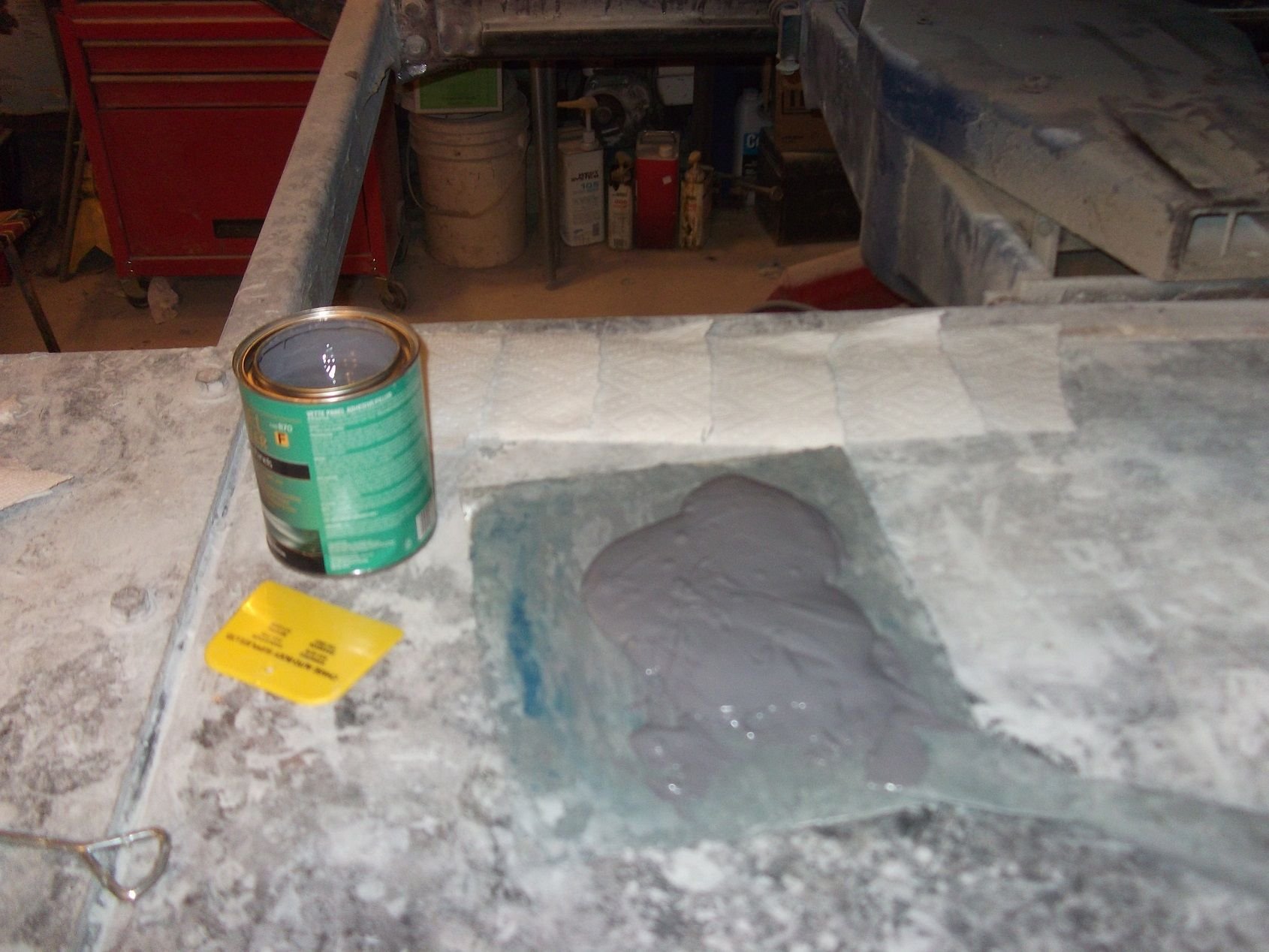

By the time I had sanded away the filler over the paint and the paint itself I had a ledge where the blue line is in the picture above and so it needed more filling The picture below shows how much vette panel adhesive/filler I mixed up in order to be able to cover most of the passenger side quarter panel:

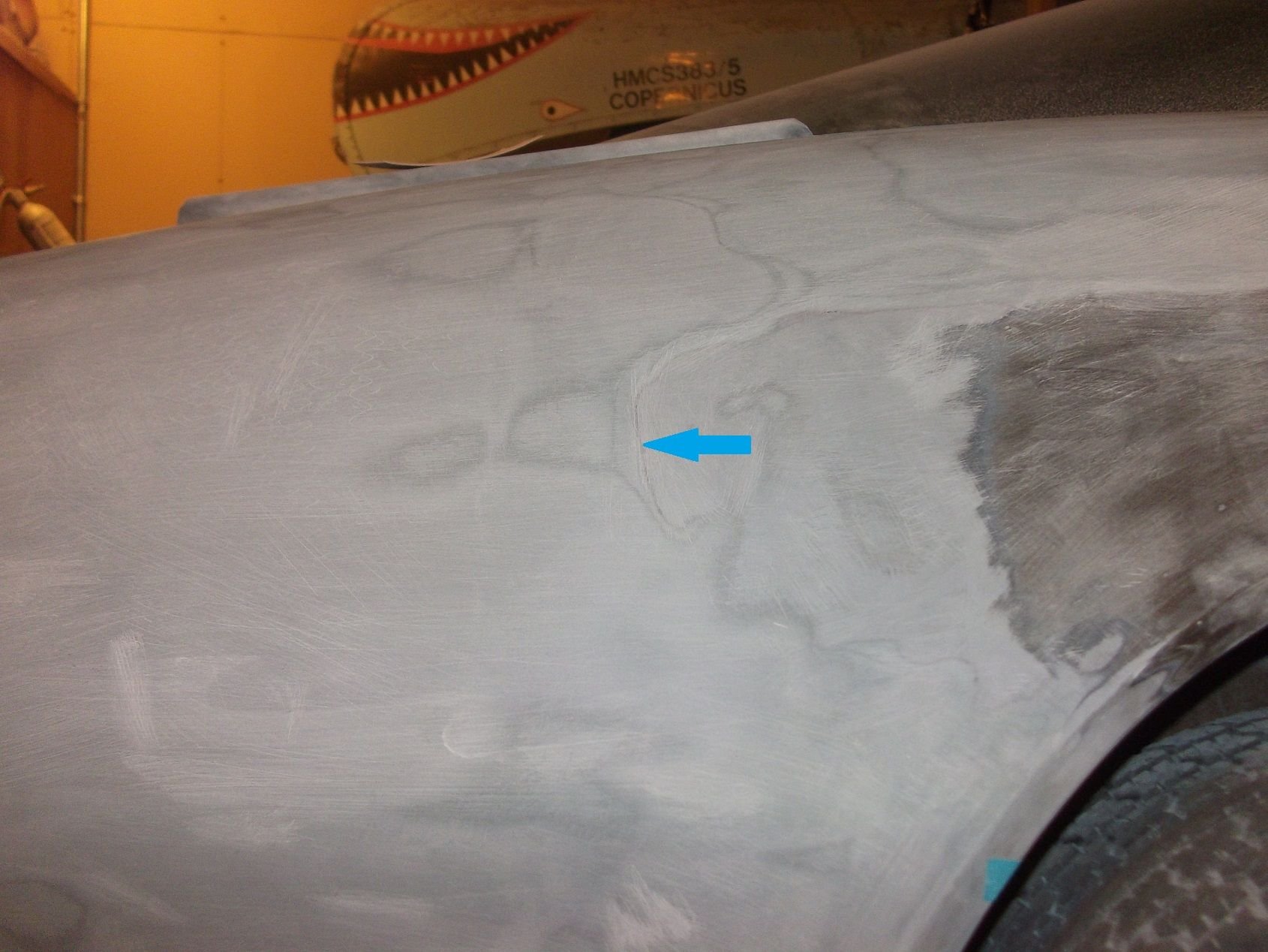

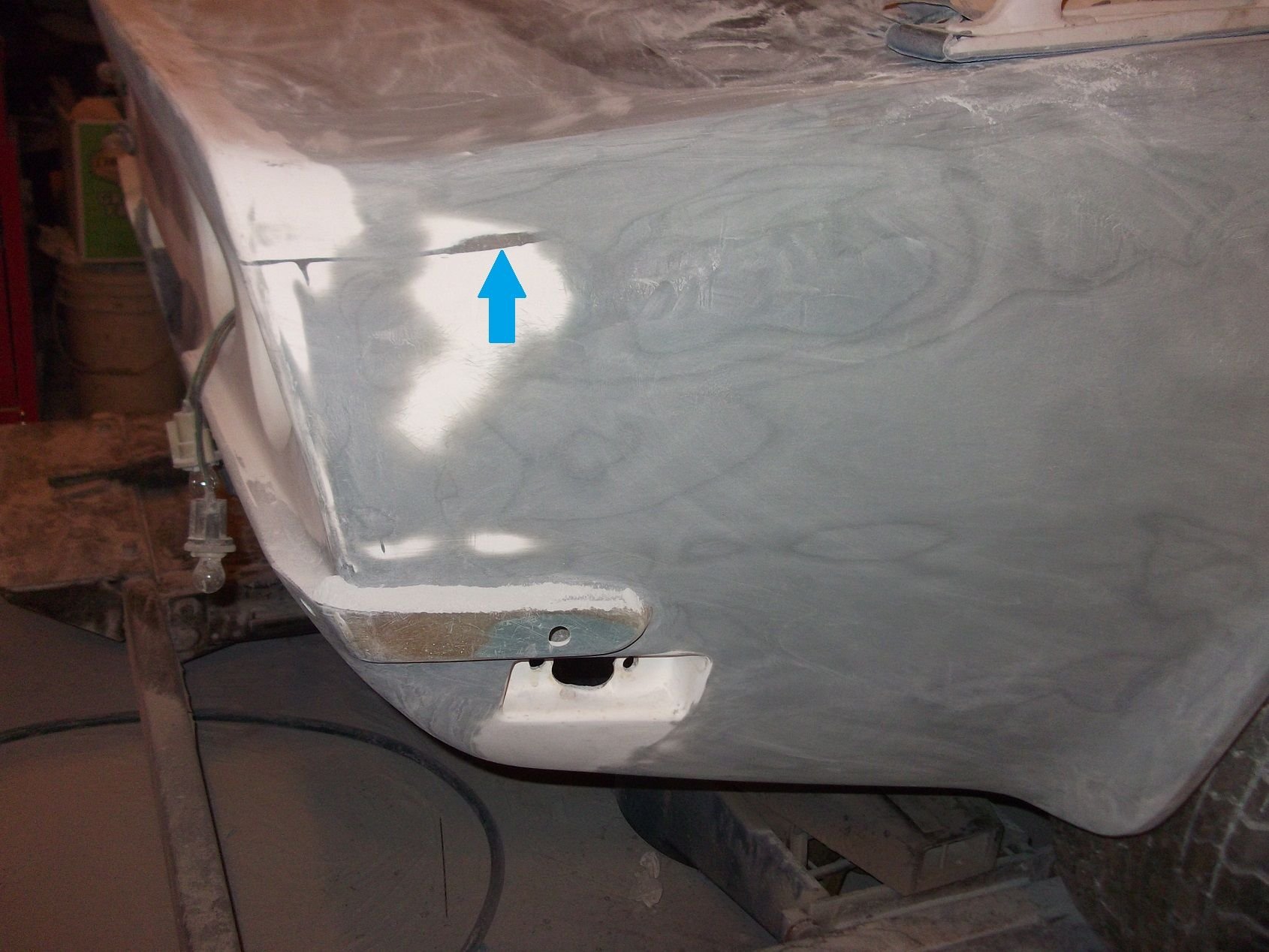

You can see on the driver's side below I also hadn't removed enough paint. The blue arrow in the picture below shows the original brown paint under the filler as I was sanding away the filler to get to the paint. The filler is under the paint line at the arrow and the bare SMC is above.

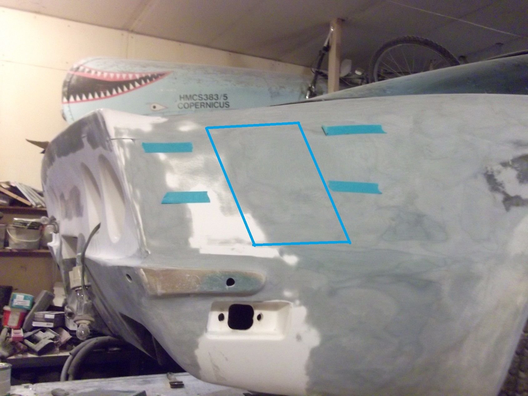

Previously I discussed the dip in the quarter panels which I wrongly figured was roughly in the area of the blue rectangle below :

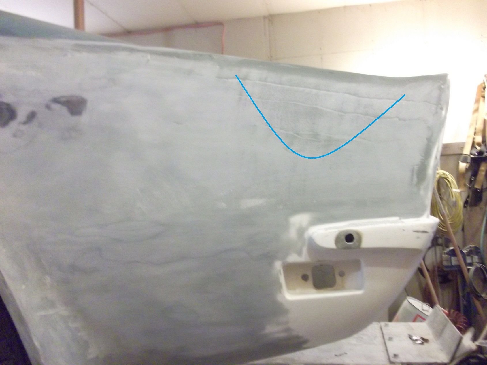

I said I had the driver side quarter panel done but there was not enough filler in upper right corner of the panel. As I was sanding away the filler I was able to see the true shape of the dip in the quarter panel and it is more of a "U" or "V" shape (shown by the blue line) than the rectangle I previously drew:

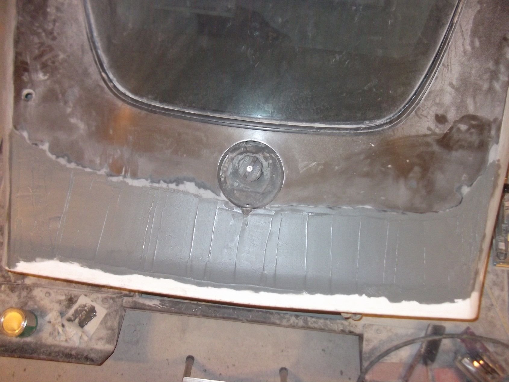

I started adding filler to the rear deck where I joined the two panels so I can better blend the quarter panels into the rear deck:
This looks like its going to be the hardest area to get right with its concave surfaces. You can't really spray it with water to see how smooth it as as the water pools on the panel and is too thick to show high and low areas. You also can't really sand with something flat to get that concave shape. At this point I'm not sure how I'm going to do it, perhaps just with 60 grit with the palm of my hand which is very slow going and probably will be pretty wavy. I've sanded down that first application of filler and am putting on another to get enough thickness that hopefully I can shape it right without going back down to the fiberglass. Wish me luck!

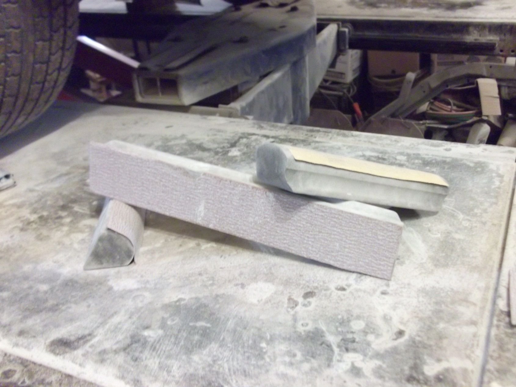

I've got this curved sanding block (bottom of the three) which will work well for parallel to the ducktail:

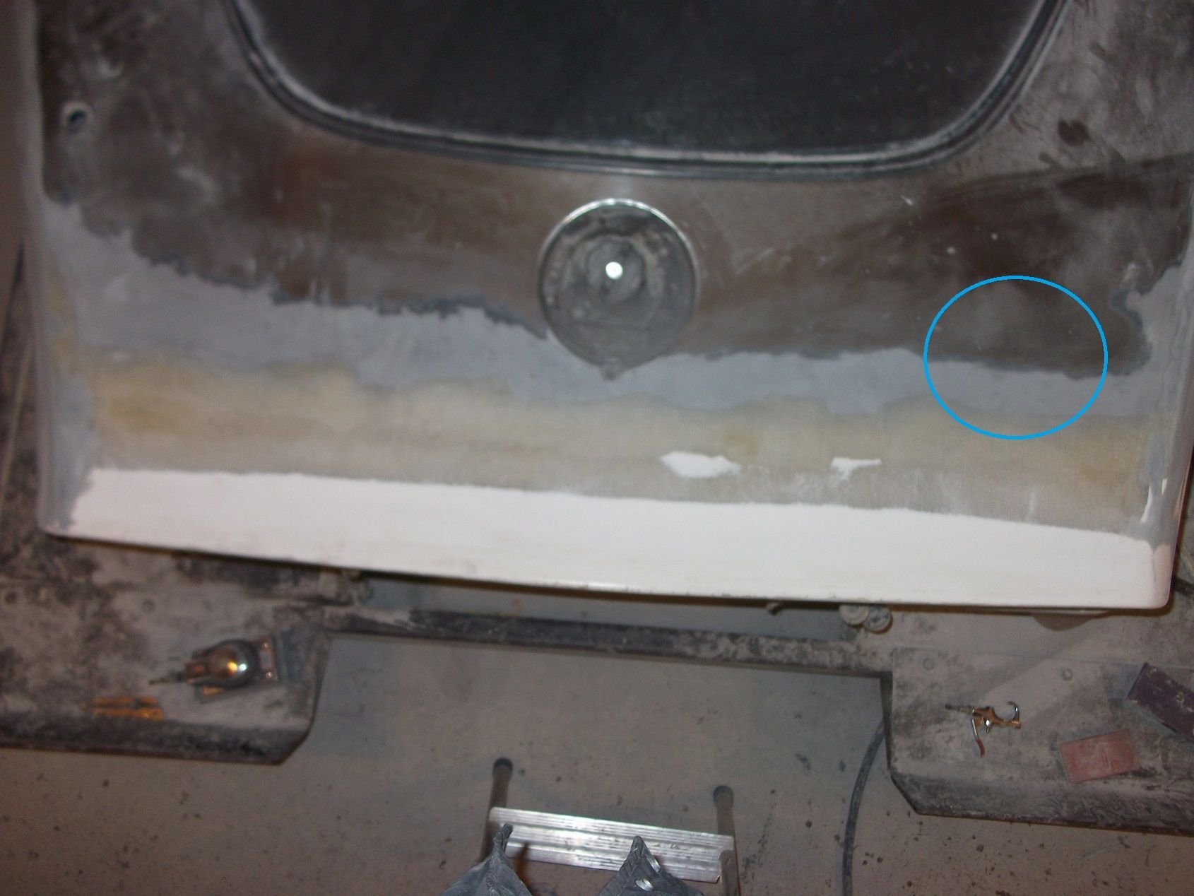

The really tricky area is going to be in the blue circle in the picture below:
That's where the deck panel rises to the lower corner of the rear window. At that point you've got a bulging area that has to be merged into the flatter/concave surfaces down and to the right of the bulge. I don't think the rounded sanding block is going to work there as it will be too long to use diagonally (it's about 1' long) and sand the smaller concave areas. I could cut 4" or so off the sanding block, but I hate to do that because I'll eventually need the full length. I was thinking maybe something the size of a soup can although an actual soup can won't work because the rims at the top and bottom stick out farther than the body of the can.
