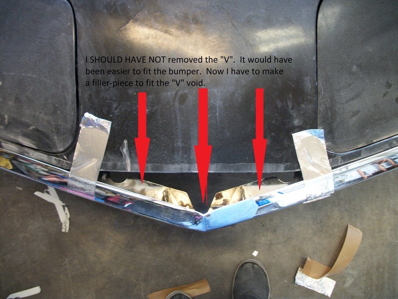

Originally Posted by Priya
That's encouraging to hear, doorgunner. I started carefully reading through your nose conversion a couple of weeks ago.
Be sure to post a pic any time you have a question.....I made some stupid cuts when I first began modifying the nose....for example......
AND........I never should have notched the fenders......

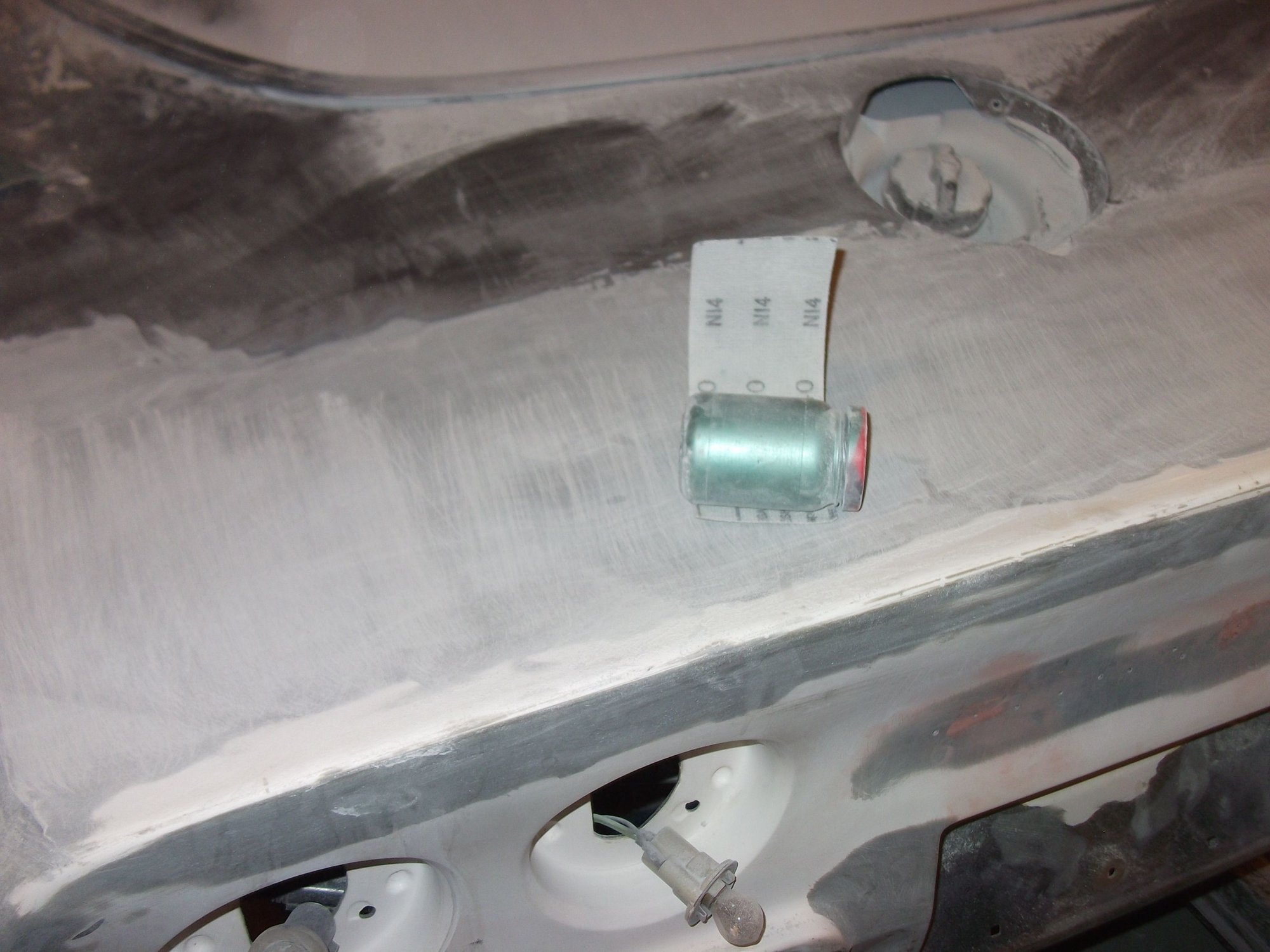

After some searching I came across a sanding block that suited me for sanding the concave surfaces on the rear deck, a glass jar that had garlic or something in it:
I would have liked it to be 50% longer but it works okay. I wrapped a piece of 40 grit around it to sand off most of the 3rd layer of vette panel adhesive/filler, you can see the deep sanding scratches in the picture. I'm a little nervous about using a piece of glass for this as I lean on it pretty hard to get rid of the bulk of the excess filler before I move to a long half round Durablock sanding blocks. So far so good, hope I don't cut myself,
I broke it to the spousal unit last night that I wanted to remove the gas tank to do the fiberglassing on the inside of the passenger side quarter panel. He made some suggestions and encouraged me to re-consider doing it with the gas tank in place. I've been sanding the inner surface and using a light to see what I'm doing. I told hubby it sounds like a nightmare to try to layer in mat and resin while trying to hold a light to see what I'm doing, I can just imagine all the fiberglass resin in my hair and the mess that would make. I was able to get air tools in between the frame rail and the quarter panel but in the corner by the tail light I had to do it by hand which was pretty slow going but I got the inner surface prepped for fresh mat and resin. Hubby was surprised I could get air tools in there and suggested trying the headband mounted light. I tried it out but to see in the corner by the tail light I have to stick my head between the frame rail and the quarter panel and the light on my head isn't pointing into the corner so I can see what I'm doing. So we're going to remove the gas tank soon. Too bad we filled it half up with gas, hubby has to burn off some gas in his truck so we can transfer it to his truck hopefully in four or five days and perhaps take it out the following weekend.
I had better luck feeling the proper shape on the rear deck and think I've got it pretty close but I sanded about a 4 inch oval through to the fiberglass underneath. Now I'm debating on whether or not to add a fourth layer of filler to sand or to leave the fiberglass showing with the idea that the primer will cover enough to prevent the two types of material from showing a line through the paint where they meet. I figure it will take me 6 to 9 hours to apply another layer of filler and get it sanded back down to where it needs to be. I don't really want to spend the time on that but on the other hand I don't want to start prepping another new area before I get the quarter panels and upper deck done and if I don't work on the upper deck I'll lose probably the next 5 weekdays until the gas tank is out. We've been having daily high temperatures of around -30 C so it sure is tempting to stay inside while it's so cold.
