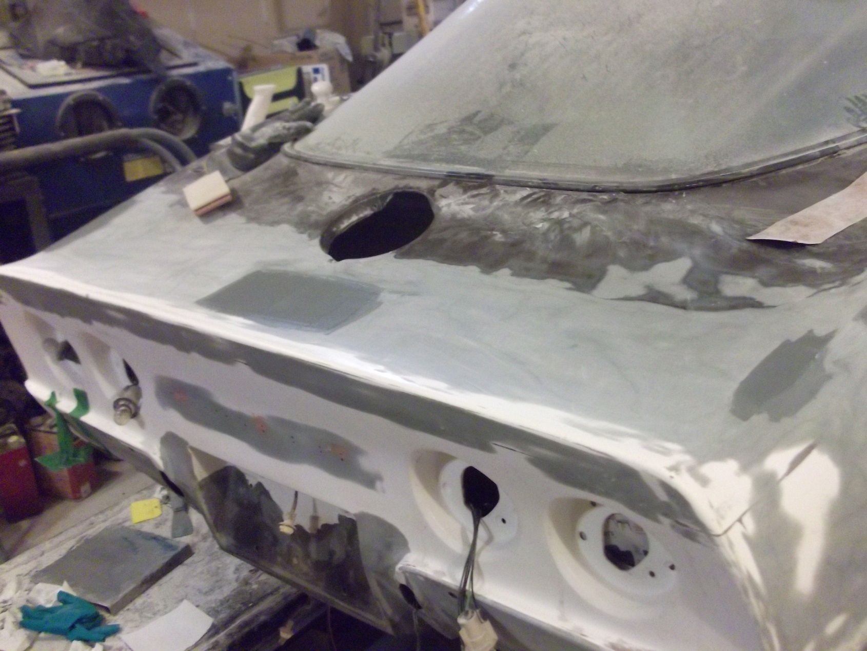

Two days ago we removed the gas tank. There was lots of grunting and swearing, even my husband had trouble getting the rubber lines off the tank this time so we could remove it. I added some mat and resin to the inside of the passenger side quarter panel so I could shave the outside of the panel down without going through. I also added some mat and resin on the inside of the deck panel just between the gas tank opening and duck tail where you can see the oval of fiberglass showing through on the top side:

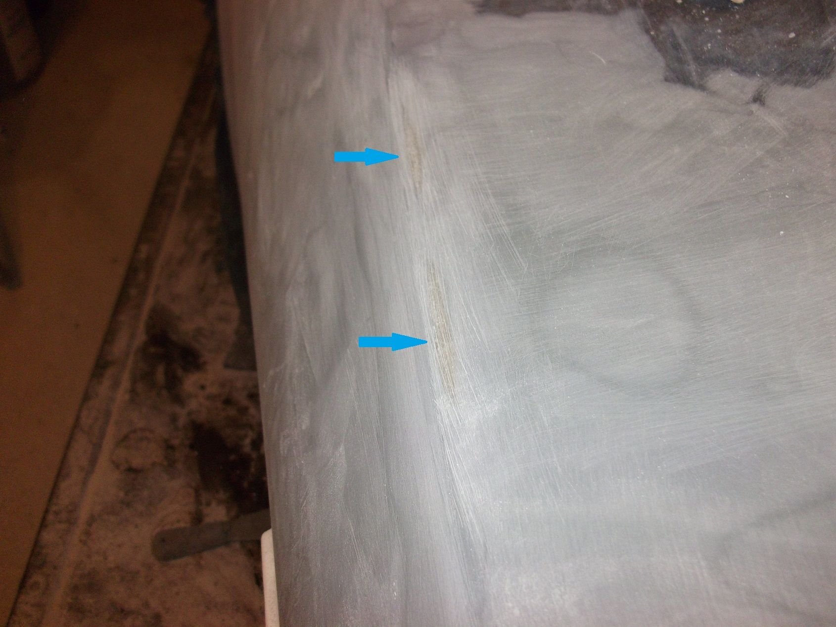

I was thinking I had the upper deck done, but hubby insists I cover the fiberglass with Vette Panel Adhesive/Filler so I covered a few different spots where it was showing through (blue arrows In picture below. Picture is facing the passenger side quarter panel):
The blue arrows in the picture below show the other two areas where I've sanded down to the fiberglass and will be covering with filler. I sanded all the areas where the fiberglass was showing through with 80 grit to lower them a bit so that when I sand the new filler I won't go back down to the fiberglass again:

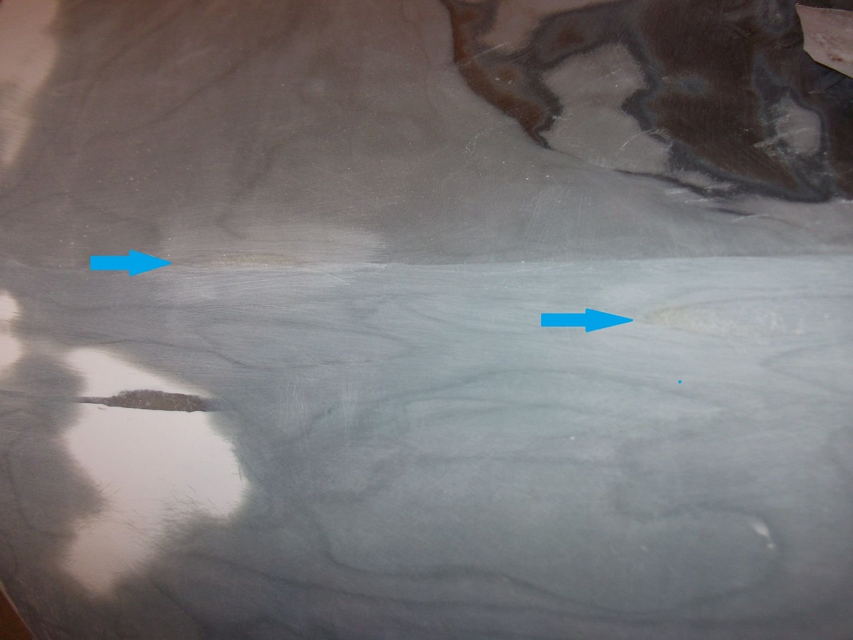

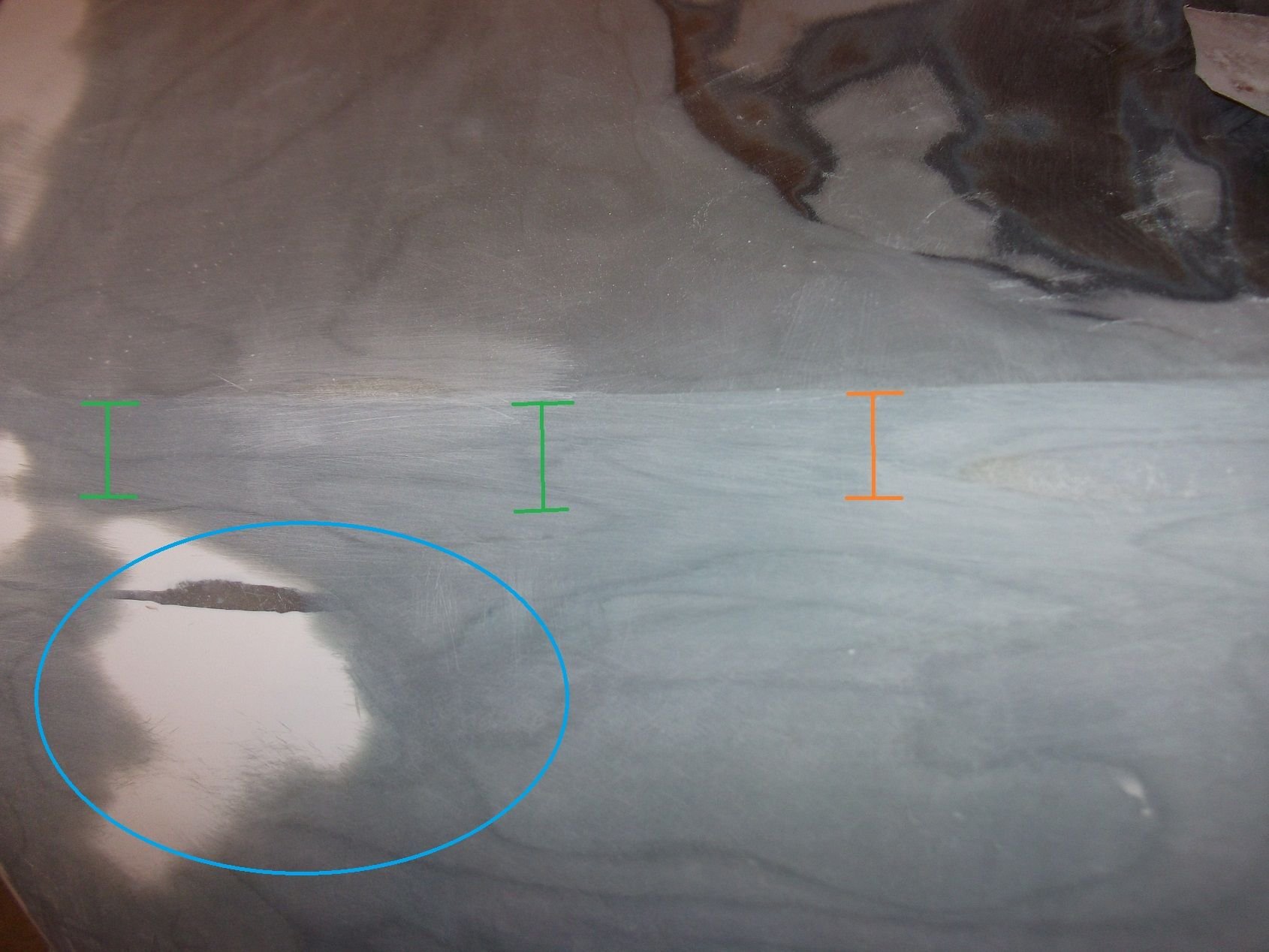

I started shaving down the dip on the passenger side quarter panel roughly in the area of the blue circle in the picture below:
I didn't get very far when I decided I couldn't remove much more material. At the upper part of the quarter panel between the green lines it's fairly flat. To the right of the orange line the 79 upper quarter panel is more rounded and you have to blend the two together. By the time I got about 1/32 of an inch removed from the outside of the passenger quarter panel I realized if I went much further I'd have to flatten out more of the curved area on the upper quarter panel to the right of the orange line. I didn't want to do that as I would be sanding down to the SMC in that area and I don't want to thin the factory SMC there any more.
I sprayed water on both quarter panels and compared and just that little bit of shaving on the passenger side changed a slight bulge on the quarter panel there to a slight dip which really changed the appearance. The passenger side quarter panel now looks much more like the driver's side. Because the lights on each side of the car are in different locations and from different angles I couldn't tell for sure if they are exactly the same but they're close enough that I can't tell if they're not. I told hubby I may not have needed to add the mat and resin on the inside of the passenger quarter panel and he said "If you figure that out don't tell me because I don't want to know we removed the gas tank for nothing" - oops
Tomorrow I'm going to spend some more time comparing the two quarter panels and decide if I'm happy with them for sure. If so then I'm finally done the quarter panels. I'll also shave off most of the mat and resin I added to the inside of the passenger side quarter panel as it's thicker than it needs to be and hubby says a big variation in thickness of the panel can eventually result in cracking where the thick part of the panel meets the thin part

this is where 2 different colors of primer may help. when you start to hit diff color, you know to stop there...
Old Jan 26, 2022 | 12:42 PM
  #1717
Priya's Avatar
Priya
Joined: Dec 2009
Posts: 6,397
Likes: 649
From: Saskatoon Saskatchewan

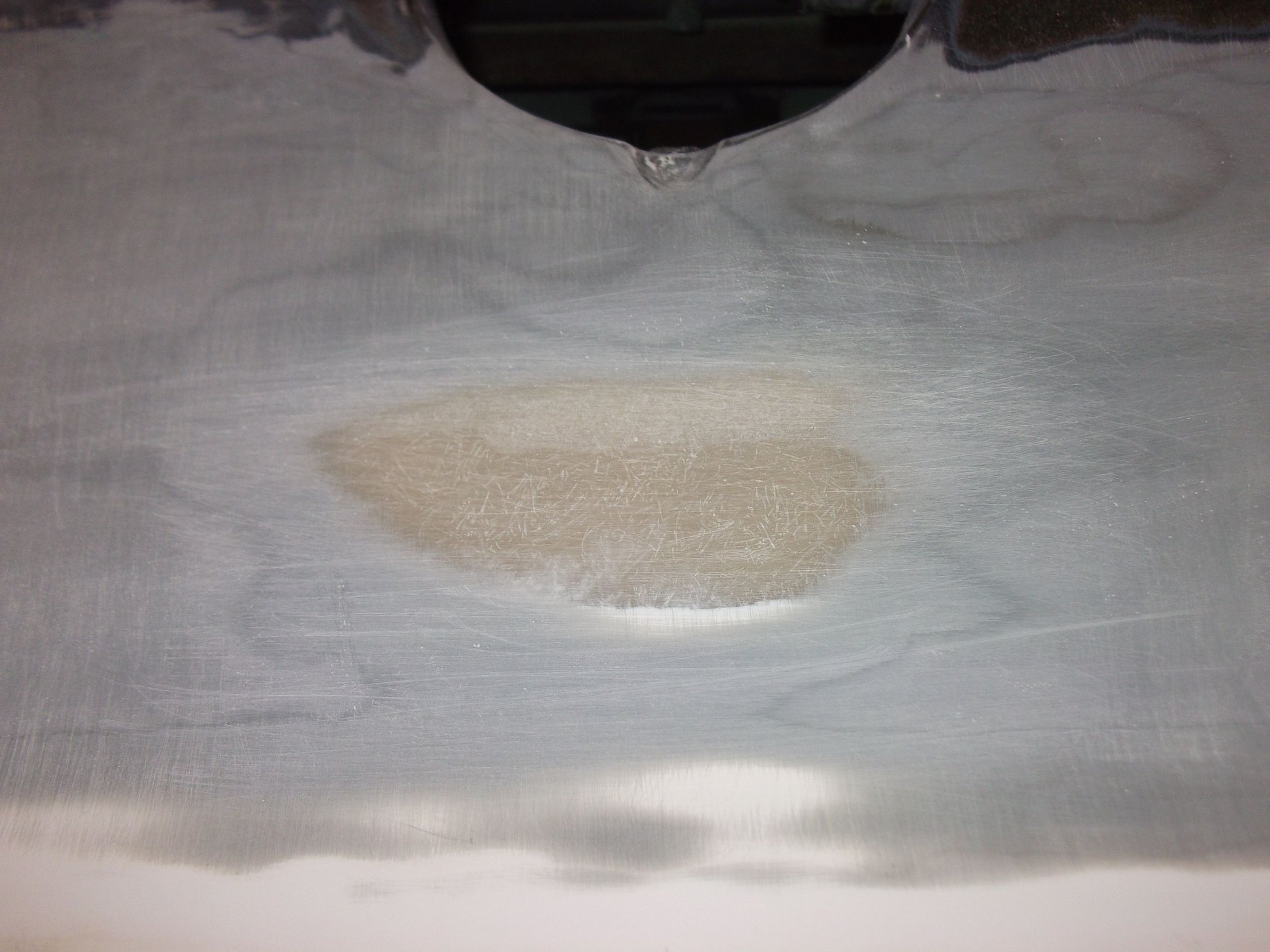

Sounds like a good idea. What I've been doing is when I sand through the filler to the fiberglass I go over the area where the fiberglass is showing through with 80 grit and make it a little lower so when I add and sand back down more filler the fiberglass hopefully doesn't show through any more. There's been many cycles of that.
I think I'm going to make a contour gauge like doorgunner did and get a more accurate comparison between the dip on driver's and passenger's side quarter panels. Even with a straight edge I find it pretty hard to see well enough to get a really good comparison between the two sides.
