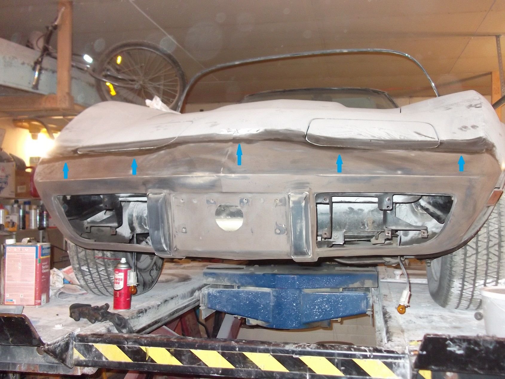

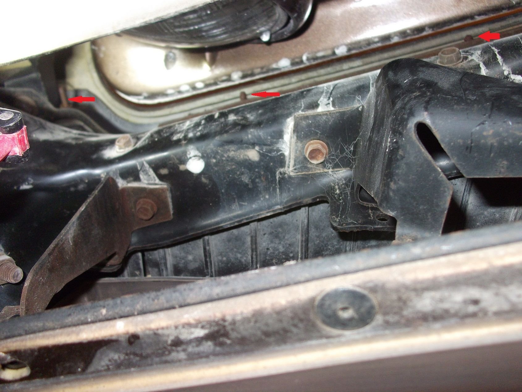

I've started working on the front end of the 79. I figured I'd do the sanding on the front bumper cover and then loosen the nuts on the studs holding the front bumper cover to the body. I soaked the nuts and studs with penetrating oil because as you can see in the picture below the studs have an even layer of rust on them (red arrows) and I read about them commonly breaking off and I was hoping to avoid that. The six nuts I could get at weren't stuck at all and readily turned although they weren't so loose that I could remove the nuts with my fingers. To me it doesn't look possible to get at the other six nuts without removing the headlight buckets (although I did try) so that's going to be next. It doesn't look like I'll have any problems with broken studs on the bumper cover due to frozen nuts.
I sanded the bumper cover with 120 grit where it had stone chips and nicks and 180 grit where it was smooth (I've got extra 180 grit and not enough 120 grit). I had a go at removing the screws holding in the grills and got a couple screws loose but then the screwdriver slipped when I tried to loosen the remaining star screws with a lot of pressure. I called in the husband and he said GM like to use these special screws that looked like a star but I think he called a "Posi-drive". He found this tiny bit and it fit pretty tight in the screw head but I still couldn't get them to turn without the screwdriver slipping out of the screw heads. I was surprised to see him kind of bounce/lean on each of the screws and using some mysterious body english he got them all to start to turn with a "snap". I wouldn't have thought there could be some sort of trick to leaning on a screwdriver but I guess decades of working on cars teaches you how to do things normal people can't figure out.
You can see in the picture below I used too much penetrating fluid and even though I wiped it down once already it's creeped back onto the exterior where the bumper cover meets the body as shown by the blue arrows below. I'd like to take the car to a car wash once I get the headlight buckets out so the oil won't be a problem but that doesn't really seem practical right now. Other than dealing with the penetrating oil the front bumper cover is ready for primer. I want to loosen it off a bit before I fiberglass the bonding seams on the front fenders.

other 6 bolts? there is about 18 all told. here they are... https://www.ebay.com/itm/25188257016...evt=1&mkcid=28
Oh dear, I could only see 12. This promises to be more fun than I was hoping to have.

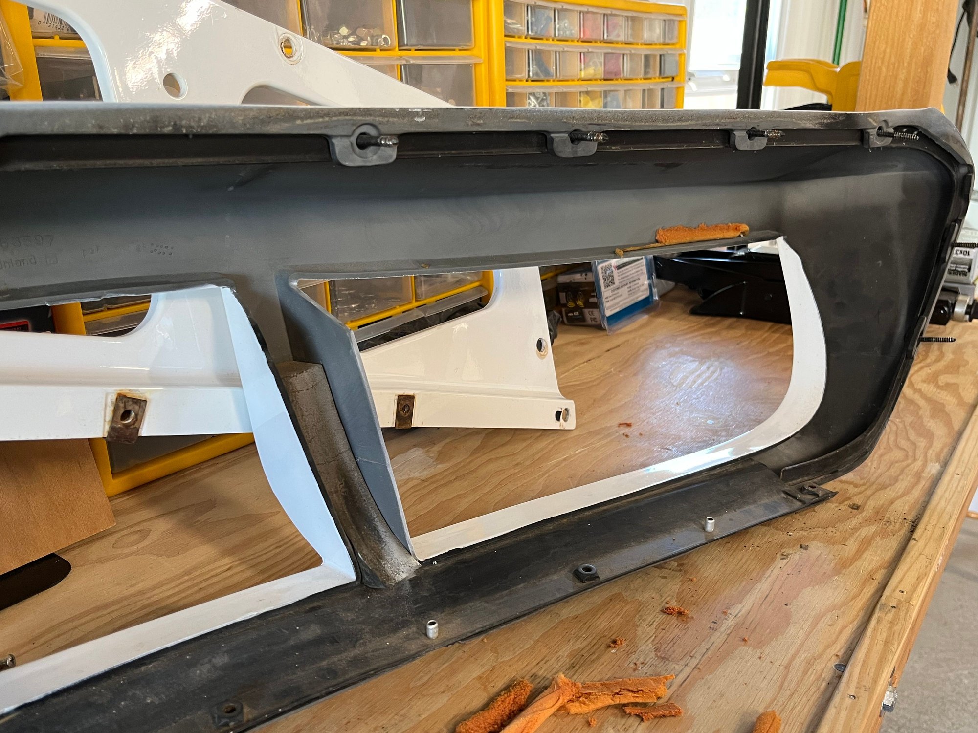

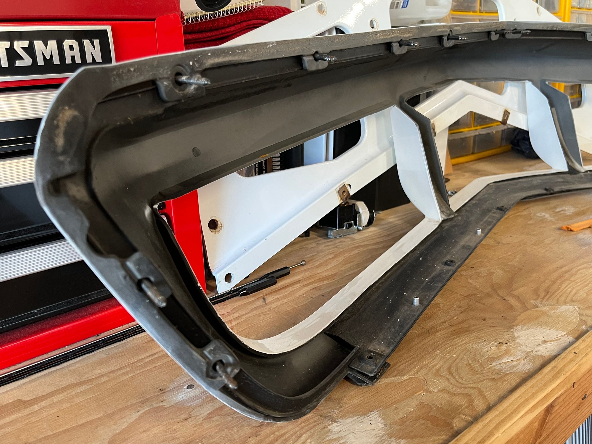

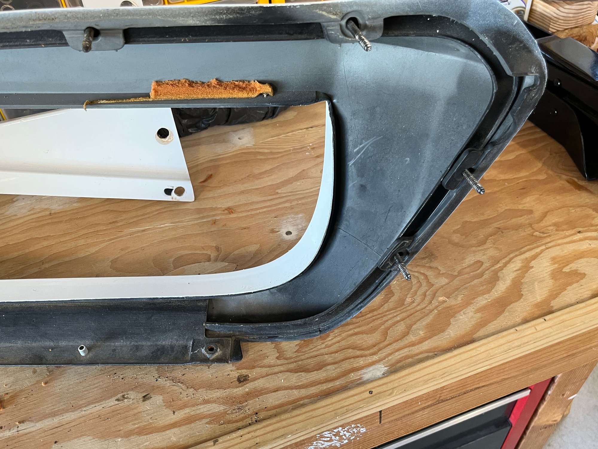

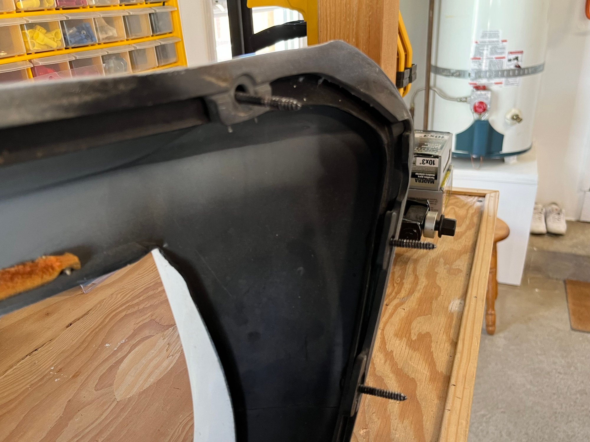

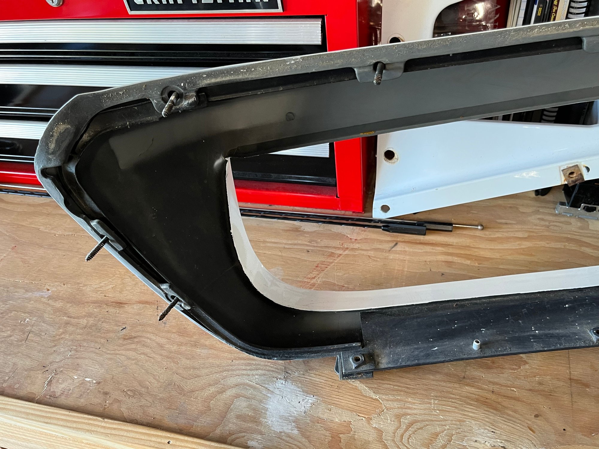

I just went though removing the front bumper cover off my 73.
You don’t need to remove the headlight buckets.
Just push the headlights up and you’ll have access.
It was that simple.
Once you remove the bumper cover the headlight buckets will easily pop out the front.
I used a 1/4” drive ratchet and long extension on a couple and a short extension for the others.
For some I used a 1/4” screw driver type handle and the nuts turned right off.
A prior owner for my car had replaced several of the nuts and used 5mm (if I remember correctly) metric speed nuts instead of the oem nuts.
So if your SAE socket doesn’t seem to be working try the metric size.
There were several U Tube videos that I watched that said to get to the far corner nuts, you had to cut access holes in the front inside of the marker light indents (after removing the side marker lights) to gain access to those nuts (BS).
One video I watched said it could be easily done without cutting the access holes.
Well I’m happy to say I’m glad I found that video, because those two in the upper corners were easily accessed using a box end wrench and came right off.
It turned out that after I laid down underneath and took a good look the bumper cover came off without no trouble at all.

If you look closely at the photos I posted you can actually see there is a metal frame that the screws go through and that metal frame would keep the shape of the bumper cover intact.
At least I would think it would, but I’m certainly no expert.
