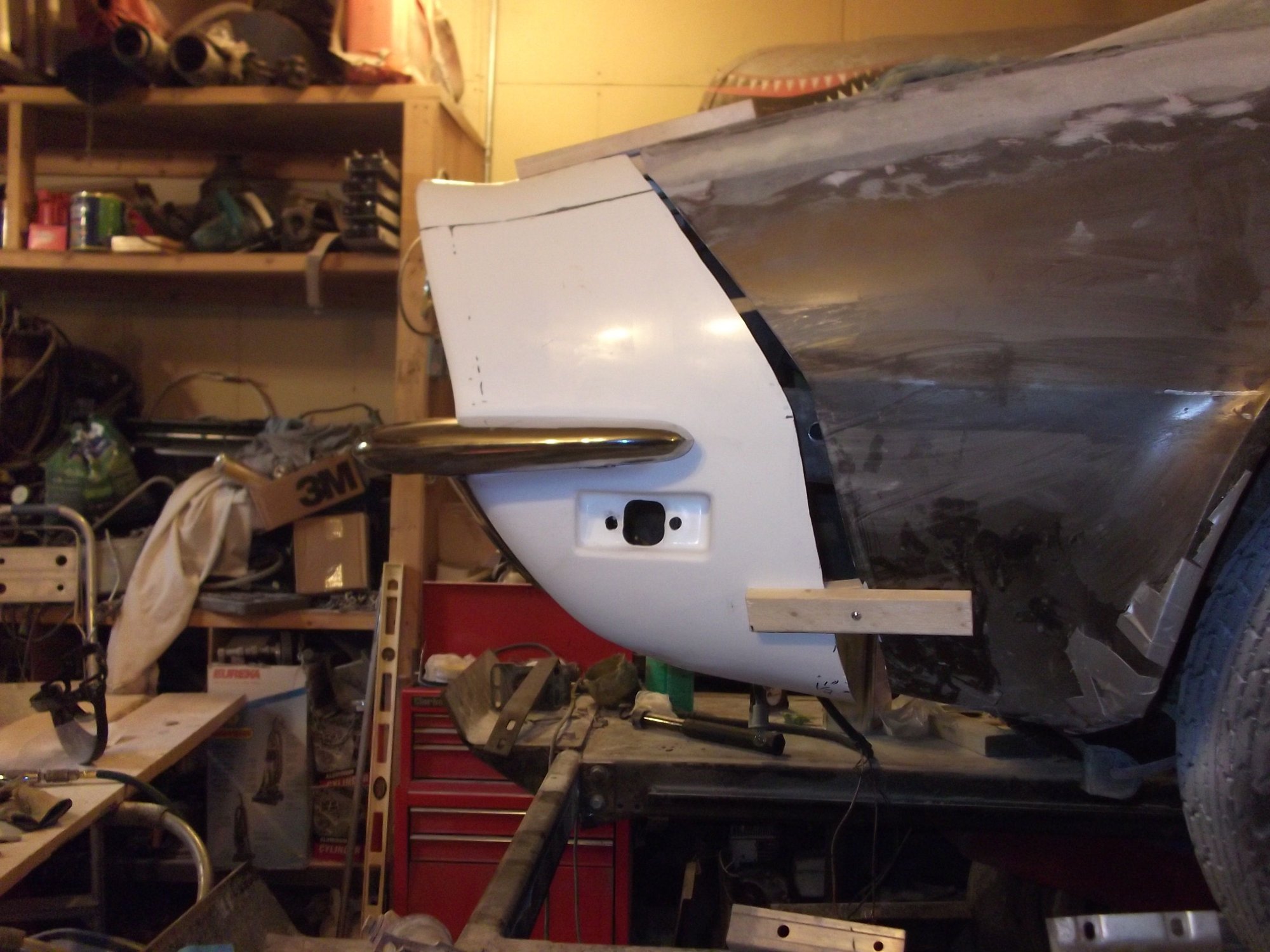

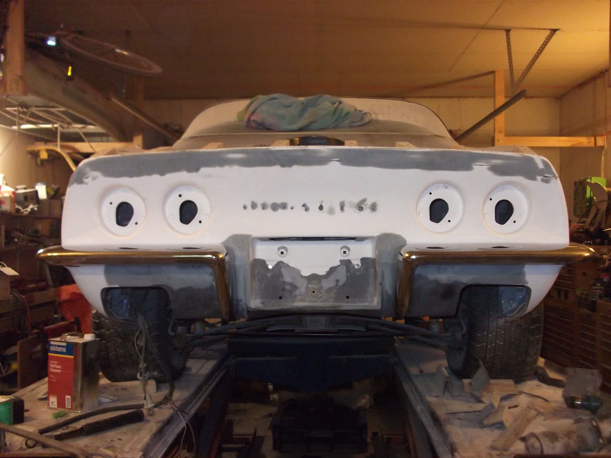

So, I have the bumpers fitting in a manner that is acceptable to me. They're not perfect but I'm pretty sure its the best I can do. I didn't really keep track of time but I guesstimate 15-20 hours to get these sorted out.

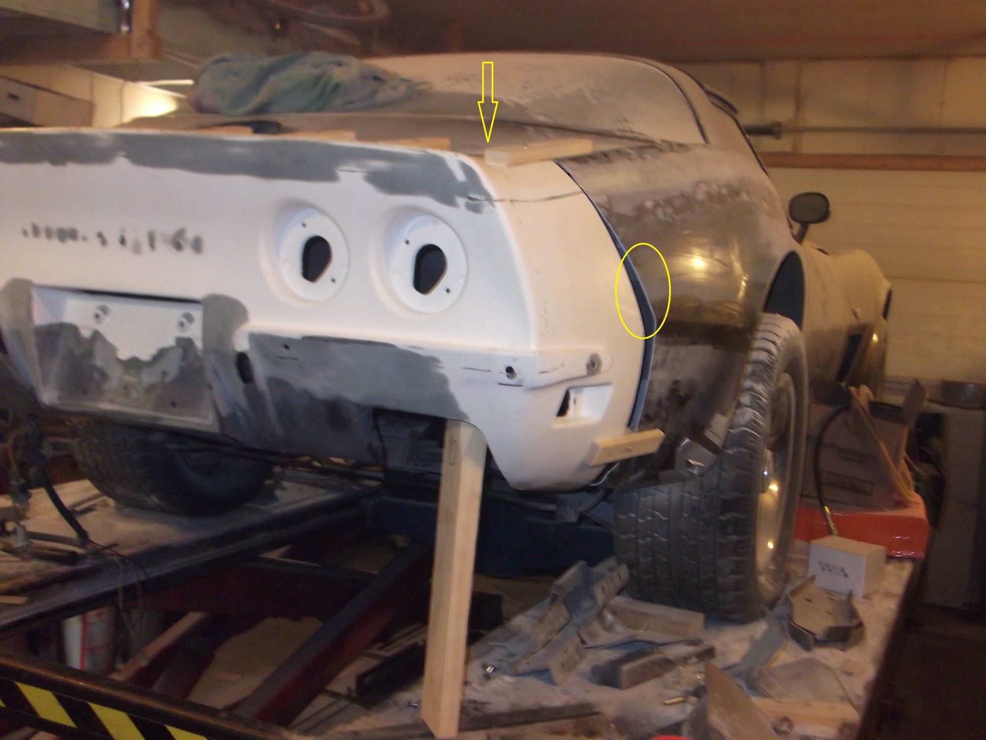

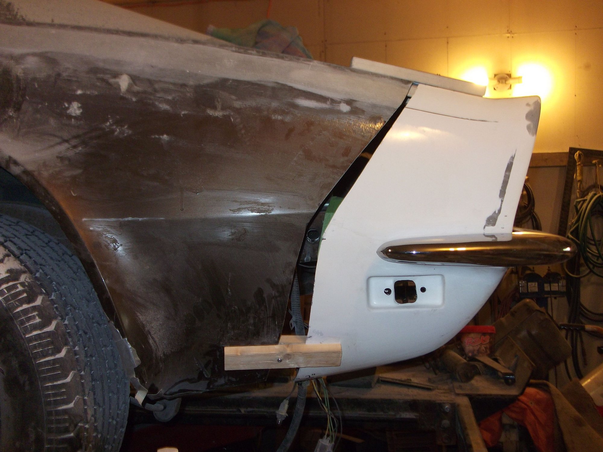

I wasn't happy with the fit I had on the quarter panels so I spent several hours trying to come up with a way to improve on it. I was able to get it pretty close by inserting a 2X4 inside the 70-73 ACI rear clip on both sides and pushing up at the point where the arrow is. The quarters line up better now and are pretty close to flush except for a manageable gap where the oval is. The driver's side is actually even closer. I can pretty much just glass from one quarter to the other now and there isn't too much of a difference to make up.

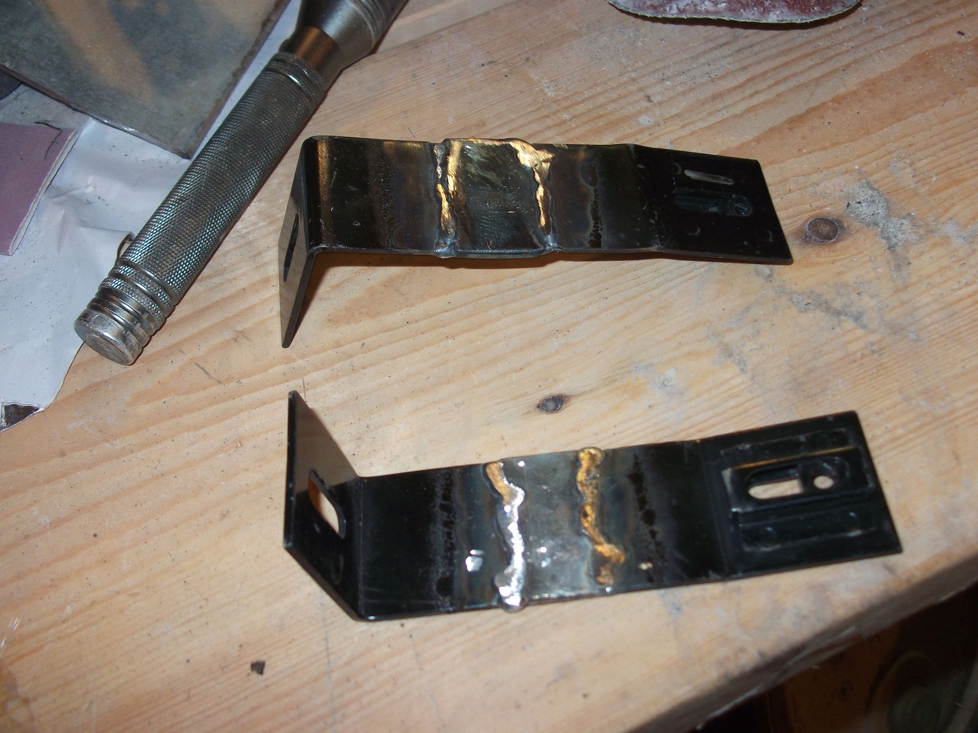

I also competed the modifications to my first pair of brackets.
Before:
After:

Originally Posted by Priya
I will try to attempt to clearly explain this and use it if you like... or.... don't and do it as you see fit.
Knowing that you are going to be doing serious laminating. Do not try to keep your laminating to a minimum. Doing so can cause you more problems and effort later on in the modifications.
I would decide what panel I am going to try to keep in the radius I want. And this also means the body contour in the factory quarter where it is more defined than the rear clips and it not being in the same areas due to body design changes.
So..if you are wanting to keep the factory quarter as it is and try to get the rear clip to mate up to it..I would make a cut or cuts in the rear clip to relax the panel so I could use the method of wood and bolts to bring the panels together and getting them FLUSH as possible....Just like you did across the top of your rear body area.
Now...If you want the rear clip to stay the same and try to get the factory quarter to fit up better and flush.....I would cut the quarter and use the wood method you are using and get the panels to be flush.
Keep in mind that this may not sometimes be possible to get it all perfect at this time. So it depends on how much stress is on a panel when you are trying to draw it up to meet another and get it flush.
Making these cuts can aid you later on in this area so you do not have such a deep step that you have to deal with. I prefer..at all costs...to not have my panels be so far from flush that I have step that I have to try to build up ....when I know I can relax the panel and get them together and speed up the repair and get my lamination to go faster and look better. Just my personal preference on that. It is not like I have had to do a lamination where it is stepped and not flush...but if I can get around it..I do so.
Make sure that the wood that you use is not too long and cause for a problem due to the inside curves these panels have. The wood may need to be slightly shaped.
And if you do all your prep and plan on lamination it up from the backside...makes sure you taper your edges very well like how I showed it in the thread on the John Lingenfelter thread showing how I filled in the heater core box hole and how tapering it correctly does aid in the repair after the fact. Or don't do it and prep it as you fell like it.
And also understand that in a scenario like this...as you may ahve already figured out....you might have to laminate up the ares between your wood blocks and then remove them and prep it again and then fill in the areas where the wood blocks went.
