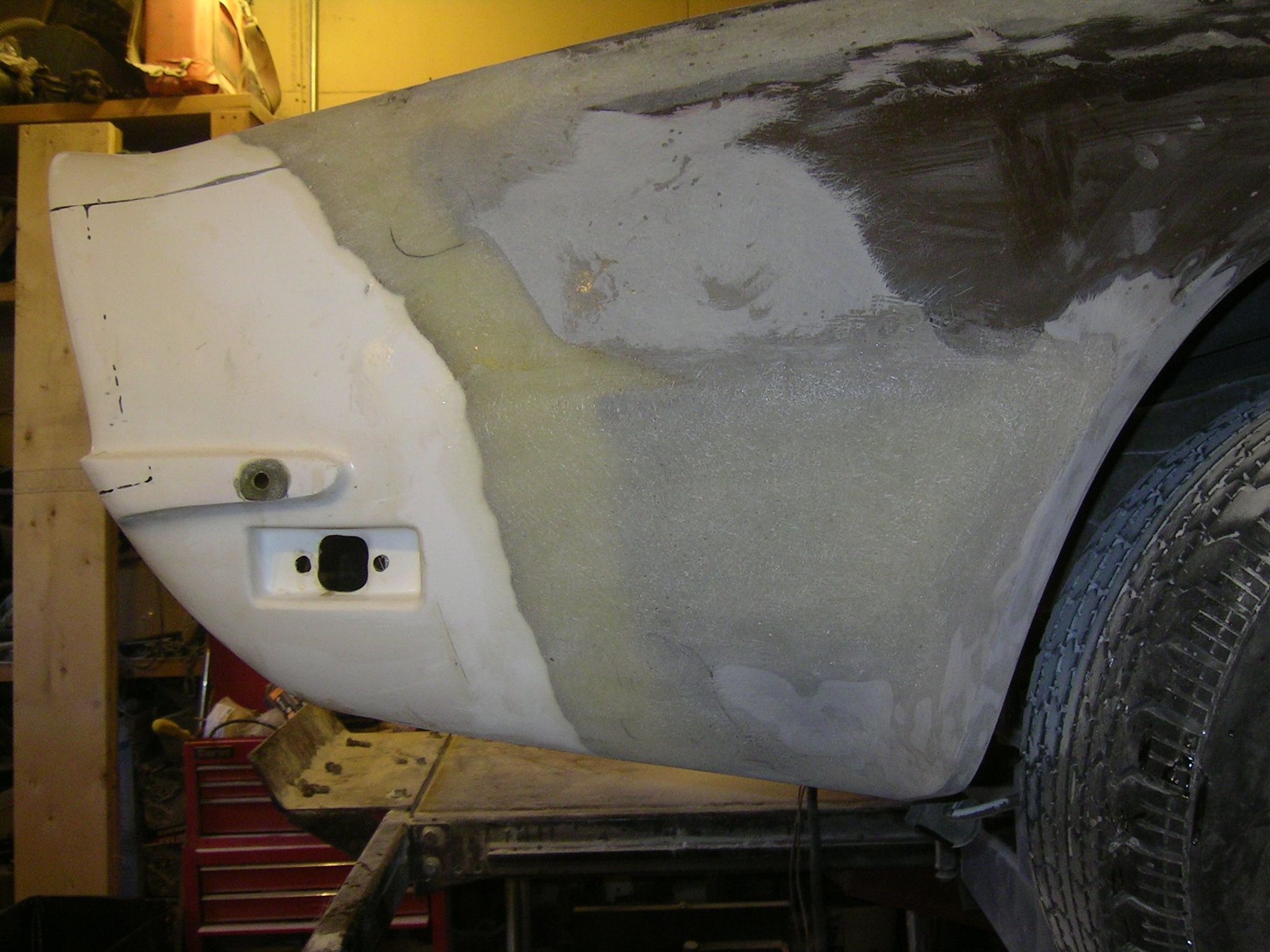

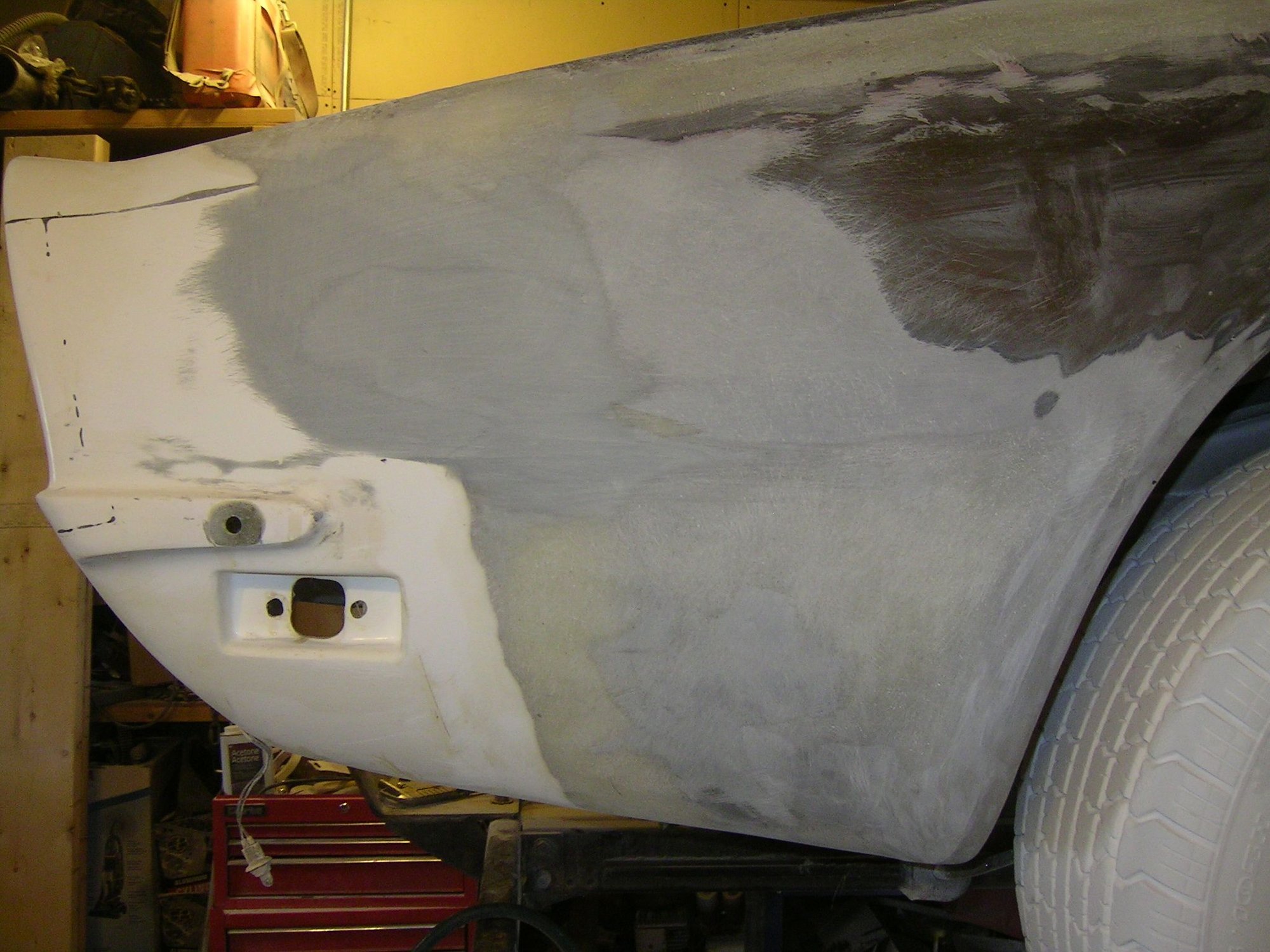

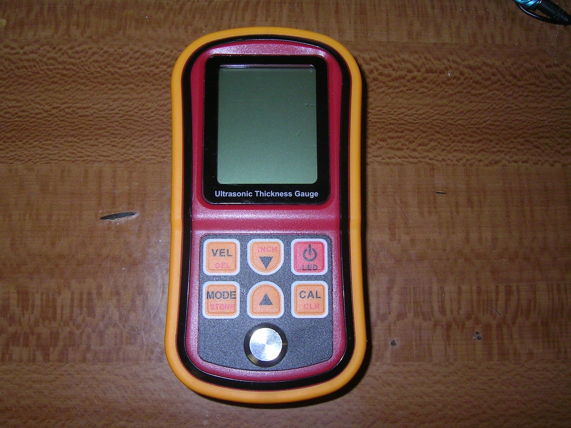

So, I got a late start on the car since having it put away for the winter, its been pretty hard to get back into the routine of working on it regularly but I'm gradually getting there. I leveled the car to assist in re-establishing the mid quarter panel horizontal character line that is at a slightly different angle on a 79 compared to a 68-73. I've got both quarter panels to the point where I need to start using a straight edge and spray them with water to tell if I've got them smooth and the right shape. Here's where I left off last October and where I'm at now:
Before:
After:
Perhaps you can see the little black dots a few inches above the side marker light and the mid wheel well area, those are where I'm making the mid quarter panel horizontal character line. So, now unfortunately I'm back under the car in the gas tank area smoothing out the fiberglass laminations so the join isn't overly thick. This is really miserable work and I really hate it. The fiberglass dust concentrates and swirls around and gets to your skin all over. Plus, you can't wear eye protection as it fogs up quickly so the fiberglass grit gets in your eyes something terrible. And because you're sanding over head you have to look up and have the grit fall directly in your eyes. I find the trick is to stop sanding under there when your eyes first start getting significantly irritated, if you wait until you can't take it anymore its a real ordeal for the next couple of days until the grit works its way out of your eyes. I found that about 1&1/2 hours under there is all I can take. Once I get it leveled out inside there I'm going to check the thickness as I don't want any panel join to be more than 1/4 inch think and I'm pretty sure some areas are more than that. To assist my husband bought me this fancy ultrasonic thickness measurer:
We don't know if it will work well enough or not, but I'm sure hoping so! I went through the instruction manual and to my surprise and annoyance its pretty complicated to use but I'll figure it out eventually lol!
I worked it out with my master that I can leave my Corvette in the garage this winter which is a good thing. If I had to stop working in the winter it might take me another six years to finish this off. The problem with leaving the car in there during winter is that when hubby wants to work on a car we haven't been able to get my Corvette back into the garage once there's snow and ice on the ground. The entry to the garage slopes up a bit and then there's about a 1 foot ramp up onto the scissors lift. There just wasn't enough traction in winter to get the Corvette up all that and back onto the ramp thanks to these tires:
So, I bought a pair of winter snow tires to put on the back and said to hubby with the snow tires and a couple of bags of sand we can get the Corvette back up the ramps in the winter so we can remove my car whenever he wants to work on one of his. He reluctantly agreed to this.

I know I can be a bit picky from time to time but I can say I am impressed that you are going to the lengths of seeing how thick your repairs are. I don't even do that. All I look at when I am doing something custom like what you are doing is that the transitions are smooth and no major obvious lumpy humps that stick out.
i do have a friend who does have a tool similar to what you have shown where he comes by and we check the thickness of the steel of a rusty frame.
Keep up the good work. I wish I could send you my positive pressure fresh air breathing system. I have a hood I can put on that blows air in so there is no way dust can get in my eyes and you can work away as long as you want in that regard.
DUB
Thanks Dub. I'm hoping after I get the insides of the panels leveled out I'll be done underneath the car in the gas tank area. There's a place just where the deck panel curves up into the duck tail on the passenger side that I think I may not have thick enough but will see with the ultrasonic thickness gauged. I'm sooo looking forward to having this rear part of the car done. Hubby is insistent I better have it done and the factory gas tank back in by winter. I don't think that should be a problem, but who knows with the way things often seem to go
