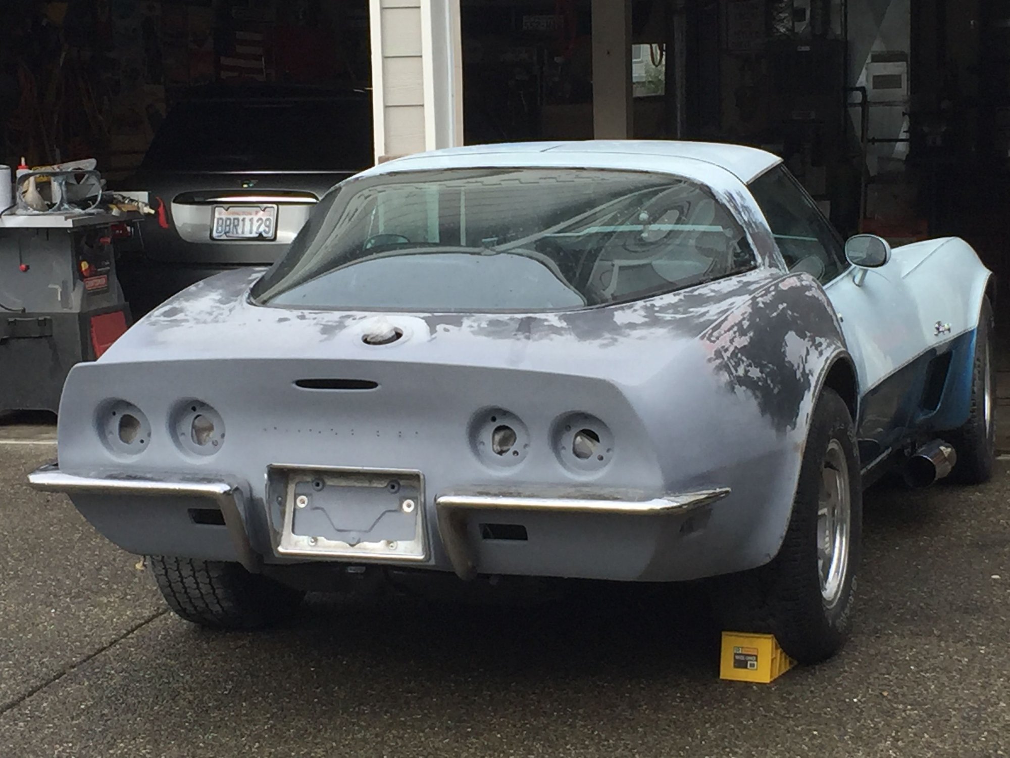

Originally Posted by Pzark
Hi, I came across your thread, made me smile as I have been doing something similar but I made my own molds for the back based of the 69 and a Manta Ray inspired new front bumper. Been a lot of fun. I was able to fasten to the existing body flanges so can in theory reverse back to the old bumpers not that I would ever do that. I will keep following your thread looking forward to seeing the finished vehicle good luck with it.
That's really something. It'd be great to see more pictures of your work as you've done it if you have them.
Old Dec 16, 2018 | 01:24 PM
  #1205
derekderek's Avatar
derekderek
Posts: 13,082
Likes: 3,399
From: SW Florida.
Especially pics of the rear. And you used bumper flange? So you basically built 72 spoiler and tail light panel onto a 75-up glass bumper? We want details.
Thank you for your interest, I do have lots of pictures but this is Priya’s thread and I do not want to detract from it. However here is a picture of the rear end that you asked for hope you like it.
Wow, that looks great! That helps me again feel like I've made the right choice to do this to my 79.
I'm sure a lot of people would enjoy seeing you start a thread on your project if you have more to share.

I am especially interested in the details of creating the bumper "cover". I have a taillight panel and bumpers-brackets. Torn between Priya's and doorguner's method of cutting and glassing and killing a new glass rear bumper by creating this type setup. I am assuming if you kept bumper flange intact, you essentially created a 68-73 tail panel on a 75-up bumper cover. I have a busted-to-crap front bumper I am gonna try the other end with, but I also have a complete 71 nose
Old Dec 16, 2018 | 09:34 PM
  #1211
Priya's Avatar
Priya
Joined: Dec 2009
Posts: 6,397
Likes: 649
From: Saskatoon Saskatchewan
I'm not sure how he/she did that but the tricky part is the horizontal character line midway up the quarter panel just above the rear bumper and going forward. On C3s this line starts mid way on the quarter panel just behind the rear wheel opening.. On the chrome bumper cars it moves backwards close to paralell with the ground while on the rubber bumper cars it rises more as it moves back to the rear bumper. So, those two character line differences between chrome and rubber bumper cars have to merged somehow, I'm curious how that was done.

Originally Posted by 7t9l82
Actually there is a guy here in Florida that makes a kit like the rear, he has a more stock front end. Nice job.
"Don" hes good people..
I believe something to point out is dons "kit" is made to bolt on the only one like that, although some glass in dons part.
What it apoears to me pzark is doing is another version of what priya is doing involving a lot of glass work, bonding, filling, smoothing etc,
Not "bolt on" by a lot more than a few degrees, and far from easy to reverse but why would anyone want to go back, this looks blows away stock.
Its always interesting and my mind engages when people solve the same issue in very different ways yet all end up with a great end result.

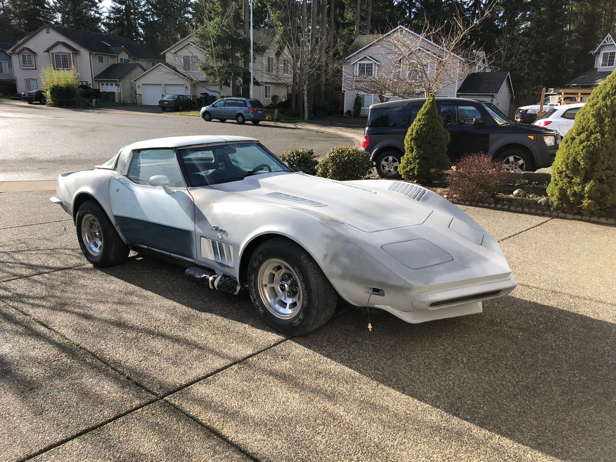

So getting back to Priya’s car I am curious what color blue are you going with and can you take some pictures showing more of the finished back of your car, I am very interested to see it.
I actually have yet to decide on the blue. If I do it will be 2015 or so Ford Blue Candy Metallic. If not the blue, then House of Kolor's Hot Pink Pearl. My clear first choice is the colour below, but I haven't found anyone that has a code for it and I don't have the money to continue painting test panels to get it so my first choice is pretty much ruled out.
I'll try to get you a picture of the back end of my 79 as it is now. Despite a lot of work, not much has changed visually, lol !
