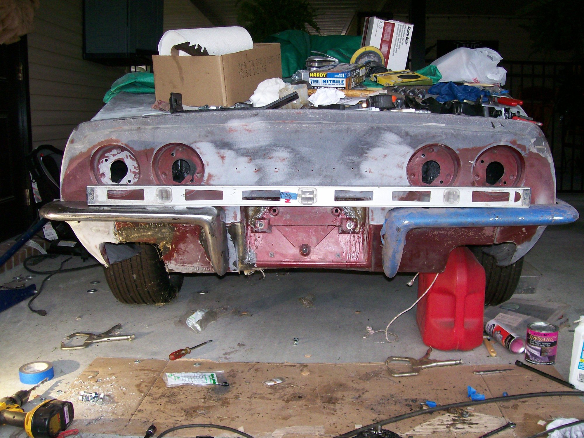

Earlier I mentioned holding a level along the soft edge of the rear bumper where it goes forward along the quarter panel. This is quite a challenge on slippery chrome with its random reflections. The picture below shows this very well when you compare how well you are able to see the horizontal edge of the bumper where the electrical tape is versus where its just chrome. Note the horizontal white reflection on the electrical tape and the crazed reflections in the chrome - its a lot easier to judge where the soft edge of the bumper is by estimating the middle of the white reflection on the matte finish of the electrical tape than it is to tell where the soft edge is on the chrome:
The level also doesn't slip around as much when you're holding it against the electrical tape which is important when you have to continually move your eyes between the bubble and checking whether the level is parallel to the soft horizontal edge of the bumper. Just as I was finishing up this bumper alignment I discovered its even more stable for the level you're holding if you lay down 2 or 3 layers of masking tape along the soft edge of the bumper and then put black electrical tape over top of that. This really gives the sharp edge of the level a significant cushion so its even less likely to slip from where you've lined it up.
I see doorgunner put the level along the top edge of the quarter panel part of the rear bumper. Somehow that never occurred to me, so maybe what I've posted here is besides the point. I can't check on my car as its in a tiny car box for the winter but I wonder if the top edge of that part of the bumper is parallel to the soft edge at the midway point of that part of the bumper.

" I see doorgunner put the level along the top edge of the quarter panel part of the rear bumper. "
I "eyeballed" the bumper as much as I used the level.
I also "leveled" the body/chassis fore/aft/left/right before leveling the bumpers. I probably forgot to mention that in my thread
"Leveling" each bumper on a granite surface....then add modeling clay to the top of each bumper and pressing down on the level until IT is level also helps when leveling the bumpers on the car itself. (I forgot to take pics of the modeling clay method).

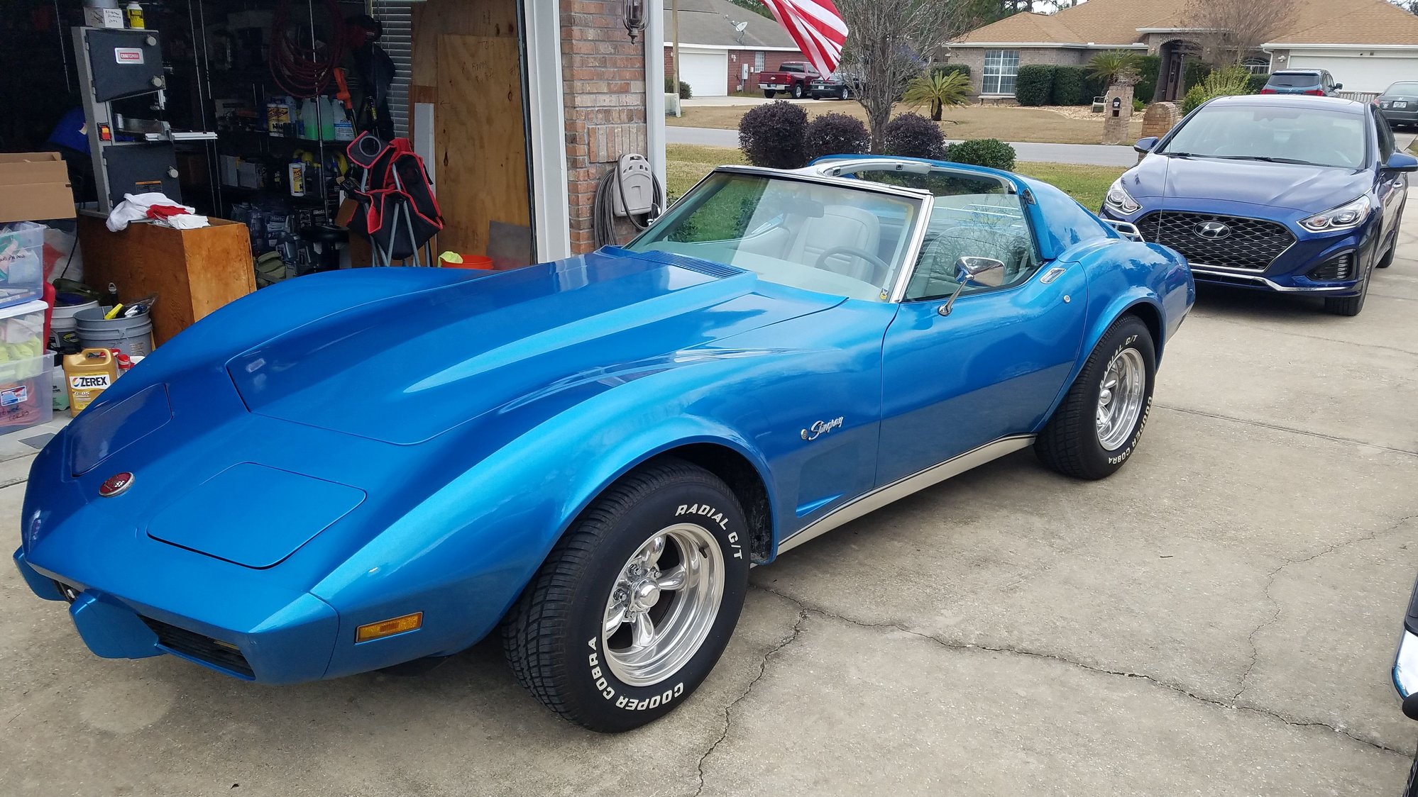

So, hubby said I can get another colour test panel sprayed. I got the idea when CF member Sharkie's blue 76 caught my eye and I asked him to send me some pictures. There's a lot of shades of blue that look great in the sun, but a lot fewer that look really good on an overcast day as well. That's what stands out about the trim code 22 bright blue metallic on Sharkie's car. I can't wait to see the test panel!
I know its just pictures, but this colour looks to have great promise
Old Feb 11, 2020 | 12:38 AM
  #1352
7T1vette's Avatar
7T1vette
Posts: 37,637
Likes: 3,118
From: Crossville TN
Not only a great color.....but a great paint job, too!!!! STUNNING on the 'appearance' meter.

  #1353
OldCarBum's Avatar
OldCarBum
Posts: 14,406
Likes: 8,212
From: Napa Valley California
Bright Blue Metallic and Black are my two favorite colors on a C3.
When I paint my 73, I'll be changing the color from white to one or the other.
So, that's a metallic, is it? I thought from the pictures it was a pearl.
And with the silver interior, that is a fantastic looking combination. I prefer the 78/79 body style over the 74-77, but if I'd come across that exact car I'd have been very tempted to buy it.
Hey, that's my car!!!

Priya, if you paint it that color we have to get the 2 cars together somehow when you get it on the road!
