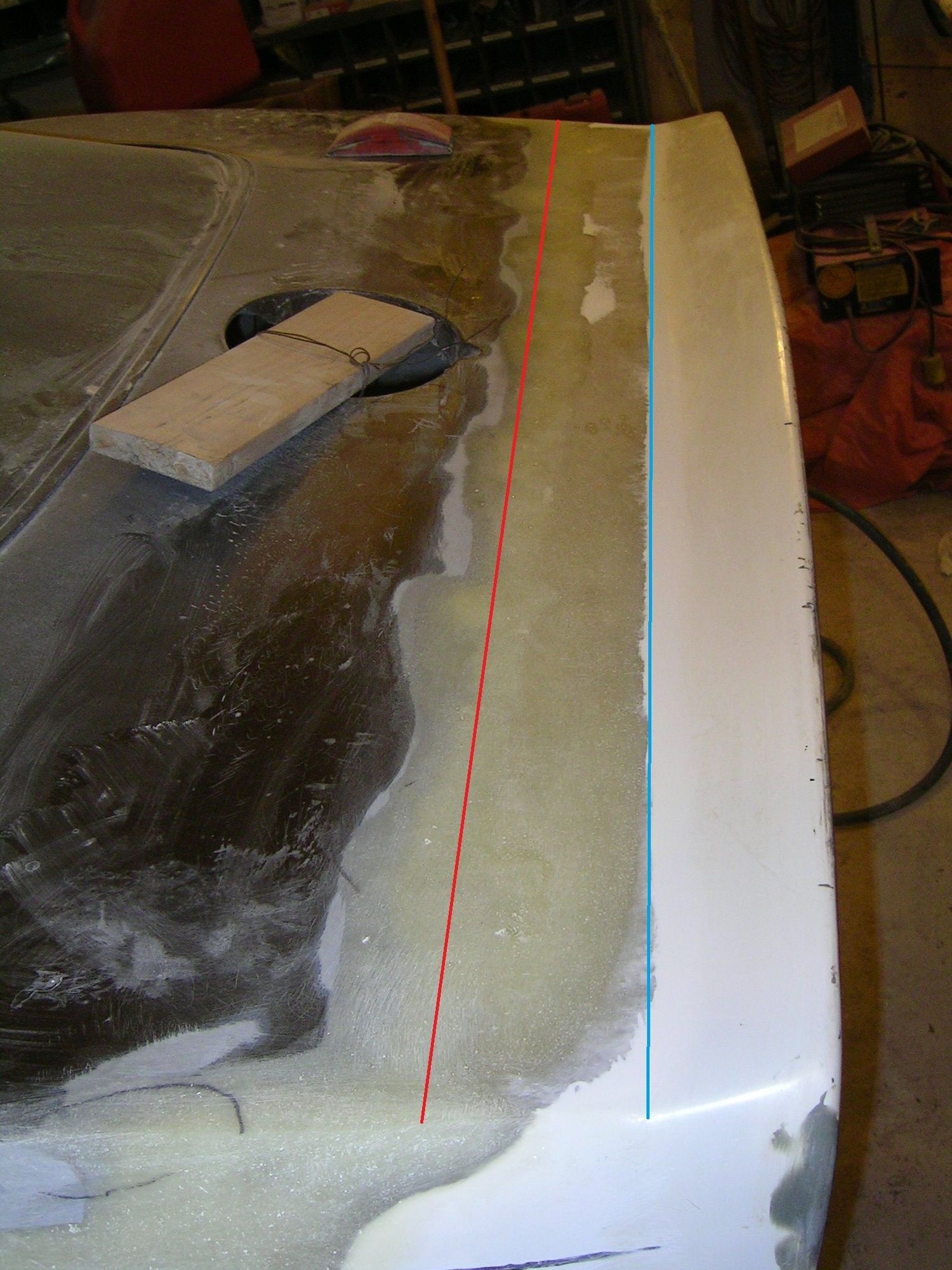

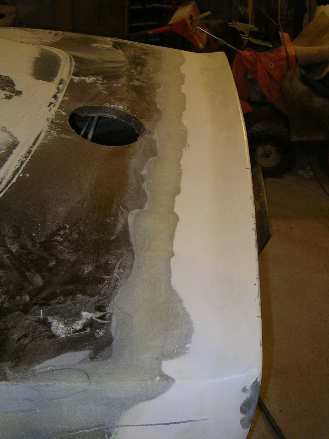

After I joined the ACI 70-73 rear clip to the car I blended the join line on the upper deck and thought I was done:
I later ran my hands over the upper deck and it was apparent the upper deck on the ACI 70-73 rear clip rises up a bit from the low point of the ducktail at the tail light panel and I needed to shave it down all the way to that low point (blue line in picture). The red line is roughly where the 79 rear deck and the ACI 70-73 rear deck originally met when I joined the two together. The blue line is the lowest point on the ACI 70-73 rear clip's upper deck and the surface in front of the blue line originally rose up from there. I had to do a lot more shaving on the deck between the red line and blue line to get a smooth transition from the 79 rear deck to the duck tail on the ACI 70-73 rear clip. This is why I wanted the electronic thickness gauge to make sure this area isn't too thin after all the shaving down.
I put fiberglass wax and grease remover on the upper deck a number of times while I was sanding to make sure I had a nice shape (water didn't lay down flat enough to really show panel levels well) and I've got it where it needs to be now. I'm finally ready to use the electronic thickness gauge to make sure its neither too thin nor too thick where I joined the ACI rear clip to the car and reshaped the quarter panels. So, probably next week I'll be back underneath the car in the gas tank area doing the miserable work of thinning things out a bit again.
Old Aug 1, 2018 | 09:43 PM
  #1147
derekderek's Avatar
derekderek
Posts: 13,082
Likes: 3,399
From: SW Florida.
Why thin the underside? What harm can a few ounces or lbs of extra glass do? Or are you getting used to the feeling of glass fibers stuck in your face and miss it? I would think about maybe adding a layer or 2 where you are worried about thinness, but too thick?
Old Aug 1, 2018 | 10:23 PM
  #1148
Priya's Avatar
Priya
Joined: Dec 2009
Posts: 6,397
Likes: 649
From: Saskatoon Saskatchewan
Here's my thinking on that. As you drive the car you hit bumps and that creates a downward momentum on the body panels that causes a sort of impact on them. If you have extra thick parts of the panel with extra weight that creates a bigger impact and makes it more likely the panel will crack over time. Maybe as you say, its not enough to make a difference, but I prefer to keep the panel no thicker than necessary just to be on the safe side. Further, my husband tells me, and it sounds plausible to me, when you have a thick part of a panel next to a thin part the panels will flex with driving and that's where a crack is likely to occur because of the different amounts of flex between the thick and thin parts. So, for that reason as well, I want to keep all the panels close to the same amount of thickness.

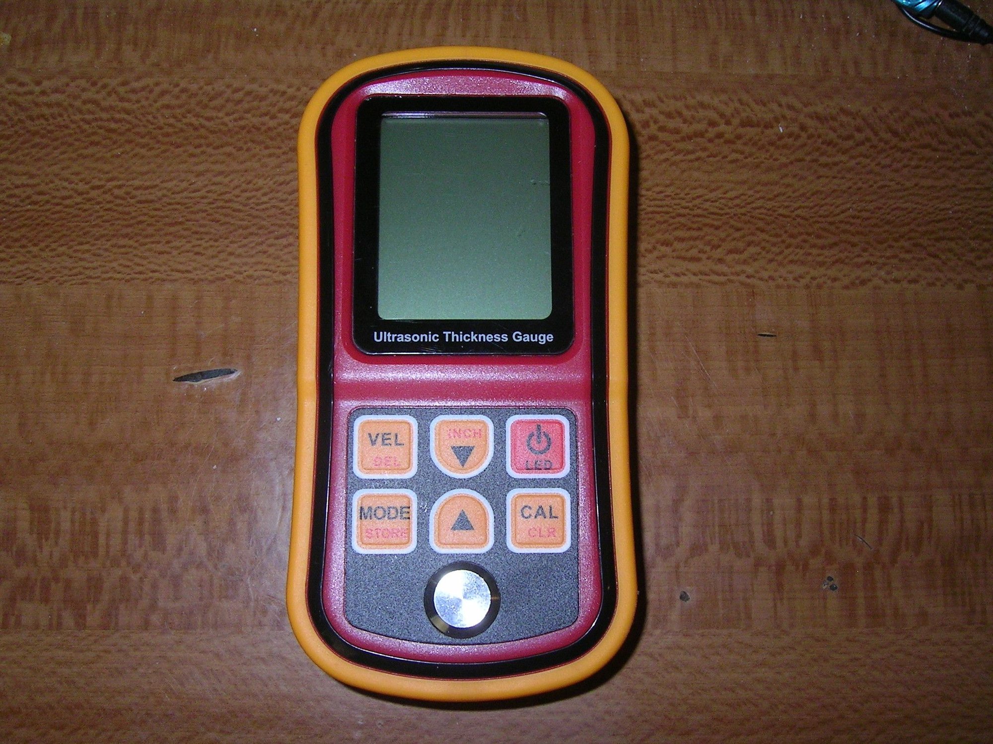

So, I was keen to measure the thickness of my fiberglass joins with this ultrasonic thickness gauge:
To use the gauge it says to take a 1 inch thick example of the material you want to measure and use that to calibrate the gauge. I layered up a couple of thick pieces of fiberglass resin and mat and sanded them down to exactly one inch. I spent about 15-20 hours doing that and trying to get the thickness gauge to work. The instructions were written in China and some of them were confusing or incomplete so it was quite a chore to figure out how everything works. After trying all settings and combinations it measured my 1 inch thick fiberglass sample anywhere between .2 inches at times and .5 inches - it never gave a consistent measurement. I sanded my samples down to 1/4 inch and 1/2 inch thick to see if that would make a difference and still couldn't get a consistent reading.
I tried the gauge on the car and the readings varied a great deal on my laminations and on the hand laid fiberglass of the 70-73 ACI rear clip. On the SMC body panels it was reasonably consistent. For example out of perhaps 10 measurements in the same place on the SMC it would give around eight readings of .09 inches to .11 inches and one reading of .06 inches and one reading of .14 inches. So the Ultrasonic thickness gauge would be of some use on SMC body panels but is of no use on fiberglass. I think it probably wouldn't work on factory press molded fiberglass either.
I figure I put about $50 worth of material into my 1" fiberglass samples for calibrating the gauge and the gauge was around $200, so that's around $250 down the drain. I really wanted it to work but it just didn't no matter how hard I tried to make it.

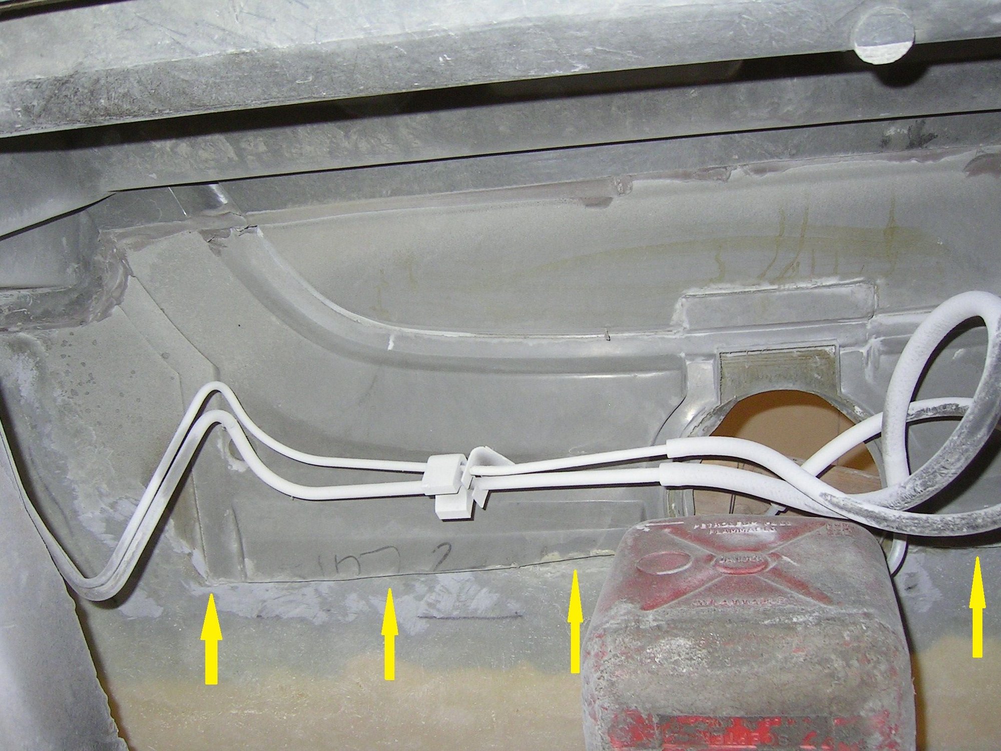

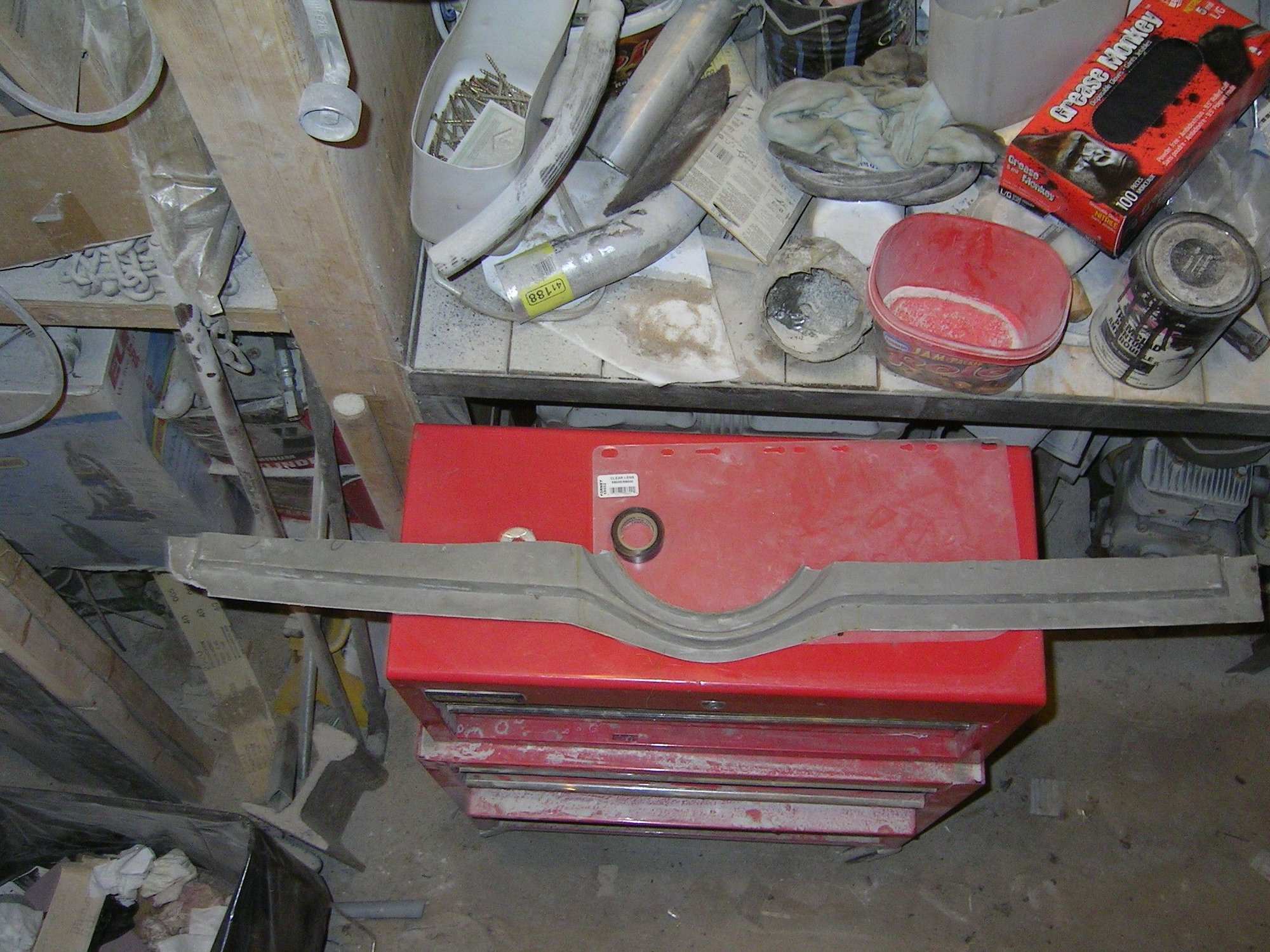

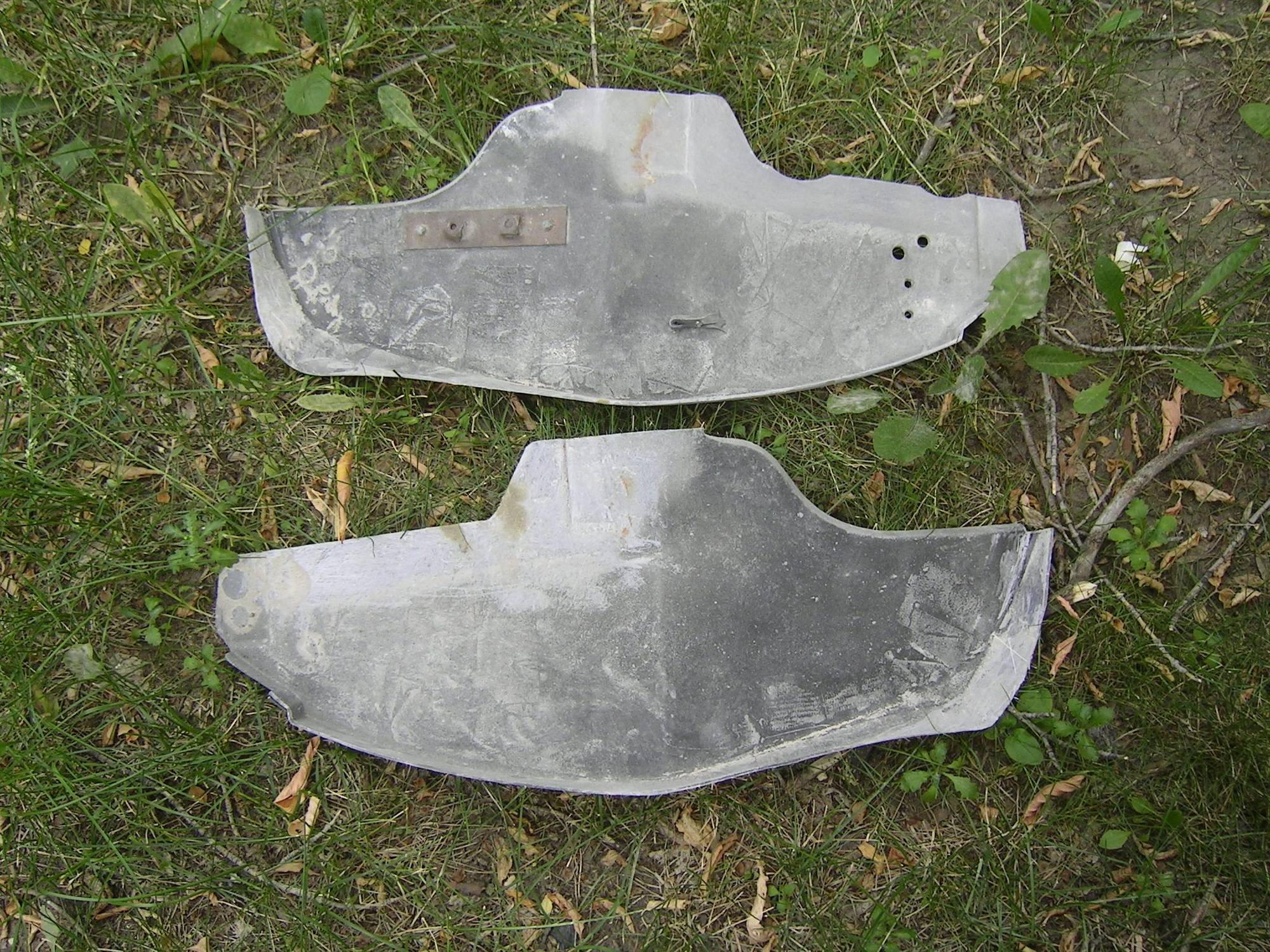

Next thing to do is to glue in the rear wheel well splash panels and this piece of the upper deck reinforcement I removed in the beginning. I'll have to laminate that back together as well once its glued into place and then its back on re-working the remainder of the bumper brackets to get them to fit.
The piece above joins to the 79's upper deck reinforcement in the picture below where the arrows are:
