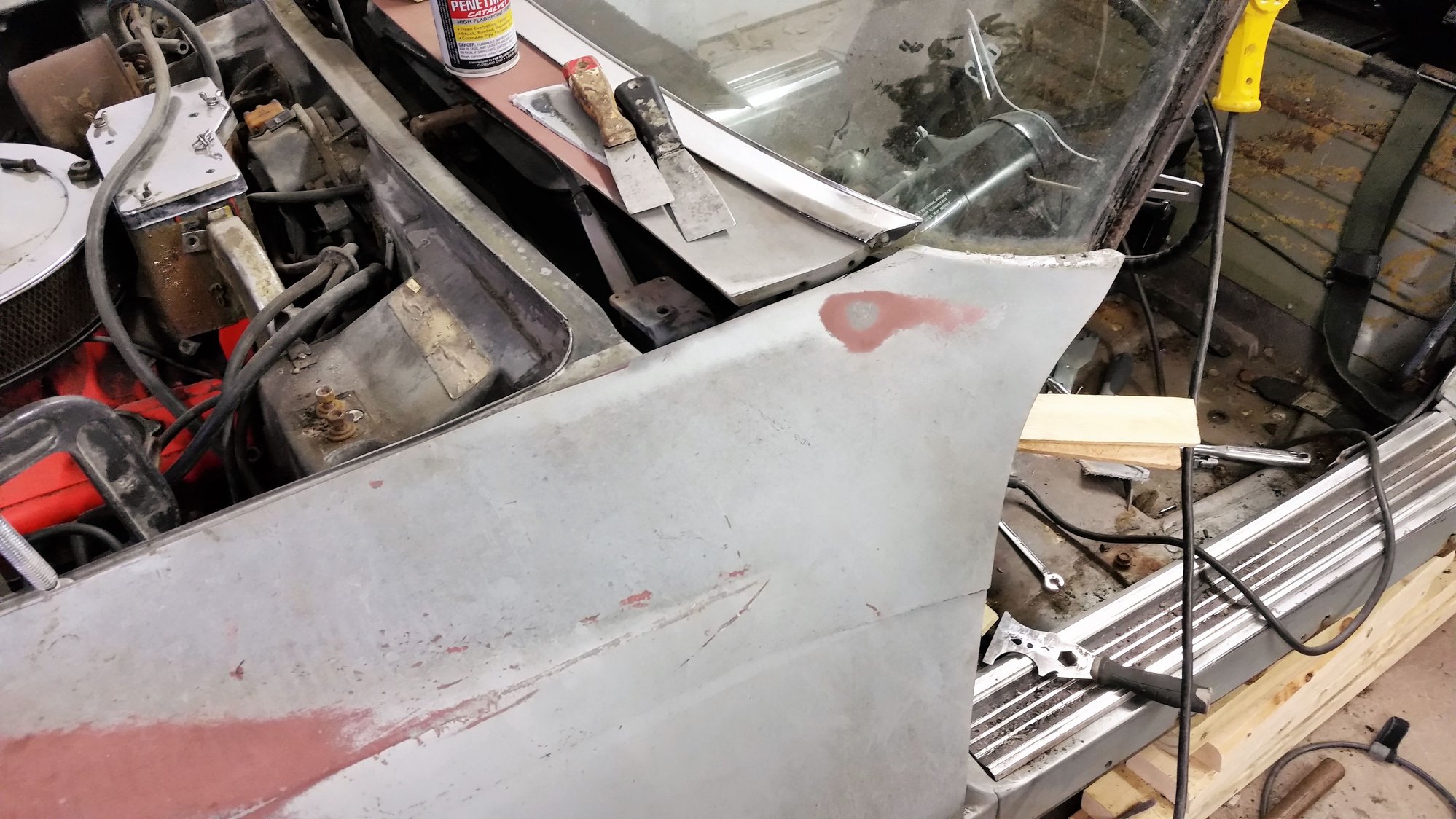

I discussed the reinforcement panel shown below with my husband and he suggested I cut the reinforcement panel just down from where I drew the yellow line, separate it from the top panel with a heat gun, graft the 70-73 rear on, bond on the previously removed part of the reinforcement panel back into place and then fiberglass up the cut line on the reinforcement panel - what do you think on that Dub?
In theory...it sounds plausible. But until you actually do it and see how things line up...no one knows. When you go to carefully remove the panel where it is bonded...use what I wrote below.
Originally Posted by Priya
More work than I was hoping for but perhaps a little less than I was expecting - I tried to remove a piece from the 69 rear clip I started with and it wouldn't budge at all.
I WOULD highly advise you in sued a heat gun...get eh adhesive heated up and IF you have an IR thermometer...use it to find how hot you need to get the adhesive so you can dig at it with a small screwdriver and see that it is able to come apart. I would guess about 170 degrees or so. The panel will coem off like a well cooked rack of ribs if you heat it.

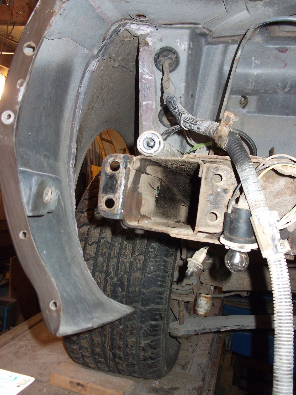

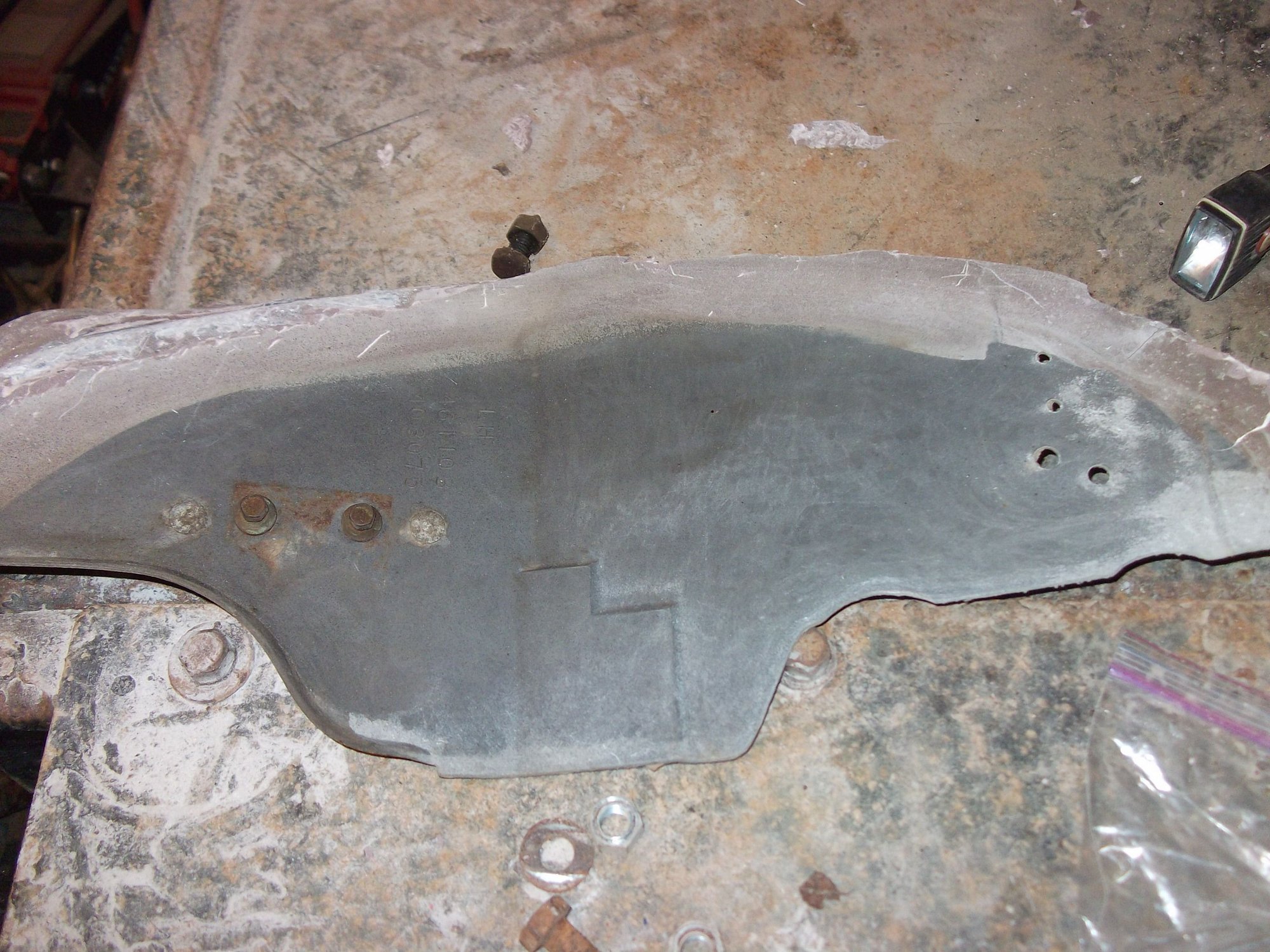

So, I got the other wheel well panel off today.
I managed to push the putty knife partway through the panel I was removing. There were also some mystery holes near the top of it.

Hi P,
Perhaps the holes are from the horn mounting bracket that was part of the alarm system?

Originally Posted by Alan 71
Hi P,
Regards,
Alan
If that's where the alarm horn normally goes, I suppose so.
