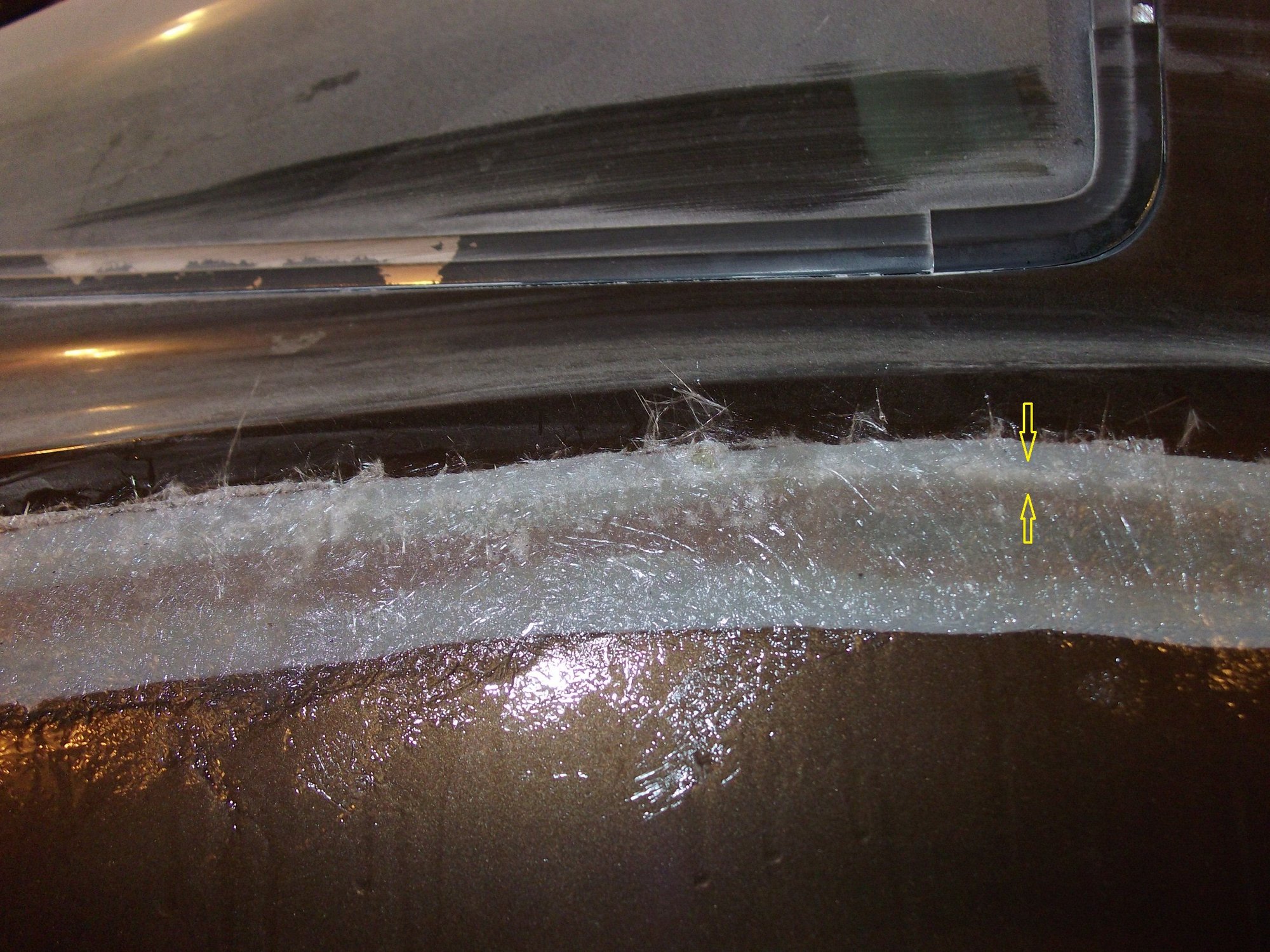

So the seams were hard enough to sand today. I thought I'd get away with just sanding through the white areas at the top of the seam shown in the picture above but once I sanded past those areas I never did get to what I felt was solid glass work so I ended up sanding it all off. The wasted time doesn't bother me so much as the cost of the lost materials.
Sorry to hear about the setback Priya.
What will you do now....VPA? glass fiber and resin?
Best wishes whichever way you go.
Dennis

I'm going back to the mat and resin. I took another inch off the 70-73 ACI rear clip today and I'll have to narrow up the upper quarters on the 79 a fair bit to get a match so I think the fiberglass base is the best for mating later glass work to.

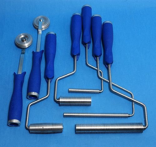

Getting a fiberglass roller would aid you greatly. I KNOW that using a paint brush can work...but if you are worried about air pockets, etc...then a roller would make this go so much easier and actually give you a lamination that will be a strong foundation.....because....a lamination that has countless small air bubbles in it is...in my opinion....worthless.

I just assumed you were using one , they give a much better quality finish .Here's the $10 one I use , just wash it off with acetone on a rag at the end . occasionally I pull the wire out and clean out the holes with a drill bit. Just make sure it turns freely before you start.
you can get bigger but I haven't needed one yet.
P.S its just a length of stainless steel all thread with a couple of shallow holes drilled in each end

They are definitely worth their weight...and there are different ones when you are laminating with the cloth that do not look like those pictured above.
And I AGREE...cleaning it very well when you are done is imperative. Nothing is worse to go and get it and the roller is locked up and will not spin.
