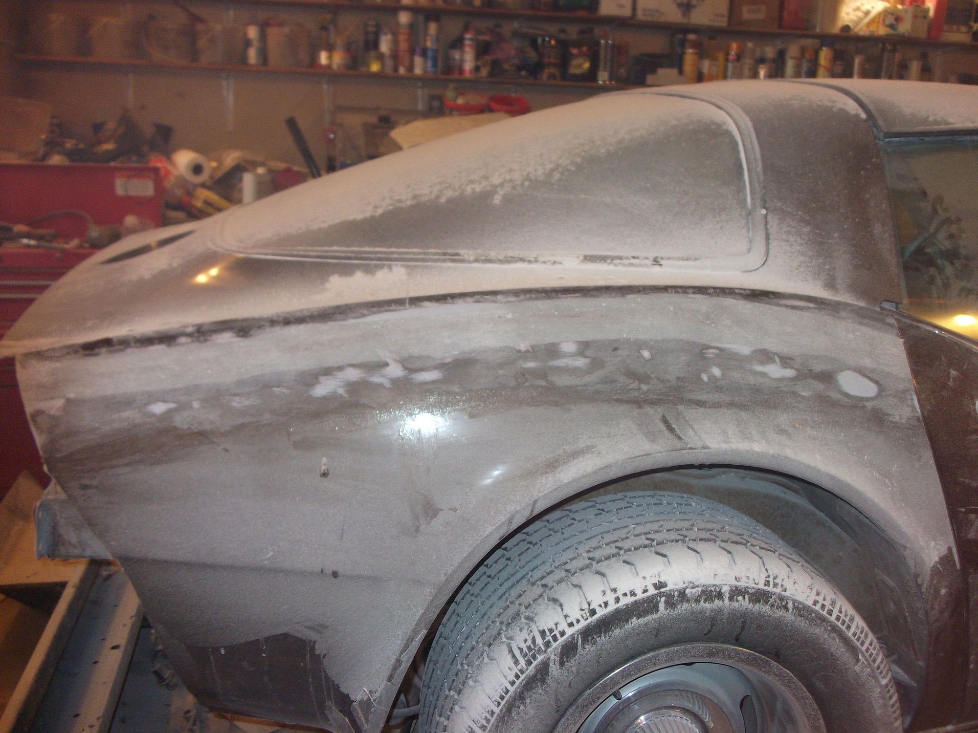

I finished doing the bonding seams for the second time. I took the resin and hardener inside the house and took it out to the garage after I had the garage at room temperature. It was a good workable consistency compared to the corn syrup consistency I had with the resin and hardener at 40 degrees F.
After I finished rough sanding the fiberglass I started to smooth out the mating surfaces on the 70-73 ACI rear clip. Then the compressor died again. So I don't know when I'll be back at it, but probably not soon.

I was roughing up the surfaces on the 70-73 ACI rear clip where I'll be mating it to the 79 but for some reason I can't get as much roughness in the surface as I'd like to see so I was wondering if anyone has any suggestions. I started with a 24 grit disc on an air sander and it seemed too smooth after that. I used some 40 grit paper both by inline sander and by hand and that seemed a little better but still not very rough which is confusing because on the bonding seams on the car I used 40 grit on an inline sander on the resin and mat and that is really nice and rough and I can see the sanding scratches in it but I can't see any on my 70-73 ACI rear clip. I also used a 24 grit disc by hand on the 70-73 ACI rear clip but still no visible sanding scratches which once again is strange because I used that on the bonding seams on the car before I put down the resin and mat and that was nice and rough there and I could see good size sand scratches. I'm thinking about getting a wire disk I can put in my drill and trying that.

Keep in mind that just because the grinder with 24 grit on it can go to full throttle and spin like crazy...you can slow down how fast it spins by controlling the sped of the disc and get a more aggressive cut in the fiberglass.
Speed of disc...the amount of pressure you apply to the panel can change how your scratch can be made. I often times hit the trigger and get the disc spinning and take the grinding disc and while disc is spinning....with a stroking motion... will apply the disc onto the surface with some pressure while moving it across the panel and actually stall the disc and make it stop. The do it again and again.
Remember.... the faster your tool spins can heat up your grinding disc and actually make it wear out faster. And I do not care if you are grinding steel, fiberglass or whatever.
DUB

Seems odd to me that you are doing that job with power sanders at all. Nothing like the control of hand block sanding without all the billowing clouds of fiberglass dust. That's a couple hour job both sides with block sanders. I only use a DA for sanding off old paint, disc grinder getting rid of other peoples bondo work plus some prepping to V out areas for glass repairs. Otherwise it's all by hand. Inline sanders and DA final finish work is for production collision shops, not quality restoration work in my opinion.
I think amateurs believe they are doing something wrong if it takes a long time to finish body work, hence the unnecessary power tools to cut corners. I know I did.

After I tried the air sanders I did it by hand.

We used hand sanders for roughing and hand sanding with 16 grit paper.
Final roughness of the surface depends an the type of glass and the resin system.
