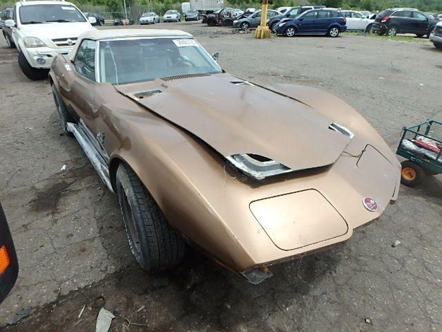

i found don anderson in search, but no posts at all. my 3k totalled copart bomb.
gotta get it cleared salvage as a 75 before i start this...

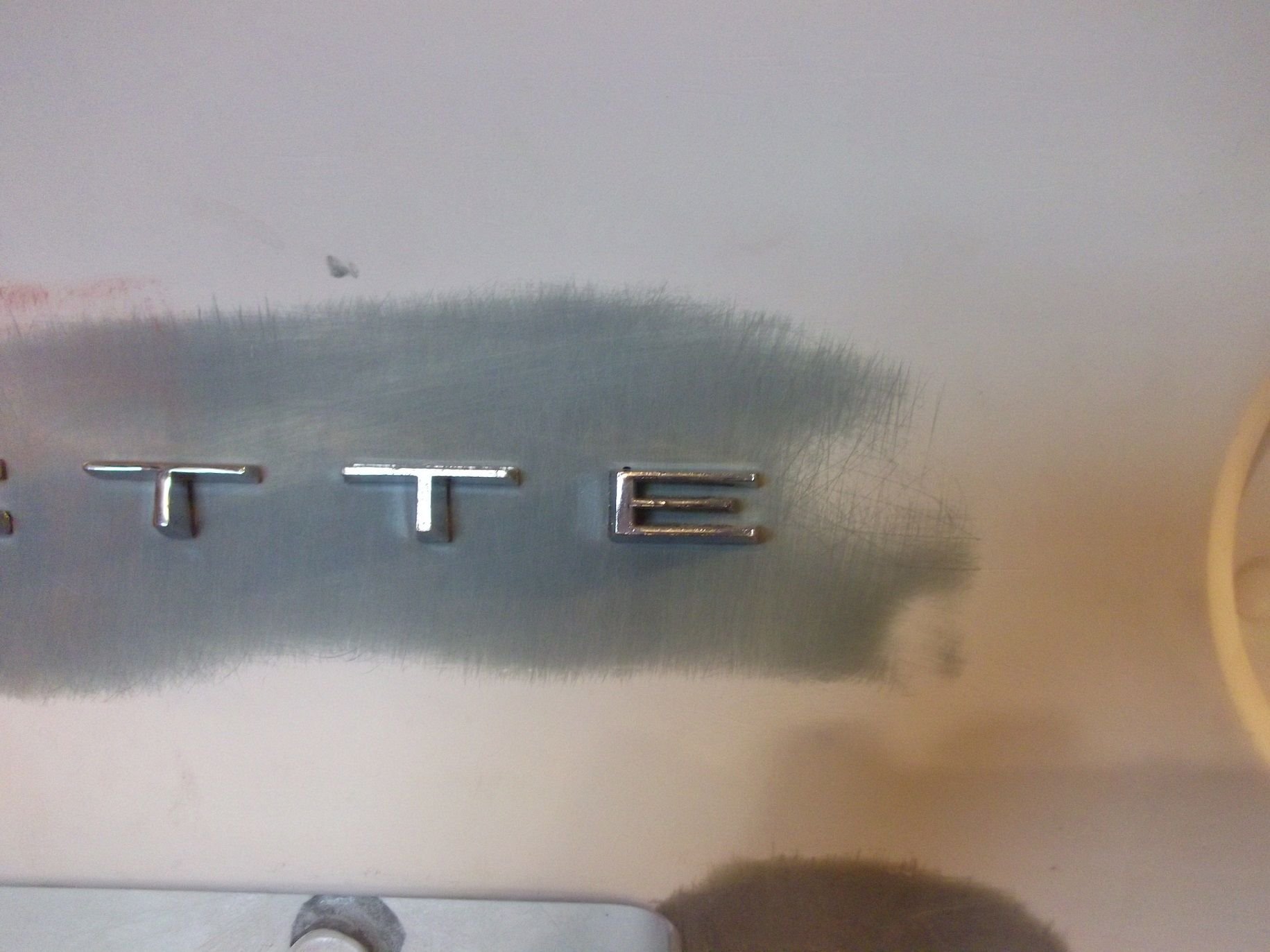

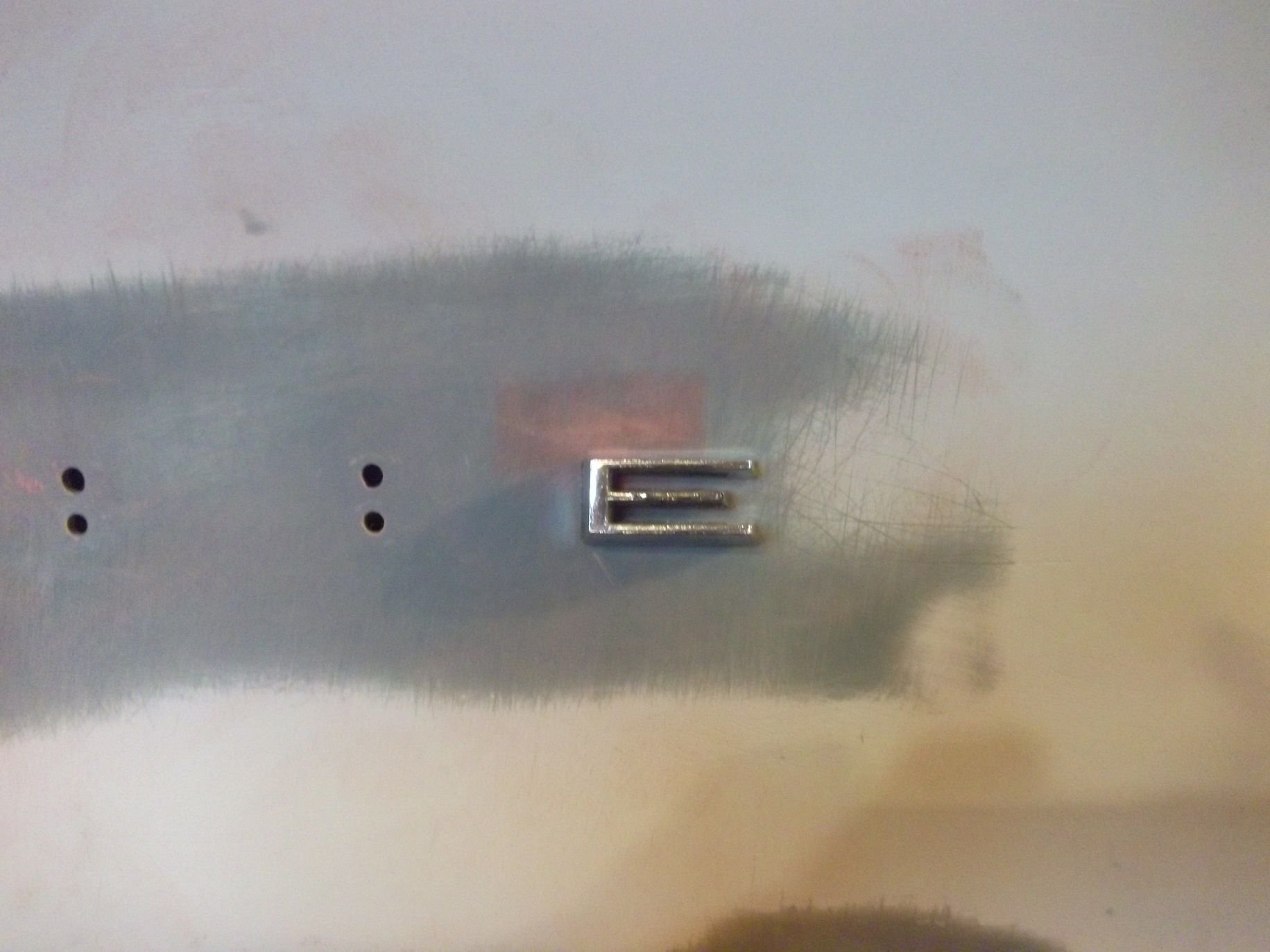

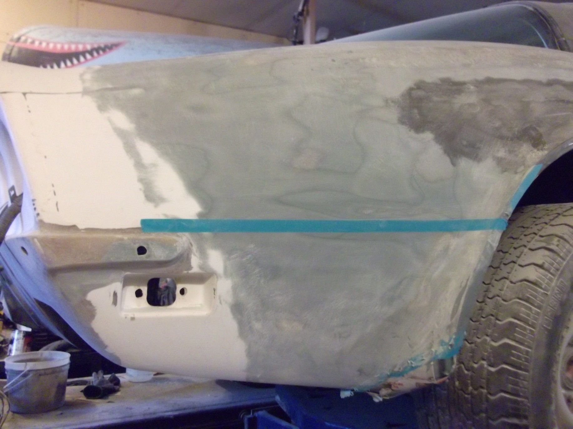

So, here's what I've gotten done on the 79 since this spring:
I spent more time on the letters with the laser level and found the top hole on the last "E" was visible as well as part of the hole for the "C". I patched those up. For some reason the "E" looks really beat up, but its not.

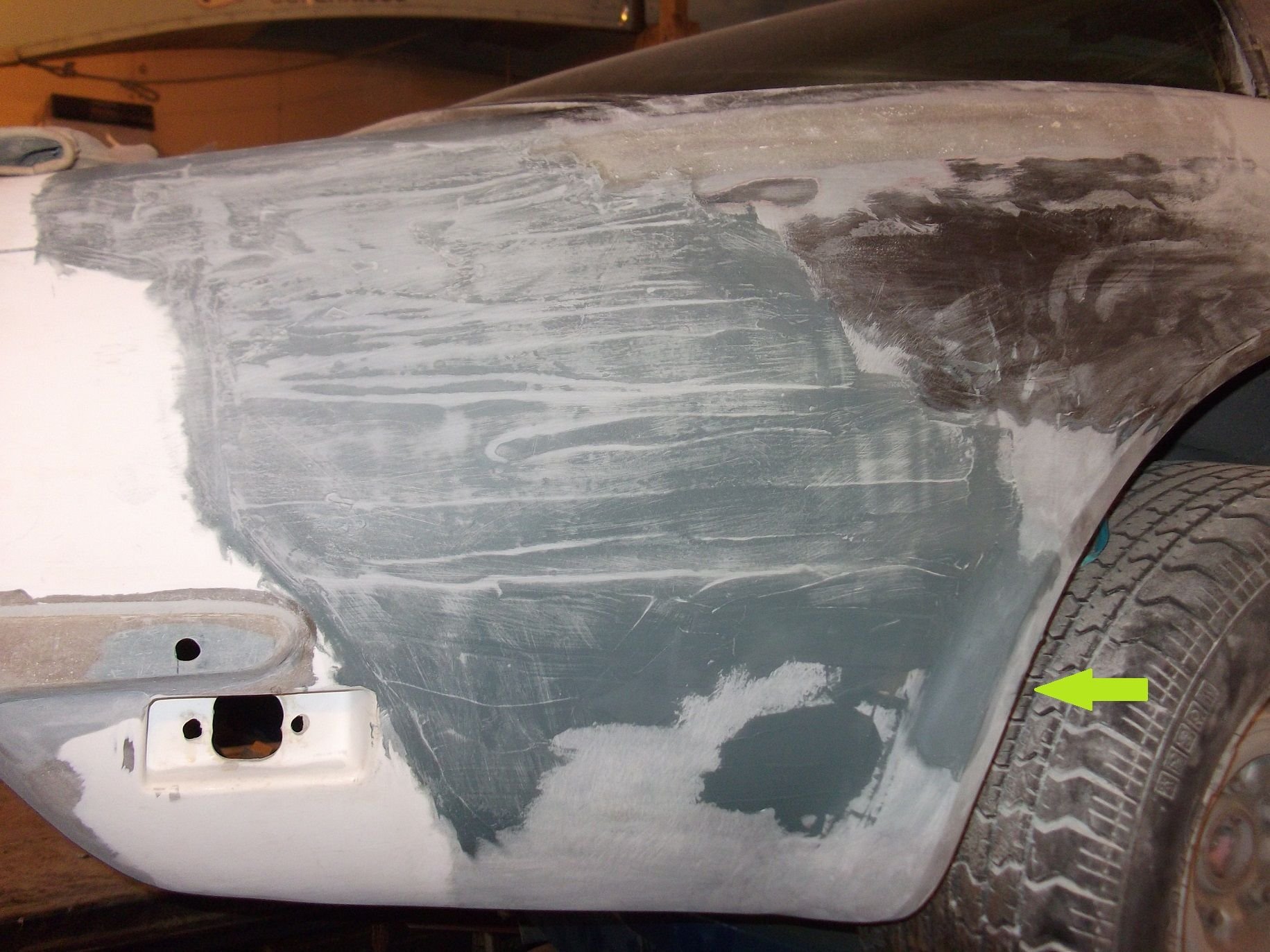

It's time for the Vette panel adhesive/filler and to get the quarter panel straight. I had a boo-boo where the green arrow is on the lip of the wheel opening. When I bonded the 70-73 ACI rear clip to the 79's SMC I got some extraneous mat and resin on the inside of the wheel lip. I tried to remove it with the die-grinder and accidentally went all the way through the panel there. So, that's again added unnecessary work to repair a panel that was fine because I didn't take the time to mask off my work area on the inside of the quarter panel. I'm a lot more careful about that now.
More fill needed

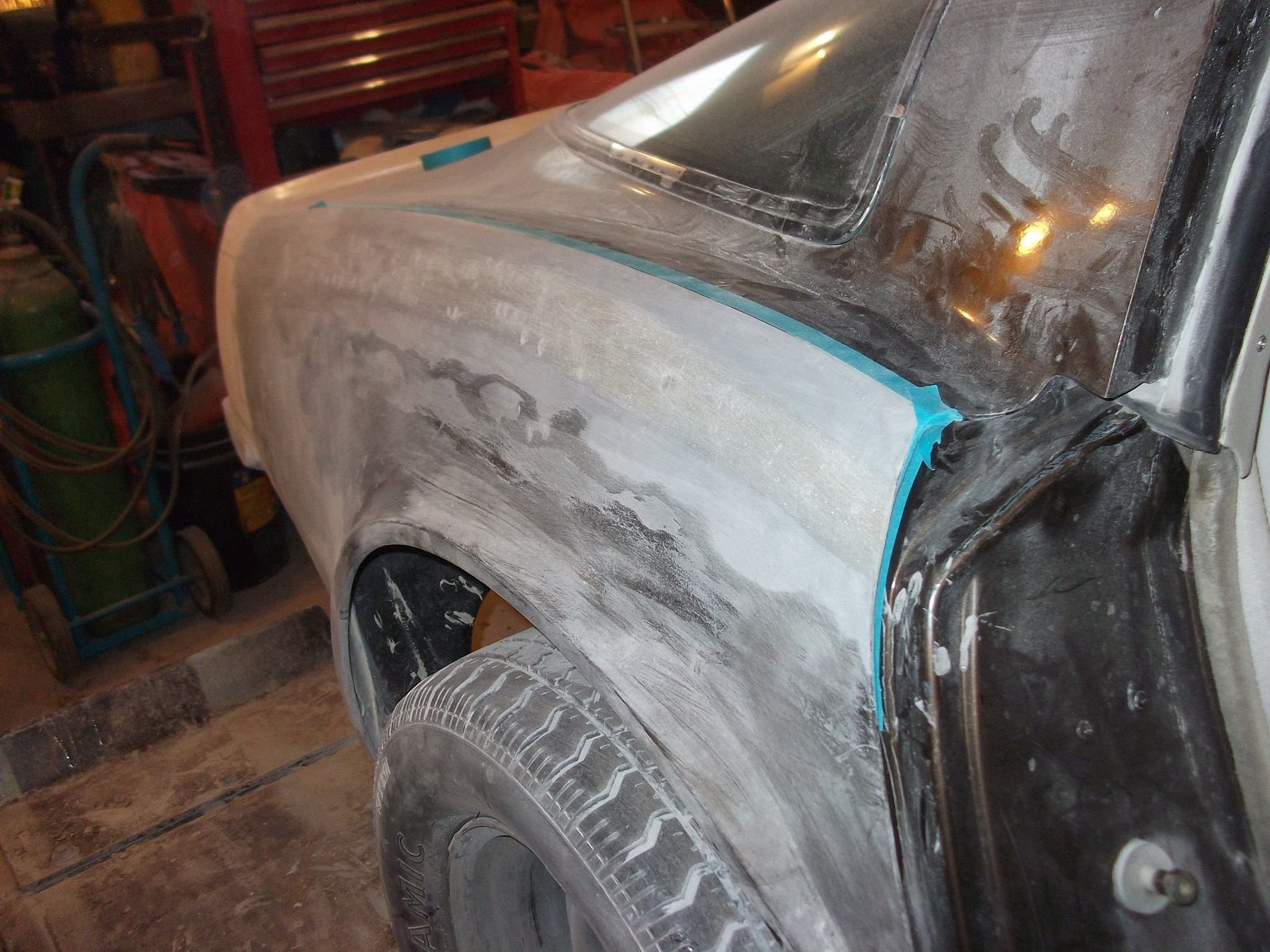

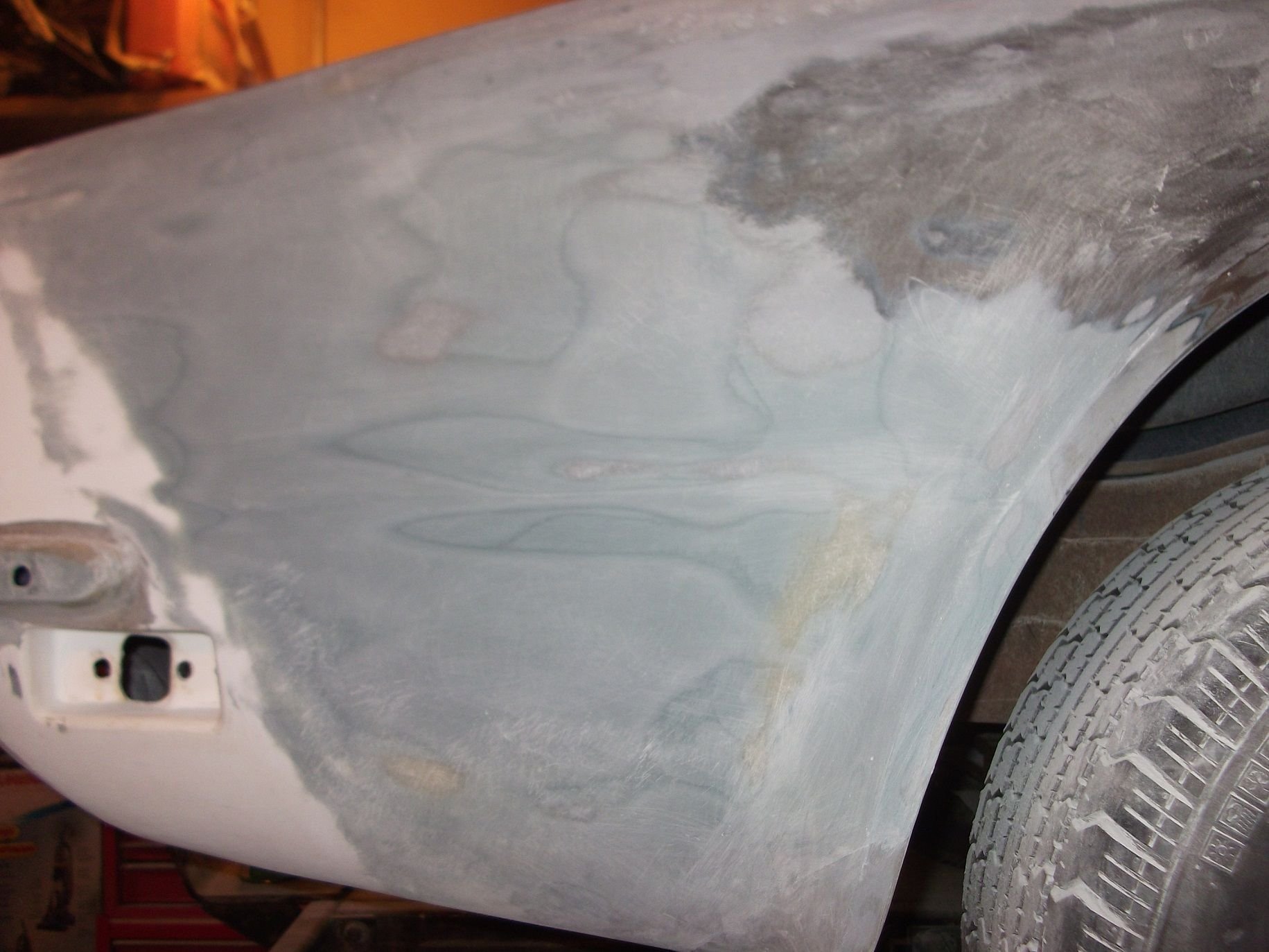

I recently learned to help get a straight character line on the body by placing a piece of tape along where the edge should be and then sanding to the edge of the tape. As you sand above and below the line you need to put new tape on the top or bottom of the line. As previously discussed, this horizontal mid quarter panel character line varies between the chrome bumper cars and the rubber bumper cars with the character line rising slightly towards the rear on the rubber bumper cars while it is basically level on the chrome bumper cars.
This factory character line is rounded and kind of vague so I had a bit of a hard time finding the centre of the line to mark its position on the fender lip of the wheel opening. To get it properly positioned I sanded it to a sharp edge so I can more easily see where it is and when I'm happy with it I will sand off the sharp edge of the character line until it has the proper soft curve

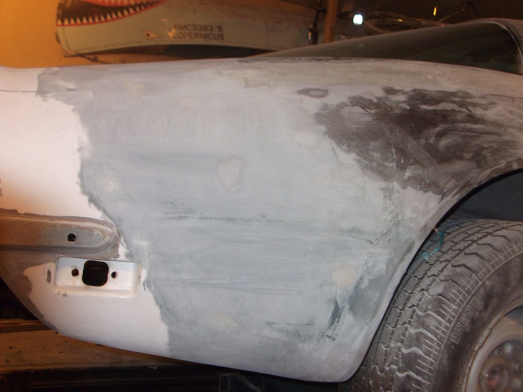

I spent some time on the bonding seam with the die grinder grinding out some voids from the mat and resin work. When I originally did this the garage was at 40 Fahrenheit and the fiberglass resin was really thick and I added acetone to it to thin it up. That was a bad idea as it created a lot of little defects in the mat and resin work. This time I taped up the edges so there isn't so much excess filler to sand off where I don't want it.
I covered it in a layer of fill and here it is paritally sanded.
Tomorrow I need to add more filler to this and do it all over again. Hubby says I need to cover up all the fiberglass mat and resin with the filler or otherwise it will show through the paint no matter how smooth it feels to the touch. You can see the epoxy mat and resin showing through on the lower half of the quarter panel, its the pale yellow patches a few inches to the left of the lip of the wheel opening. I'm feeling good about getting back into and and right now anyway I'm confident I'm going to keep at it consistently throughout the winter. This is the hard part now, making it all flat and smooth. There's one window in the garage which I need to get some cardboard to cover up. That way I can turn off the lights in the garage and hold a light at a sharp angle to the bodywork and it will show up highs and lows better.
