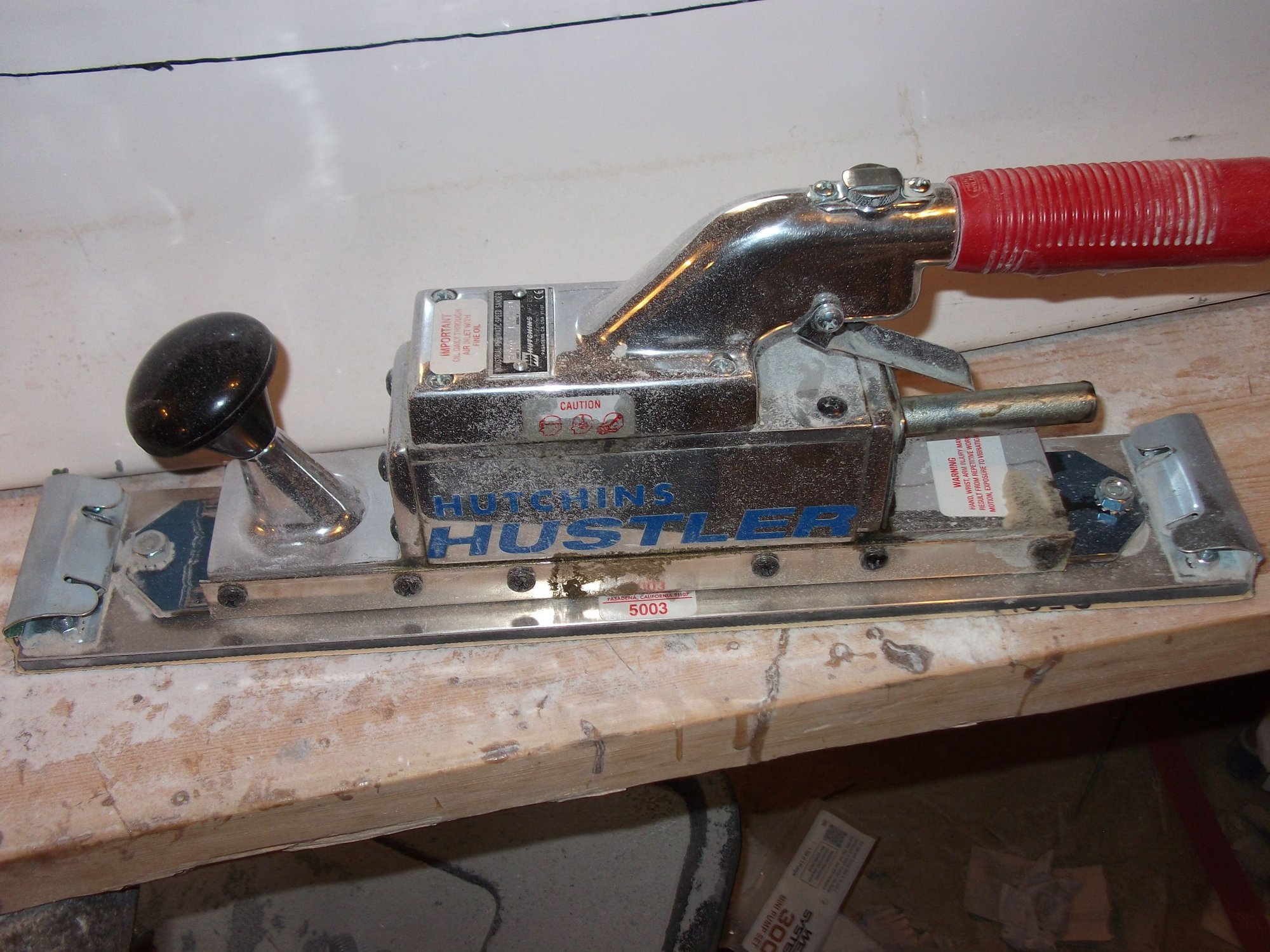

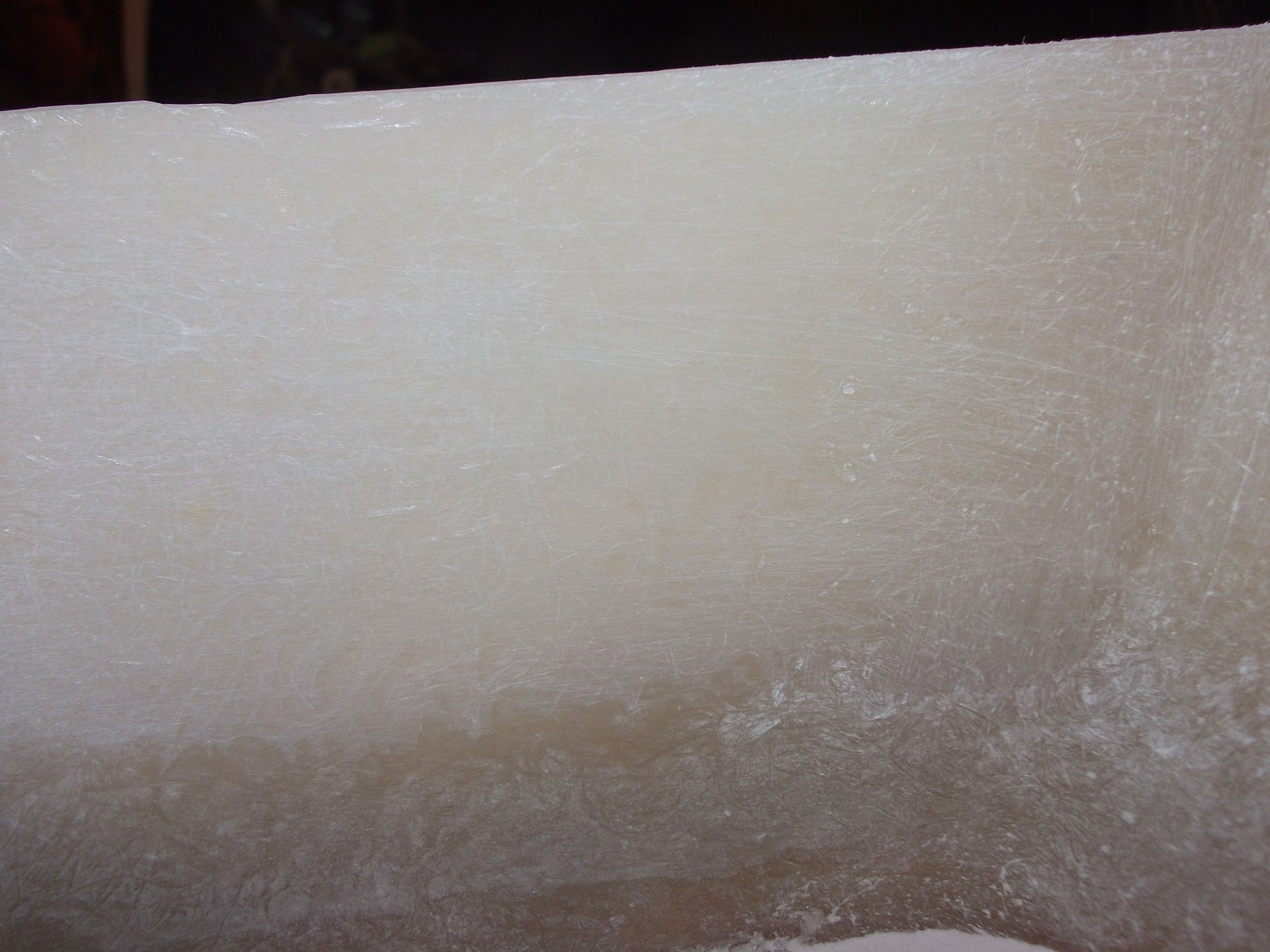

Here's what I've been using to get a rough texture on the 70-73 ACI rear clip to join to the 79:
24 grit on the air sanders and 40 grit on the inline sander
And here's the result after hand sanding with a 24 grit air sander disc. The lower 1/3 of the pictures is the unsanded interior finish of the hand laid fiberglass. It looks a little rougher in person:

Your air sanders are JUST FINE! Getting a rough surface will have to do with technique and NOT the tool itself. Because I have sanders just like those you posted photos of and I have no problems at all gettign surfaces prepped....so I know you can also.
Keep in mind that all surfaces do not ALWAYS have to be so rough you get cut just by wiping your hand over them.

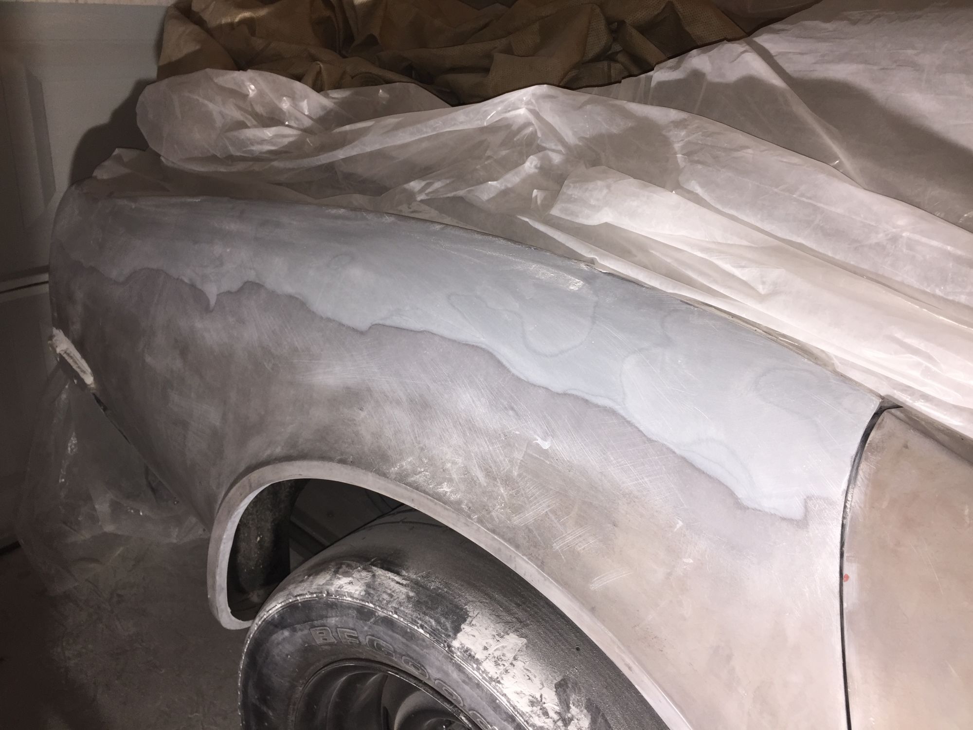

My only concern I have is what I see in you sanded laminated quarter seams where you applied the West Systems resin. In the photo below I am see quite a few rather large air bubbles that have been sanded on and exposed. Honestly if I had to do this I would not care about it being blocked and flat. I could get it flat enough for me to grind the heck out of it and skim coat it in VPA.
My other major concern is seeing resin on top of what look like the original paint. That is a disaster just waiting to happen if that is left like that. This is why I often time will let people know to not be afraid to take more paint off than they feel they need to so when they laminate...their laminated area stays within a prepped area.

I was disappointed at all the air bubbles as well, I haven't had a problem with this in the past. Even though I used close to the recommend amount of hardener (5 pumps resin, 4 pumps hardener) it was still soft five hours later and with the resin at room temperature a lot of the resin ran out of the mat before it hardened so I will be putting VPA over it. Also, I left the original paint there as a guide to know when I sanded down to the proper level. I will be removing all the paint on the quarters with 120 grit after I finish the fiberglass work to join the 70-73 ACI rear clip to the 79 quarter panels.

I always pump each material the same number of pumps...and that is using the correct ratio pump for each material also. By cutting back on one pump reduces the hardener by 20% of what it normally would take. I do know that reducing the amount of hardener in some products is quite acceptable...and they can still cure out...and I do it. But I also use infrared heaters and other measures to make sure that what I am doing is still going to work due to me modifying the ratio of hardener to resin or whatever it is I am modifying.
I seriously doubt that the resin ran out and caused for air bubbles to develop....especially if a roller was used to apply the mat and resin and work the air out.
Do as you wish in how you are going to deal with the remaining factory paint. I have a different method that would require removing the factory paint all the way to the top of the quarter panel styling line and then apply the VPA all the way to that top where I had prepped is so when I go and block the seam....it comes out looking something like this from '7Stingray1's' thread. And trust me...it is easier to get the seam right by doing it this way instead to trying to keep the work area smaller.
