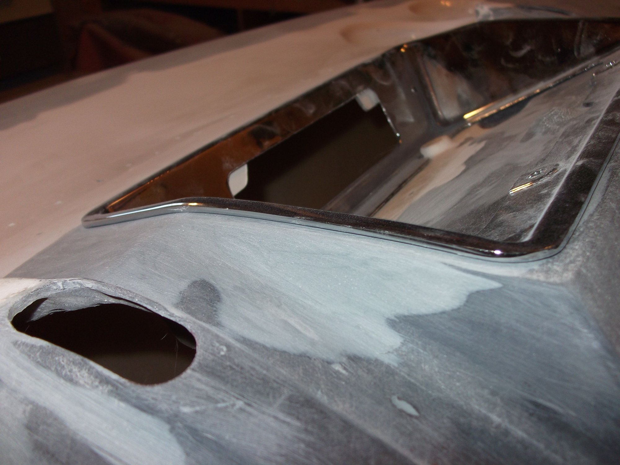

I thought that when you bonded in the lower exhaust panel..that you fitted in the license plate bezel to make sure all was good?
DUB
I did and the license plate bezel fits very nicely. Apparently its crooked.
I'm thinking maybe I can get away with lowering the left character line a bit and not make the license plate bezel look too mismatched. My husband figures I should just leave it.

Hi P,
Remember this area is down fairly low and tipped inwards when mounted. So you don't see it from eye level.
From close up you're looking down at it, and from a distance the alignment/detail begins to be not quite so important.
Perhaps you need to bear this in mind while you decide what to do and how much you'll do. Do the modification based to a degree on the angle you view it when installed.

That's a good point Alan. I'll take a look from a more normal angle before I make any further decision on this.

IF you can't live with the mismatch, rework it. Like Alan said about the angle the car will be viewed from/With the rear bumpers installed I don't think it will be noticeable. Besides....it gives your car character!
too bad you couldn't put a temporty peel-off glossy vinyl "sticker" over each side of the license plate bezel to see if a "paint job" makes it more noticeable pr less noticeable

After I did the license plate area I was tempted to spray it with some cheap black paint to get a better idea of how it looked and if the transitions were smooth enough. I figured I'd remove it afterwards with some paint gun wash.
In those situations you can primer it and then hit it with prepsall.
