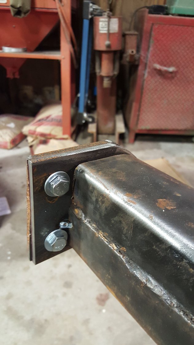

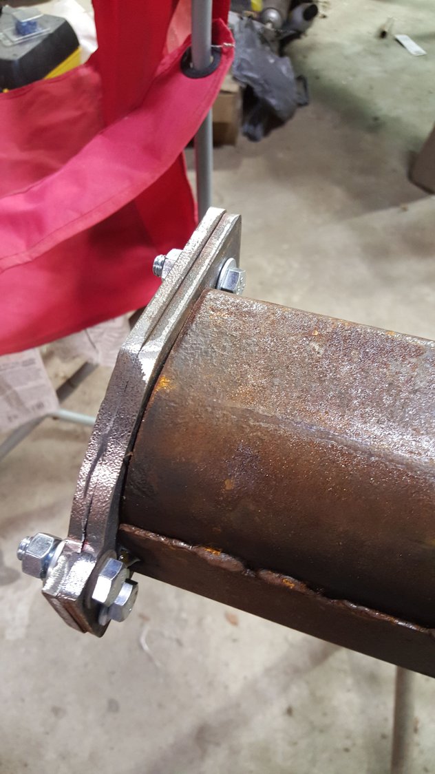

I have both sides of my cross member almost completely cut but I am wondering does it carry any load from the frame sides. Is there any chance of anything twisting or the frame rails moving out of alignment if I cut both sides and take it out completely and then weld the plates on and bolt it back up.

No I was just wondering if anyone who had cut theirs and welded in the plates to make it removable had ever seen the cross member move when the cut it. I machined 2 pair of butt plates today out of 1/4 flat plate and have the cross member almost cut through on both sides but before I completed the cut I was just asking if anyone had ever seen the cross member move out of alignment when it was cut

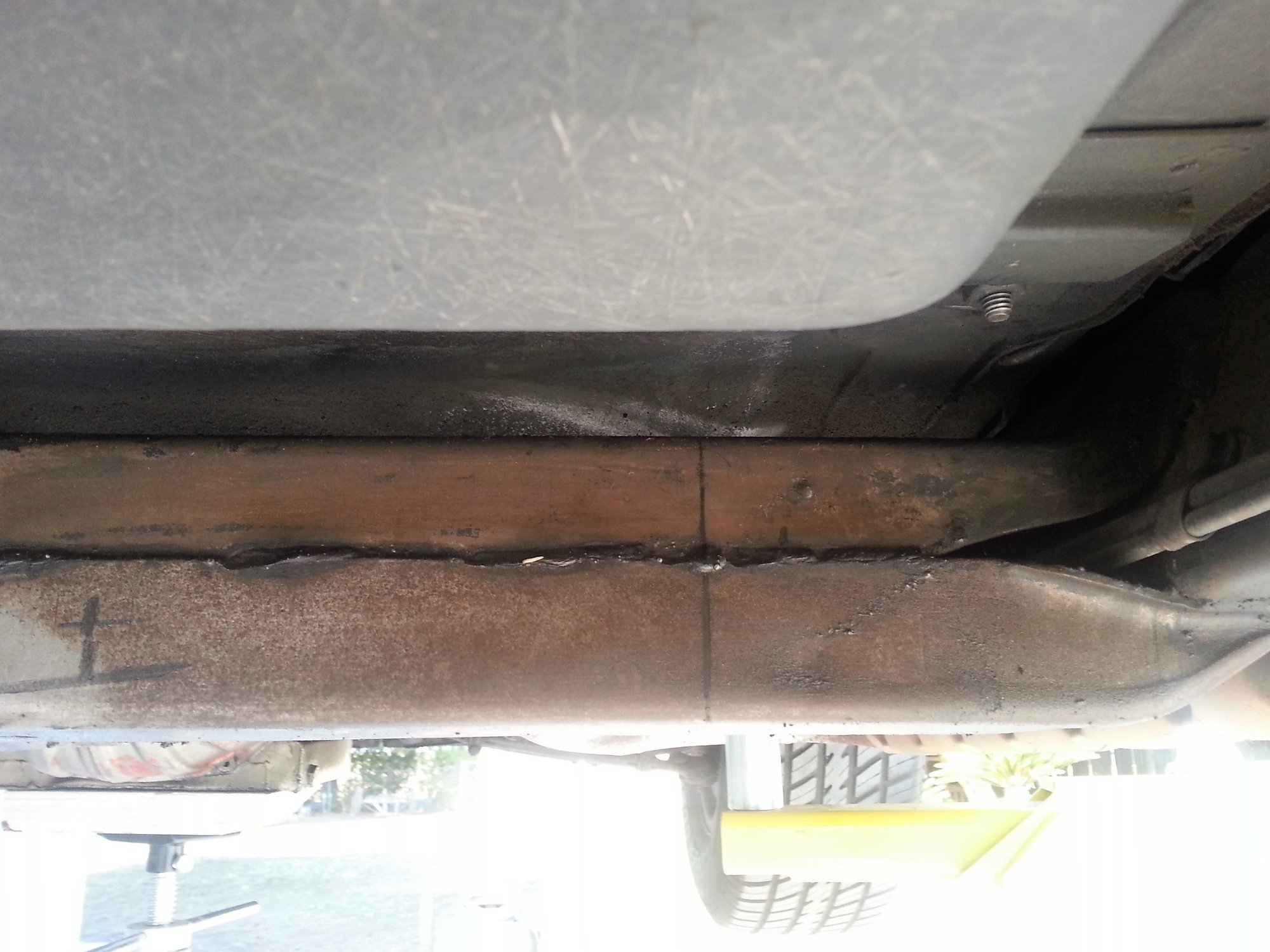

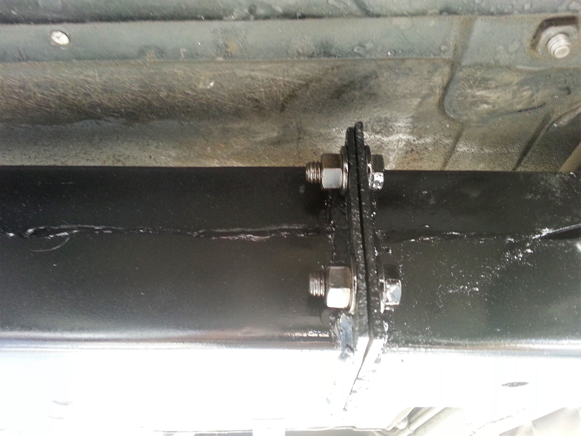

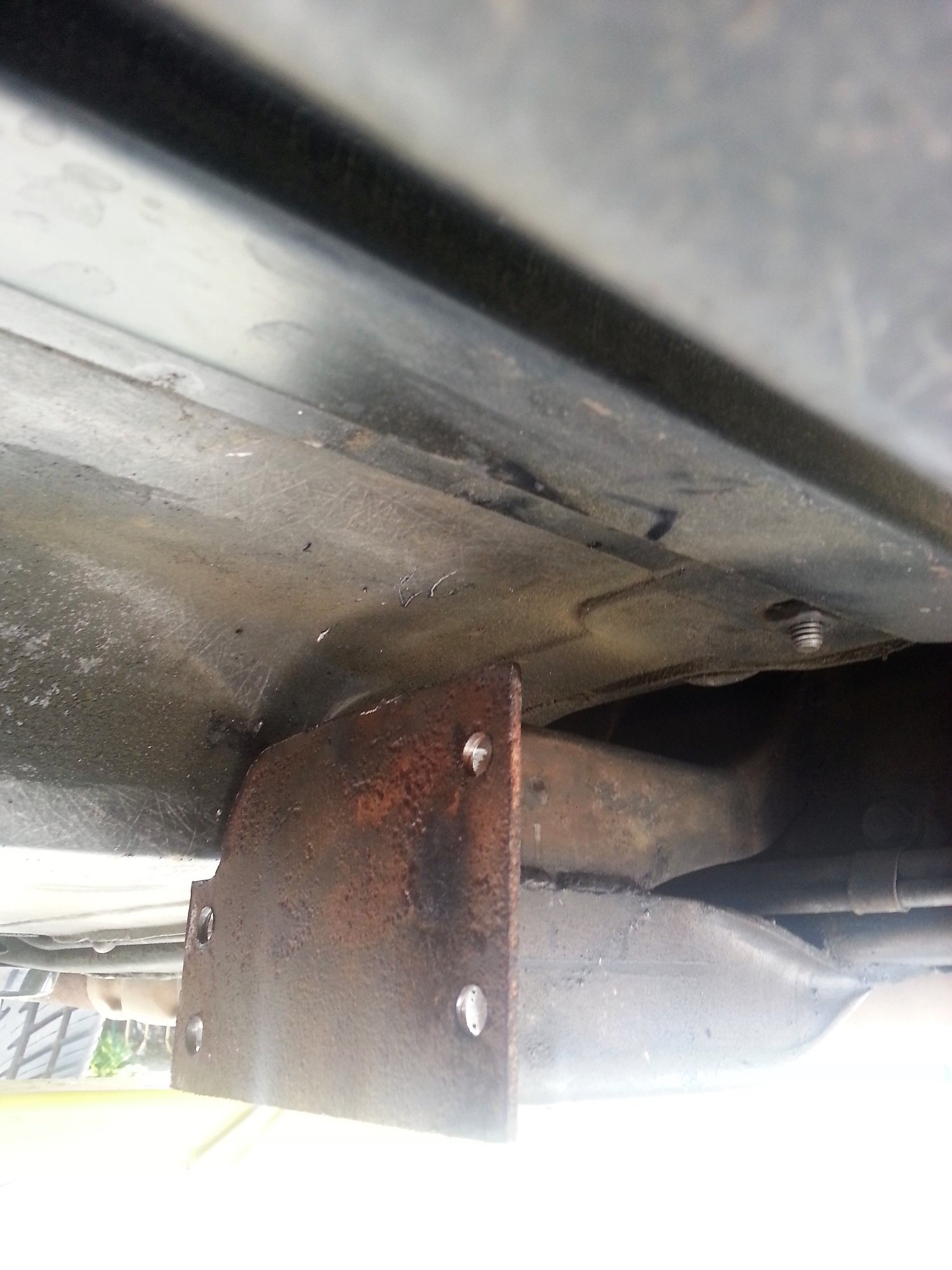

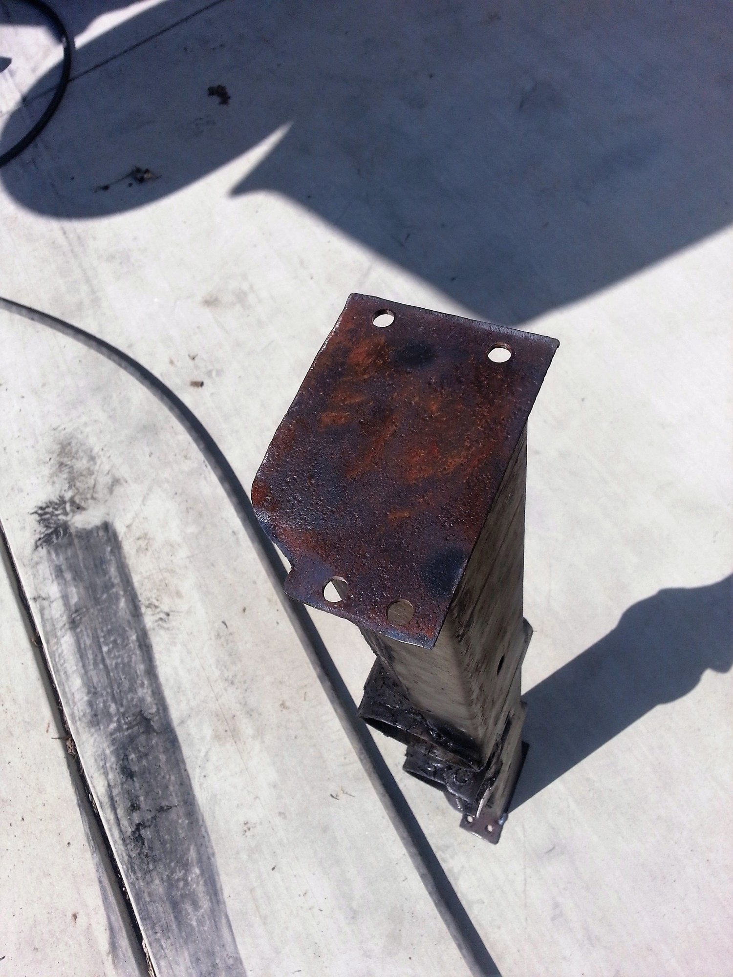

Here's some pictures of what I did.
Pics are in reverse order.
Bolted into place
Welded plate on center section of cross member
Welded plate to cross member from frame
Marked location to cut on cross member

That's exactly what I needed to know thanks. I made the final cuts this morning and nothing moved. I machined 4 plates almost exactly like yours out if 1/4 flat stock and cut the radius on the milling machine, hell a grinder would have done just as good. I made the cuts 8 inches off the frame rail on each side. After I get it all sandblasted and painted I will post pics

Thanks 502 I used your idea now all I have to do is like everything up and weld it in place

I was able to tap in the cross member with both plates on and tack it on the frame side then unbolt the center section and remove and weld the plates on the frame side.

That's exactly what I did
