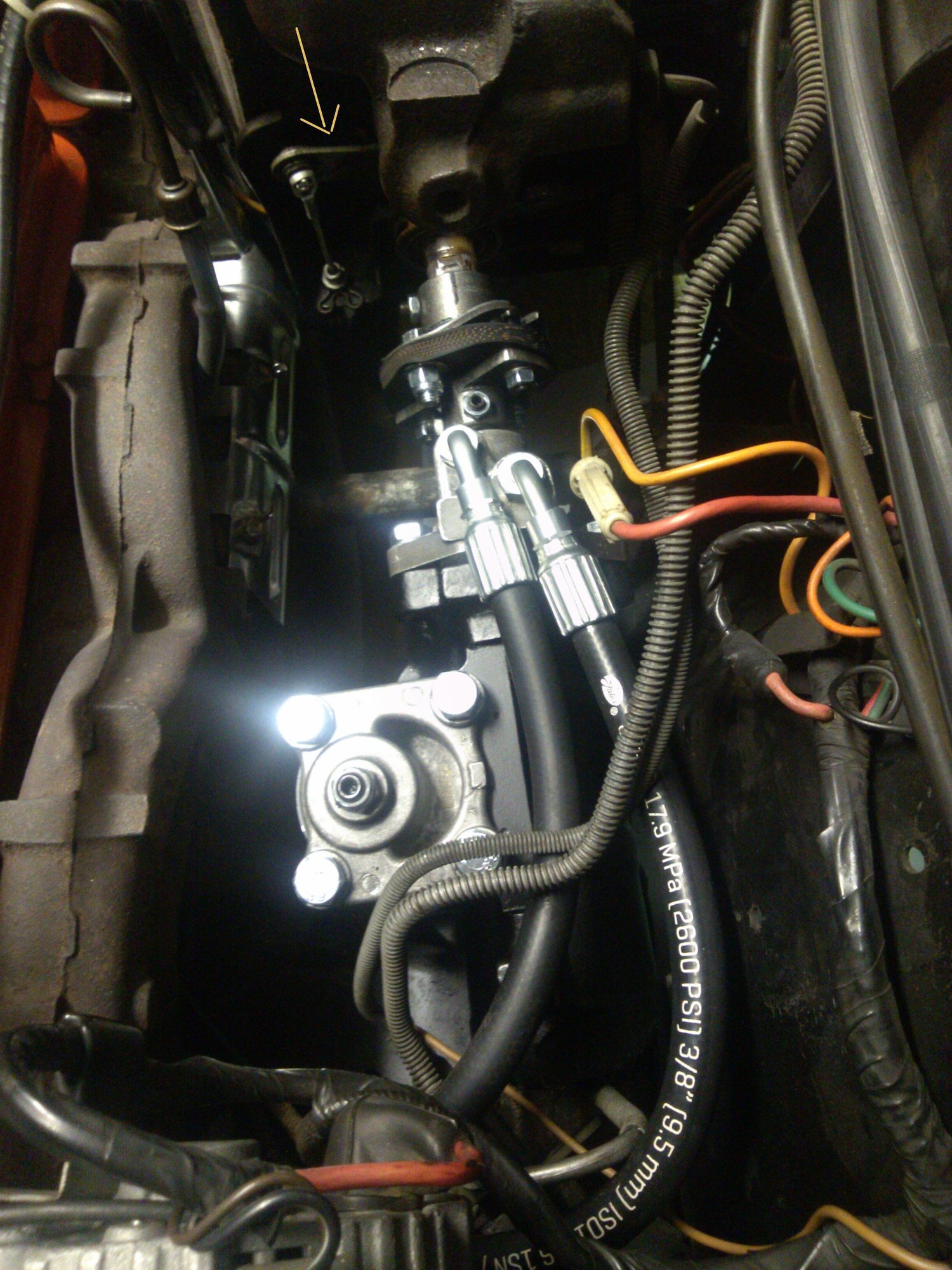

Have someone move the linkage for the lock mechanism on the steering column while you turn the key.
This one, lift it up:
Thank you very much .. that did the trick..
