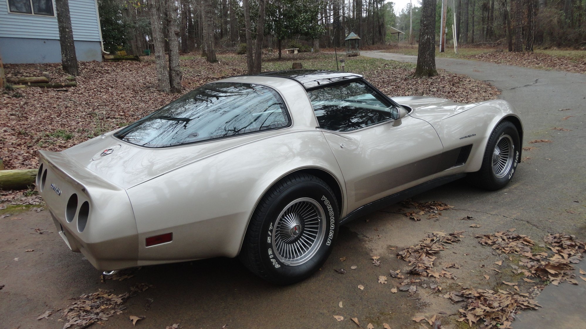

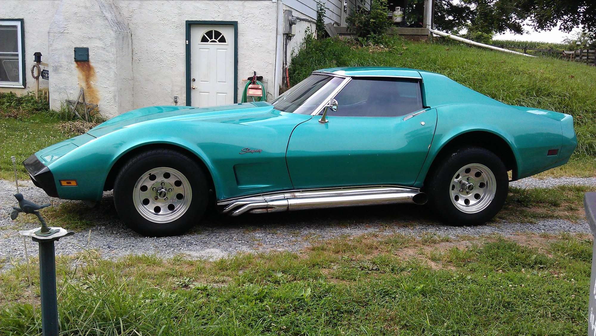

my first thought was that the spring was replaced by the original owner only because it has one hell of an arc to it, so maybe thats it? here's a pic of the car as sits. I went with 17" front & rear wheels/tires & went to a 10" leafs spring bolt on the ends because the car sat high before with 15" wheels on it. here is a pic of the car before & after, I have 3.5" above the tire on both sides I'd like the wheel opening to be even with the top of the tire. now I am still working on the car and have not driven it since the work I did, I read on the forum after doing such work and having the car in the air will require me to drive it around and settle the spring/ride out. I have driven it up and down the street but thats it since its not tagged or insured yet. I just can't see it dropping as much as i'd want it just by driving it around?

I don't know how high a stock c3 sits to begin with, where would the top of the tire & edge of the fender well be, on a stock c3? it also looks worse from the side because I still have the spare tire tub out and you can see alot of light in the rear of the well.

Looks good to me, but then again, I like my 74 sitting up higher in the back.

thats how I'd like it to sit in the rear, I do realize I went to a 17" low profile tire and that does not show as much meat as a 15" tire would, I did go with a tire that put me at the same tire height as stock 9I think @27")

you should be able to get it much lower. the front even looks high compared to your before pictures. You really need to drive it first and go from there. around the block is all it takes.

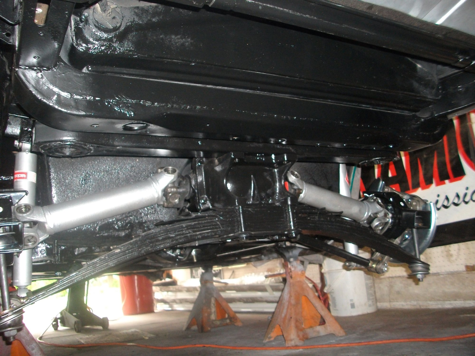

Have you ever removed your rear suspension mounting crossmember?
Something looks "off" to me with yours.
It seems to be an inch or two lower than the frame crossmember just rearward.
Mine is practically flush with the frame.
