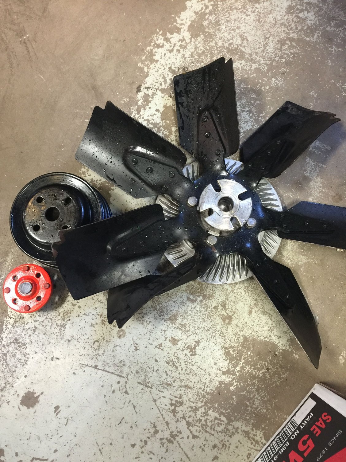

I got a call from a friend this morning, not good news, I had my '74 in his garage for some cam & lifter work along with a new water pump and the news this morning was the shaft on the new water pump snapped and did more damage while it was at it, , bent the fan and clutch base in turn caused the fan to go into the radiator while breaking the shroud..
So far, if I were to replace it all with factory parts I'm looking at about $1k, so there's going to be some substitutions for now..

My money is that fan was never tightened properly and the first anyone new of it the blades where hitting the shroud and it snapped the shaft on the water pump .
That i could buy before a shaft failure which is very unlikely.
Just myop .. Not trying to start trouble ..

If it was a parts store reman, then not entirely shocked. Still I'd be considering that the clutch/fan was unbalanced or the clutch locked up or that the belt was overtightened.
Either way, sucks. Back to work!

I totally agree. there had to be stress there to be twisted like that. unless the pump itself was seized inside the housing. that shaft did not "snap", it was twisted...
