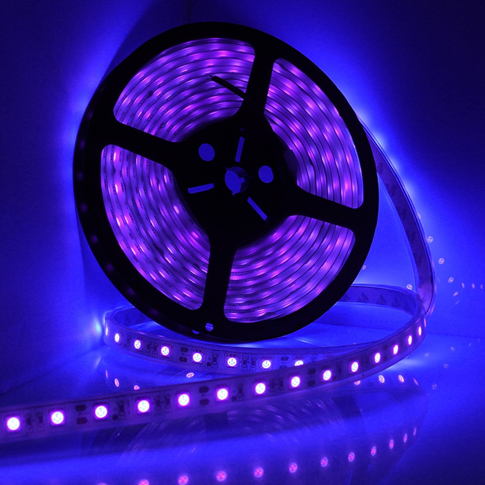

Looks great did that to mine last year but I changed to rgb led strips, can change color with remote control

I tried the bulbs- white and red- just didn't have the light I wanted- as I'm running the stock green letter gauges.
I ended up using LED strip lighting and made a length long enough to wrap around twice. Looks better- but I'm going to get a hold of some cool white strips and see if it looks any better. I could also add some LED bulbs in the stock location and see if that makes a difference.

LED's have come quite a ways. I wish the strips had been available years ago when I was changing the lighting in my C5. Converted everything to blue LED's, but I was using the bare LED's. Getting the radio done was a major PITA! Had to de-solder all the tiny incandescents out and solder in the LED's, each of which needed a resistor soldered in-line also. Looked great when it was done, but it took some doing.
