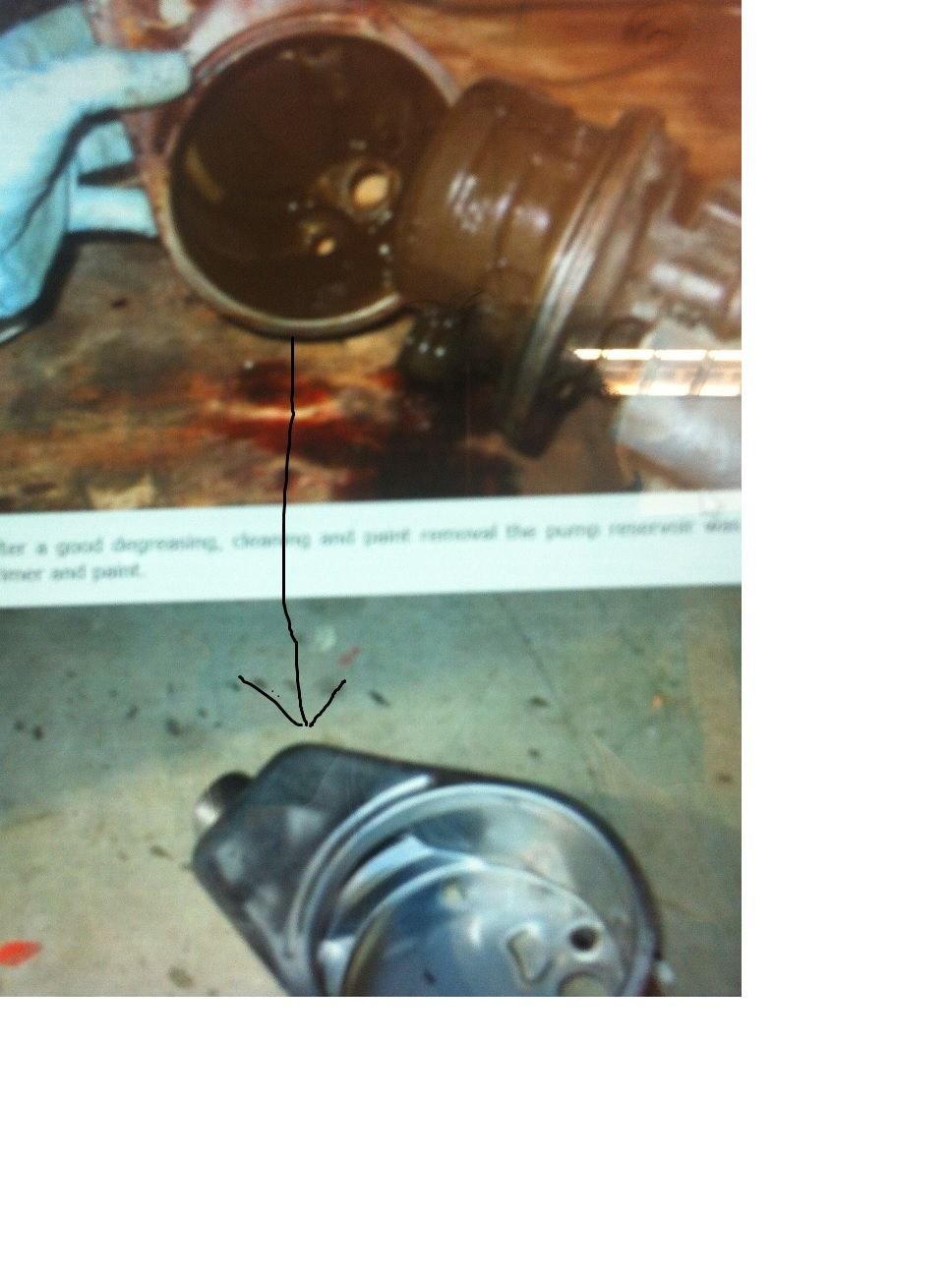

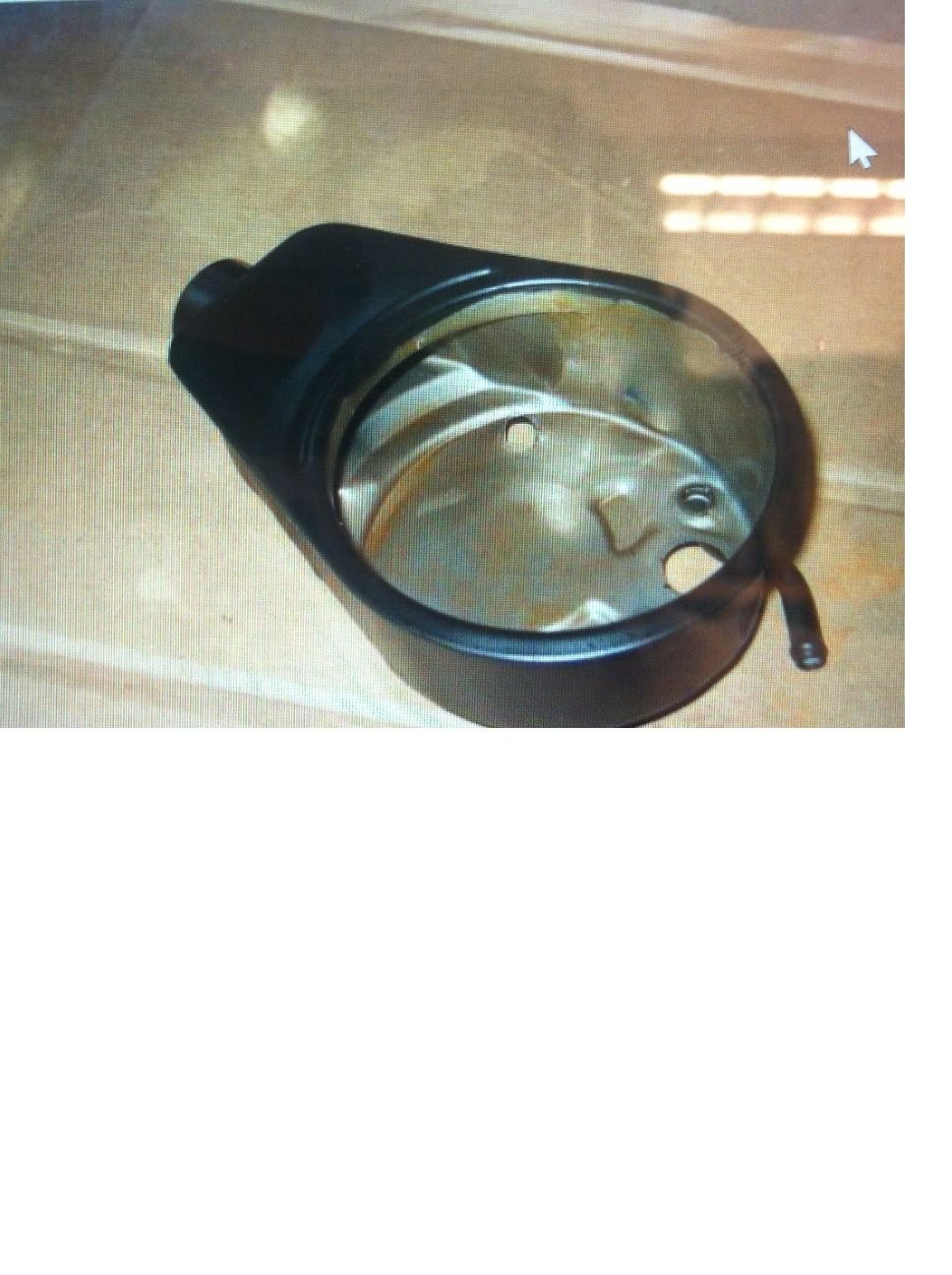

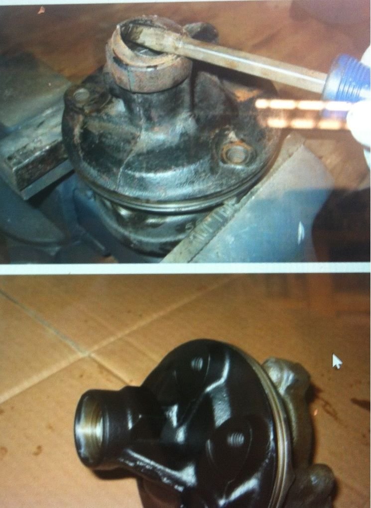

Hi, I have to remove the power steering pump to fix a leak that my mechanic told me it has. More or less I know how to remove it but I was wondering if anyone can help in finding out what type of chemical I need to buy to leave it clean as shown in figure 1. Also what type of paint do I need to leave it as it is shown in figure 2 and 3?

A semi gloss black Engine Enamel would be great.
You need a parts cleaner with some sort of solvent.....then spray down with brake cleaner and wipe with lacquer thinner so the paint will not fish-eye.
