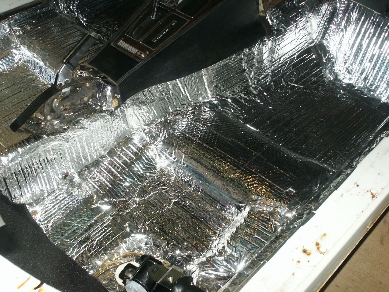

I installed the complete set of ACC carpet in my 73. I used Reflectix as
insulation under it. The only place that I used any adhesive was the fall
panel behind the seats. Of course, you have to fit and test the pieces
carefully before you install each.
That was my experience, others may have had another.
Donnie

Awesome! How well does it work? I watched a manufacturers video about it and it said one side had to face an air space to provide thermal benefit. How much did your car require? I see a 48" x 25' roll at the orange hardware store for $42. Is that enough? Seems like it should.
Old Jan 18, 2016 | 02:57 PM
DonnieP73's Avatar
DonnieP73
Joined: Mar 2013
Posts: 1,018
Likes: 582
From: West Monroe Louisiana
I bought the 48"x25" roll from Lowe's for the same price. I also bought
a roll of foil tape for the seams. I didn't need little more than half of the
reflextix roll, but I wanted the 48" width to have less seams.
The tape works great, but when you stick it to the reflextix, better have
it where you want it because you can't take it off without tearing the foil
on the reflextix. I covered the rear of my 73 to keep the cool in when I use
the air conditioner more than to keep the heat out. That said, I haven't got
the air working again yet. I drove this summer without it with just the vent
open. I never felt any heat from the engine on my feet or in the cabin.
This is the IPG Foil Tape 1.88-in W x 150-ft L Hvac
http://www.lowes.com/pd_760653-21669...ctId=999972336
You can nearly make out the foil tape on the foil from the belt rectactor
to the console. There are other seams in the photo that are harder to make out.
Donnie
