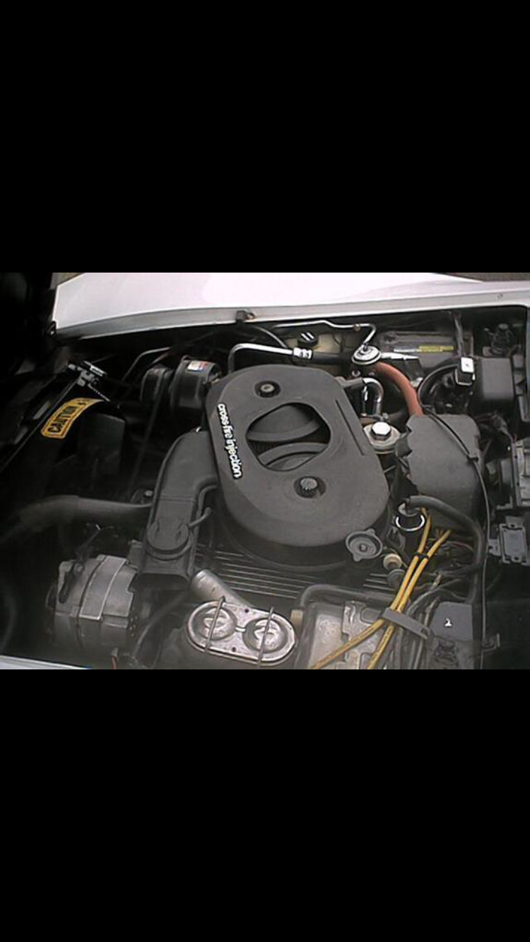

Are all the snorkels suppose to be open like this one or is these some kind of ducking to attach to it?

you are good,
the ram air on top opens at wot, you can rig it open all the time

You can see the steel heat tube coming up from the left exhaust manifold area to the snorkle inlet. That assures that warm air is injested until the engine temp is up to operating level....then input airflow comes in that snorkle tube from the engine compartment.
When at WOT, cold air comes in from the hood openings.
Everything looks as it should...as long as the various temp/vacuum operated duct valves work properly.

AS stated by 'slcikfx3' and '7T1vette'...you air cleaner is good to go. Assuming that the rubber seal on the underside of your hood is still there so the hood can seal to the opening in the top of your air cleaner lid.
BUT....I have to mention it ( sorry if I am over stepping any boundaries)..... because you have your engine compartment looking so good....the spark plug wires for cylinders #1 and #3 are...uhhh....'jacked up' and really need to be routed as designed. Not really that hard to correct.
And the heater hose that is red ...going to your hot water shut off valve needs to be replaced with a black hose.

That's not my engine pic lol. It's a image I found on Google. Just to make sure it is the correct way lol.

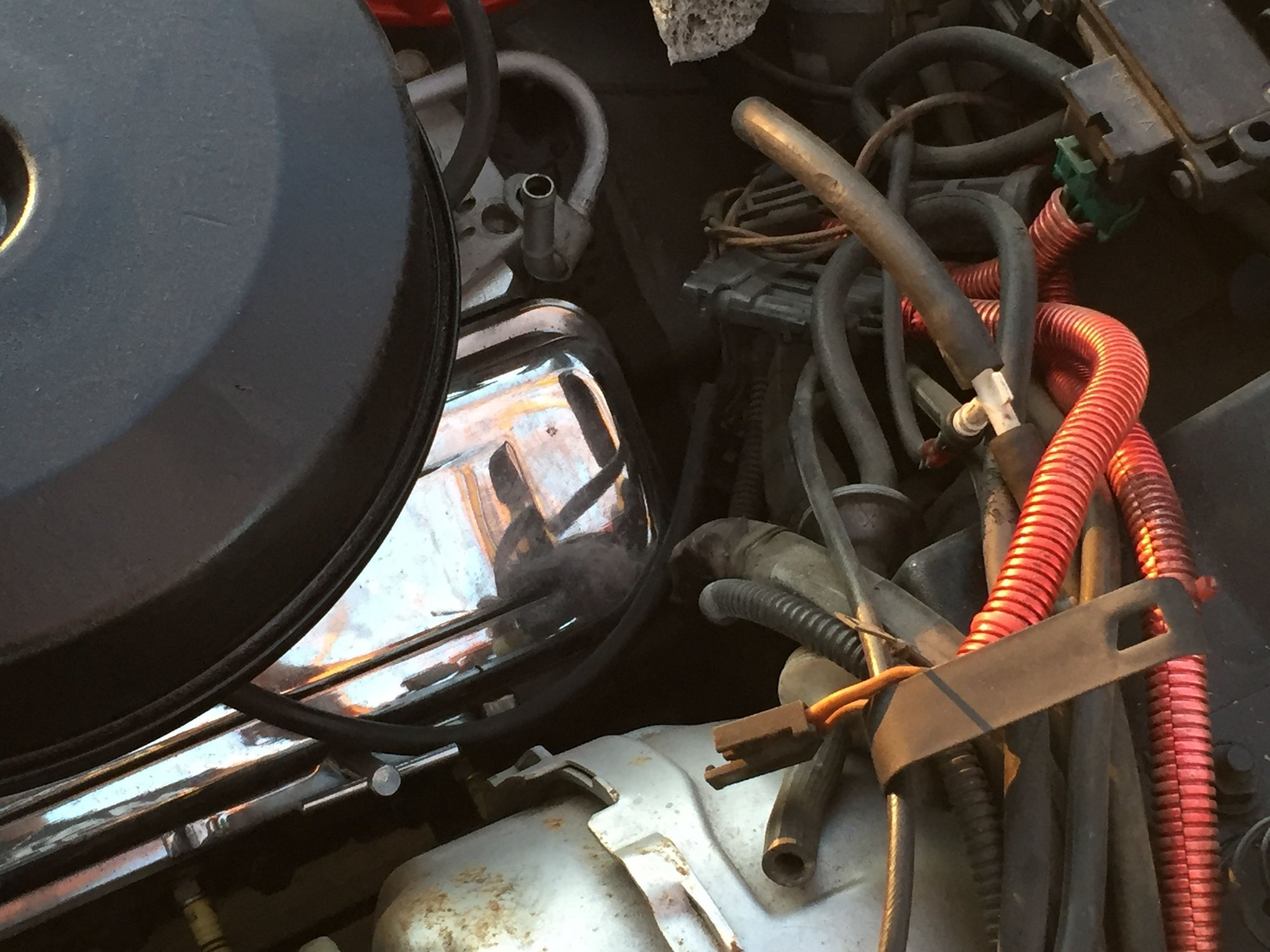

Judging from that second picture you posted up there, looks like someones been messing around under the hood

The first picture is a picture off google image just to see if that was correct. The second one is mine. Bought the 82 for $3500 and just needs to be put back together again but from what I can see everything is there
