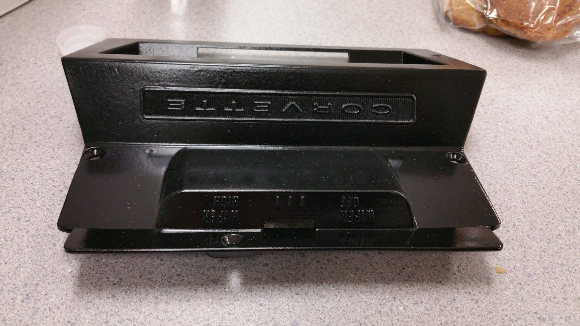

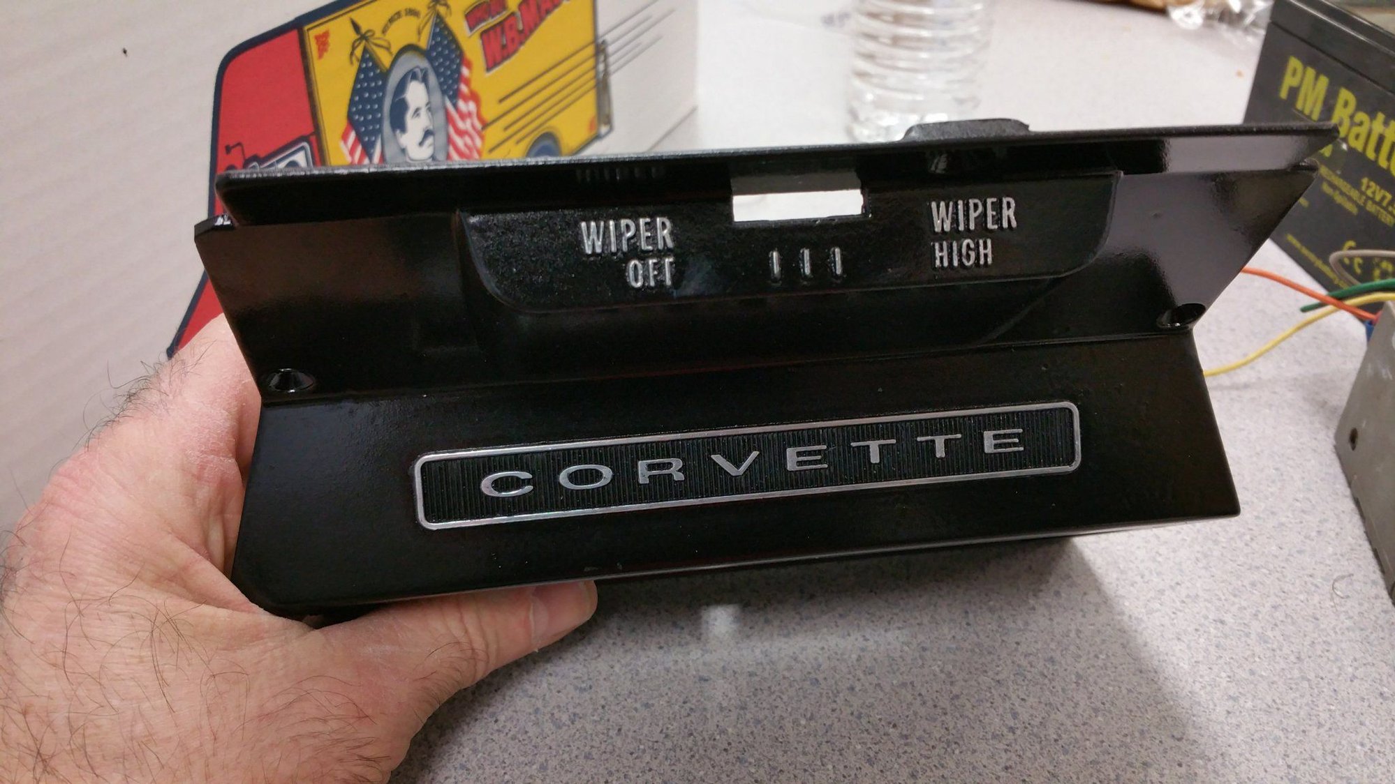

On the 68 bezels we like to use an acid primer and then a color coat. You can get away with this on a 68 because they don't have any grain texture to fill. On 69 and new cars you can't because you'll fill the grain with primer. For the color coat we use our part number 431920 black dye.
Two ways to get the letters clean.. First paint the bezel and then with sharp razor blade scrape off the letters and/or the chrome edge. The other way would be to use a lint free rag and after the paint is dry, use some thinner to wipe off the letters. You do this by putting the rag over one of your finger tips tightly, dip it into thinner, tap it off on a towel (keeps extra from dripping) and then wipe the letters.
Razor seems to work best IMHO.

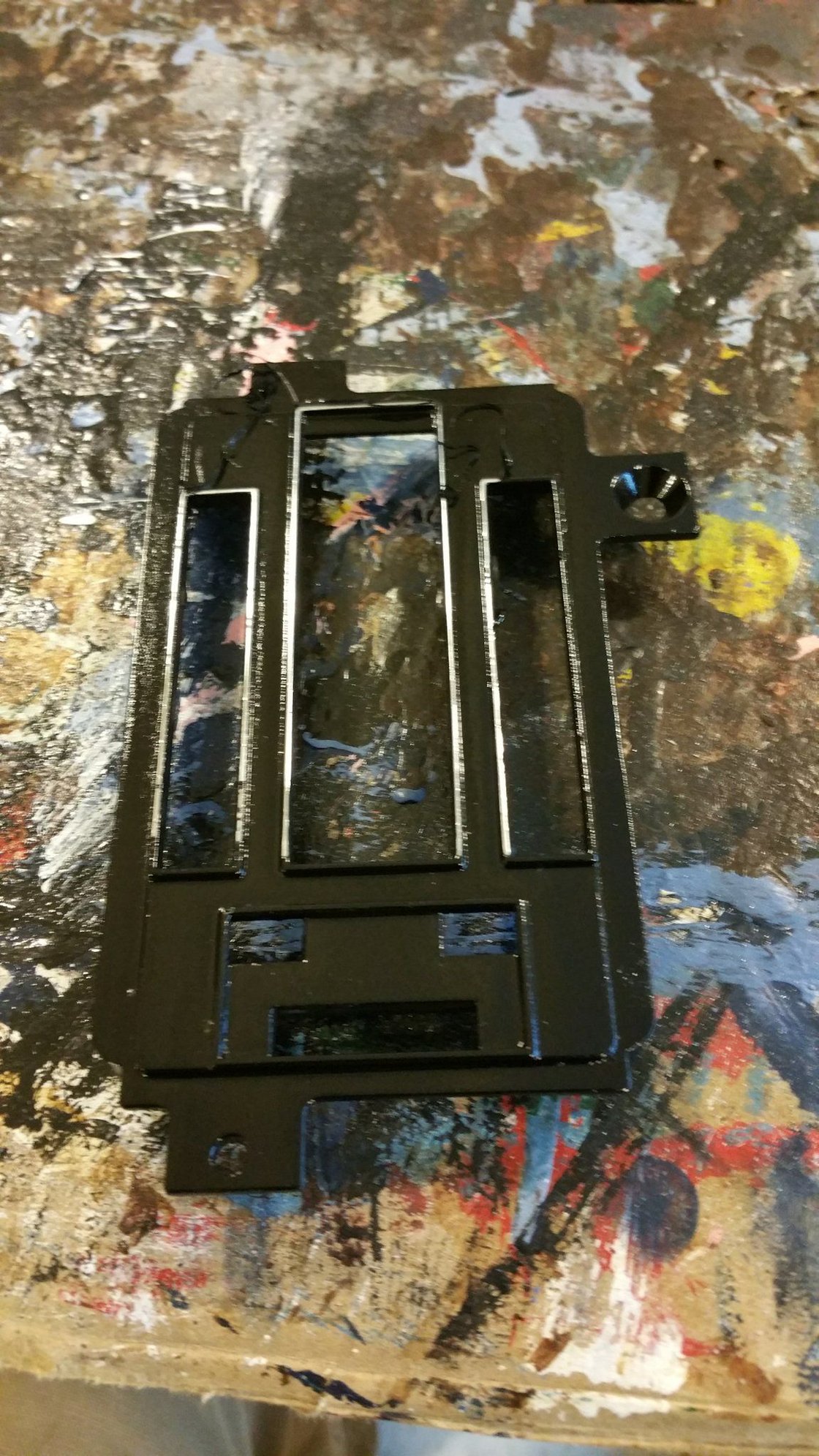

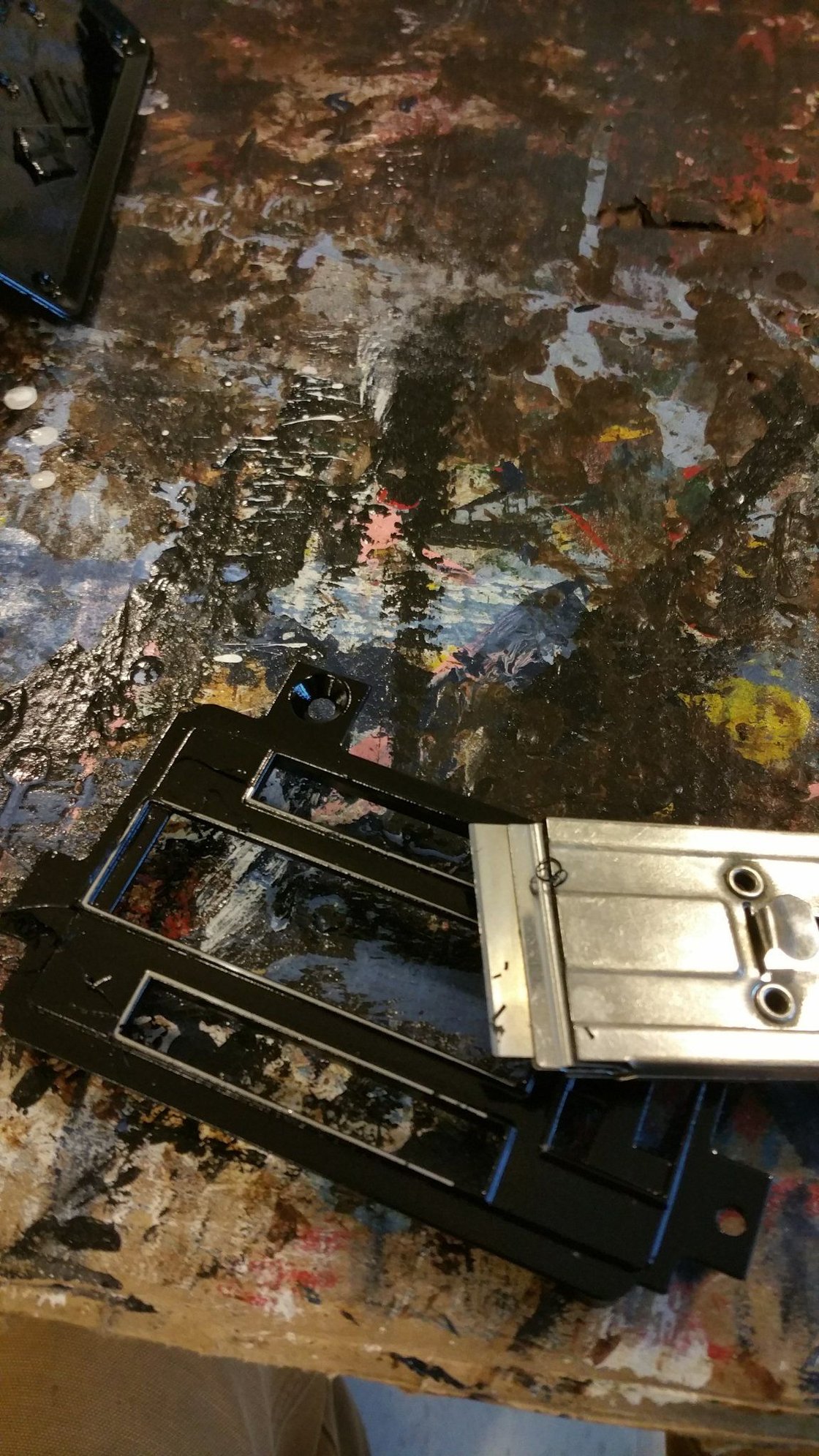

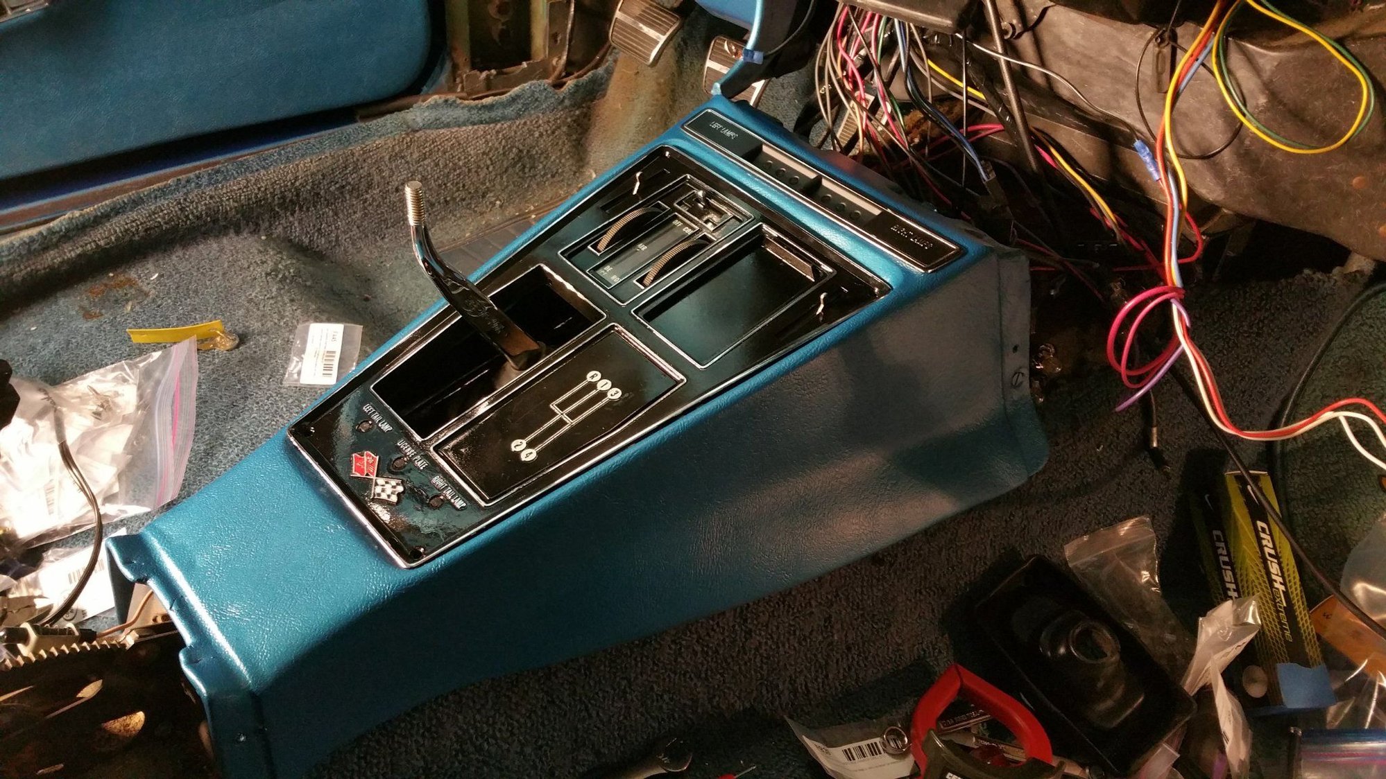

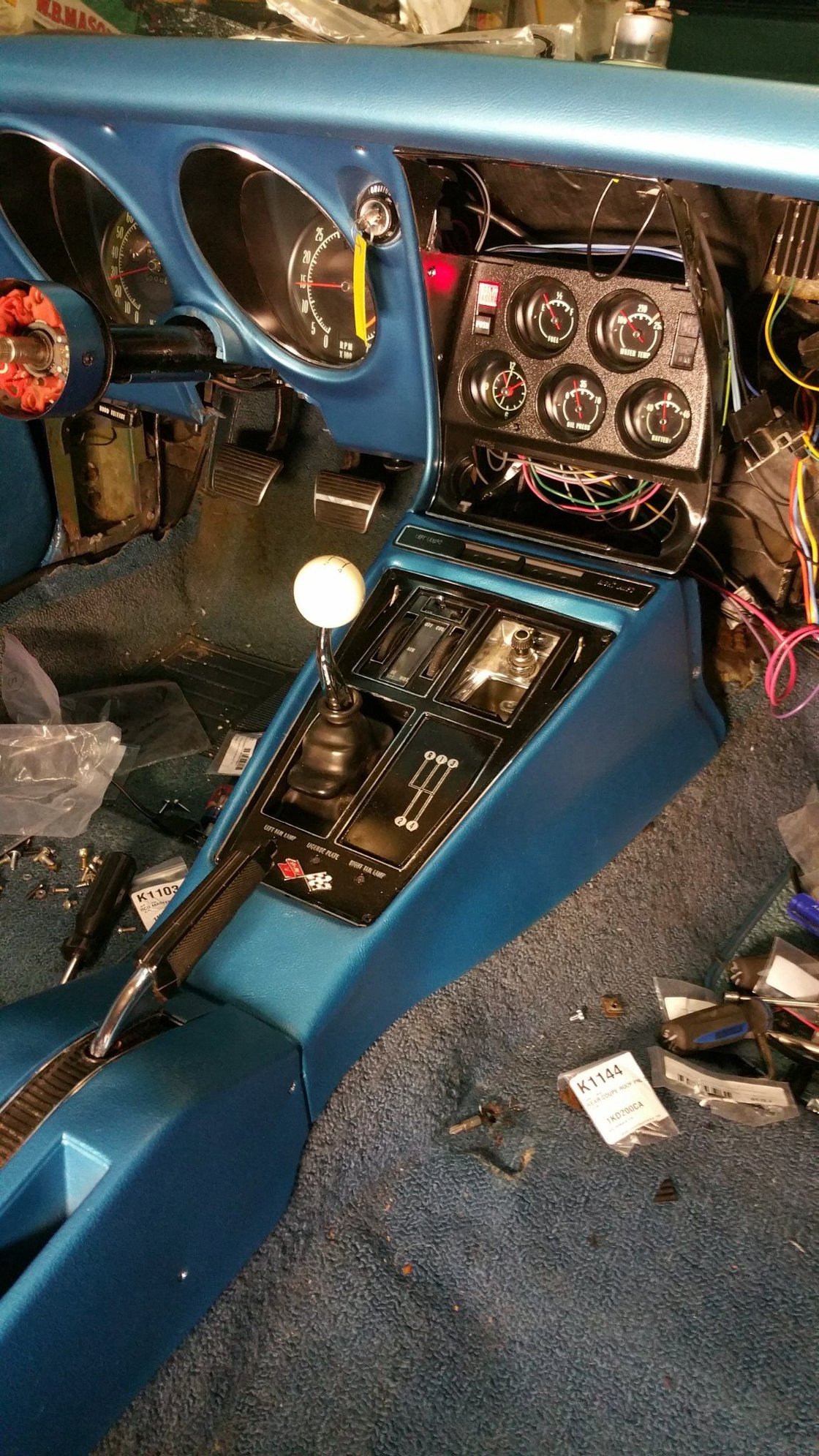

If you wait about an hour after you paint it should confirm me off in strips. If you wait until it is fully cured it will chip. I have asnt going for the original fi ish I wanted the high gloss look
