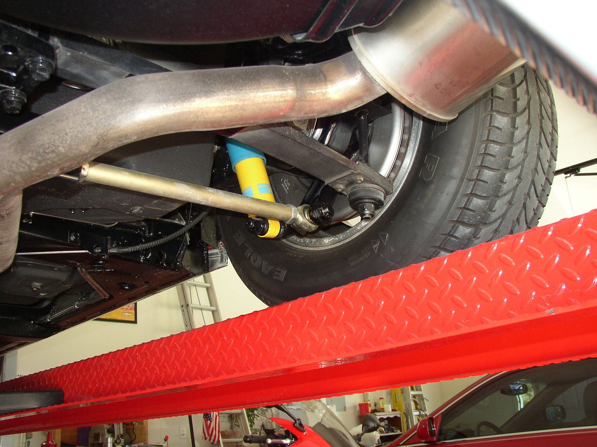

When I rebuilt/upgraded the suspension on my 72, I went with Bilstein Sports and have been very satisfied. Some have used the Bilstein HD's because they are not quite as stiff/firm.
