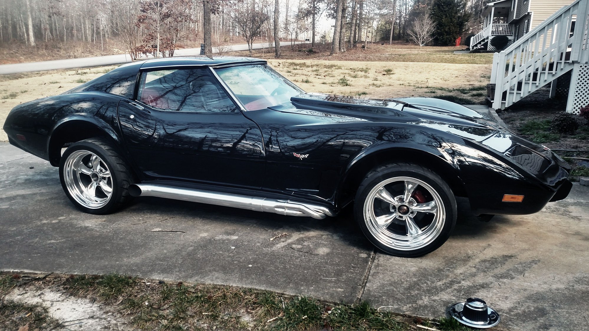

Just purchased 550 springs and longer bolts. Going to install sometime this weekend/Monday or Tuesday. Will let you know how it goes. And I see they linked you to VB and p. Im hearing real bad things about there service and shipping times. I ordered springs and bolts from vansteel and shipping took 3 days from order.
Heres a before,ill let you know it looks after
