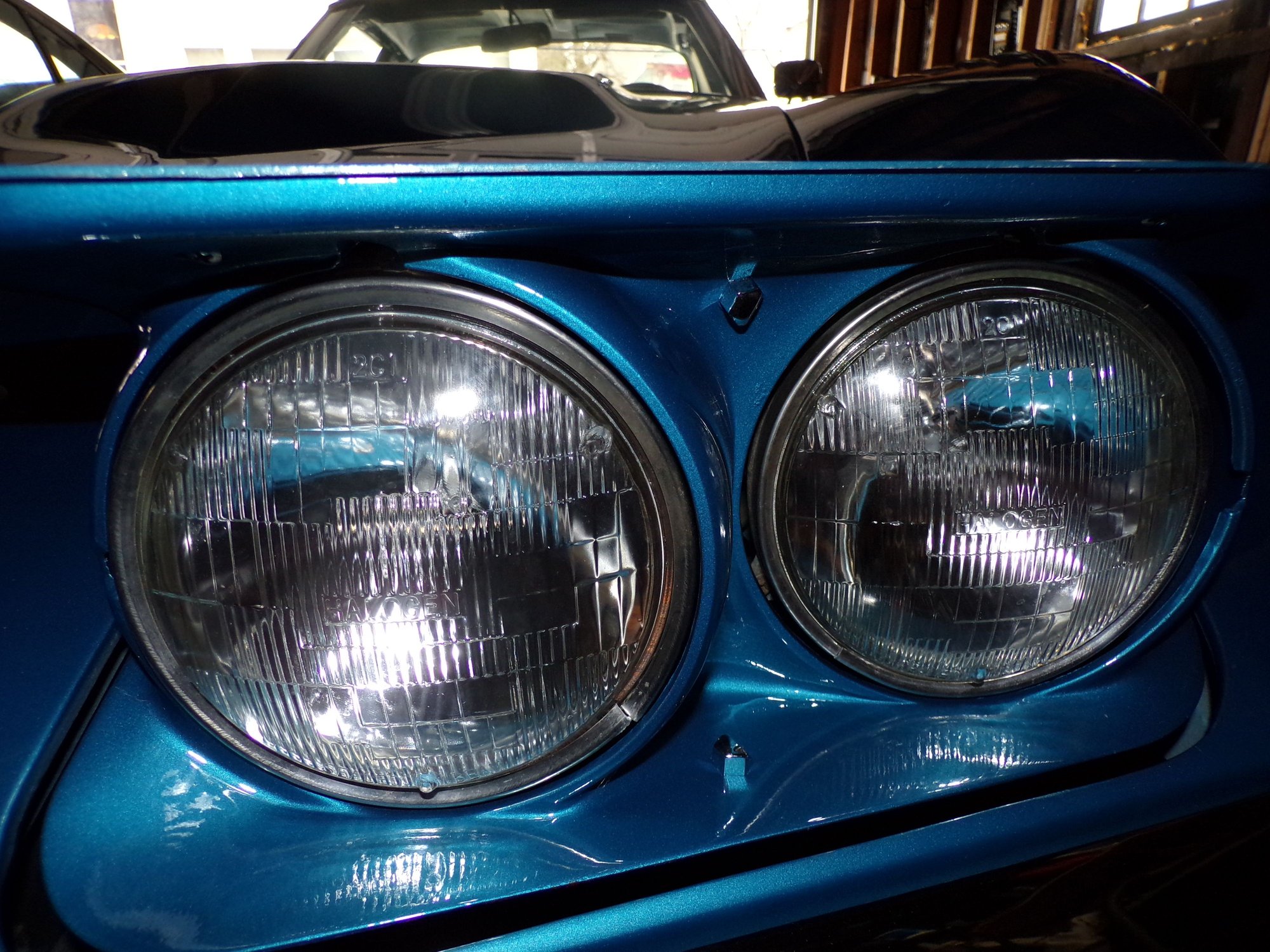

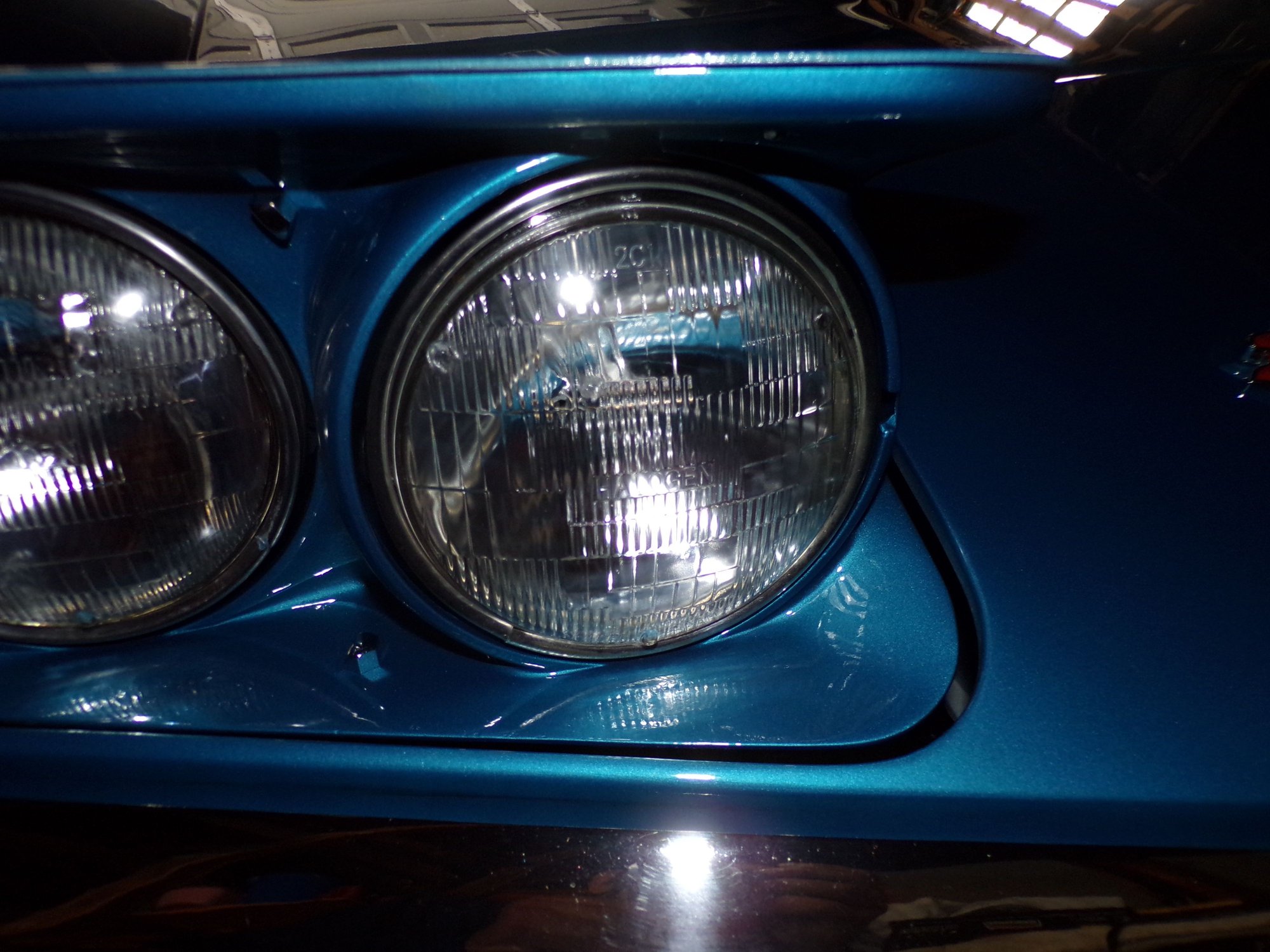

here are some photo's unfortunately I have to take the lower washers off to remove the bezels but you can see that the bulbs look off diameter and the rings are not able to grab them well, some seem worse than others

... you can see that the bulbs look off diameter and the rings are not able to grab them well, some seem worse than others
Originally Posted by OZvette72
Hi steffan,
... double checked the OD ...
... I noticed the little tabs on the retainers were bent due to the US Sylvania Halogen bulbs being slightly thicker on the glass rim and when fitted with the retainer didn't sit correctly, rather the tabs bent to compensate. I used a pair of flat nosed pliers to square them to the retainer ring surface and then fitted my bulbs ...
Mine was exactly the same, like it was a size too small and the very reason I double checked the outside diameter of the bulb. If you notice Alan 71 also has bent tabs on his retainers. Here is an image of a GM factory retainer. Give it a go before you spend endless hours for nothing.
