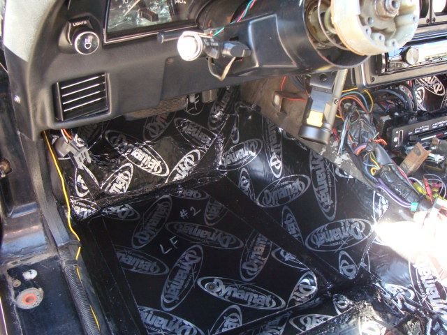

Originally Posted by DUB
Use what you like....but I use the Dynamat Extreme and DynaPad. To date...I have never had a compliant about noise or heat.
I have a customer with a 1974 that I did who is a member here on the forum and if you want to ask him how well it does. PM me and I can get you his name here on the forum. AS he will tell you...he can sell ice cream out of his car in the dead of summer with the A/C on.
DUB
That is the route that I took. Summit has Dynamat Extreme precut kits for our Corvettes

Reflectix from Lowe's will work. You can also purchase sound/insulation kits through the aftermarket providers. 1/8" material will not affect carpet fit.
Agree, used Reflectix a number of times, cheap and effective, you will need to cut and fit and I use Gorilla tape to hold together where needed.
