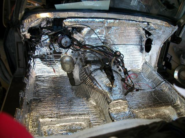

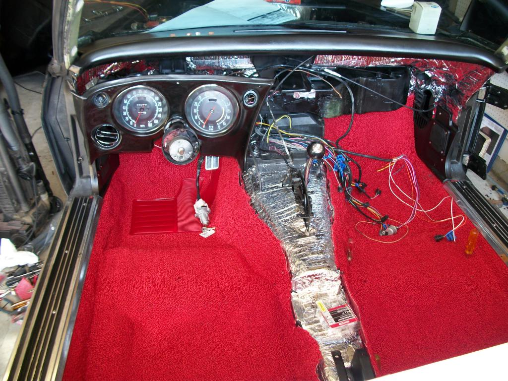

Heat/soundproofing is a great idea! I did have to remove the backing from the carpet in several places so the carpet would lay down in curved areas........good news is-----the heat/soundproofing was actually better than the backing that I had to remove..................
WOW! That looks amazing. What was the heat shielding kit you used?

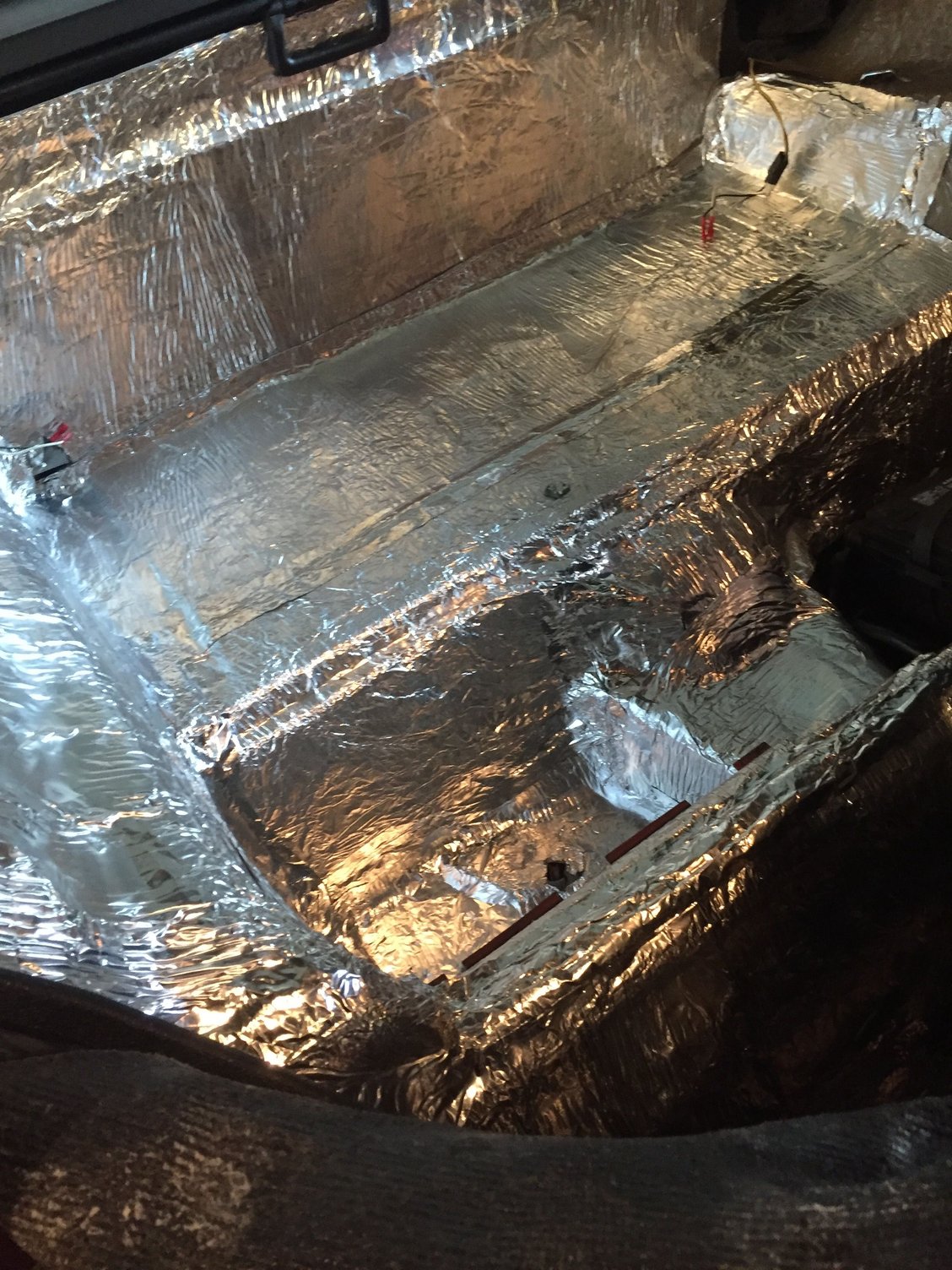

I recently used this material from Frost King along with 1" tape made of same material for small seams, hard to reach areas. Entire interior (less the doors) was completed using this stuff, took about 4 rolls. Ran it up the firewall to cut the heat buildup. Self adhesive, easy to cut/install and doesn't affect carpet install too much. Some places like the rear deck for storage/battery compartment needs trimming because the plastic deck lids are rather tight fit. Be sure to line the battery compartment with carpet or equiv otherwise since it is aluminum foil you will end up with an unintended light show of sorts. About $80 - $100 for all the materials which is a lot less than the pre-fab sound deadening kits which I saw were in the $400-$500 range. Pleased with the results, overall quieter, sound system is noticeably improved.
sound proofing/heat shield
home depot
