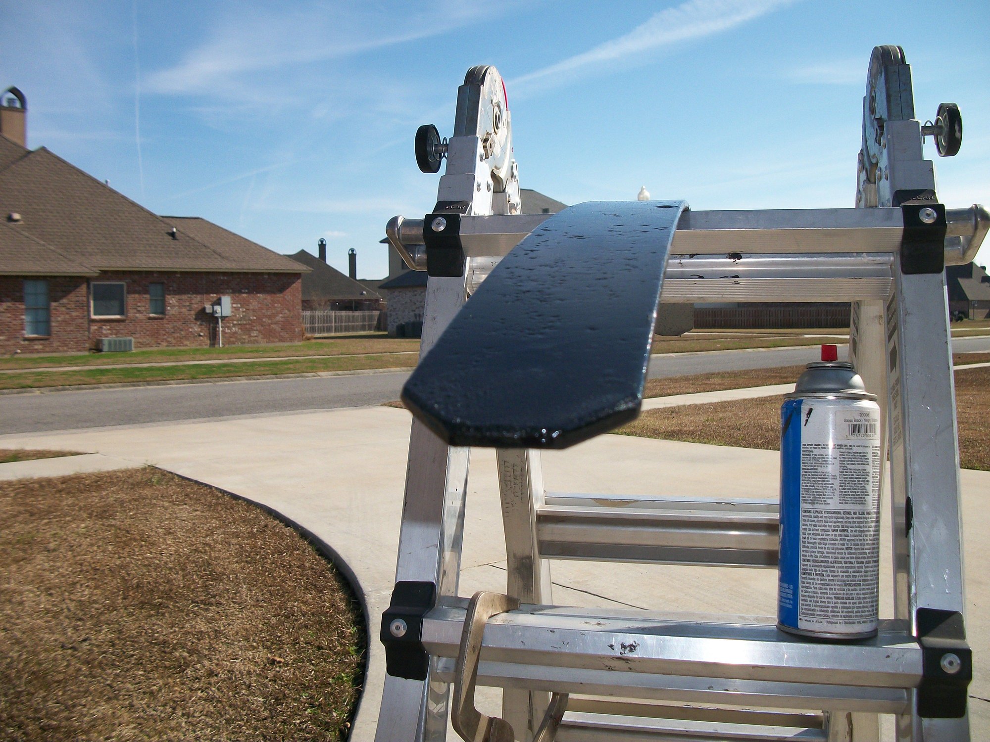

I wanted to stay as close to original as possible with my '68 steel leaf spring-pack.
The main leaf with the hole on each end was "turning up"/losing it's arch.....so I bought a piece of spring steel/cut it to length/drilled holes/installed it.
(I also modified the original main leaf to support the new main leaf)
Any local Spring Shop could fabricate a new main leaf for you.
