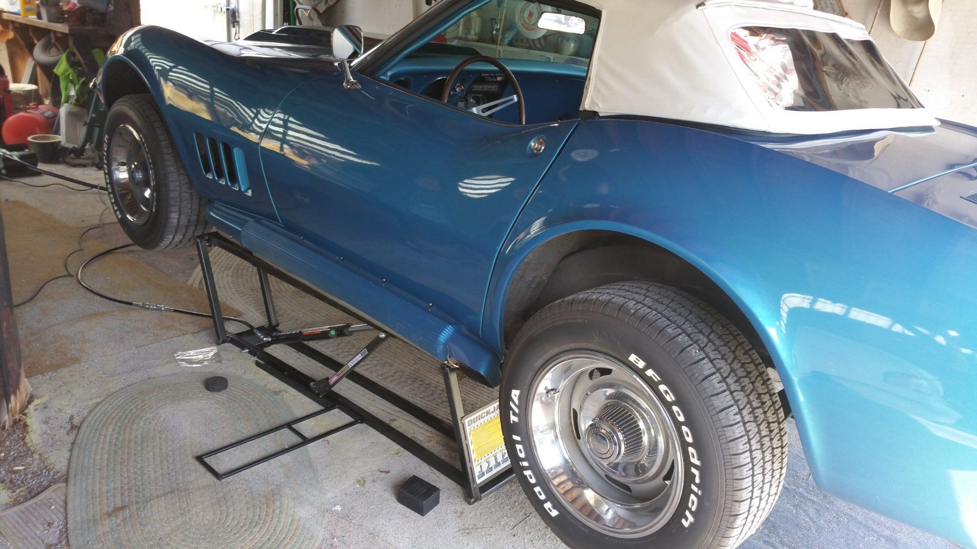

This is how I lifted mine with the tires on. Works well and very stabile.

AS you can see in 'sullyman56''s photos....the concept is much like what I did but he left the wheels on. THUS..the frame can not sag.
