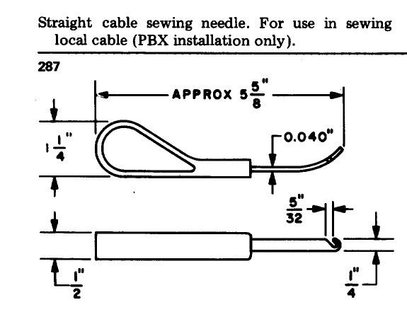

I remember my Dad using the special tool to remove the handle clips. I use a Western Electric/Bell System cable sewing needle to remove the clips. It's curved so I can get between the handle/plastic disc and push the clip off.
