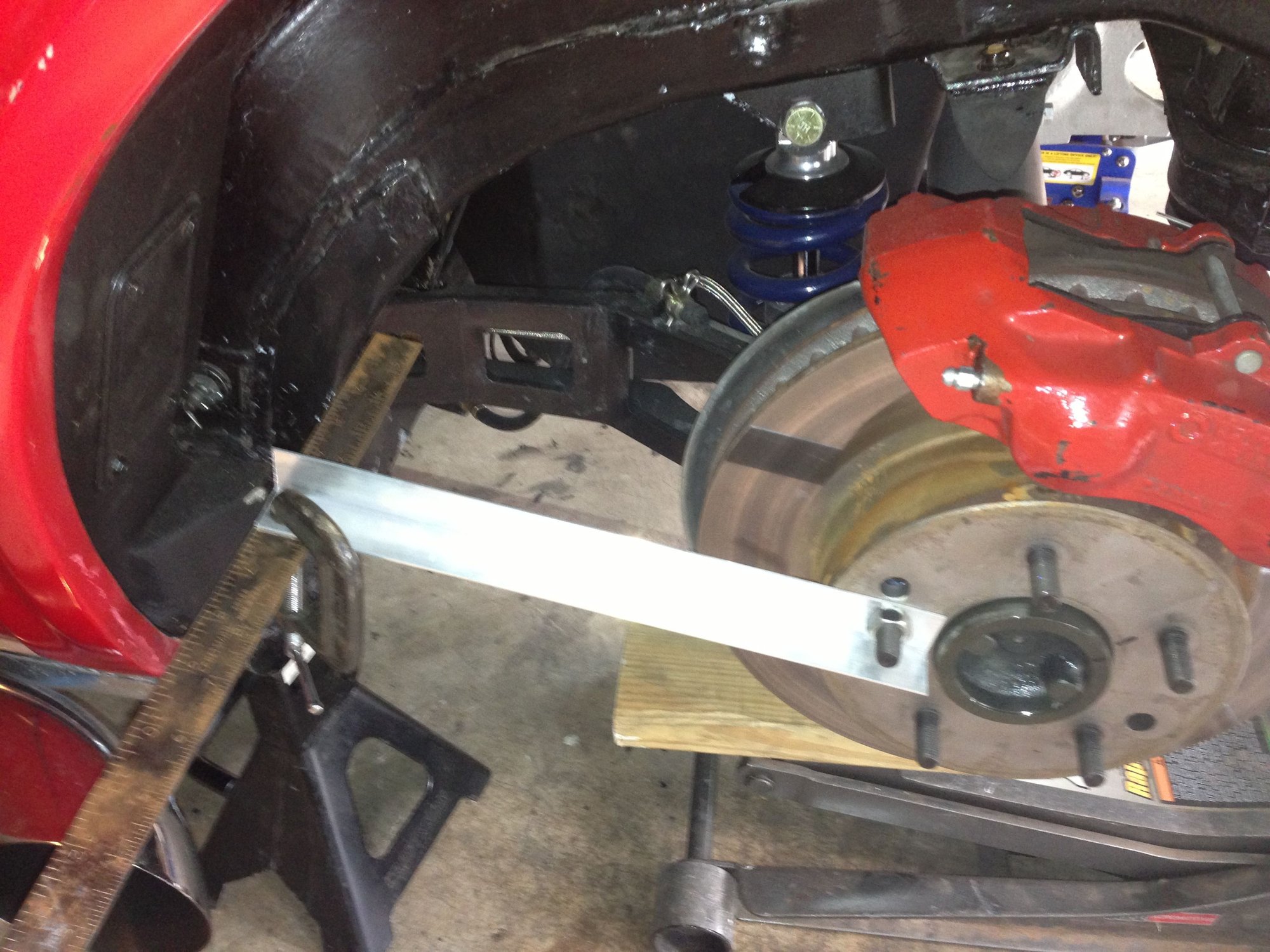

When I went through this, I found most people have gotten away with 5.5" BS without a spacer and I recall seeing somebody with a 5.75 BS with no spacer. After a lot of measuring, I concluded that 5.25 was the max I could go, and that turned out to be right. It is very close to the fender lip and I would have preferred 5.5" BS if it wouldn't have rubbed. I have ~5/16" between the frame and the sidewall. Although I have offset trailing arms they don't do anything for clearance unless you have small diameter tires because the frame (at the TA pocket) is the limiting factor...and possibly the spring. I have coilovers so I didn't need to worry about that.
The Tire Rack website lists both the tread width and the section width, which was very helpful. I assume you know that a 9" wheel is 10" measured from the outer edge of the lip.
Here's my measuring set-up. I'm sure there are other ways to do this, but this proved to be spot on.
You will need to lower the car to ride height because of the arc in the IRS movement. In this picture I don't have it all the way down because my half shaft isn't quite level.
