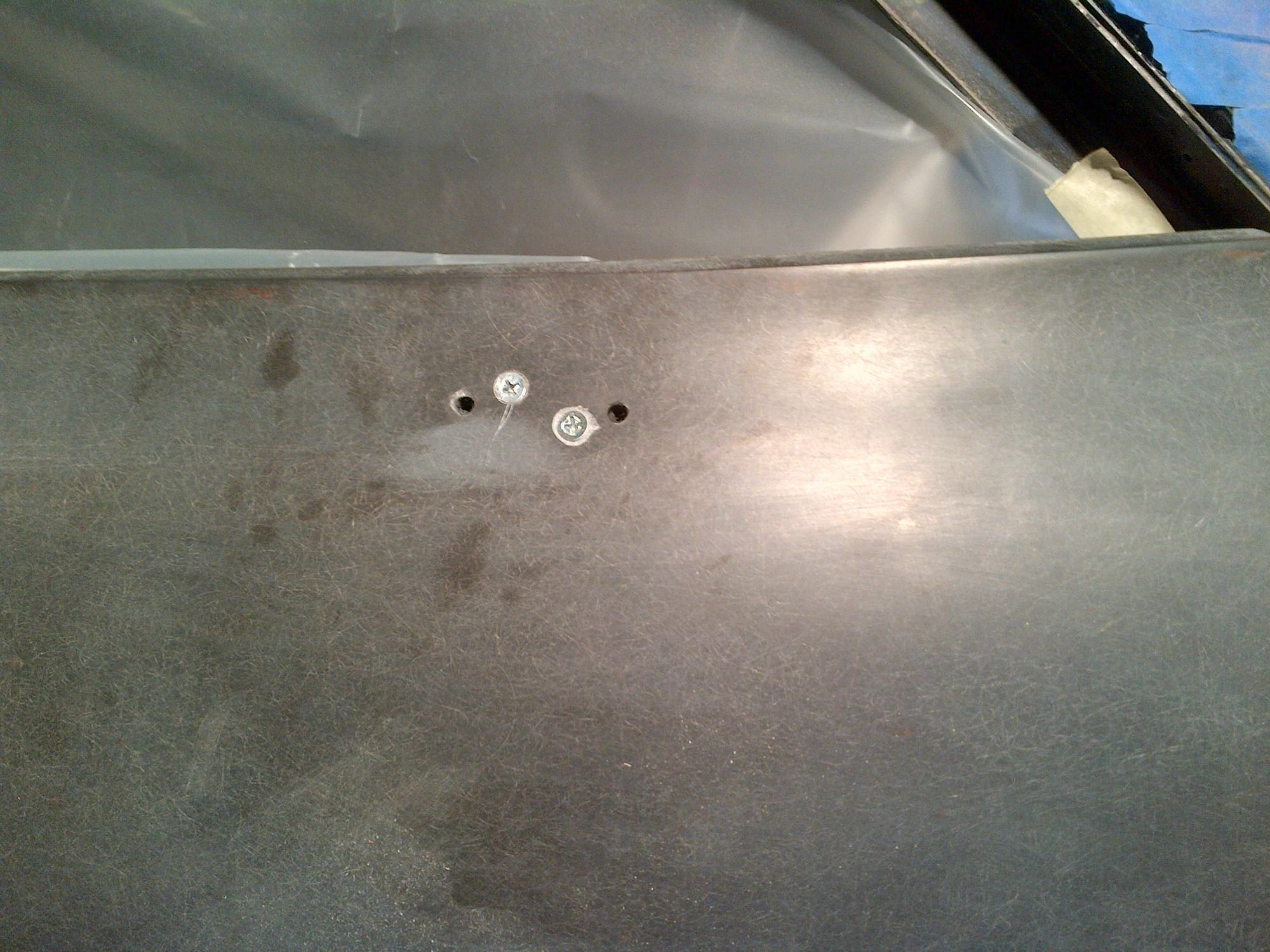

If you want to have your car judged in the future you will get a slight fiberglass point deduction because of the holes drilled for the mirror mounting bracket.
My 73 came with a RS mirror already installed by a previous owner. If it were up to me I wouldn't have one only for originality reasons! If and when I decide to have my car repainted the RS mirror will be removed and the holes repaired.

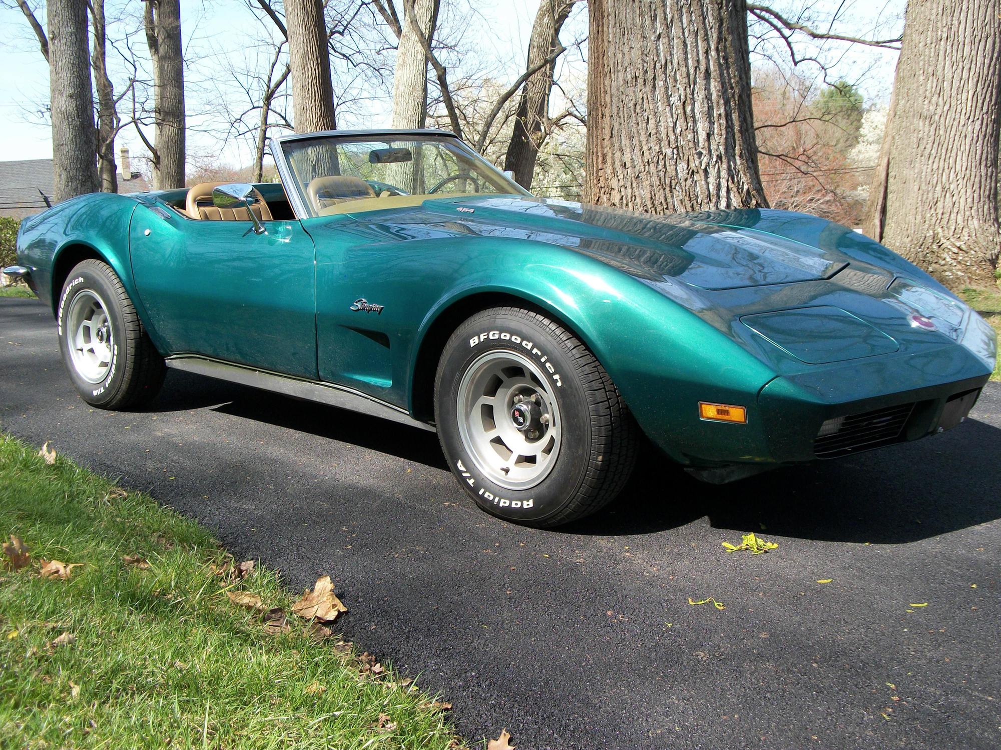

I just added a RH mirror on my 73 I bought in Dec, here's a pic of before % after. To me it balance's the look, but the most important to me is, I just fill lost without the RH mirror when driving.
