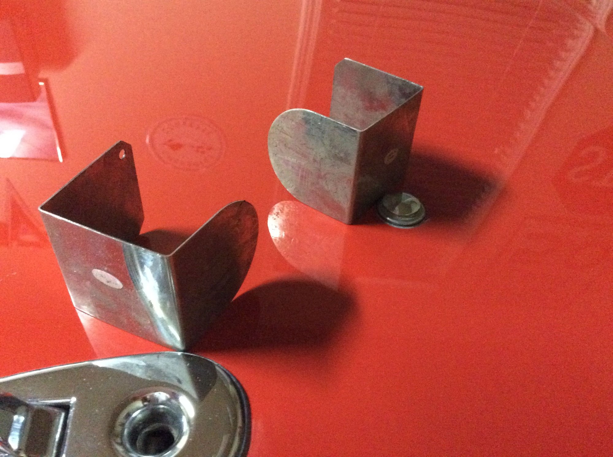

Is there a brake tool to help install the rear pads? I replaced the caliper and am having a hell of a time trying to get the pads in place. As you know the pads must go in straight down, meaning that I cannot **** one side while trying to put the other side in front of the piston. This is on my 81. I seem to remember seeing some kind of "U" shaped thing that held the piston in while you slipped the pads in place. Went to Advance, they had no idea what I was talking about.
Thanks for any help.

This what you need.

That is Exactly what I need. Thank you very much 64roadster.

I bought mine originally for my '68 Z28 but have used them on the C3 as well.
