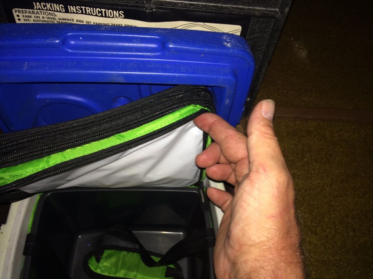

Can't mount it in the jack compartment, that's the ice chest!!!

I found a soft sided zipper style cooler at the Family Dollar, perfect size, holds a 12 pack if I remember correctly. Maybe someday I'll insulate the compartment and not need the cooler, and put a rubber stopper in the drain hole I drilled in the bottom.

The cooler?
Did that for the Hotrod Power Tour last couple of years-
Used an old Igloo- cut off the handle so it would fit. Then found a soft sided one that fit inside- so it could be easily removed. Will only hold a 6 pack though...
